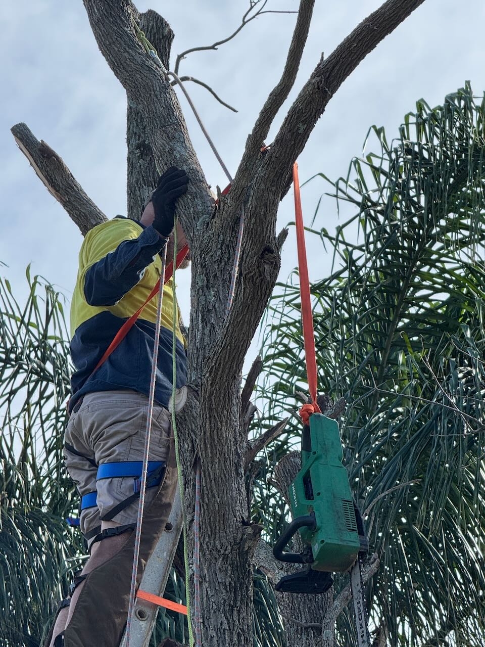

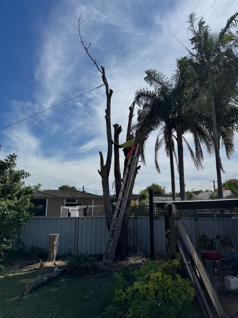

I've fallen a few trees out in paddocks, and I've done a few chainsaw courses through work. I'm defiantly not expert though. If you attacked the tree from the ground one trunk/branch at a time you should be fine Biggest concern is falling branches wear a had hat and don't forget to look up. Do a scarf cut for each branch remember the scarf only goes 1/3 the thickness. As long as the falling trunks can't damage anything go for it. Make you your chain is sharp teeth are even and you bar is dressed. If you have ever cut through a large log and the chainsaw starts curving around, that due to the bar and teeth not being filed dressed properly.

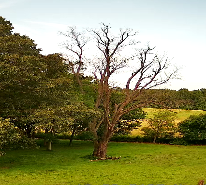

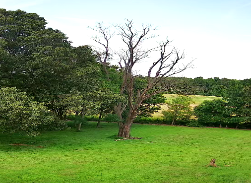

I would do a notch and backcut to drop the tree toward the camera.
I have done that to 100' pines here in East Texas. Notch in the direction of the desired path of the fall on a day with favorable winds, and then backcut backoff (run) as soon as you see some lift on the cut in case it "high chairs" on you.

It was fully alive two years ago. Bugs got to it I think. Lots of bore holes.
That's one plan. But part of it is hollow and I don't really want a giant Roman Candle next to a guy's hay crop.
I have a barbeque place not too far from me. They declined it saying Hickory burns too slow for them.
I have another picture that has a 60 gallon spray tank at the base of it. The tank looks like a thimble. Picture is from a camera mounted about 25' up, so the perspective is off a bit.
