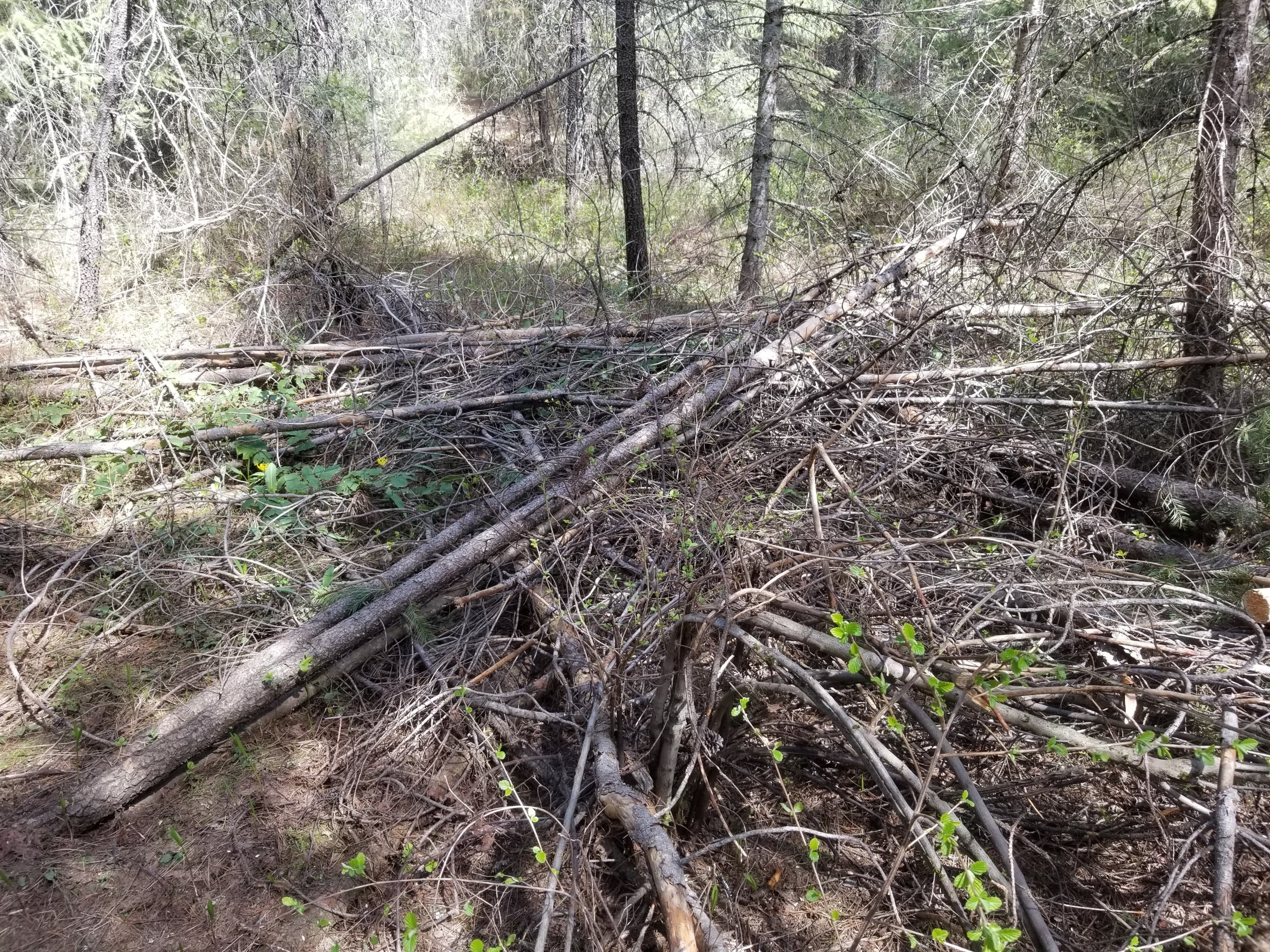

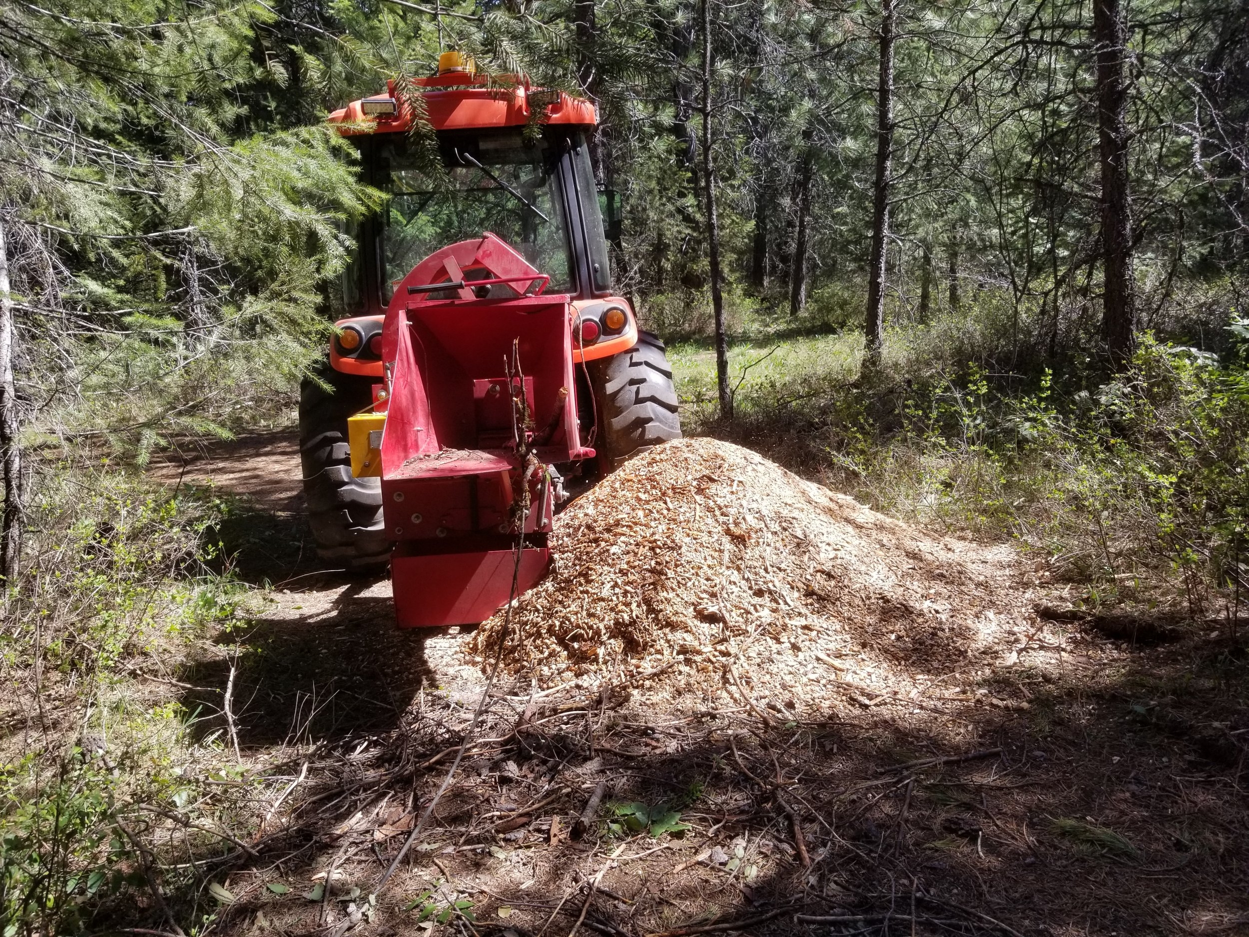

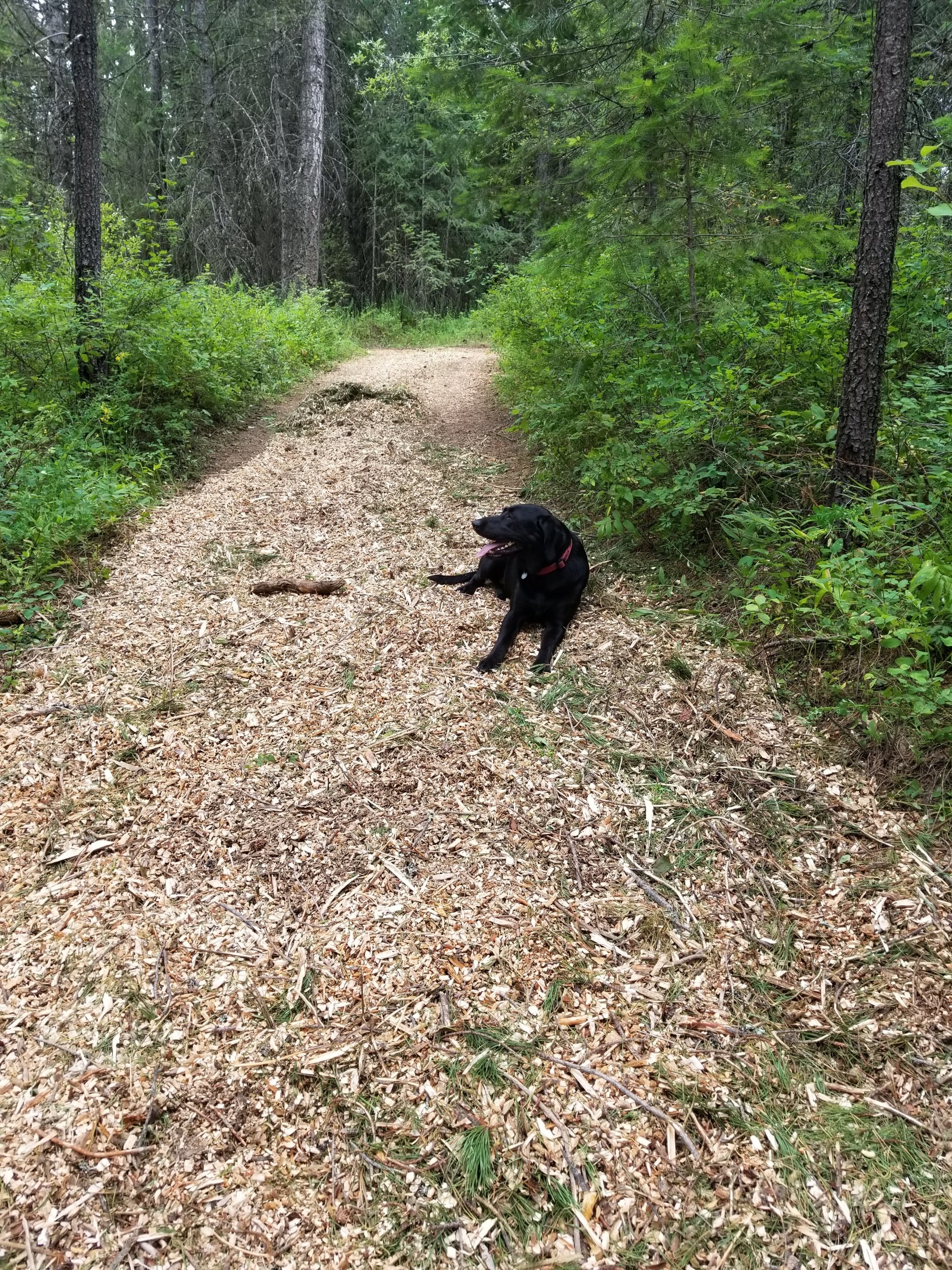

Heck if i know. I can produce a yard of chips in about 2 hours of chipping. But i have to cut and haul to chipper. I chip anything 3” and under. I spread these on about 1.25 miles of trails. Heres an example. First pic is pile of wind blown trees. Next picture is after chipping. Final pic is pile of chips. I rough spread pile with bucket, but they clump up. I have to run spring tooth harrow over trails when i finish chipping.
