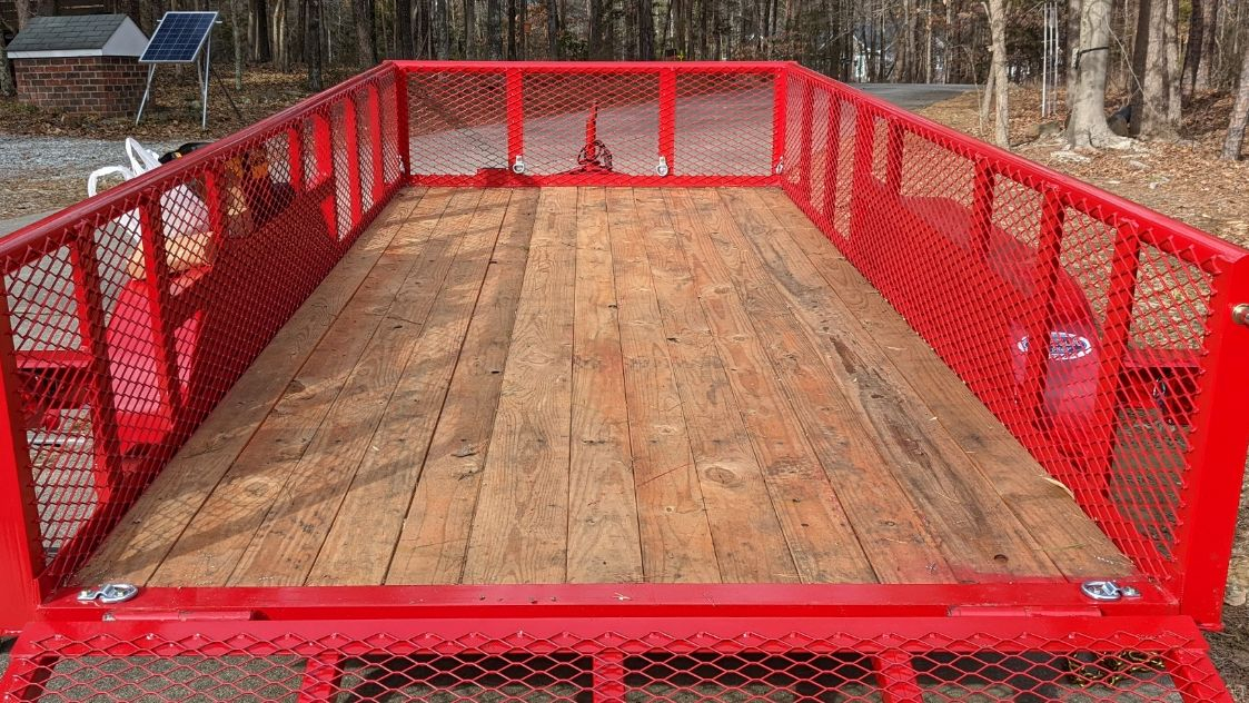

A while back we picked up an XUV590E S4. The S4 is 12' long, 56.5" wide and the only trailer of ours that could haul it around was the 18' aluma car hauler, which was not real convenient (big, wide & pull out ramps). Anyway, we went trailer shopping & the wife decided she liked the red Texas Bragg with a 14' x 76" deck & 2' expanded metal side walls.
It is a tandem axle (brakes on one axle) 7K (5500 lb. payload) 14' with a 4' drop down ramp. The ramp is expanded metal w/ 2" tube struts. The deck is 2" southern yellow pine. I will need to add some D-rings, it has 4 stake holders but I'd prefer D rings. I'm sure it will get used for stuff besides the gator. We should probably get rid of the little 5'X8' sno-bear trailer, as trailer parking space is getting a bit tight (this is trailer #5).
Pics from the trailer lot web site - but are of our trailer (the vin matches).

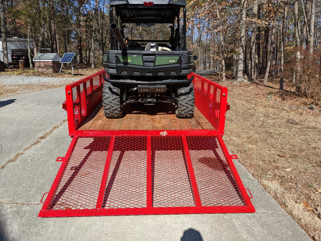

Pics of S4 on trailer. No problem moving along between gator & trailer side.
Good clearance on approach angle with truck air suspension in high position, close clearance on approach angle with truck air suspension in lowest position (per an observer). Of course this could also be changed by changing the ball position on the hitch. No deflection of gate components observed during load/unload.
