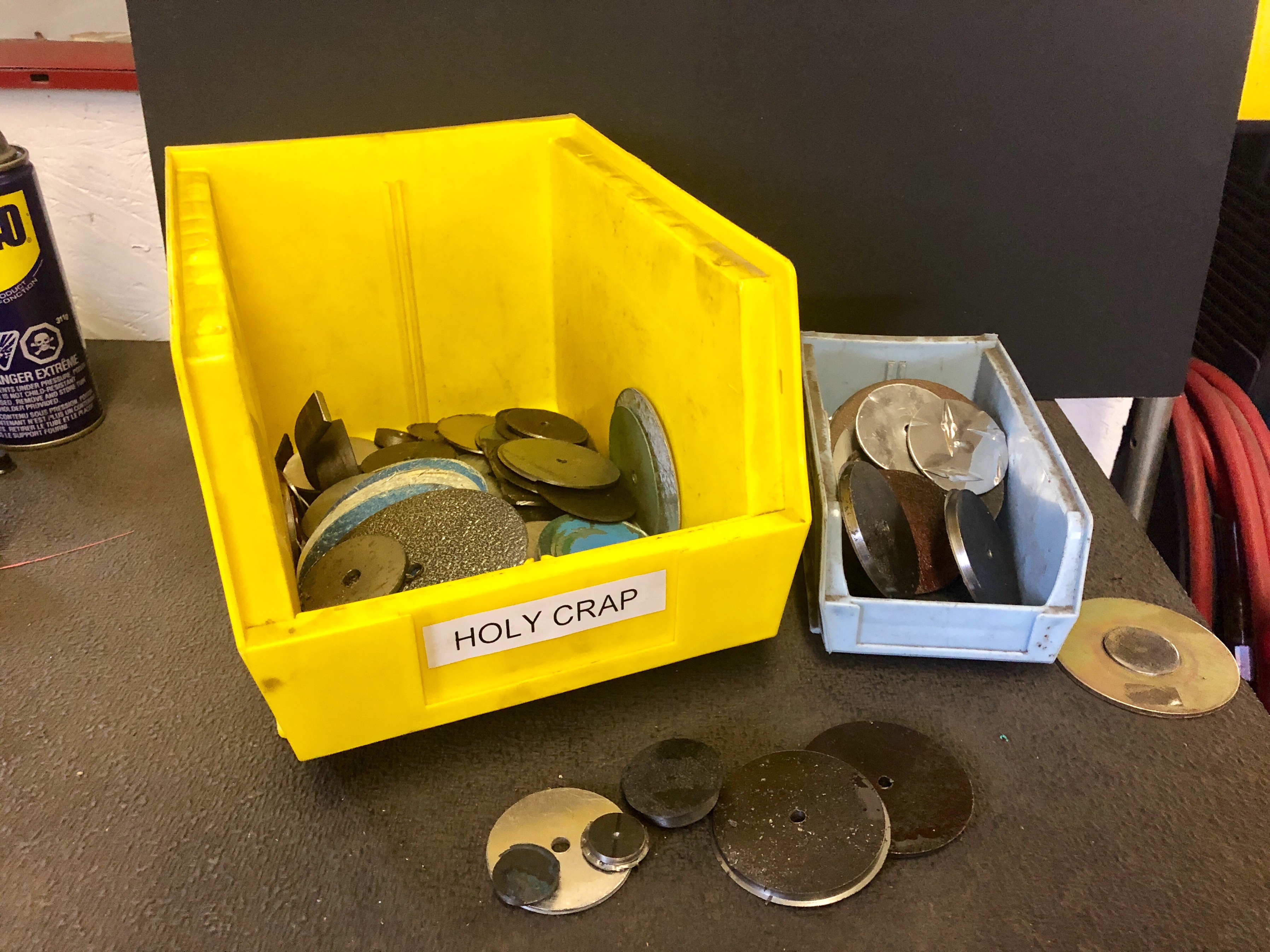

Plus all the centers and slugs from using the hole saw. And the arcs left over from large circles cut with the torch or plasma.

it's not like those saved pieces are going to wear out...so why not.
It is so satisfying to go looking for a piece that size, and find it.
My metal pieces are all stored in a metal trash can.
