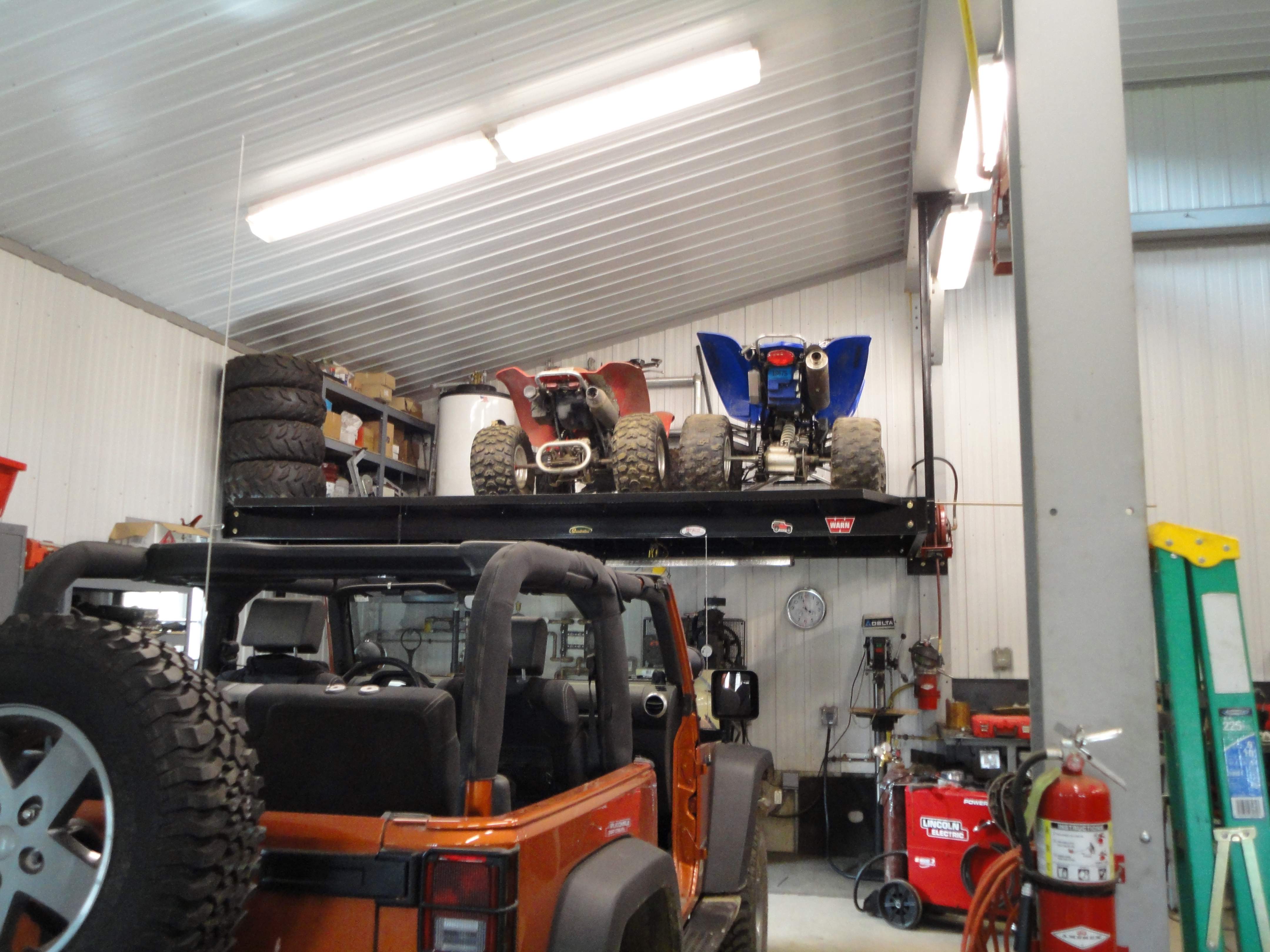

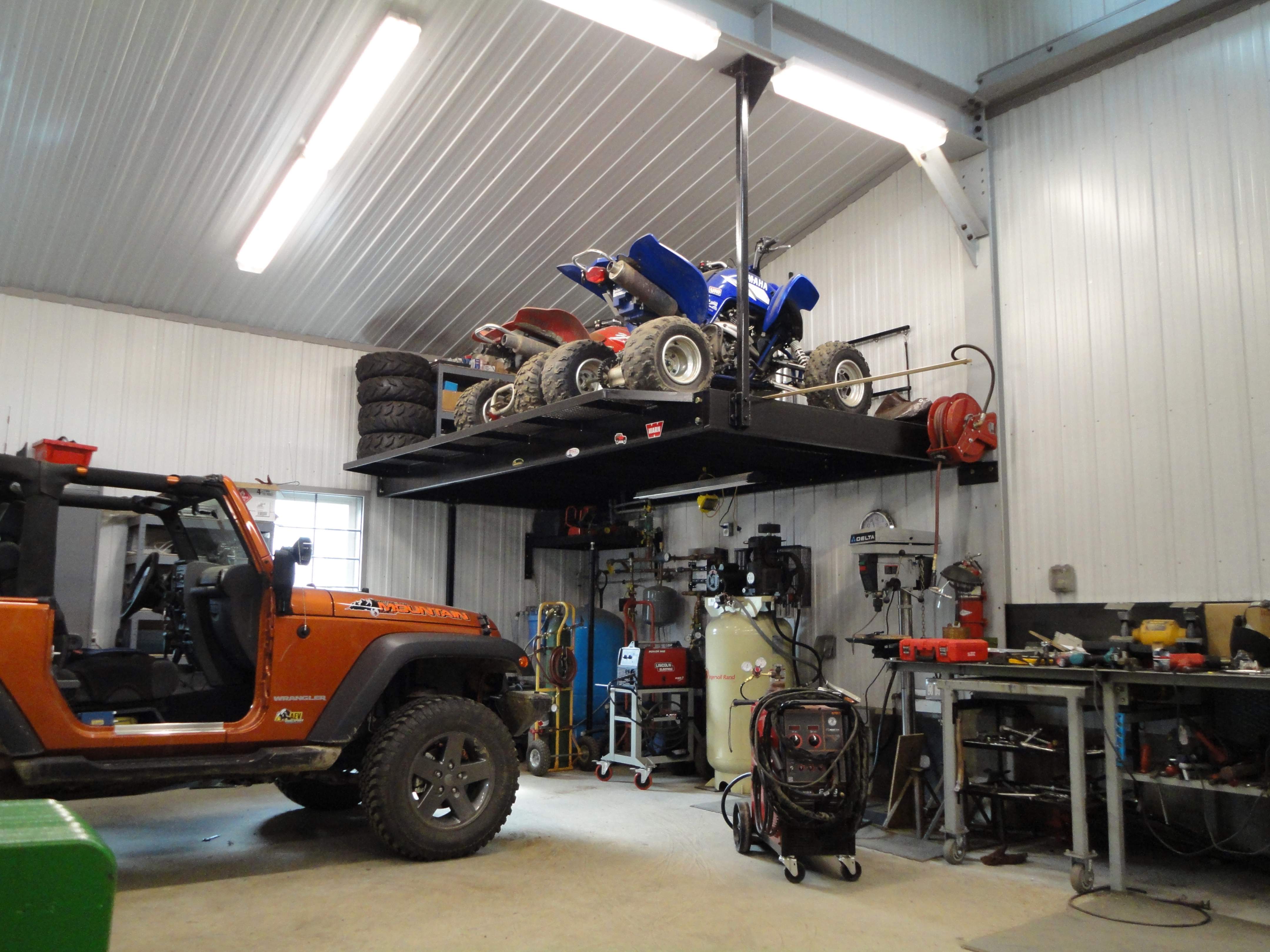

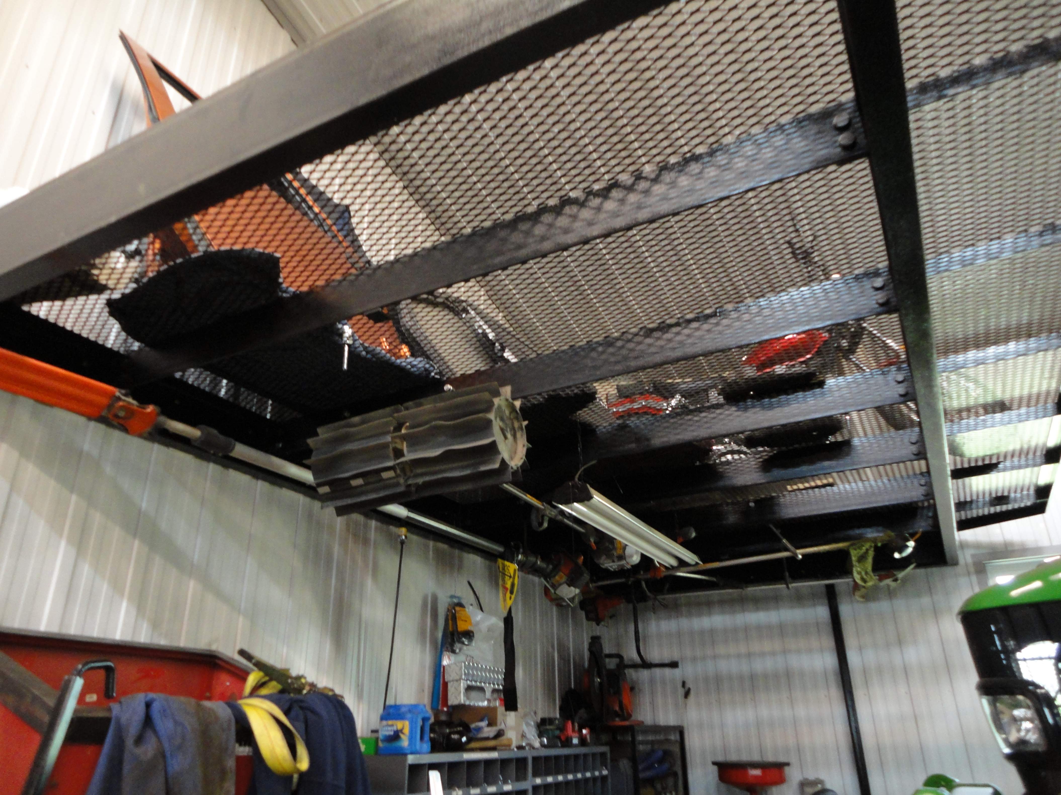

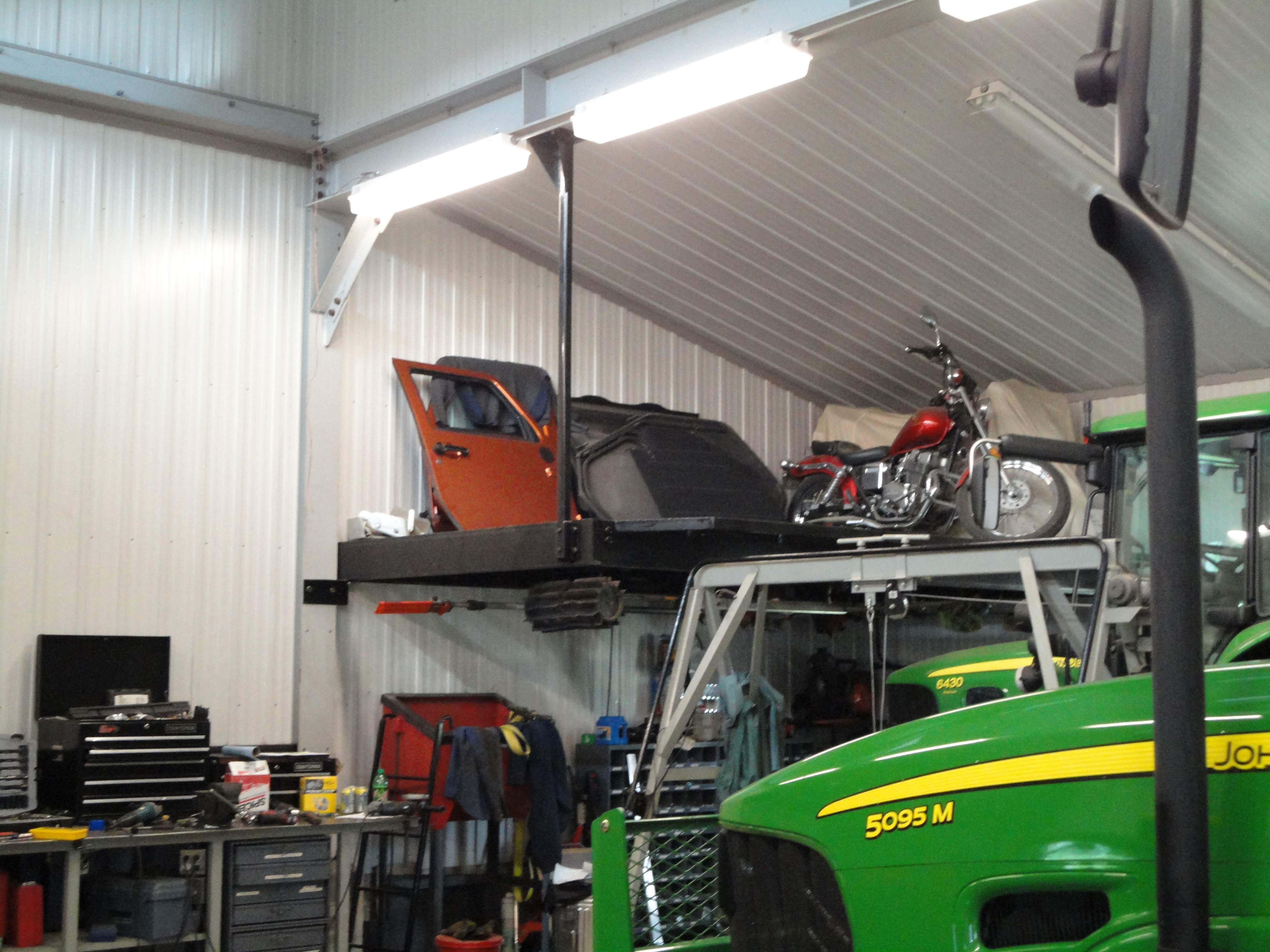

Some of the work that got done this winter/spring
Added two shelves in the back corners of each side bay 14'X8' framed with 3/8"X3"X8" channel iron with 3/8"X3"X5" angle iron floor stringers floor is 1/8" expanded steel sheet.
Lagged it to the wall with (2) 6" lags in each wall stud. One 2"X2" post against the wall from the bottom of the shelf to the floor and one post from the main shop I beam frame to the shelf. No posts are out in the floor to get in the way.
One shelf had my X728 lawn tractor a Yamaha Grizzly ATV and two motorcycles the other shelf has two ATVs the hot water heater and smaller shelves to store all the filters to the tractors and other equipment.

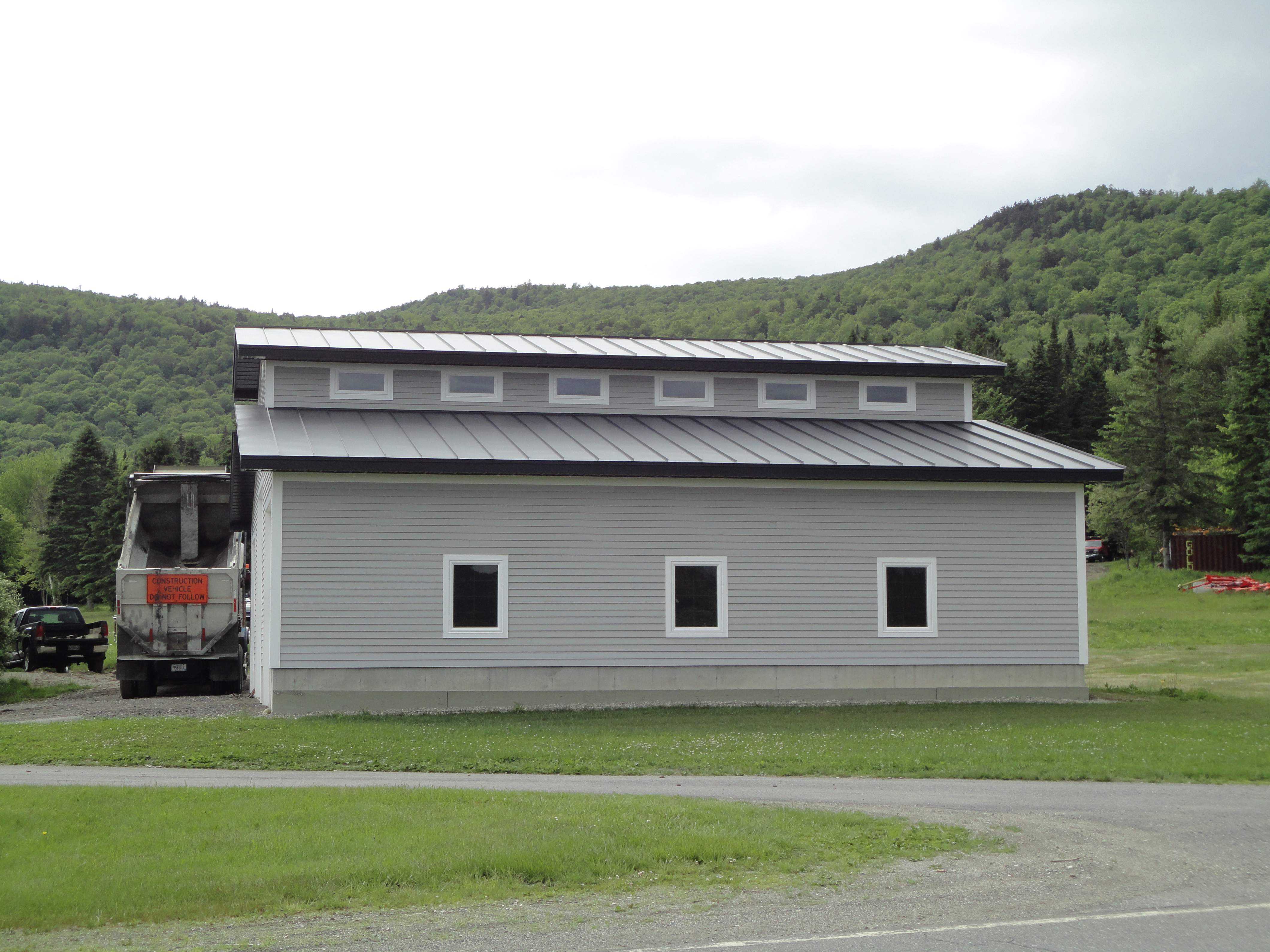

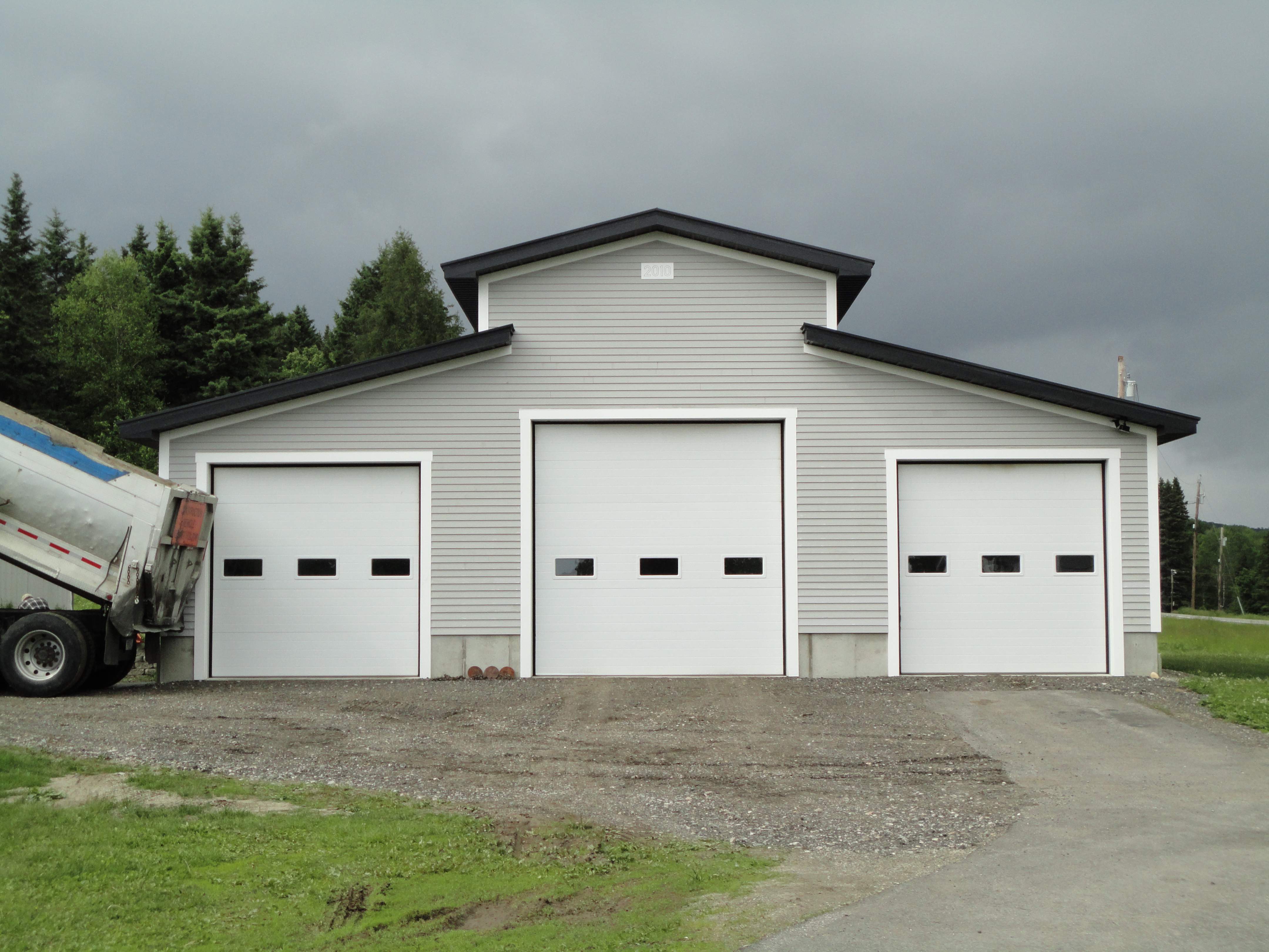

The outside is done just have to do the final paint.
