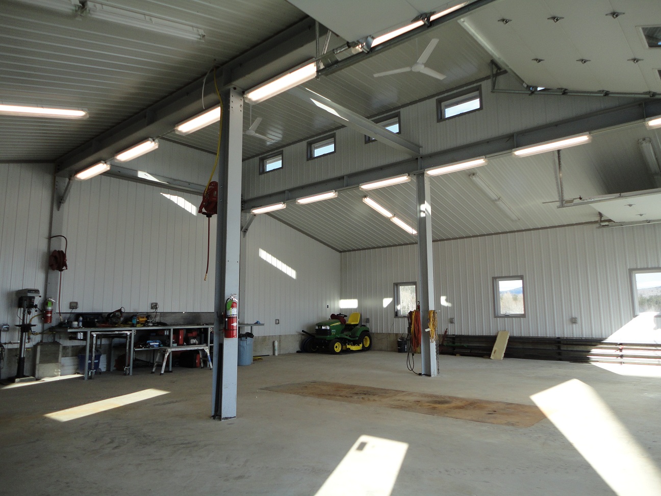

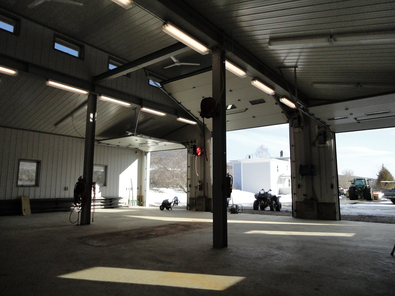

Thanks for all the replys, Im glad everyone thinks I did a good job planing it out. The insulation is working out great, I put my 10*F frozen 135C excavator in a week back and in 8 hours it was up to 70*F, once the door was shut you would have never known there was 30,000 lbs of ice cold steel in there.
As for the wall on the inside they will soon be all covered with steel siding, I will get some pictures up soon.

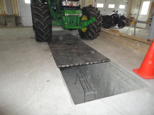

The pit has worked out great, When I dug the hole for the frost walls I dug one big hole and the floor of the pit is only8-10 inches below the wall footings. The pit floor was poured at the same time as the footings and the the walls were all poured second, back filled and compacted then the 9-10 inch floor was poured over the top of the pit to lock it all together. In the floor of the pit I have a 5 gallon pail in the concrete for a sump pump. I want to be able to pump it out. That way if I ever have an oil spill it wont be getting in my ground water.
I have built a small bridge crane on wheels to remove the pit lids.

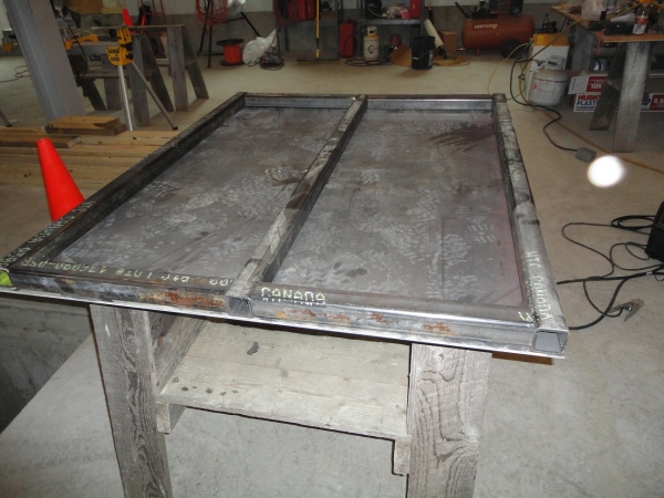

I was wondering how you handled that chore. Any pictures on the crane?
The bridge crane.

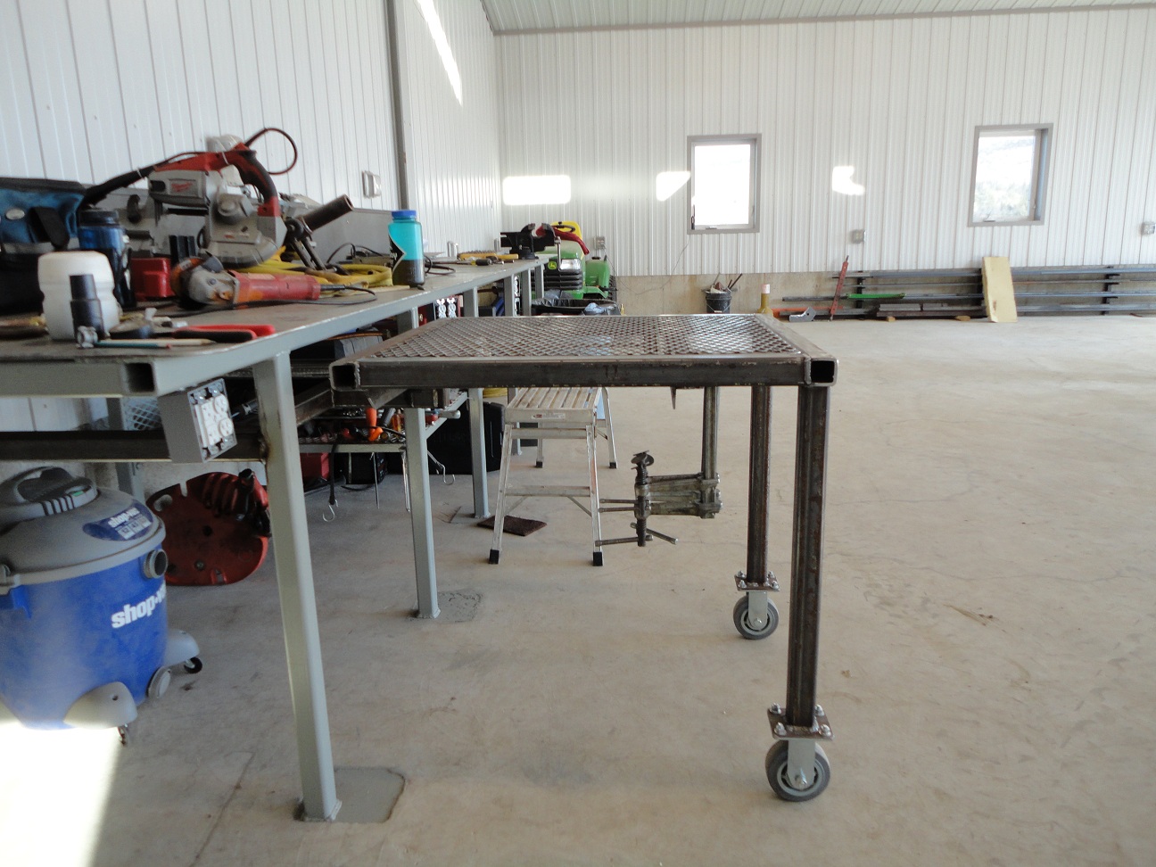

2x2x1/4 tube for the A frame 2x4x1/4 top cross tube and 2x2x1/4 angle for brace. 6 inch poly caster wheels rated for 750lbs each, 2500lb Warn ATV winch, truck battery and battery tender.
Started the bench today all the same size tube 2x2x1/4 with 1/4 inch plate for the top. welded to plates that were poured into the floor.

It cost a little more to build with the steel frame. The way I desigined my shop it would have had many more posts between the bays. With the steel frame I only have one post on each side in the middle and the building is much stronger. May put in a overhead cran system latter.
I have nothing bad to say about the steel frame, it worked and has come out just as I planned.

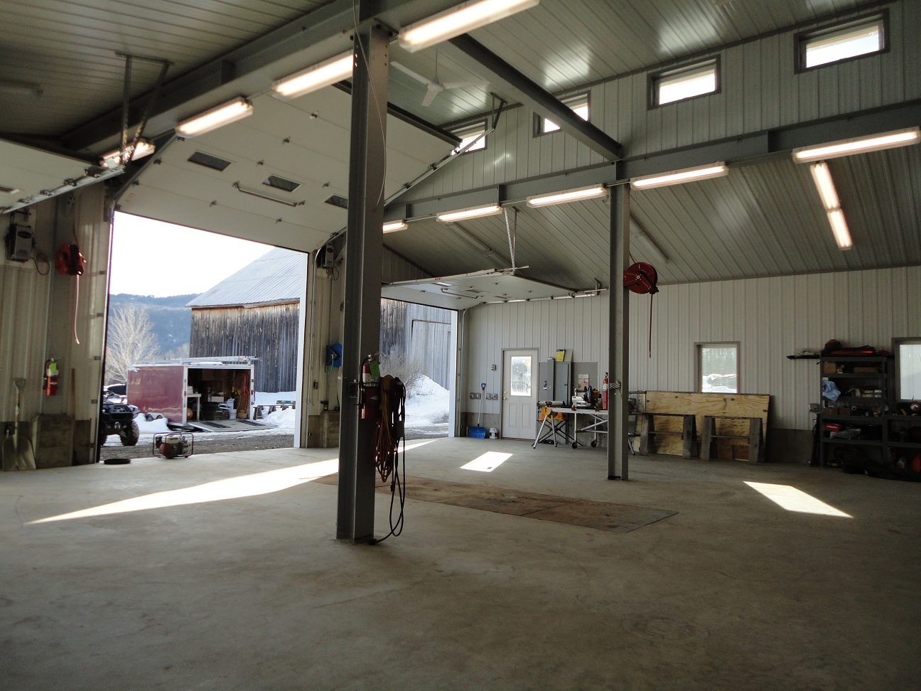

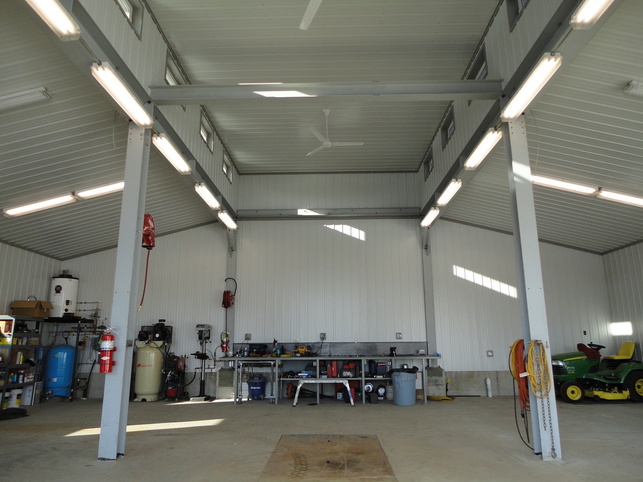

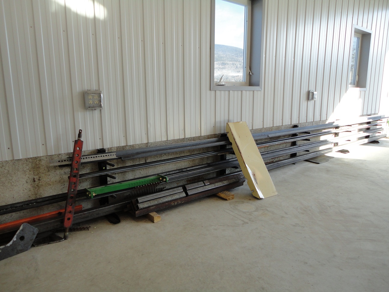

had a warm day and got the new shop all cleaned out.
Got the bench all done with a pull out welding table and racks for full lenght steel.

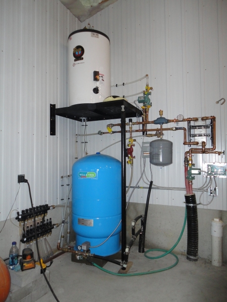

I would love a shop like that, nice job! What kind of wood boiler do you have and how much wood do you think you will burn. When I moved my garage in I had a pit all dug in and was forming it up, my house was being built at the same time. The plumber told me pits were illegal because fumes settle to the lowest part and can ignite if you cause a spark or use a trouble light in the pit so I filled it in. I still wish I had one though.
