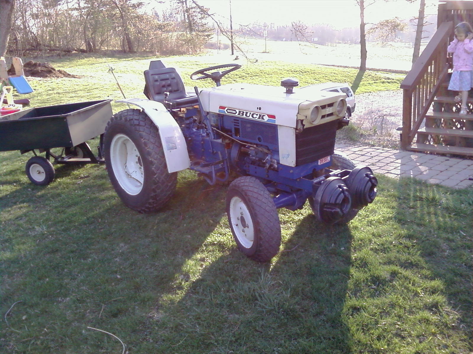

Seems to be running great since I pulled the thermostat. Run much cooler. I spray painted a couple parts with Ford blue engine enamel (the two mesh engine covers on the sides, air cleaner bracket and the front portion underneath the grill) -- I pulled off these parts and spray painted them to see how it matches. Looks really good, I should get some pictures up.
I do have to get a voltmeter and try to find out where I have that electrical drain. I have been pulling the battery cable when I park it, and it starts up just fine that way.

Update:
So far, I've painted a few more pieces with that blue Ford engine enamel, and the front axle.
Bought a new seat from Tractor supply. I'm in the process of trying to fabricate two seat springs to make the ride better, instead of the two rock hard rubber bushings that are there now.
I also bought a 5-foot rear scraper blade for snow removal, which has been great this winter in SW Pa.
After I got that, I bought some really nice rear ice/snow chains, and a got a front weight bracket..the place I bought the plow from just gave me the bracket from a scrap heap. Right now, I just put two wheel weights I had from my last lawn mower on there, until I get my hands on some suitcase weights. So it's pretty much unstoppable right now.
The headlights are still fried, and I haven't spent the time to find out where that electrical drain is coming from. I just pull the negative battery terminal when I park it...It's just fine that way. More pics to come of what it looks like after all this work.
It's been a fantastic little tractor, and adding that rear blade was a great addition. I have enjoyed it a lot.

Pictures as promised....sorry for the wait.
/ New S470d owner here #51
Looks good. I'll have to post some pics of mine. It'll make you feel good about yours. Mine's been rolled 3 separate times but none by me.
#52
Thanks! Somebody did smack into something with mine on the right side; probably a tree or post or something, but the hood still opens OK. Yeah, I would bet three rolls wouldn't be too good for the sheet metal. :D
There's always a to-do list for these, isn't there?
So far, I still need to:
Fix the battery drain problem. I still have to pull the negative battery cable when I park it, or it won't start up for me.
Fix the headlights. After it overheated, the headlights didn't work. They were very dim before that.
Seat springs. I have these awfully hard rubber bushings on the seat, and it's like have zero suspension at all on the seat. I think the original seat was pretty much the same way. My yard's kinda rough, so some seat springs would go a long way.
A replacement emblem would be cool. Looks like that got smashed when they hit whatever they hit on the front end side. Maybe I can find a mitsubishi one that might fit.
So, I just need time to fix all that stuff....which I haven't got.

The headlight problem might be as simple as cleaning up the contacts. Mine has some corrosion and one is dim now. There was a post here or on the club on yahoo about a replacement mitsubishi emblem from a car in a junk yard.
