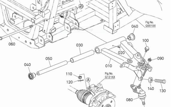

Nylon lasts well. That's what bushings are made of on most similar vehicles (Polaris, etc).
So you can turn down on a lathe 8 new nylon a-arm bushings in a couple hours and rebuild a RTV rear suspension? Impressive.

PapaPerk, anyone that sees this as a 'rebuilding a RTV suspension' probably ought not to try it. If bushings are defective (ID/OD) they should be replaced obviously, and as soon as the company or dealer can provide them. Kubota doesn't seem to be rushing to admit there is a problem, perhaps lost somewhere between an engineers view of parts/pieces and a consumer's measure of perfection.
btw: Say an hour planning (dimensions, parts count), another to drive to a supplier if I don't have the nylon, and an hour to drill, turn, & part-off 8 or 16 or however many needed. I'd expect another hour or two to assemble and admit I'd have to compare the time/effort spent to waiting for a dealer to get help from a maker, hauling, etc. Easily doable for me and some others, but probably overkill.
If I could 'give the guys' anything I hope it'd be the inspiration to consider doing what they might do themselves, esp if it's a simple matter of shimming out some slop. Stacking rings on a stick isn't for everybody, but the pictures and parts above don't make servicing look too complicated. Nylon washers are available from Grainger or other supply houses if not the hardware store.
I'd hate to think that a guy who can mount tool-boxes, lights, or hitches to a vehicle wouldn't fix this better anyway than those who are dodging it thus far or waiting on someone else further removed from the individual situation. Meanwhile, I'm starting to hope warranties will outlive owners just in case ... well, you know ... stuff happens ... and not everyone is 'handy'. :confused3:
There is no 'perfect' or 'forever' in 'new' but there can always be an 'ew' if you know how to look at something the right way. ;)

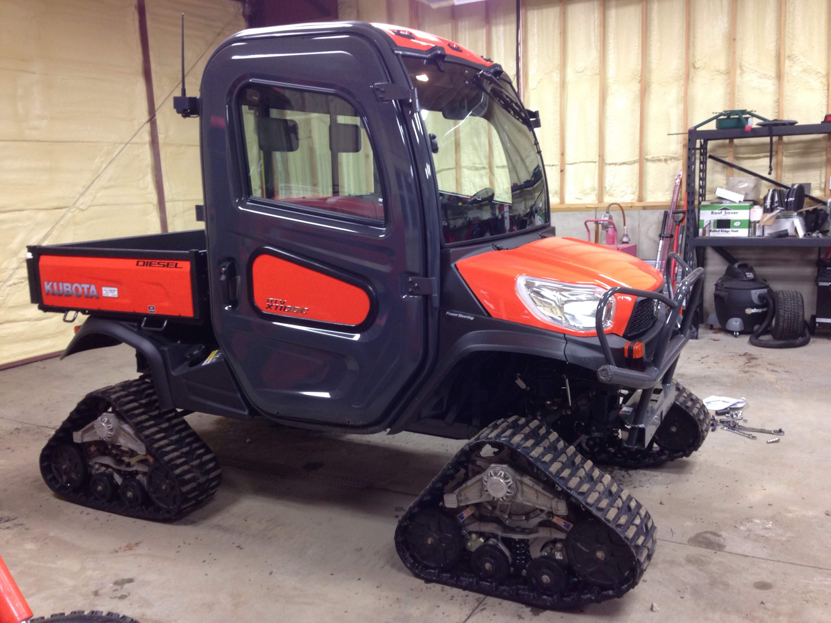

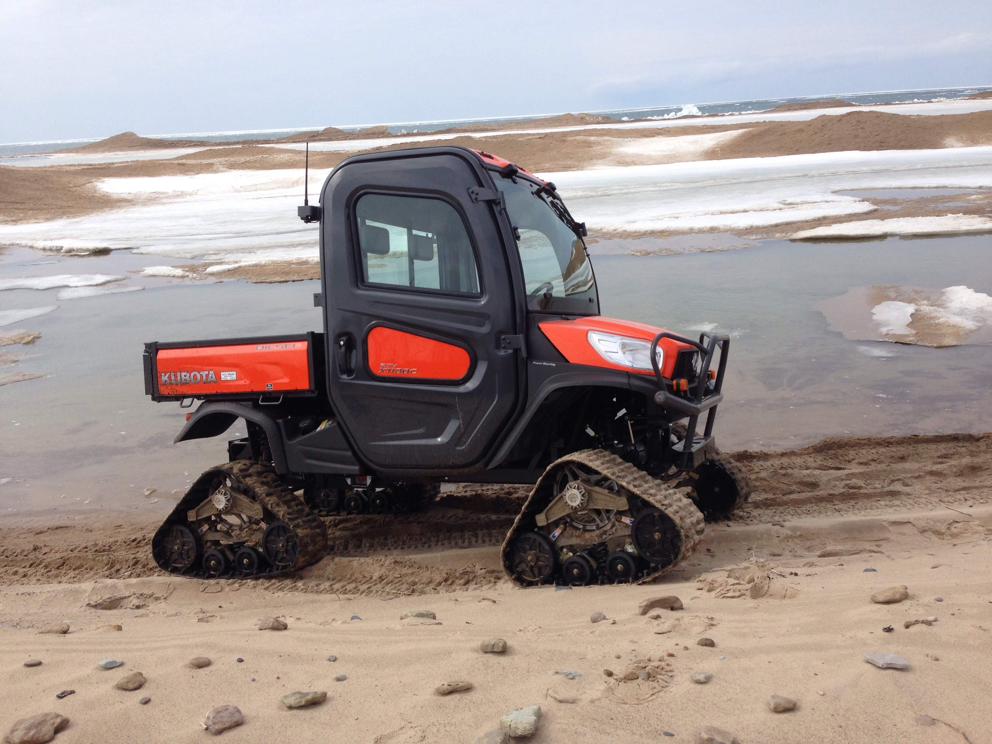

Just put the tracks on my machine we will see if it holds up. It seem better then my old 900!

The RTV1100's suspension doesn't look that complicated compared to a car or truck, tho' I did assume that things wouldn't be rusted up and difficult to deal with on a fairly new machine.
I wonder if any play between parts #40 could be reduced by adding shims (nylon washers?) onto #60 to contain the control arm's excess movement, tho' maybe that's not what the issue is. :confused:
btw: I don't buy that 'play' is intentional for the sake of CV joints. There's no way to assure which end of motion the pieces would be in when turning the wheels, and up/down action seems to be handled ok at both ends of the vehicle without such accommodations.
