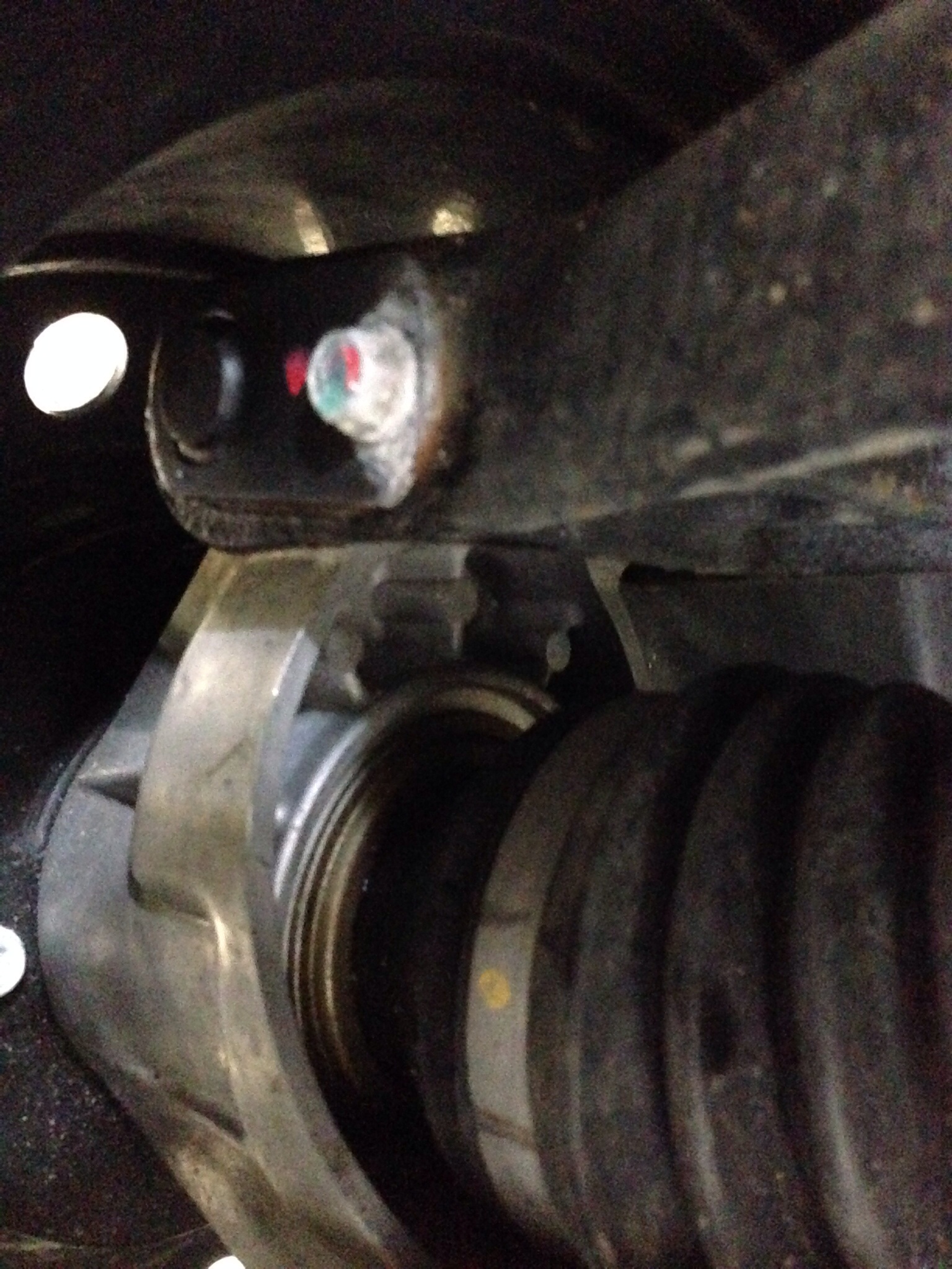

I tried looking up parts diagram but I'm on an apple..so couldn't look. what is exactly back there at the hub/transaxle connection that could have that much play?
   / New RTV-X1100C clunking wheel noises. #57
image.jpgHere you go it's the aluminum housing that has all the play were it is mounted top and bottom.
This is for the rear wheel play.
