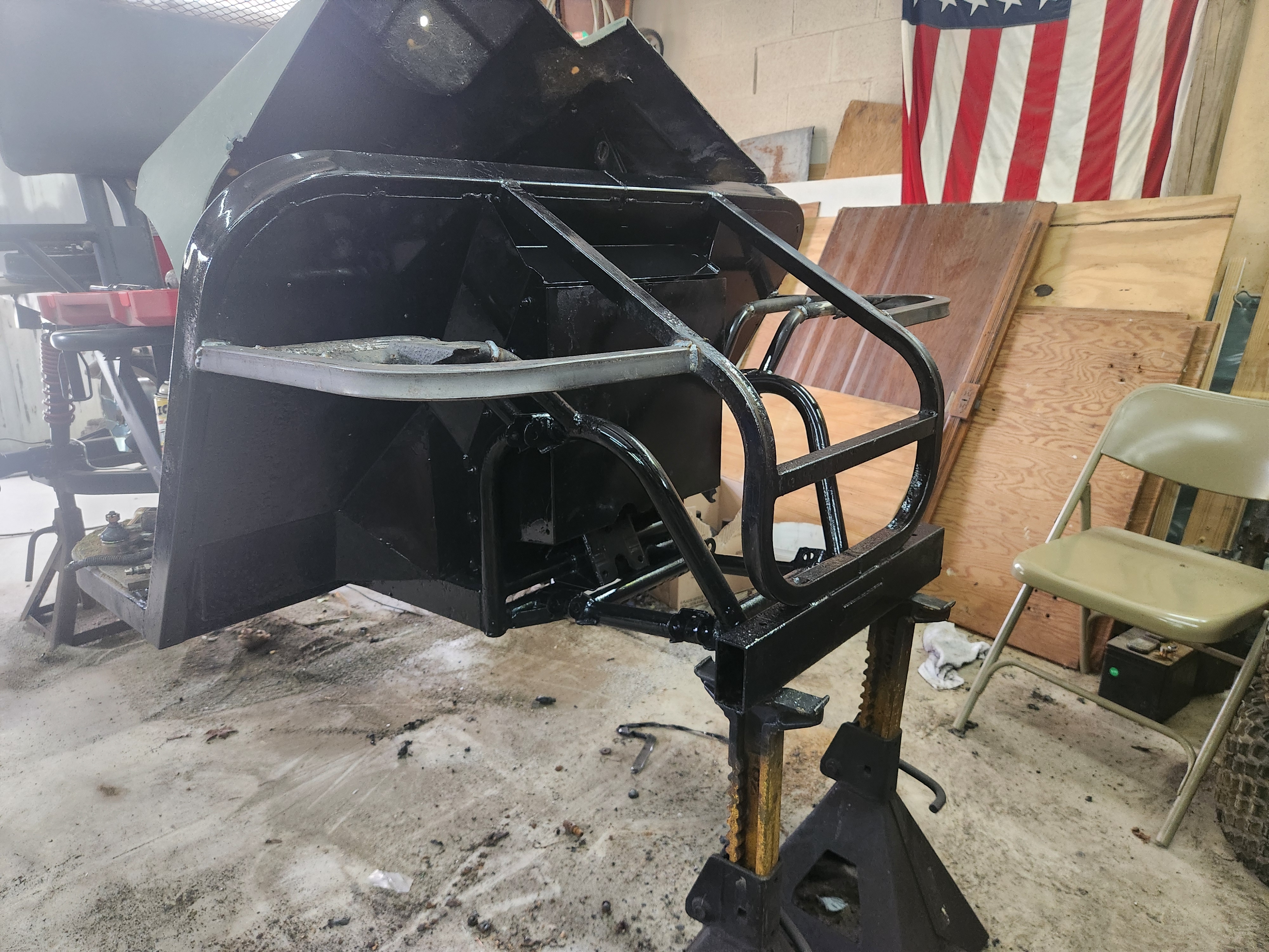

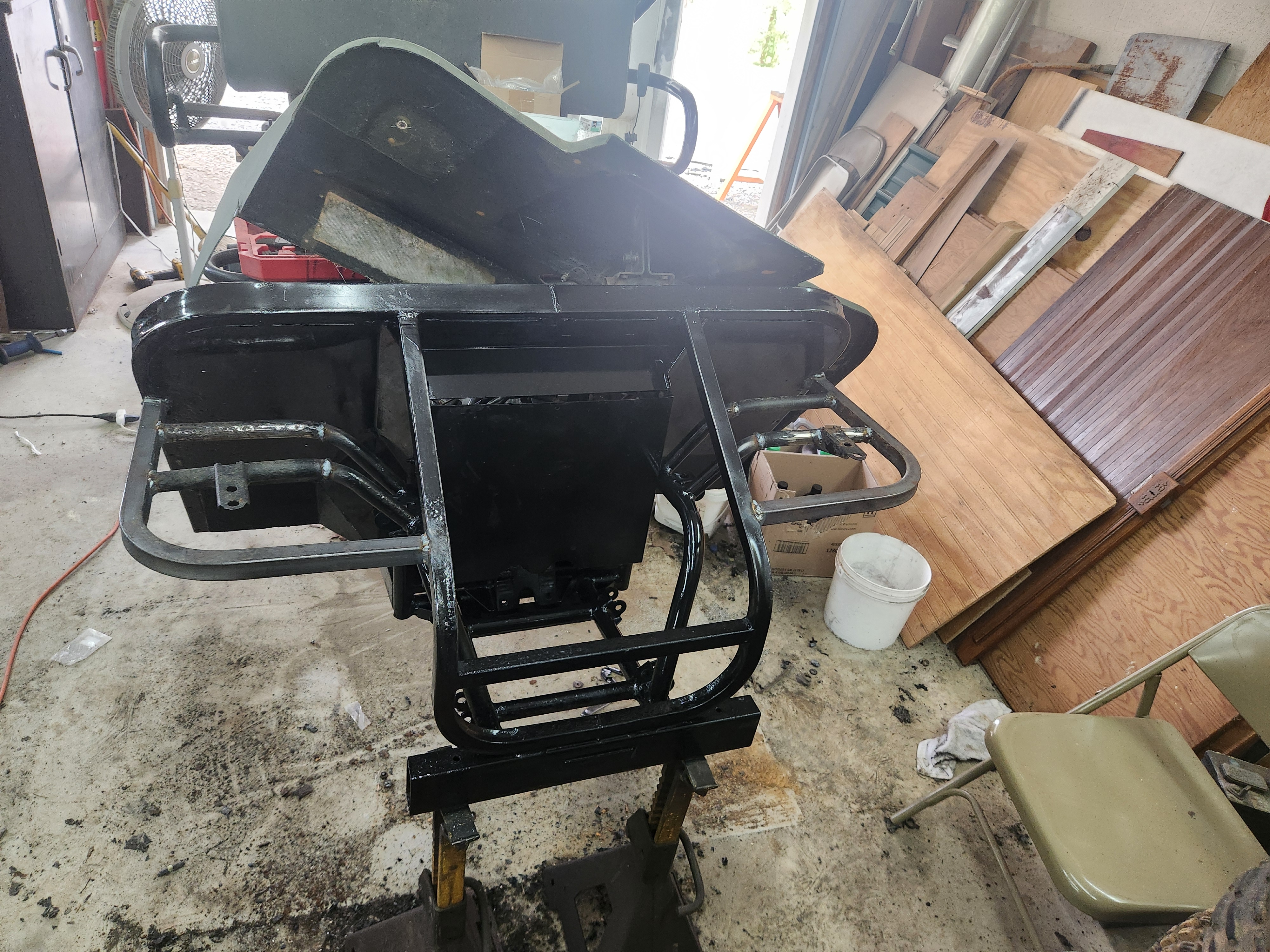

I started preparing the plastic to go back on the Mule, it is rough and going to take some time.
This model is my least favorite of all of them, because of the front end. The headlights look like an afterthought!
Someone started fiberglassing the backside of the dash, Im sure they were trying to stabilize it.

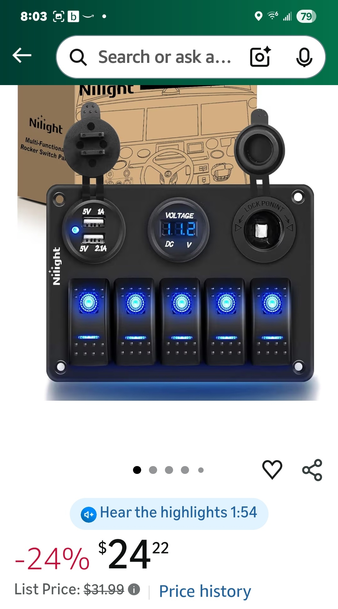

I think I finally figured it out! The first one is the brake light switch, I found a decent pic in a parts catalog, the second one almost has to be the headlight switch.
Im thinking that I will add this to the dash, so that will eliminate any old wiring and the old switches, the headlight wires are missing anyway so I think this will be the solution.

GRS, Im not quite sure how I will handle the plastic.
I have some headlights that I would like to use but they will require some cutting and plastic welding and I have never tried that before.
The small scratches should sand out ok the cracks will require stabilization.
I bought this from Amazon, it embeds a wire in the plastic, Ill place the wires in the cracks and figure it out from there.

Sandman, I agree 100%, I have been researching the plastic, looks like my plastic is hdpe and the other hood is abs, so that isn't going to work. I need to get some hdpe and see if I can make a repair!

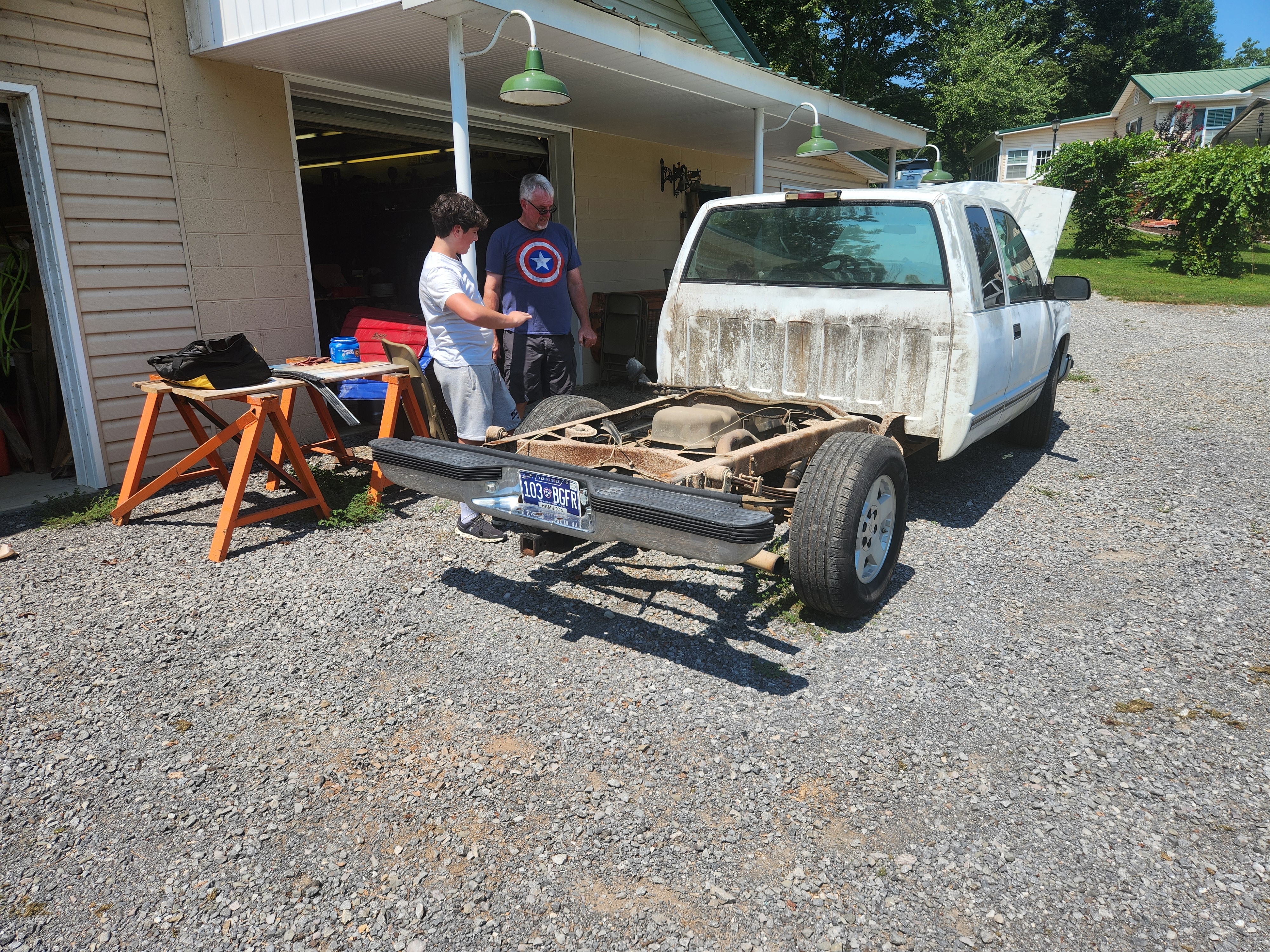

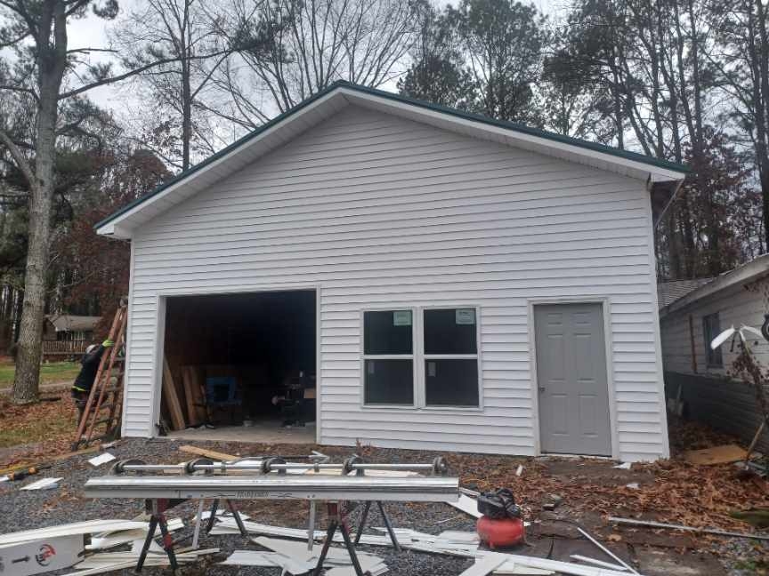

Got sidetracked again, trying to help the bil get his shop closed in.
/ Kawasaki Mule rebuild! #92
Is there a second story to that building? Seems odd to not have a taller door with all that wall space there.
#93
There will be a four post lift inside the overhead door.
There is a loft above half of it. Inside the room will be a trophy shop. This tall bay will be for 50 years of memorabilia.
And his show car. It will live on the lift, he is looking for a Nova to live under it.

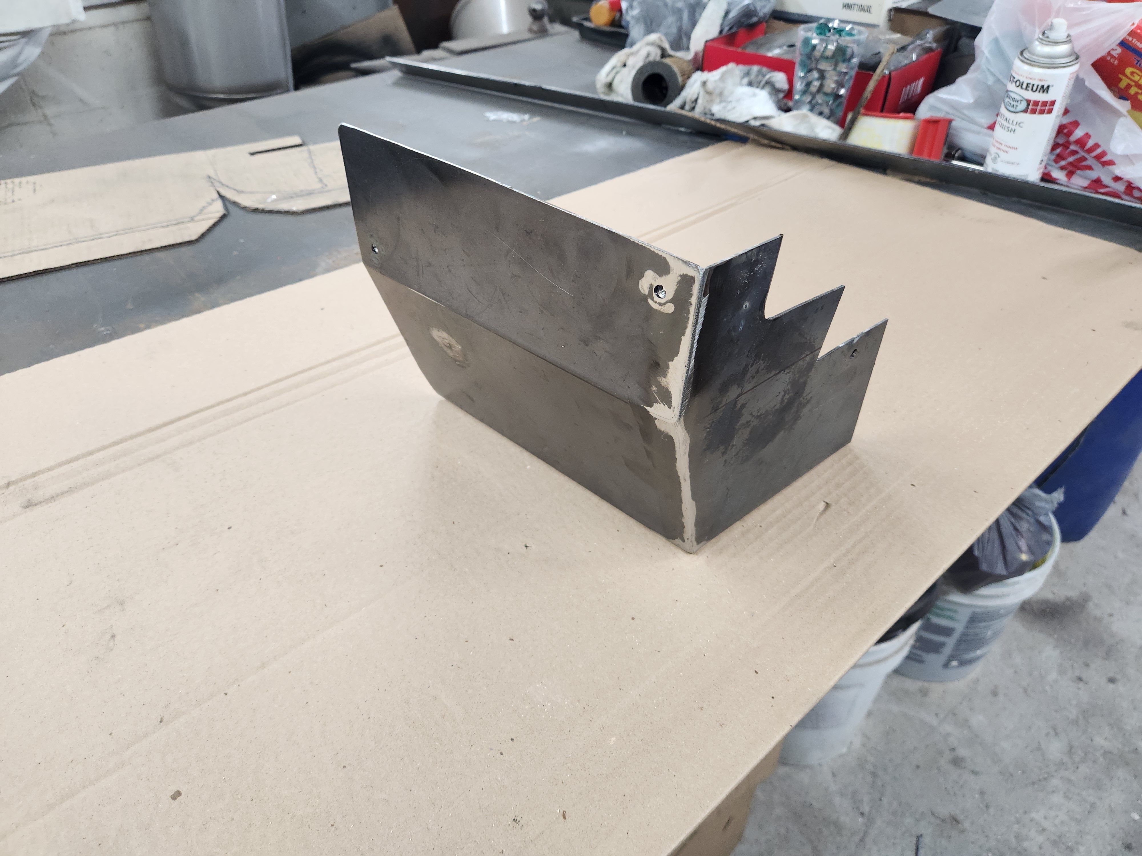

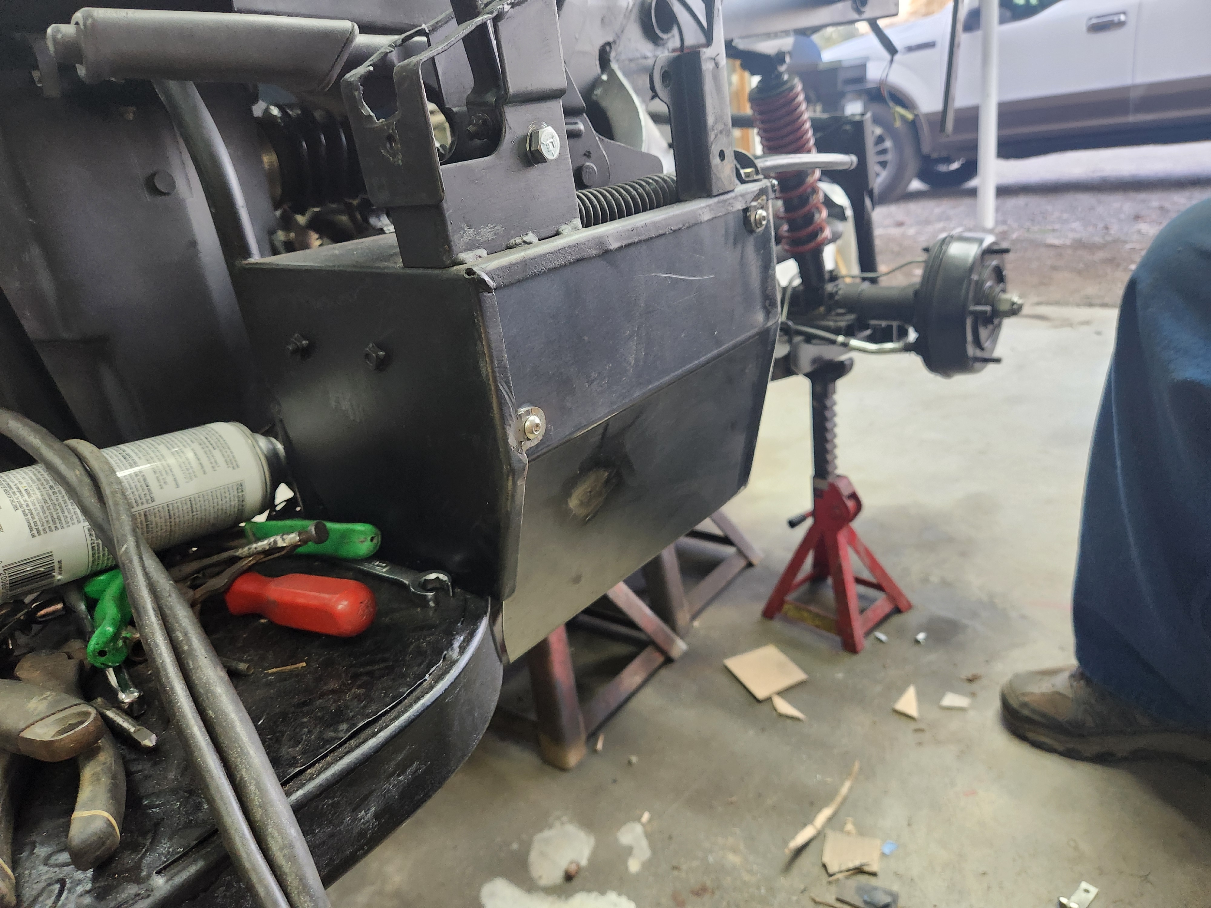

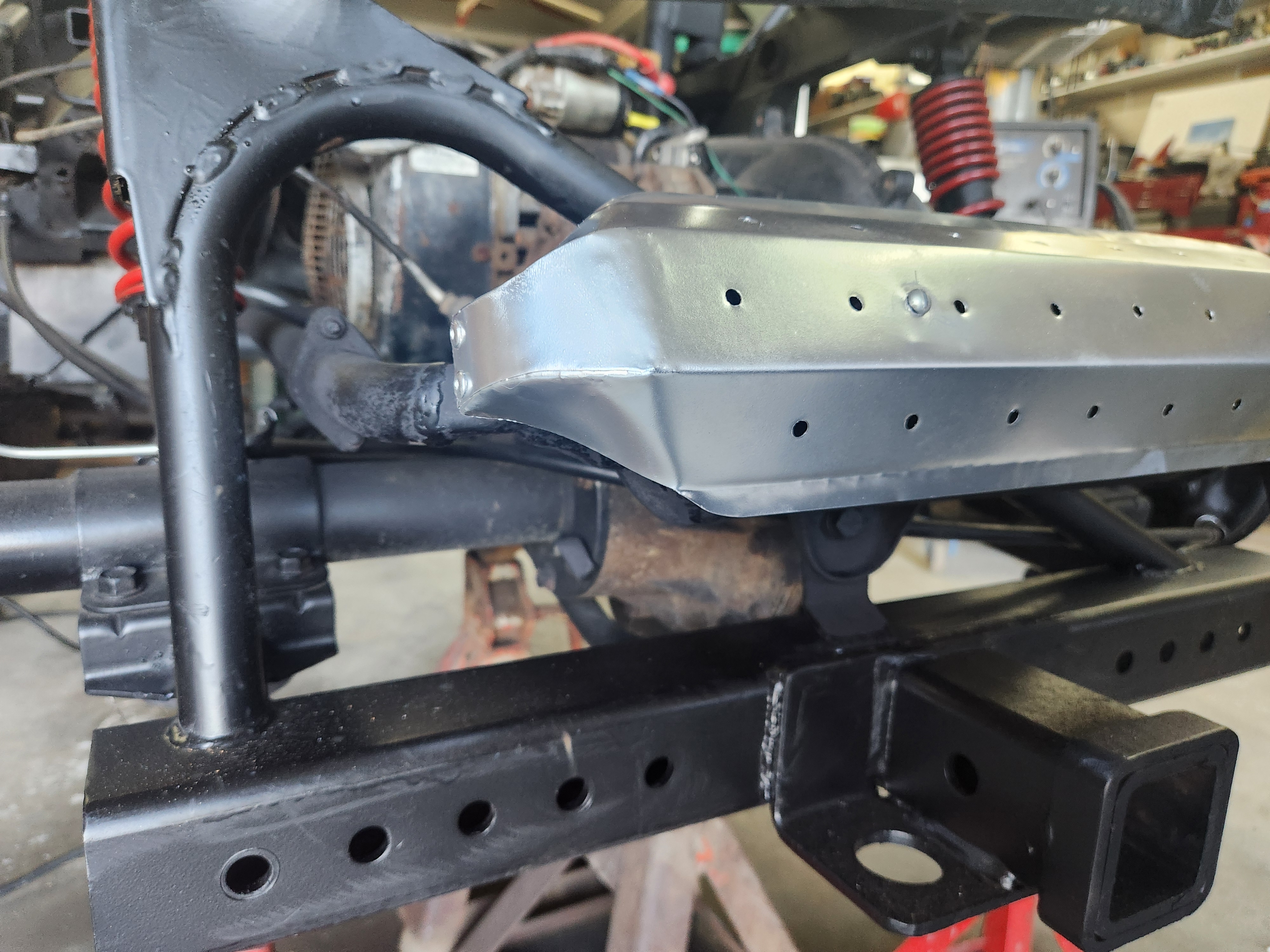

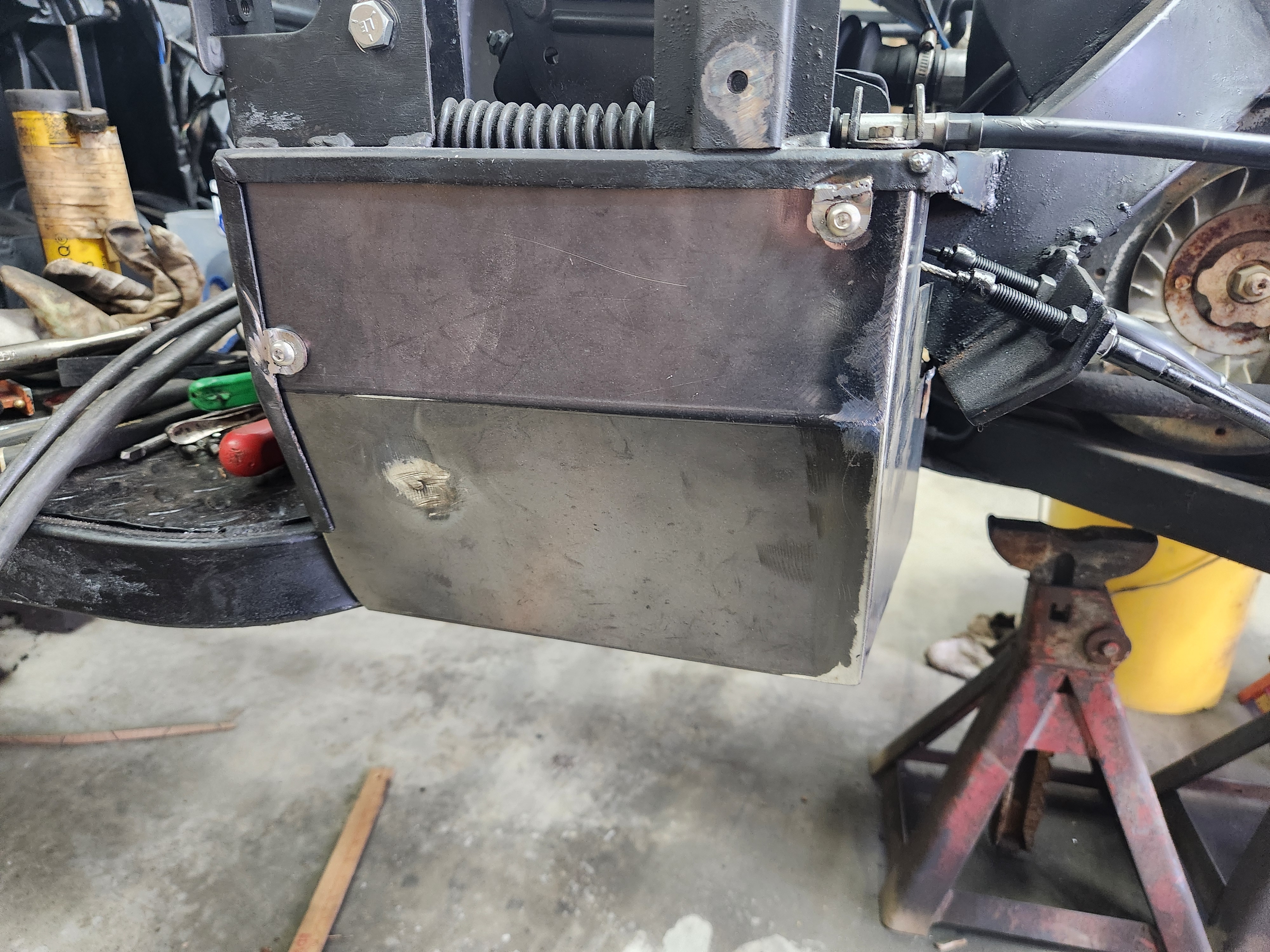

I finally got over the covid enough to get outside today. So I got the battery box cover finished! Its funny that the factory didnt make one, but back then it was a utility vehicle not a luxury ride like they are now.
First I modified my original CAD design, Cardboard Aided Design!
I added 2" to the bottom of the box.
I cut out a piece of metal, then!
I got busy and forgot to take more pics.
But anyway, after some trimming, bending and a little hammering, this is how it looks.
I welded some nuts on the inside.
Then I made some bolt tabs and welded them to the mule.
I had some stainless steel button head screws. I had to trim them down, they were 1¼" long, I cut them to about ¾".
now you can see why I added two inches to the bottom of the cover, it now lines up with the frame rail better.
I keep a smoker in my shop, so I got to make part of supper today! Lol.

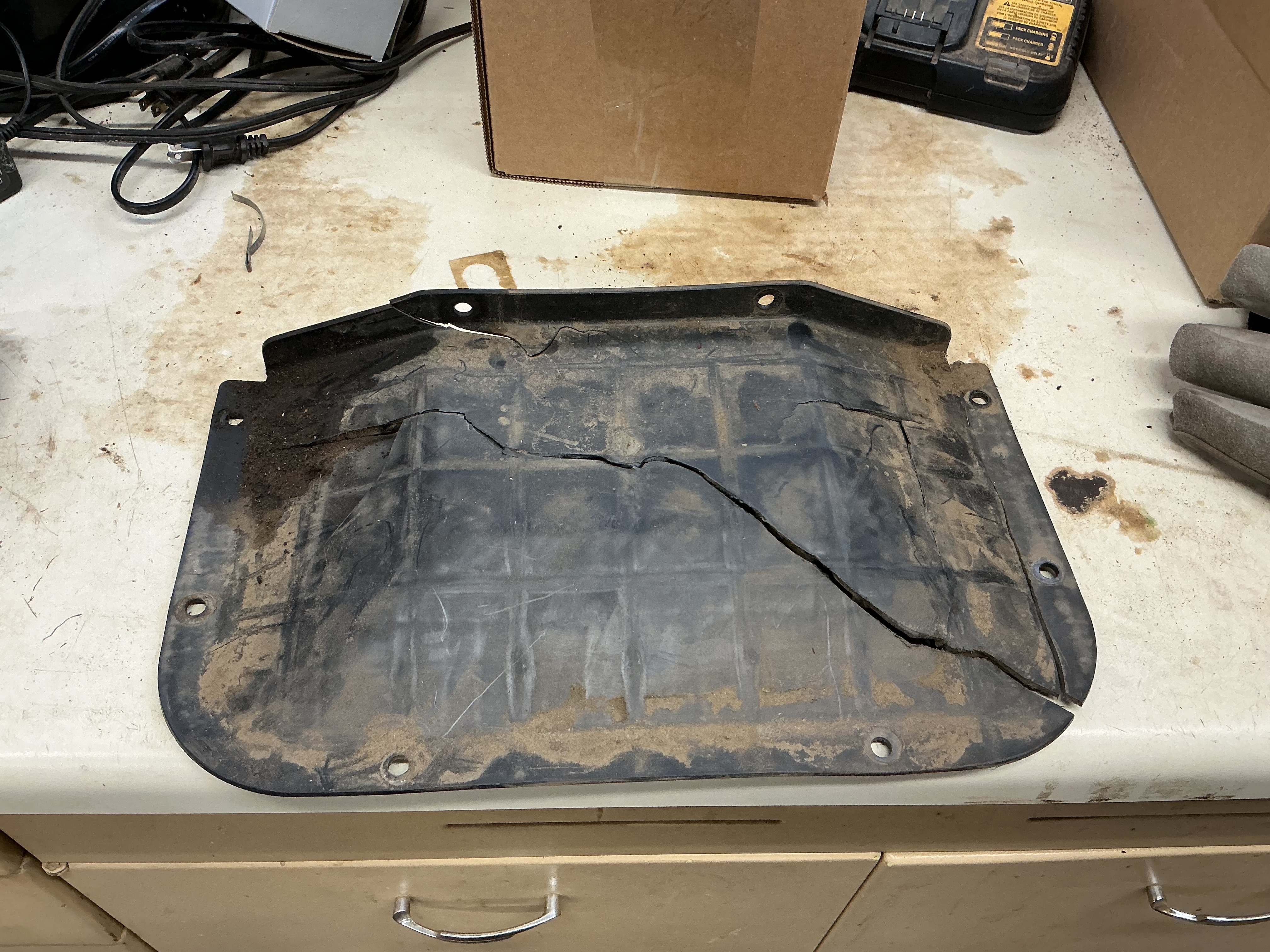

You have way more dedication to complete a project than i seem to have. I need to fab up a simple steel cover to replace the POC plastic access cover that Kioti uses on the floor of my cab tractor over transmission. Ice cracked this cover 2 times since owning tractor. I was all ready to make a steel one, but lazied out and ordered a new one from Kioti. Only $17, but its the idea, as it should be steel.
