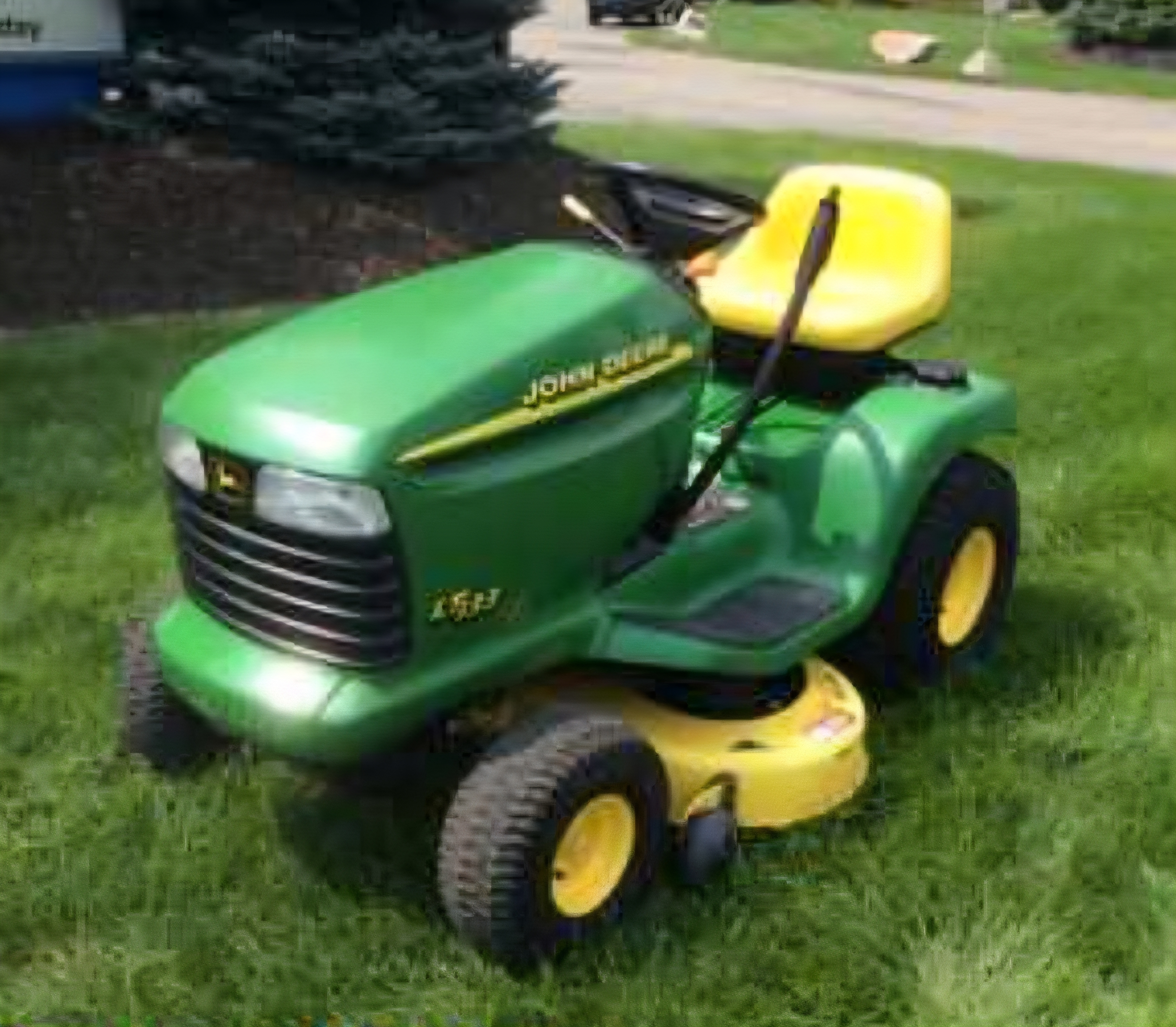

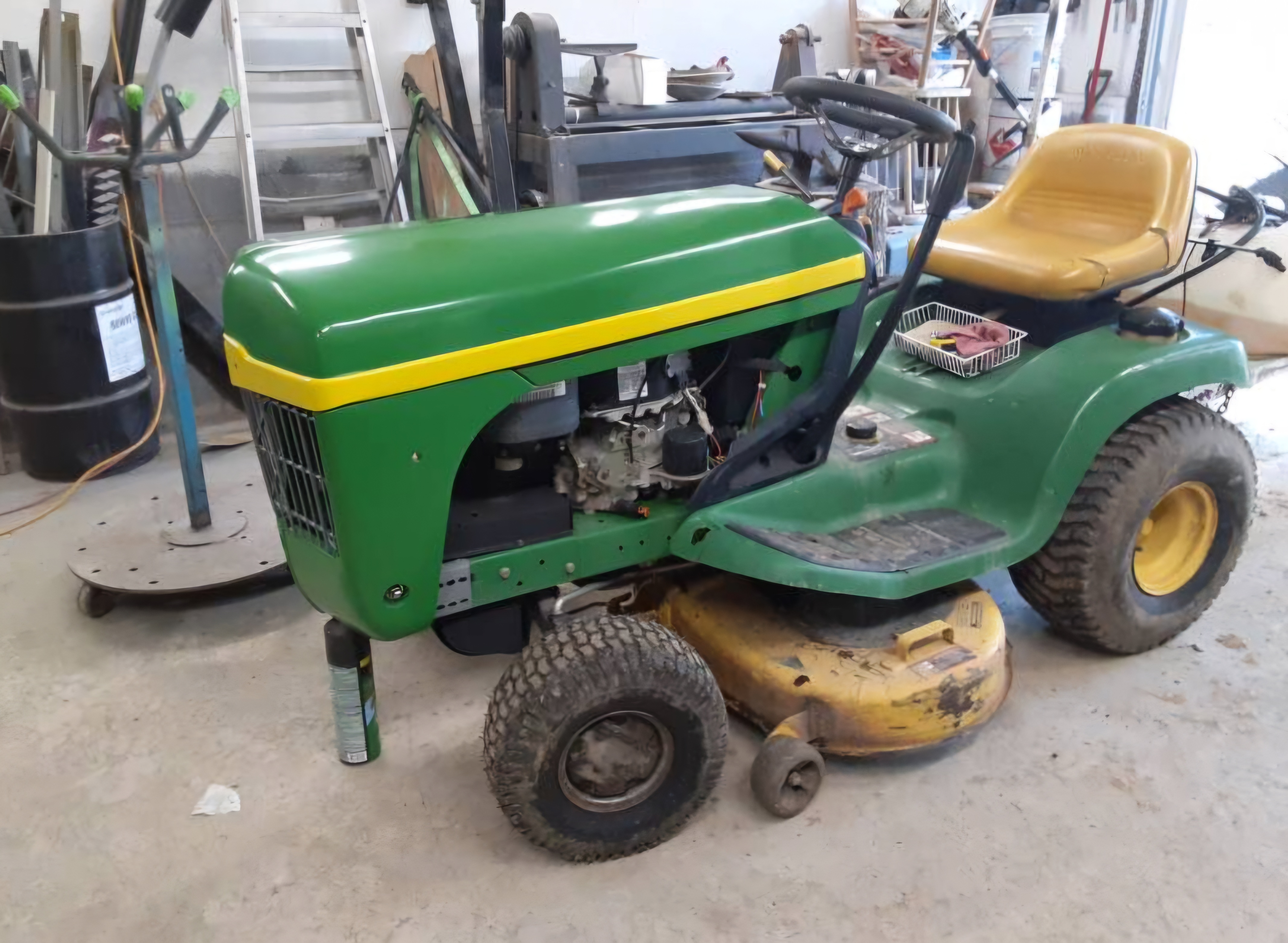

I get pretty serious! This is a 2000 JD LT133, it had that lousy plastic hood, it broke three times, so I tossed it and built this hood myself. It came off of a 1955 Massey Ferguson TO35, I chopped and channeled it to fit, its almost half scale from stock. I built the hood about 10 years ago, Im going to repaint the tractor with Ferguson colors and badge it as a John Ferguson! I can't help it.

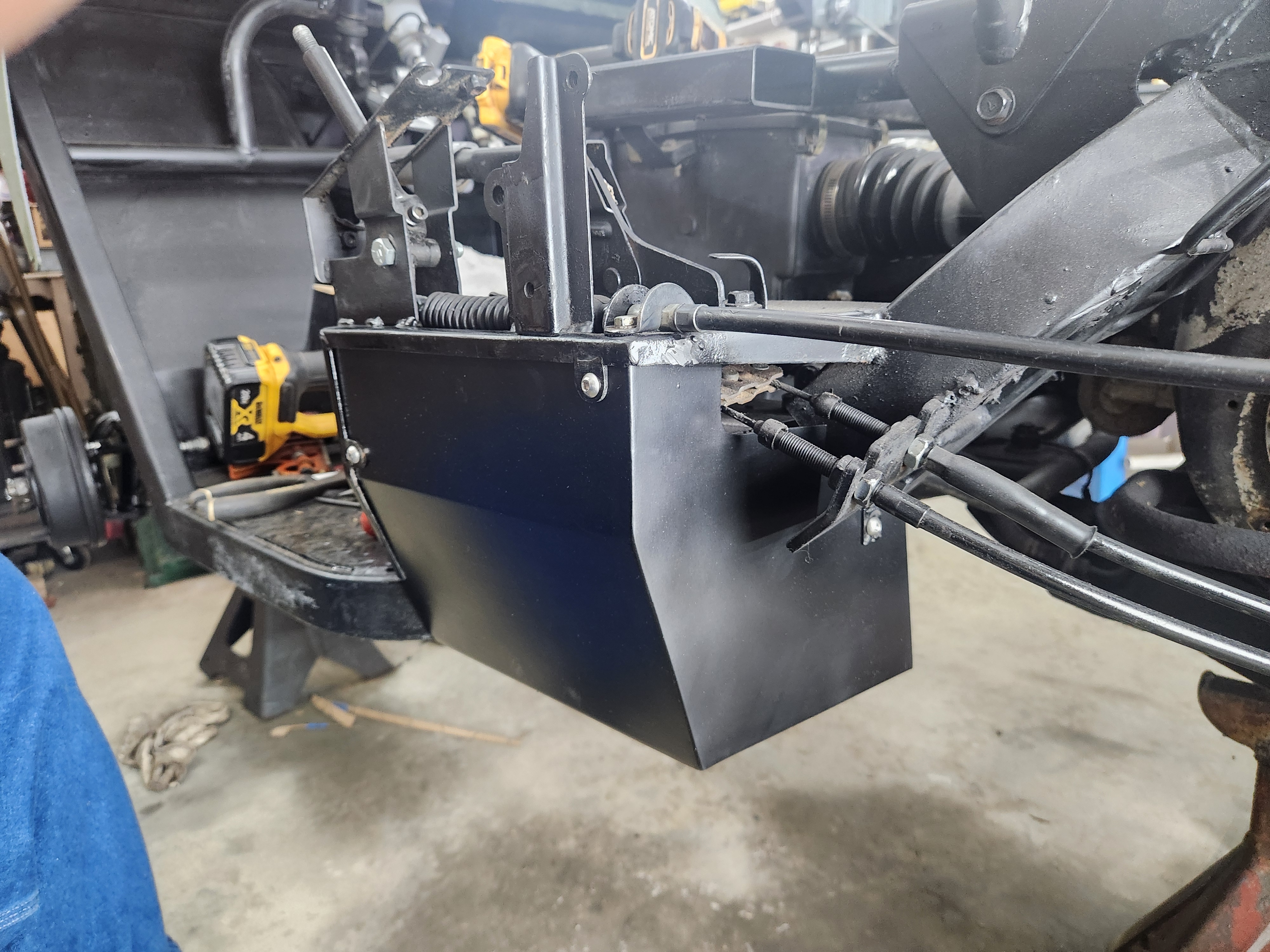

On my 2012 mule, battery is under seat. No box needed
Sorry, I didnt respond earlier! Somehow I missed your post.
My other utv has the battery under the seat also, it dose make better sence.

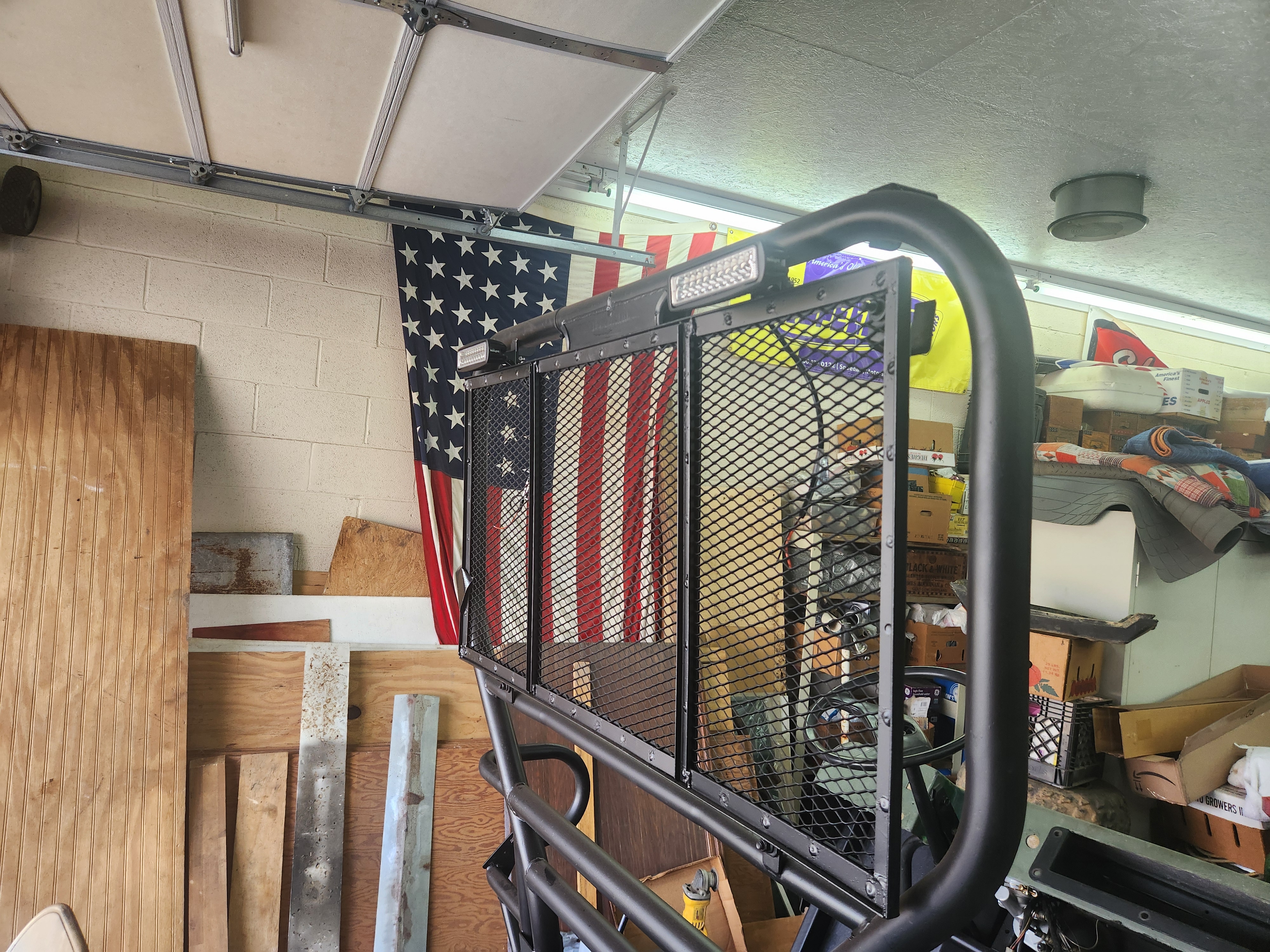

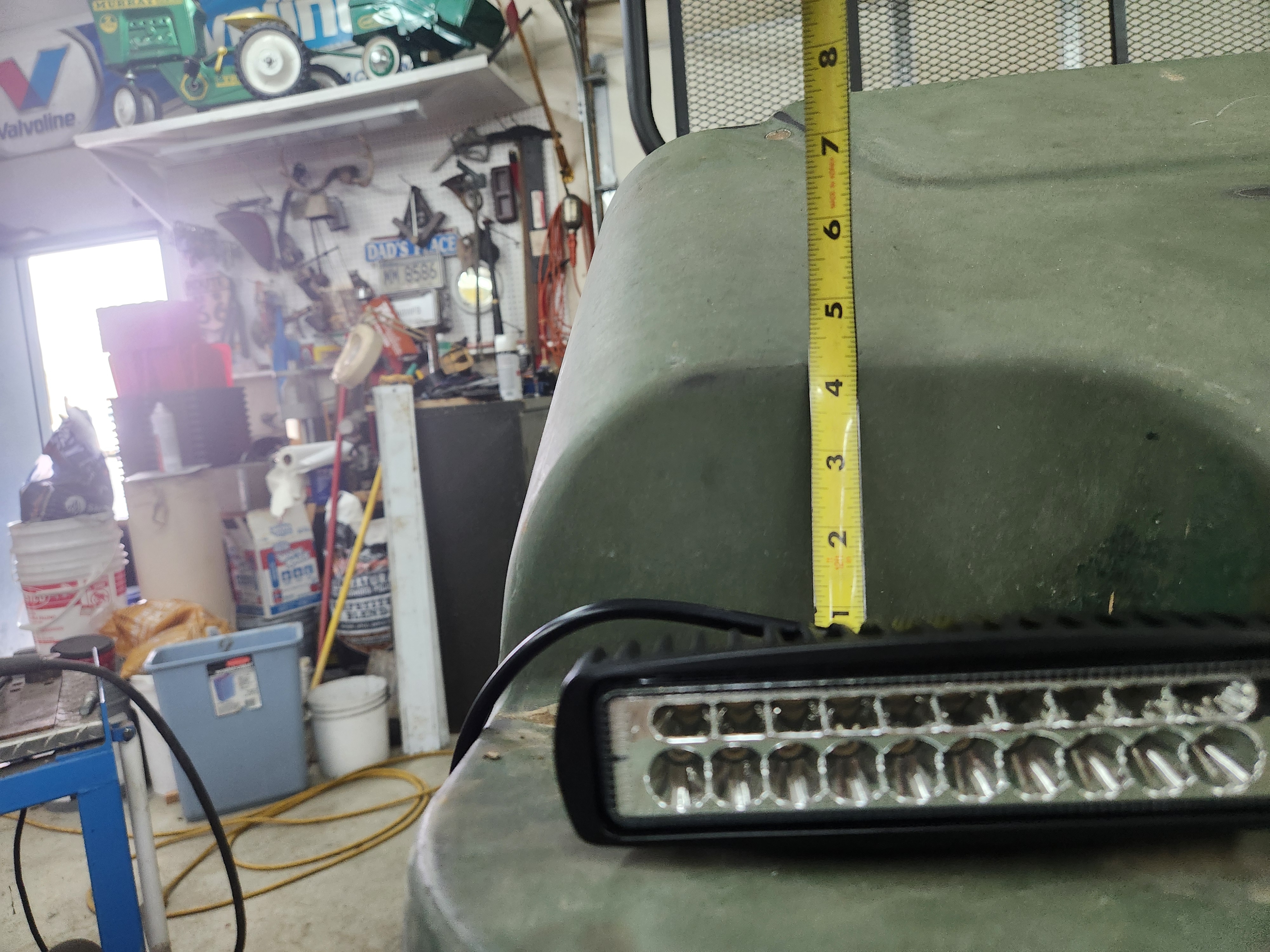

I bought these a while back thinking they would look better than the round lights. They are way too short.

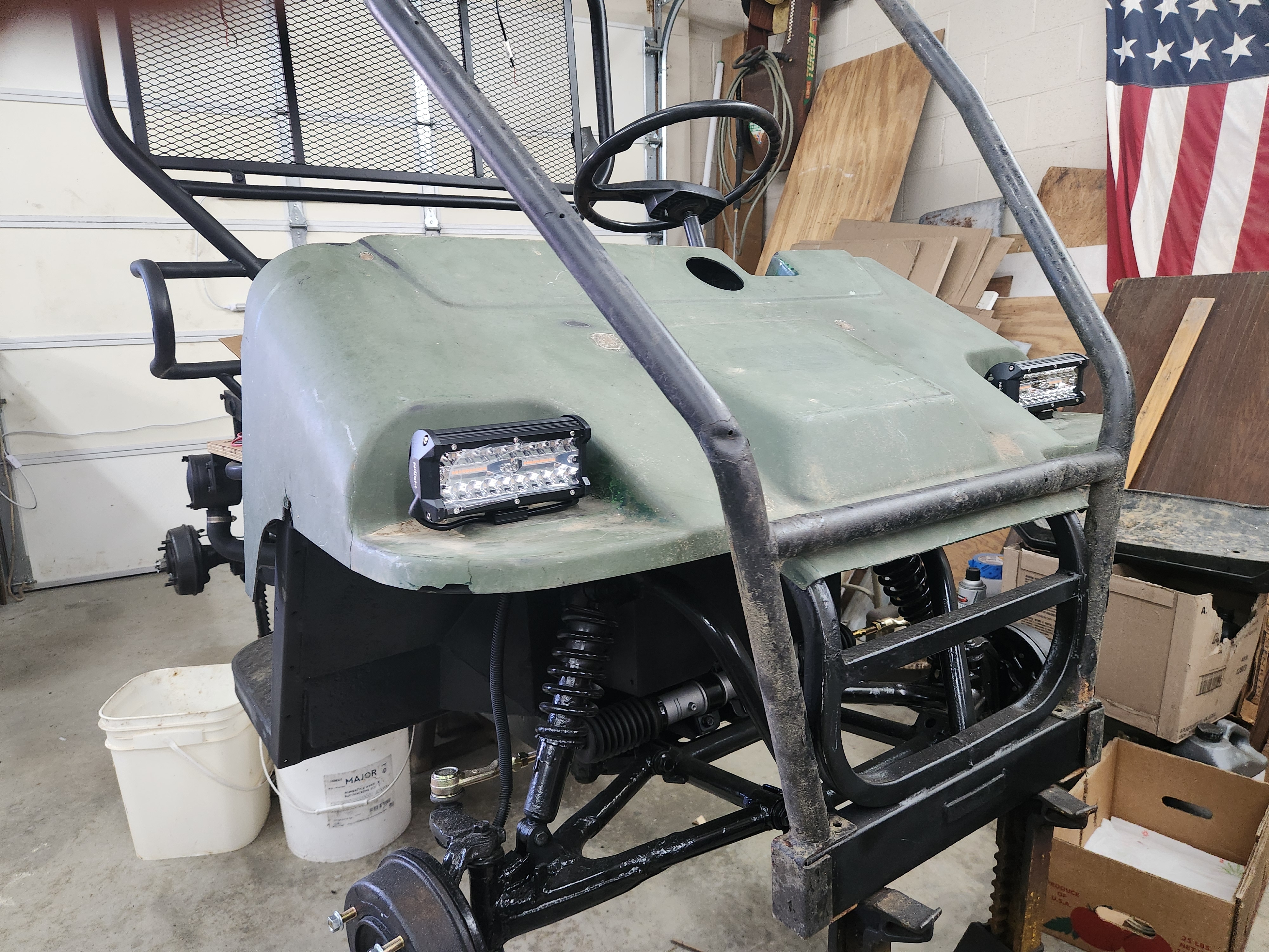

So I got theses coming.
The thin ones look better back here!

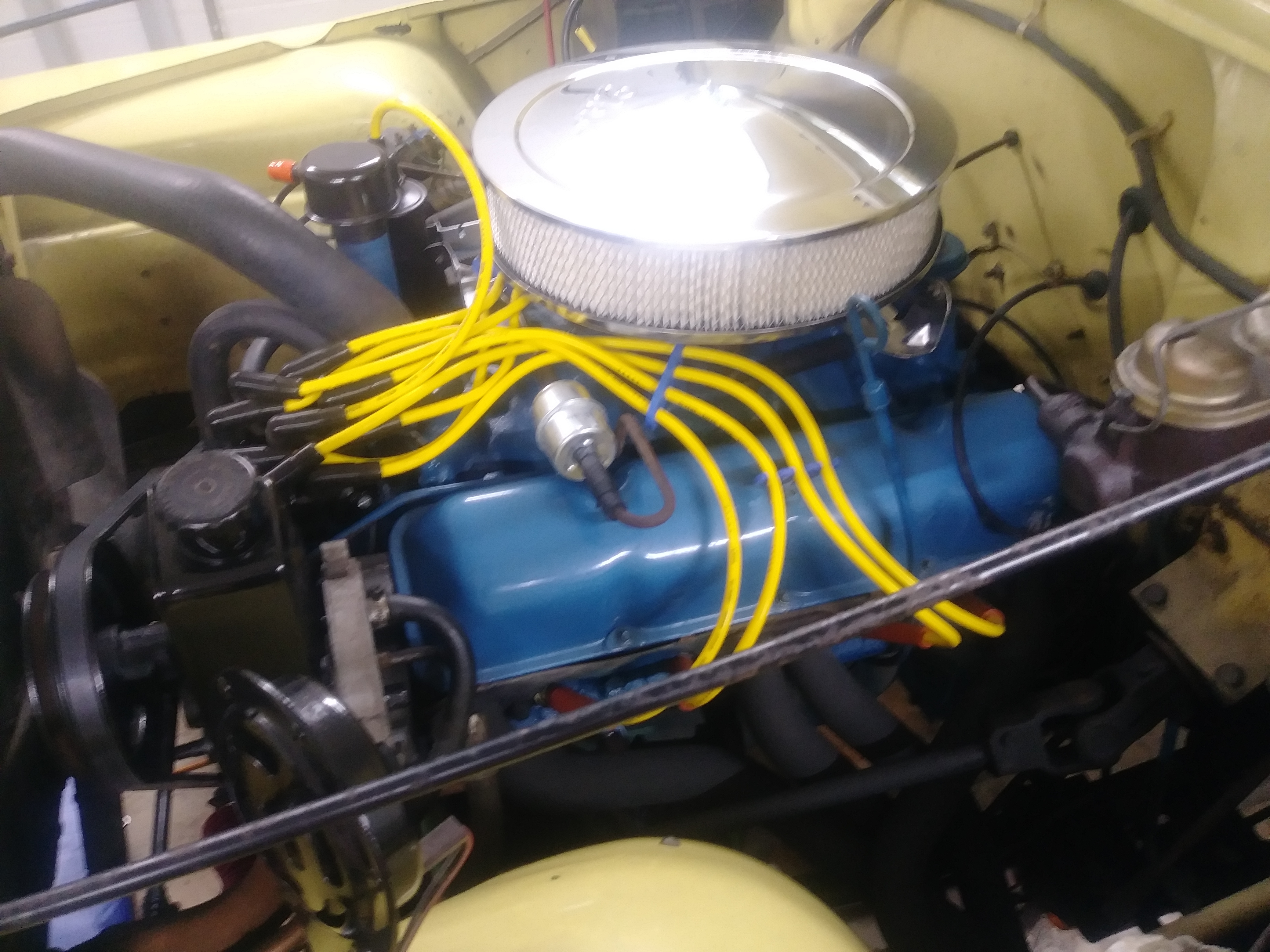

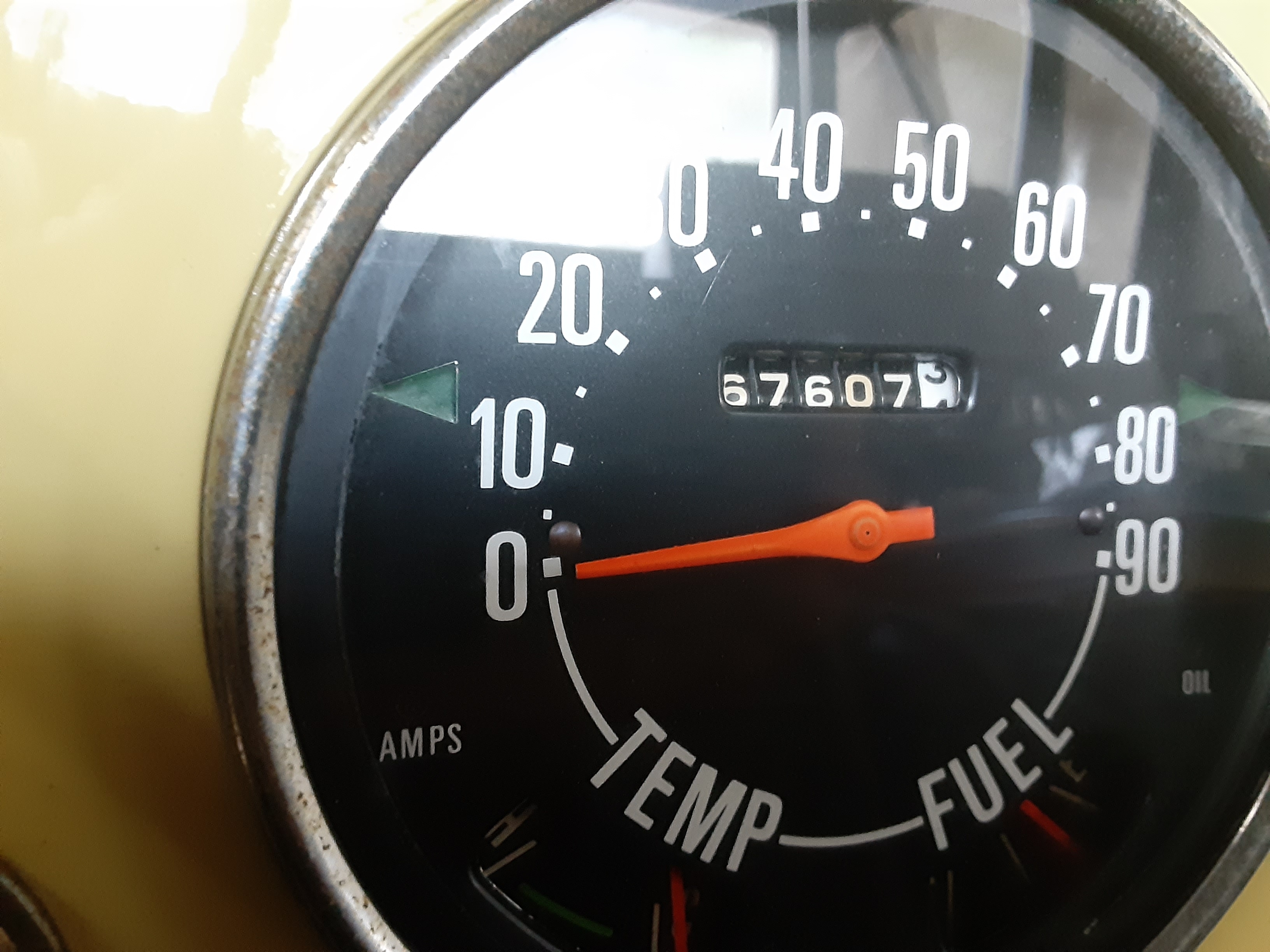

My first vehicle was a 1973 CJ5 and you just reminded me of replacing all the gauges and fabricating a new dashboard for it. That was one of those projects that I did as a kid that I was really proud of.
   / Kawasaki Mule rebuild! #113
I once owned a CJ5 with Mickey Thompson Dirt Dog tires. It was the most unstable vehicle I ever owned. It would spin like a top on snowy roads.
I once took it across a field with deep snow and got it stuck. I had to go out with my 1954 Jeep wagon to retrieve it :oops:
#114
We just sold our 73, It was a rust free vehicle. The original owner bought it to pull behind his motor home, it sat in an airplane hanger for over 20 years. We were the third owners of it, the second owner( owned it for six months)put it in a ditch and skewed the frame, causing it to not steer at 35mph, it was kind of like a death wobble but not as violent. I had a buddy put it on his frame machine and pull the right frame rail forward 3/4" and that fixed it. I nuilt it for Pat but I got old and couldn't get in and out of it so she said to sell it. I bought her a 93 chevy Z71 that Im going to start on after the Mule.

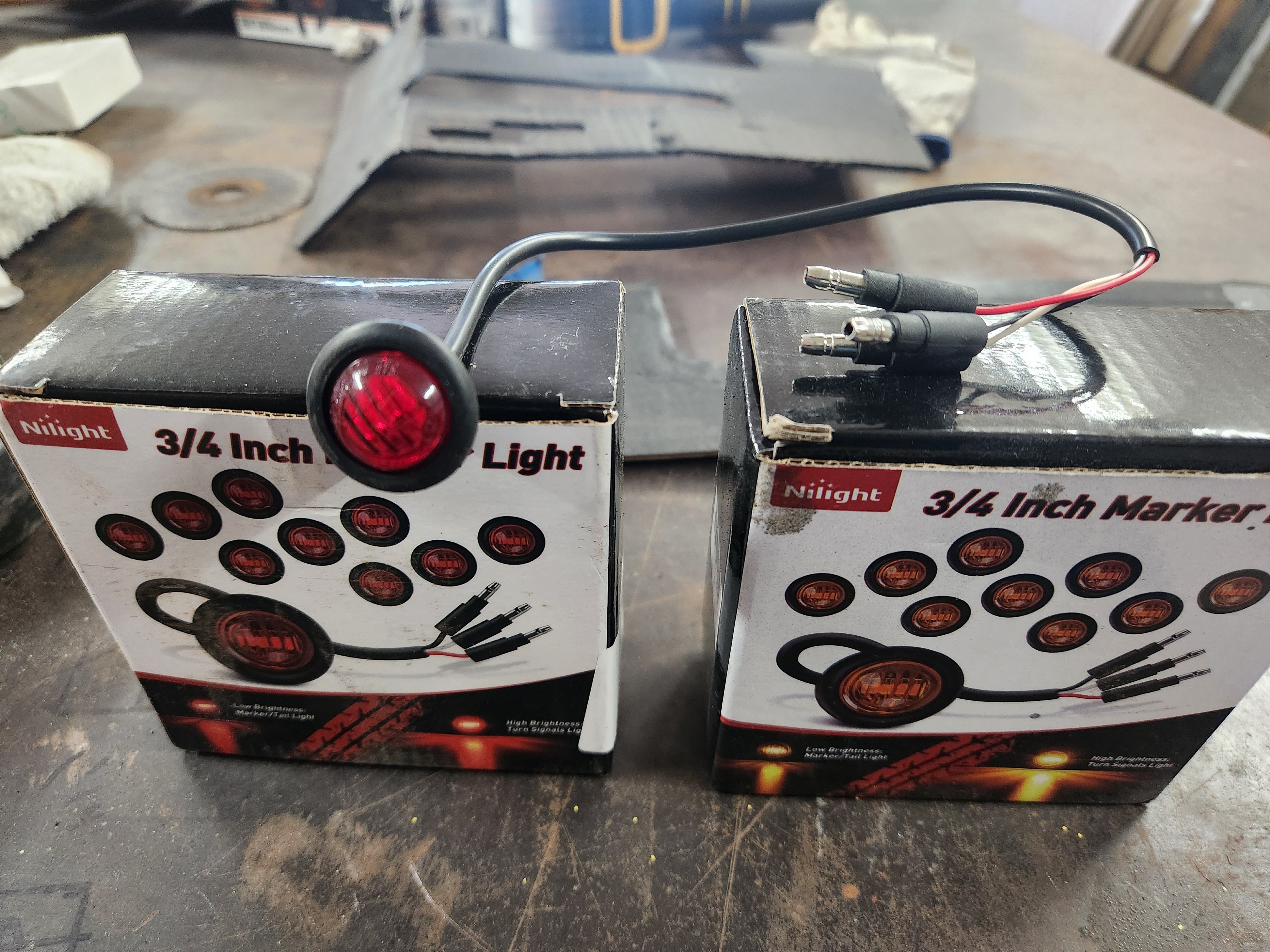

Got the new headlights yesterday.
Im going to put this in the dash also as a park brake engaged lamp.

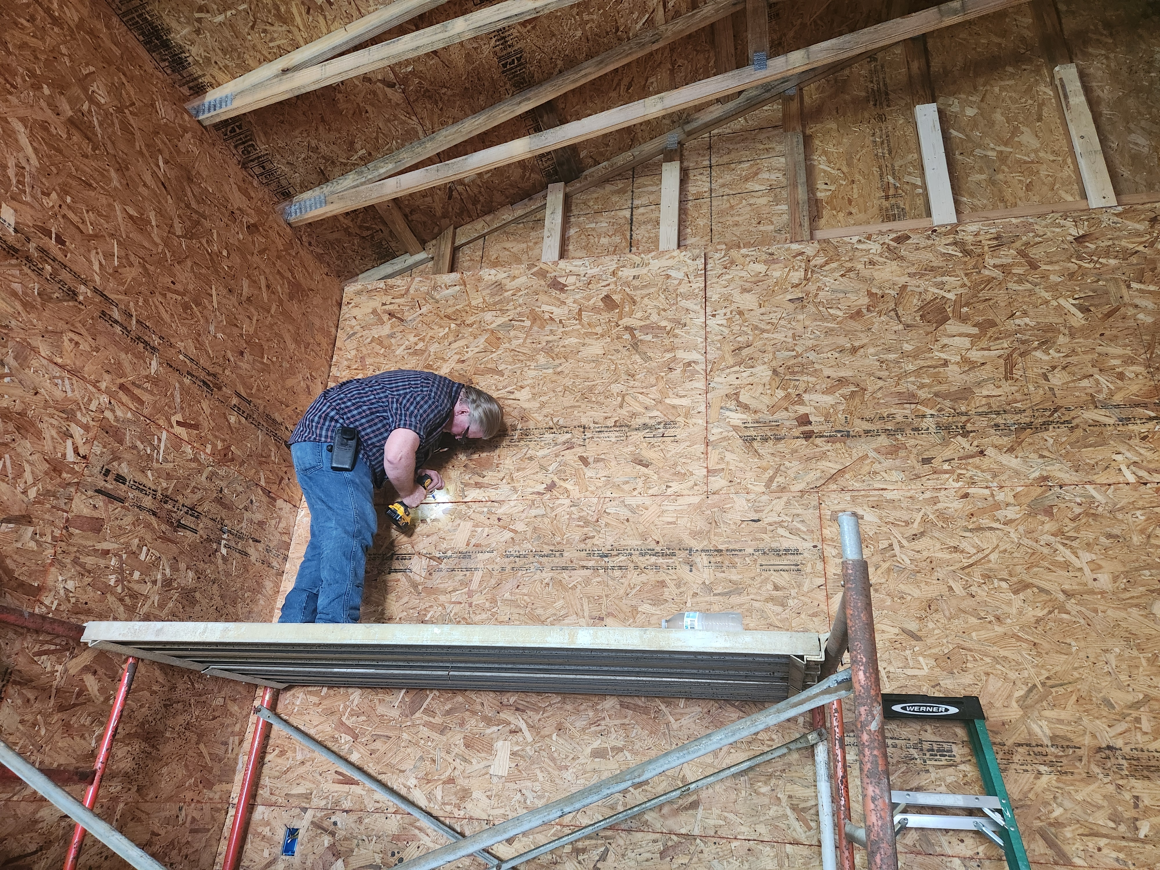

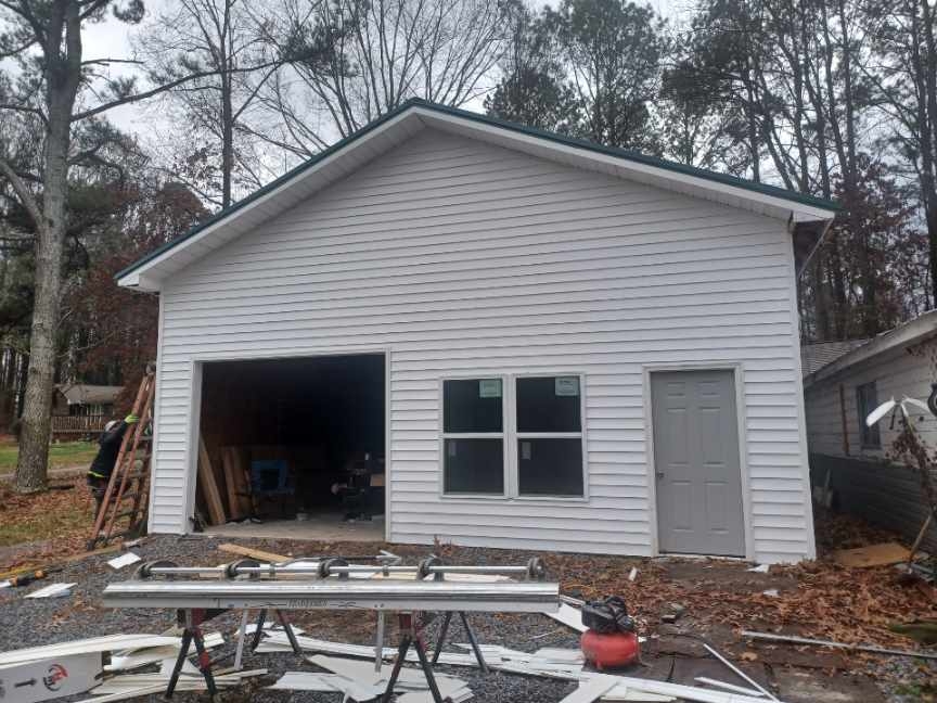

Im not getting much shop time with all of the holidays, and the bil is on vacation, so we have been working on his new shop.
Its going to be a nice one when its done.
   / Kawasaki Mule rebuild! #116
Good scaffolding is nice to have!!!!
