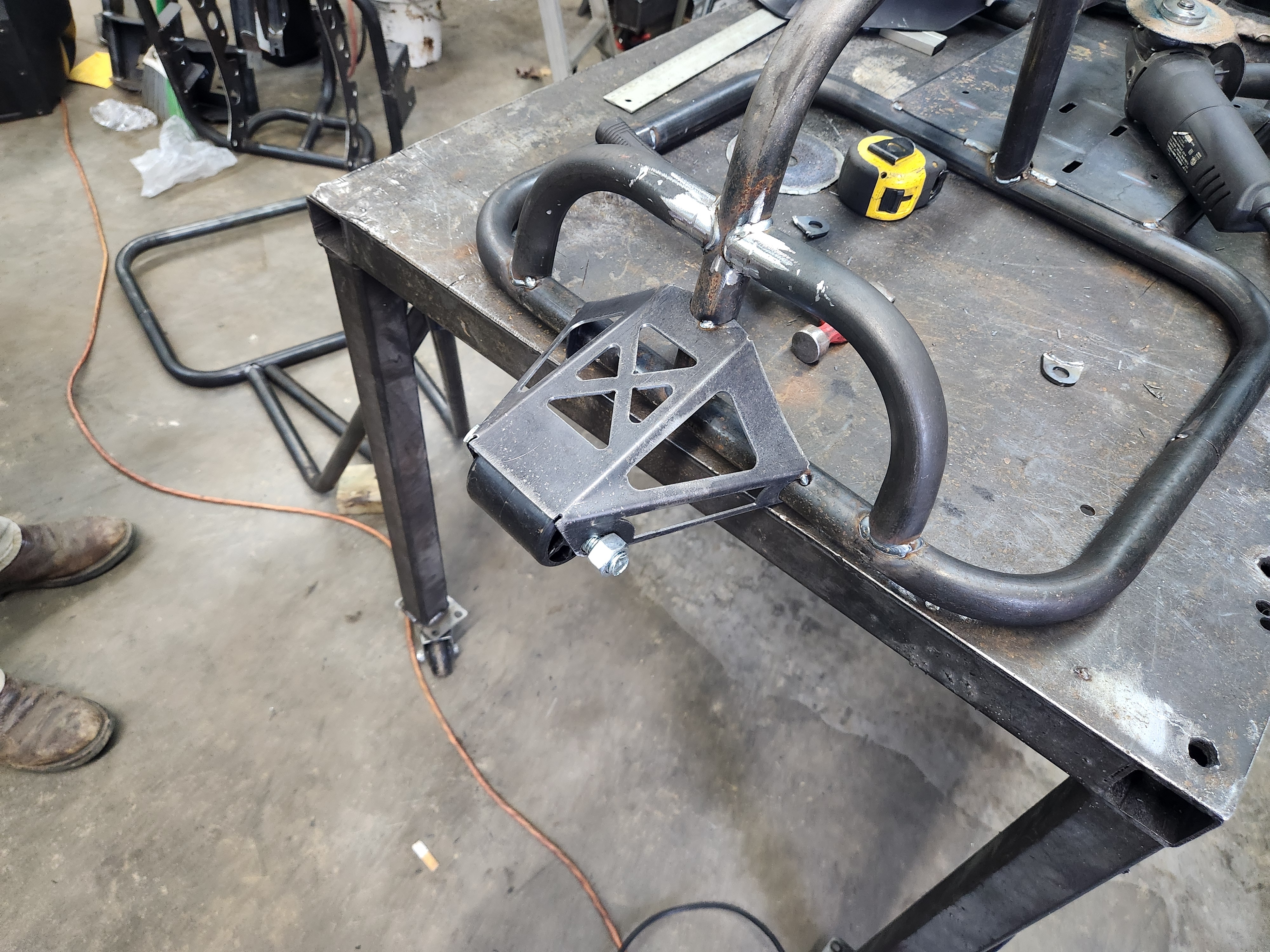

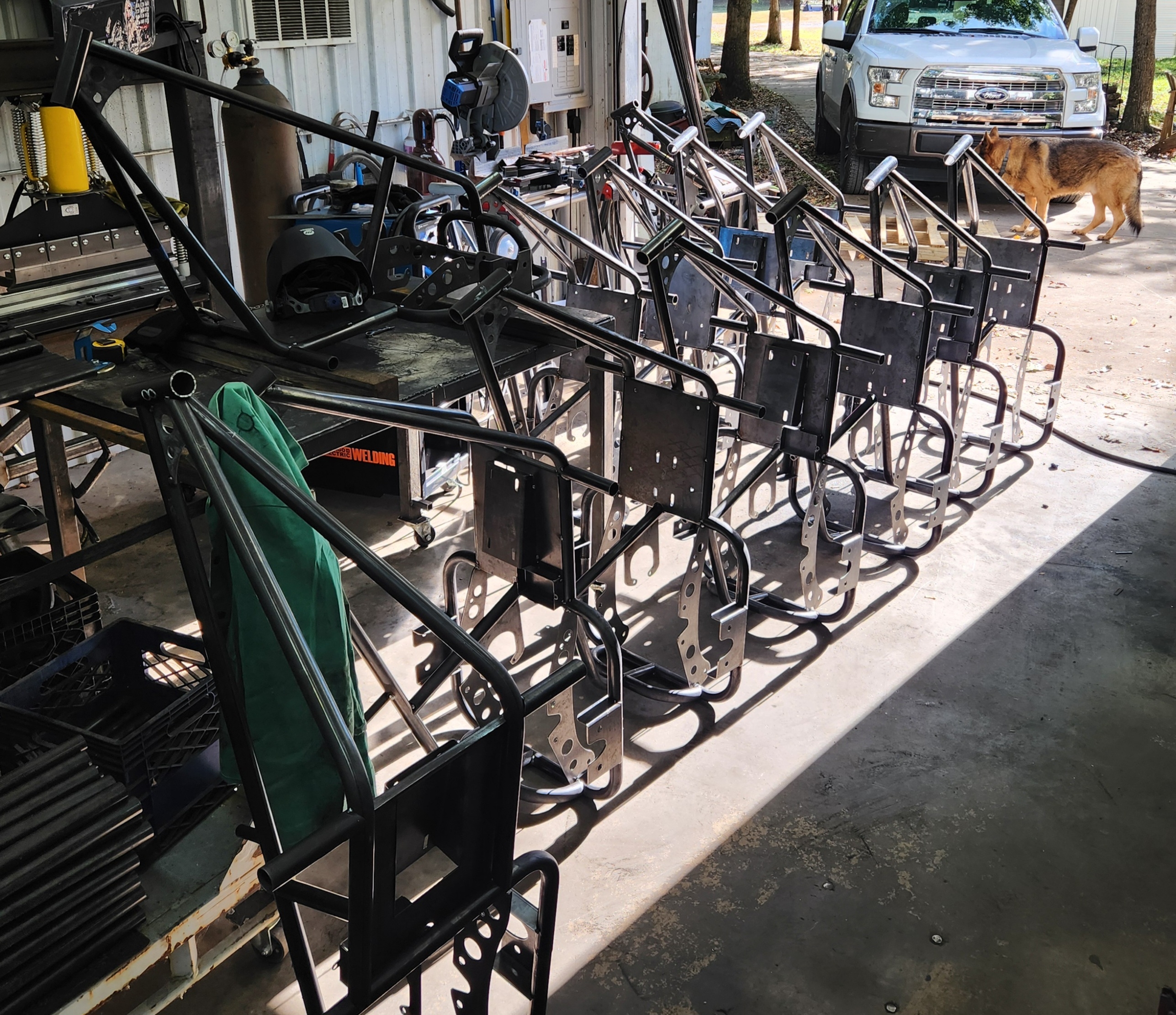

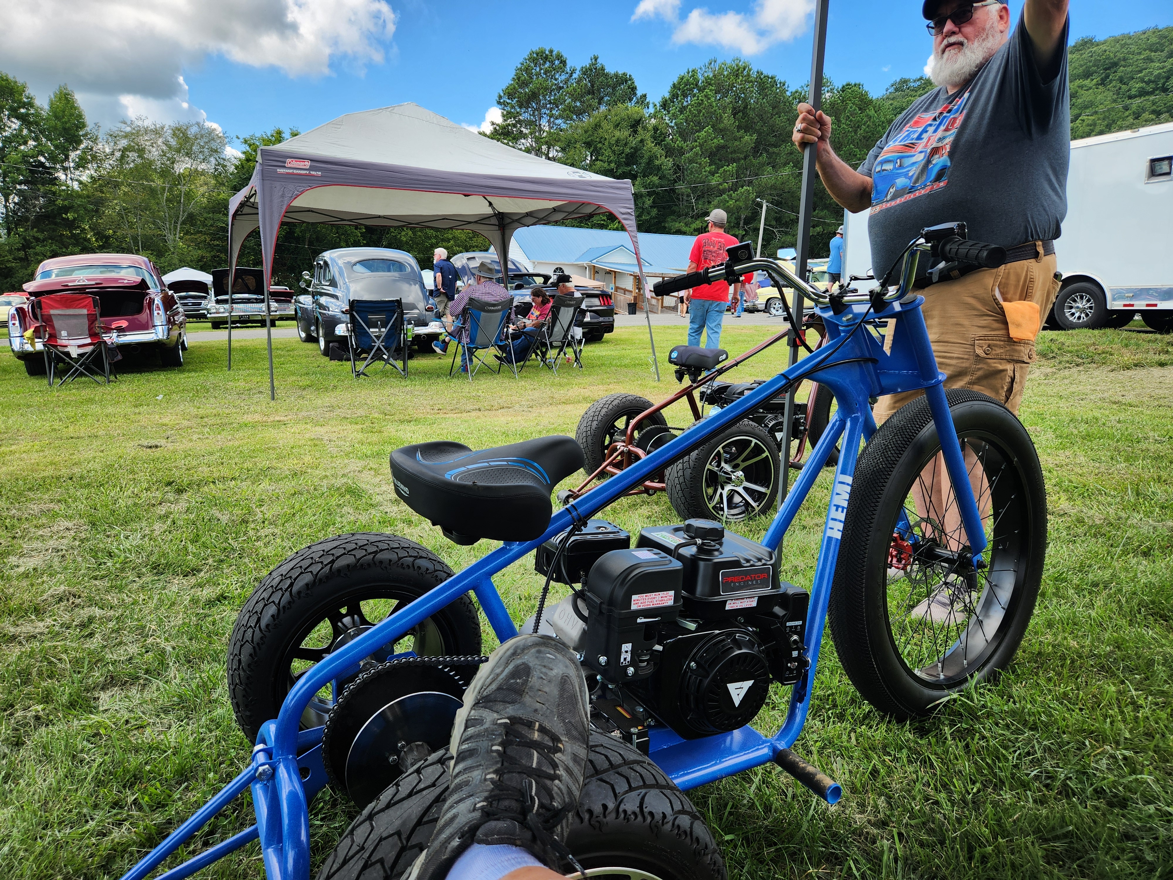

Just checking in! I have been so busy with non atv stuff. We had a good show in pigeon forge, we have to build 73 frames to get stock back to level.
