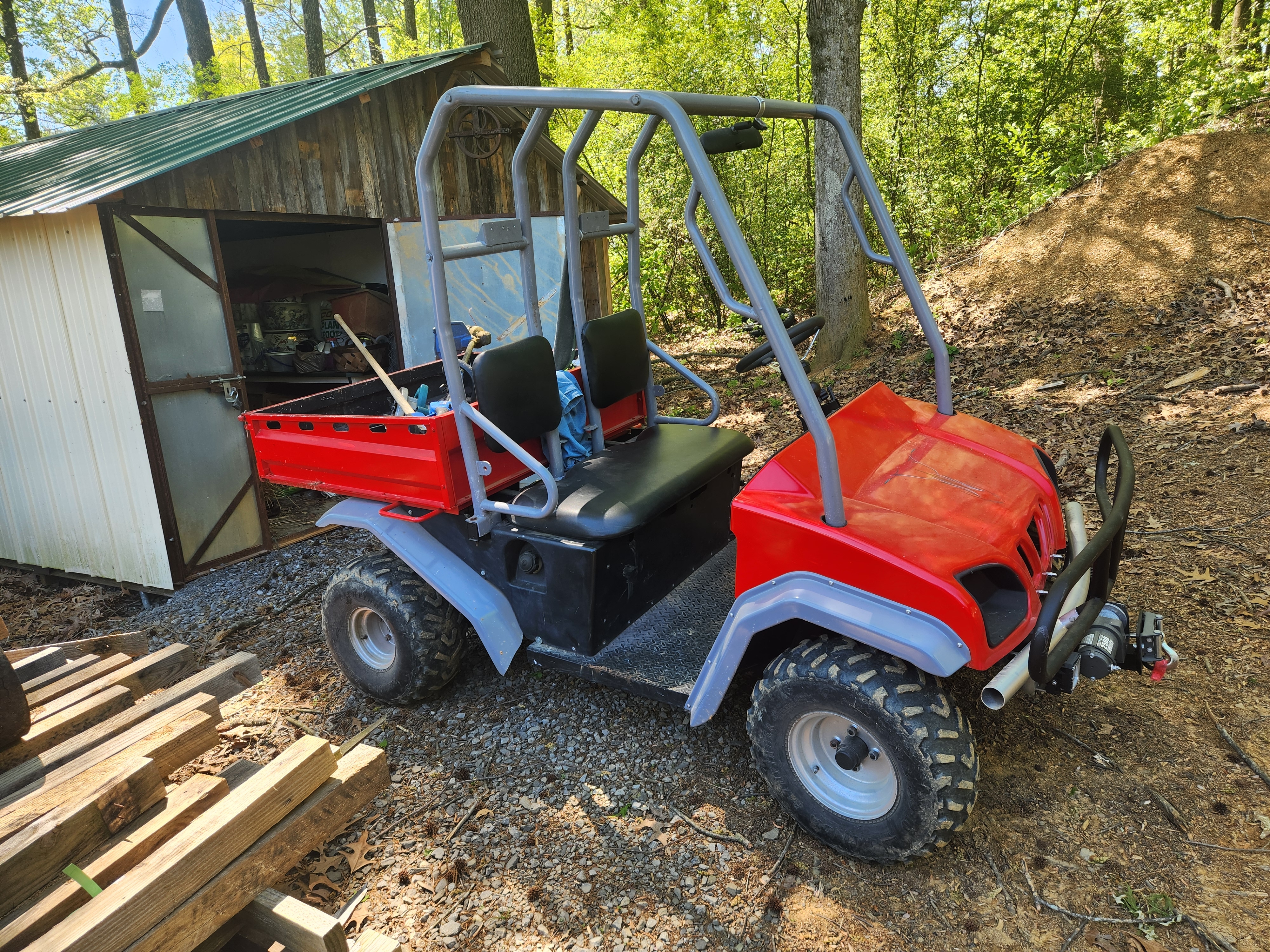

But I did find some time yesterday to strip all if the paint off of the front of my Mule.
If you remember, the fender supports were destroyed, so they got cut off.
The new pieces are now welded on and I will get everything painted. I did the first coat in gloss black, the second coat will be semi gloss, I needed to use the gloss paint somewhere to get rid of it. It was purchased by mistake so had to hide it somewhere!

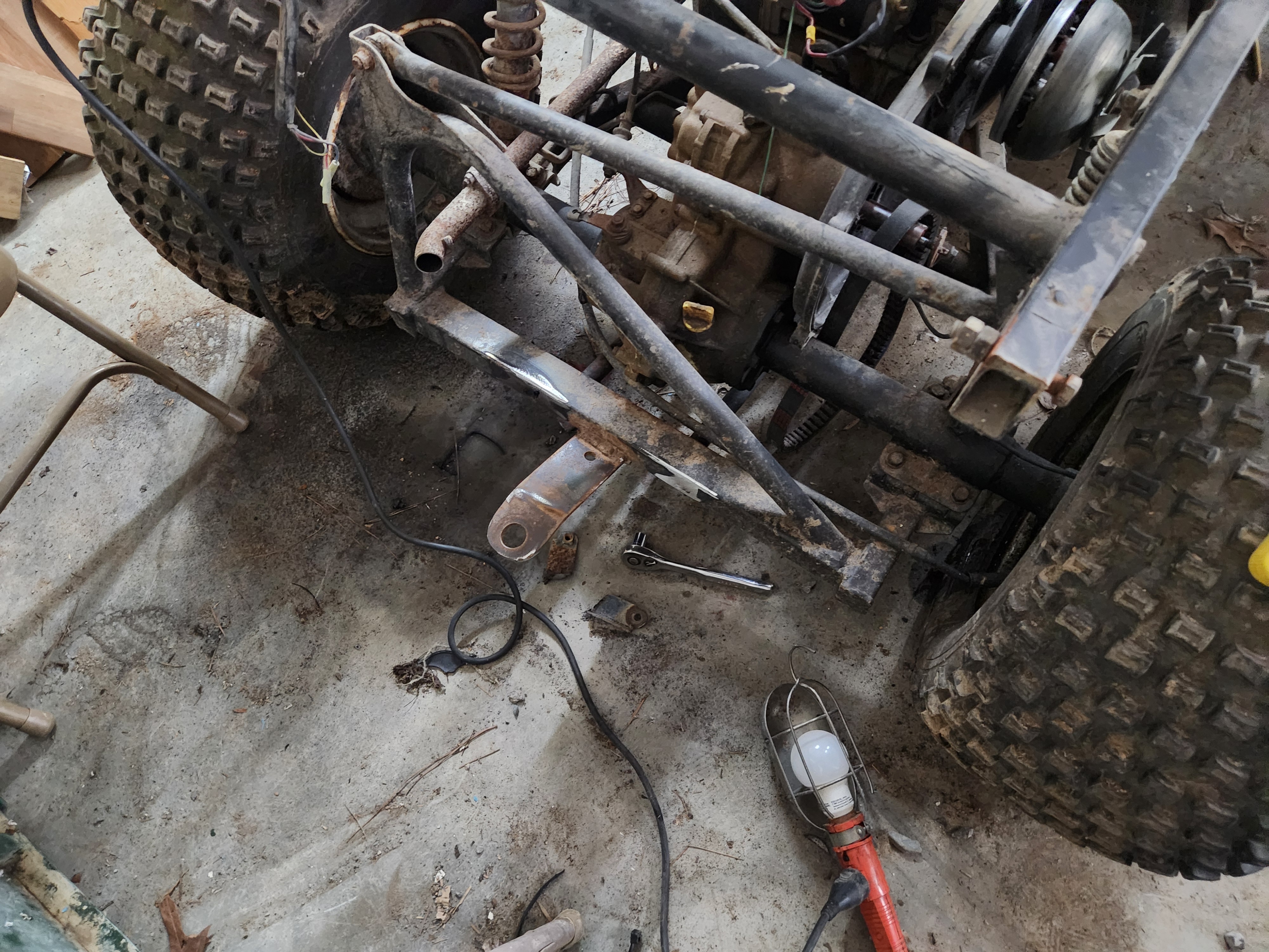

#50

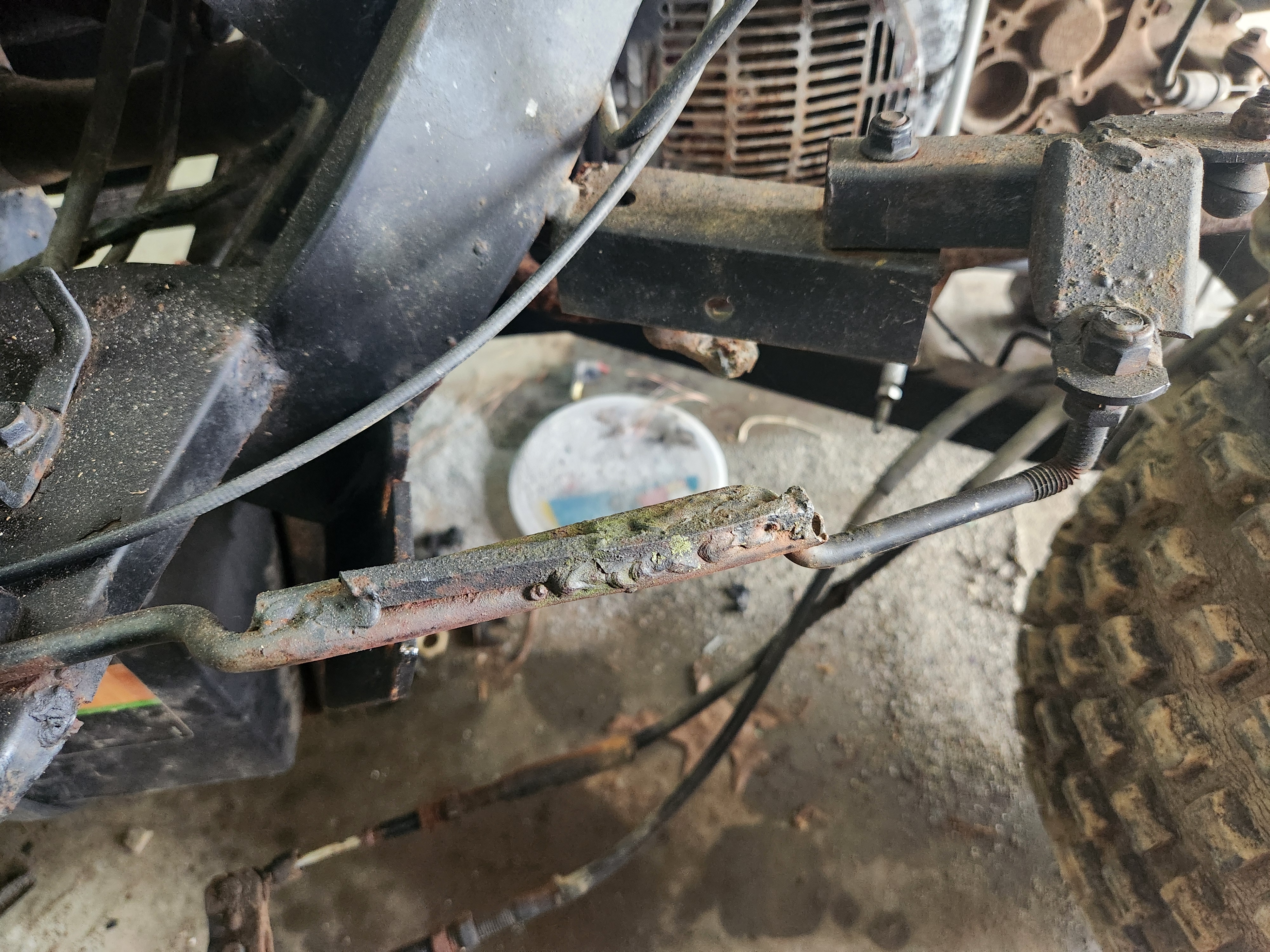

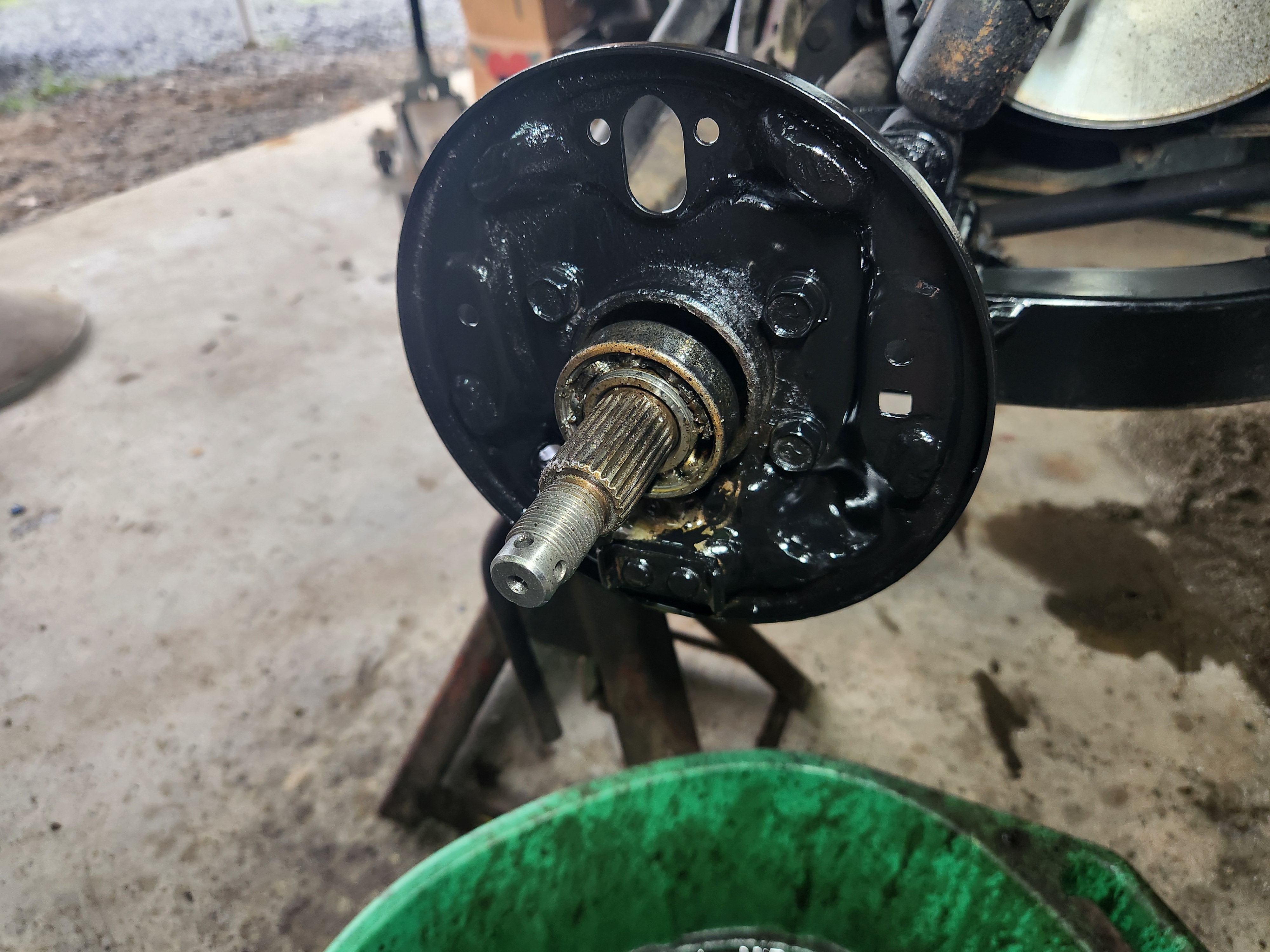

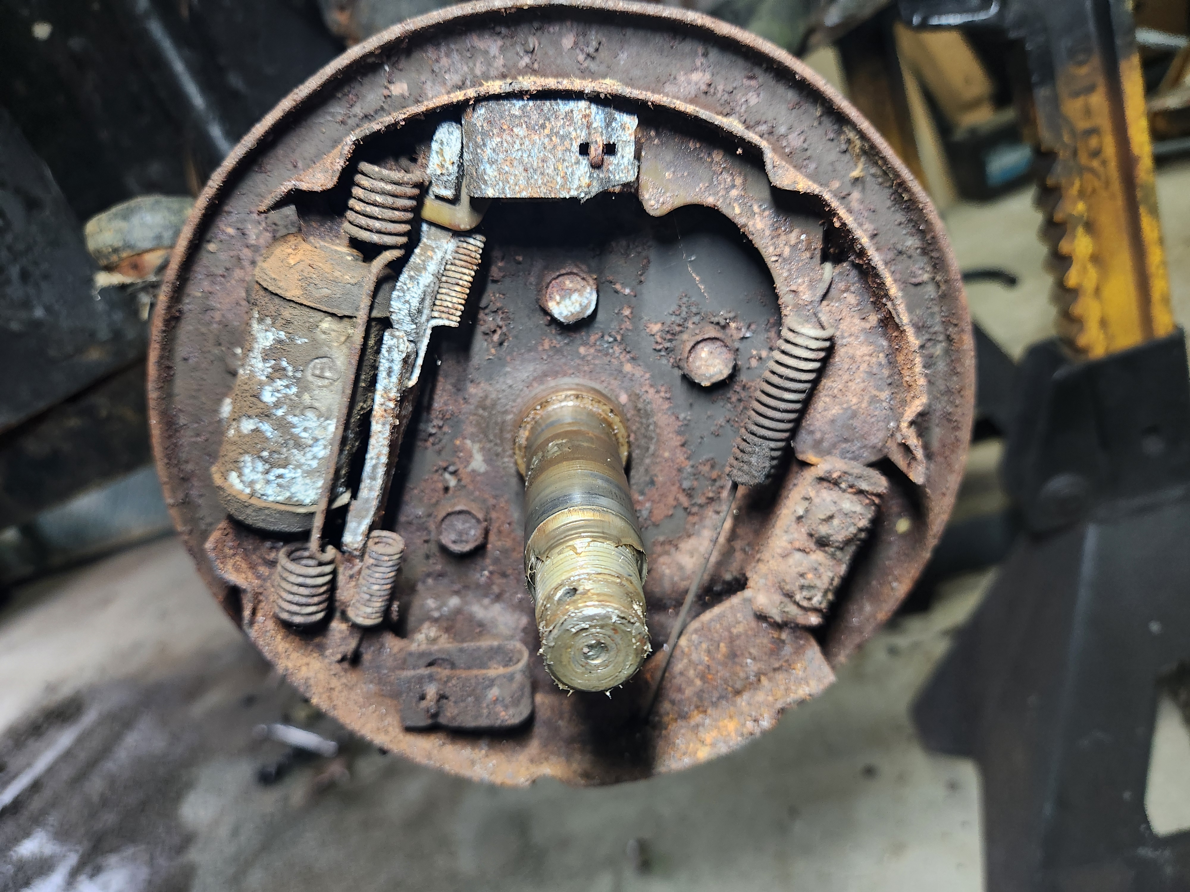

I finally got some quality mule time in!
Got the new rack installed.
Both control arms and all of the new brakes.
Front end is basically done.
The rear crossmember was in bad shape, had rust holes in it. I have reciever type hitches on all of my other equipment, and all of my attachments are on reciever tubes so I want this one the same.
A buddy gave me an old hitch so I took the ends out of it.
I cut 2½" off of the ends of the swing arm and welded the hitch on, then I moved the reciever head up and welded it straight to the tube, it was hanging too low.

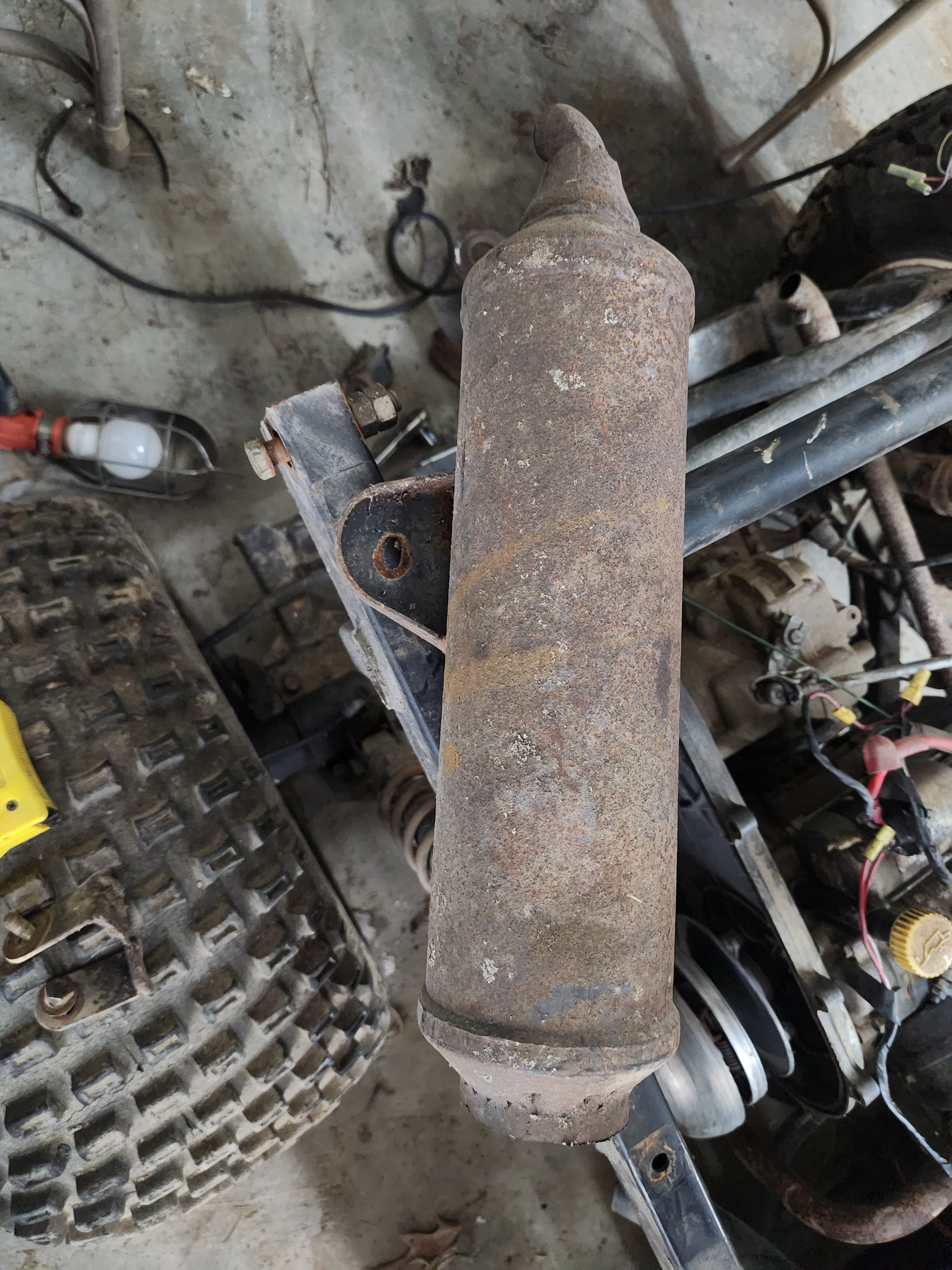

I couldn't find the correct muffler, so I used this one from a Chinese 4wheeler. I added some brackets for a heat shield.
I had this old shop light cover lying here so I cut it and rolled the end. Im going to dimple die all of the small holes, they will be punched out to 1/2".
The end of the muffler was large like a motercycle muffler so I welded a washer into the end and added an elbow to direct the exhaust down and away.
I have to mount the master cylinder, mount the shifter and shift cable, and reassemble the steering column, then I can take it to the tire shop and get new tires and wheels!
Hopfully I can get that far by Friday.

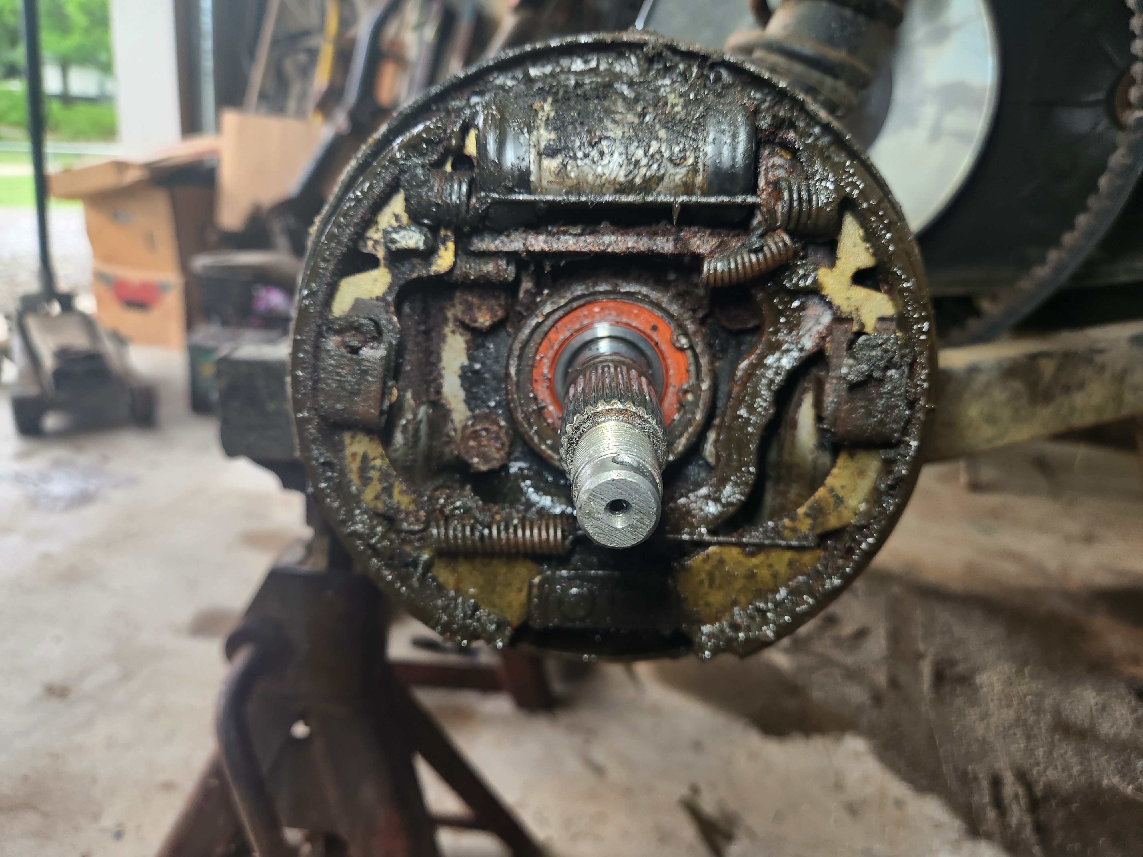

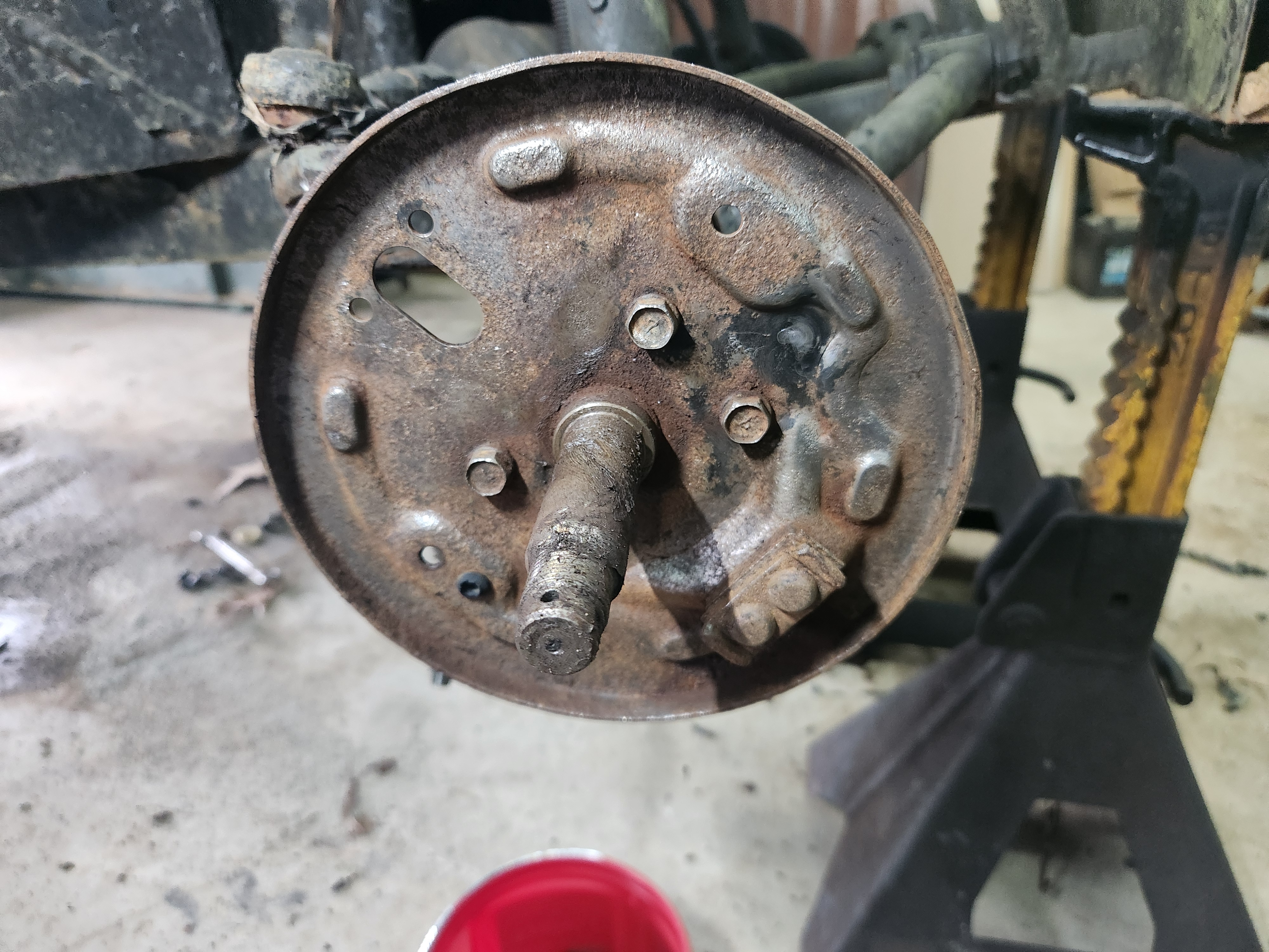

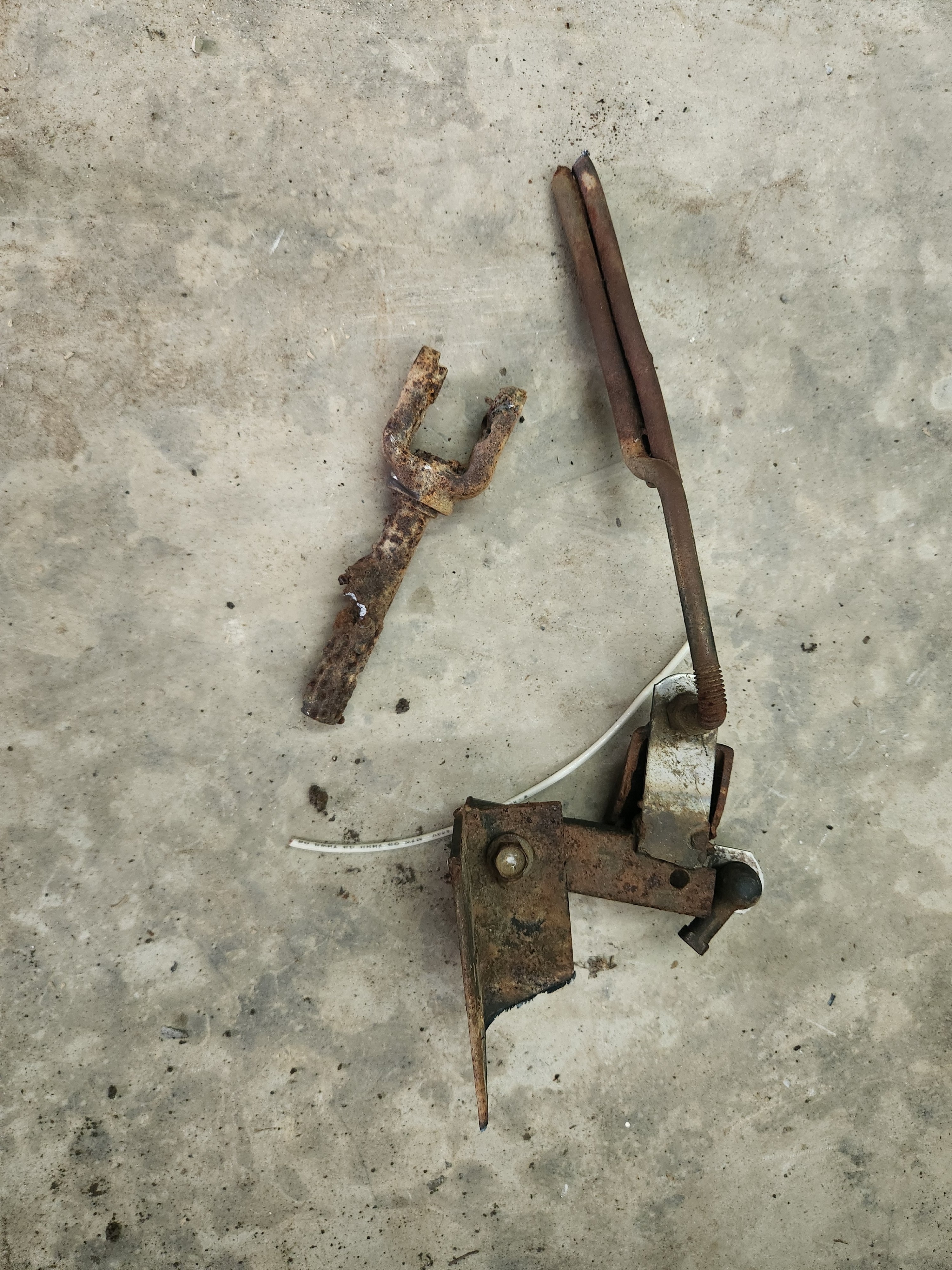

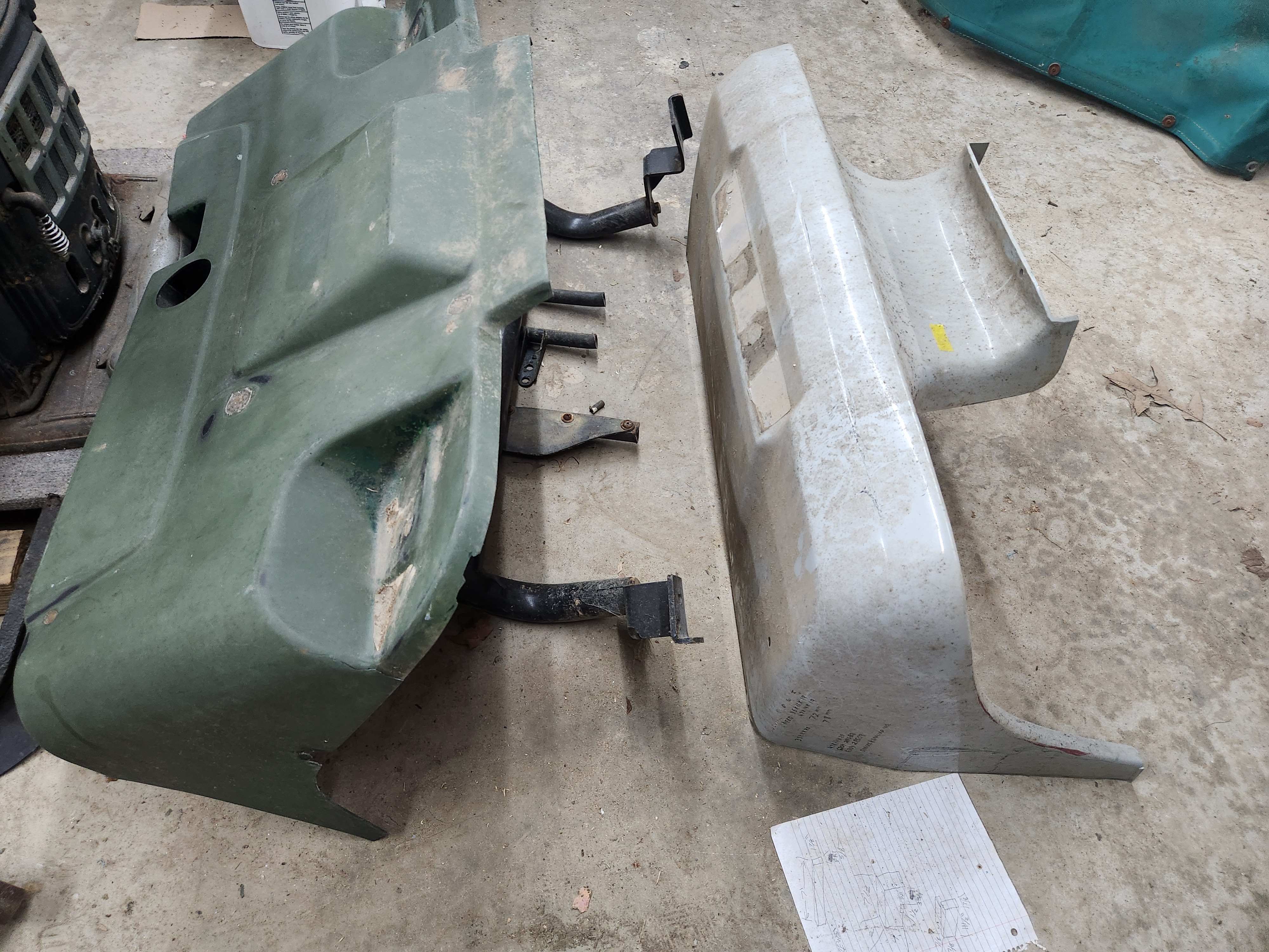

She was rough when I drug her home.
Im about ready to start the body work, so Ill put some before shots of the pieces!

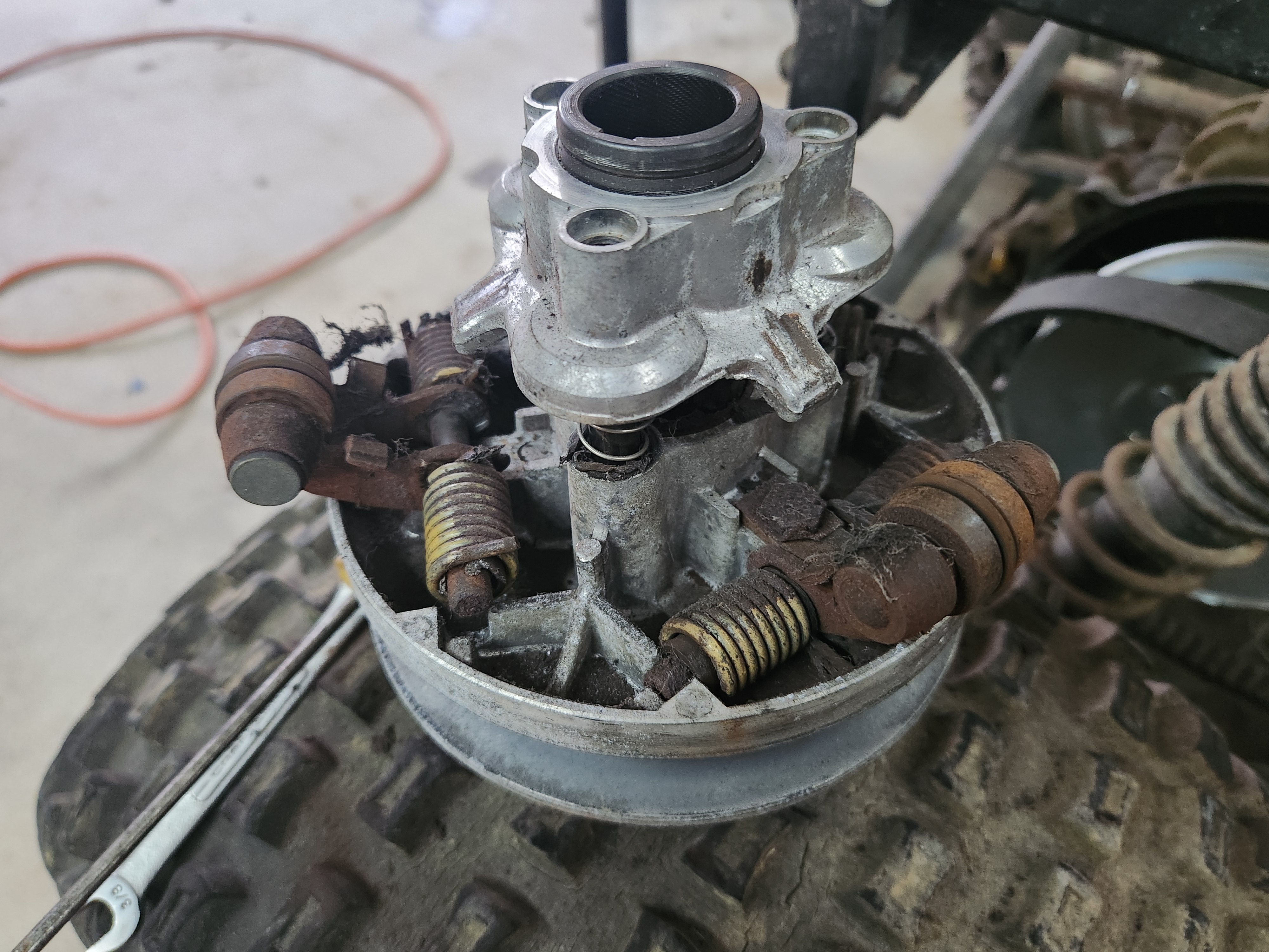

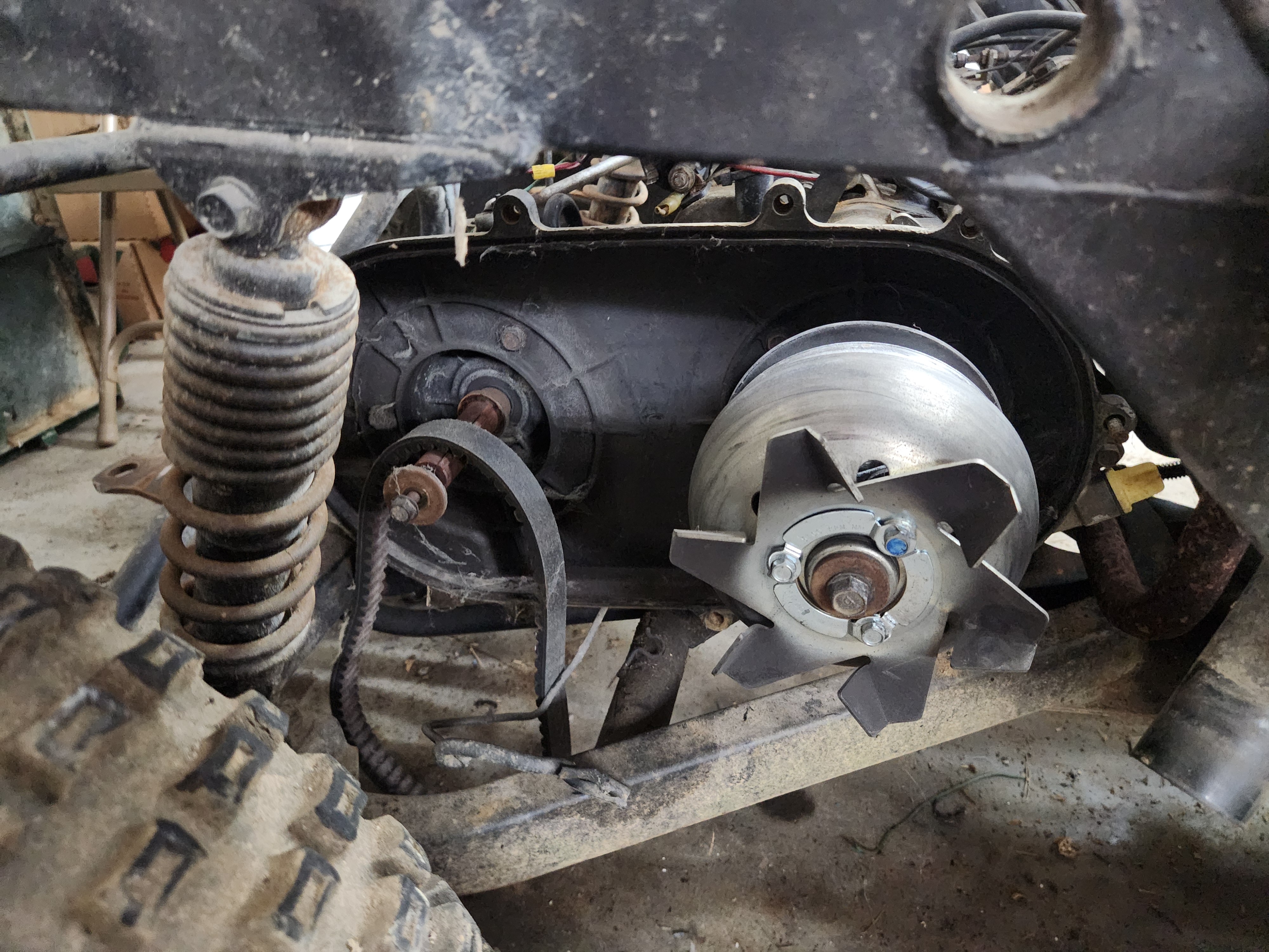

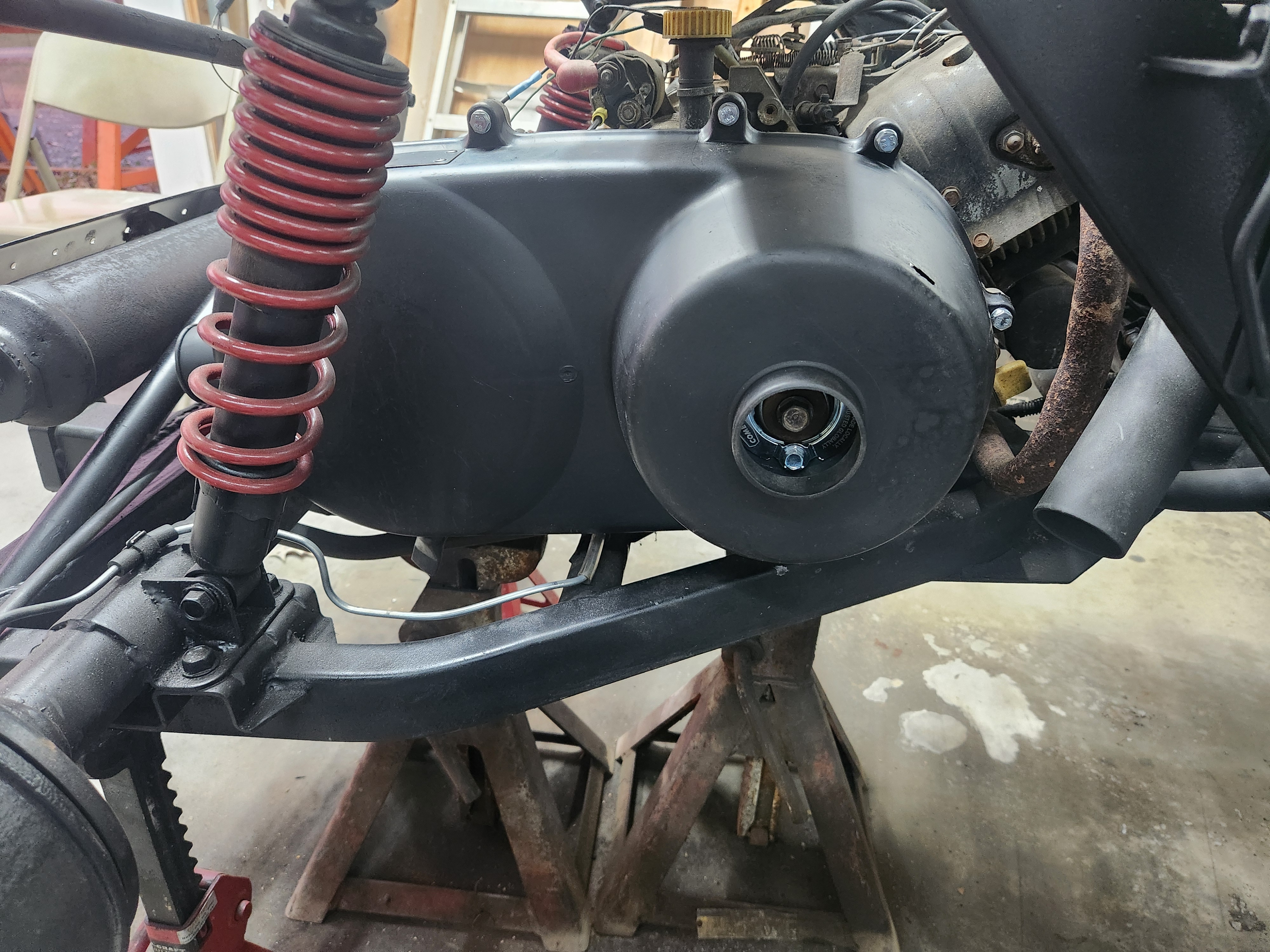

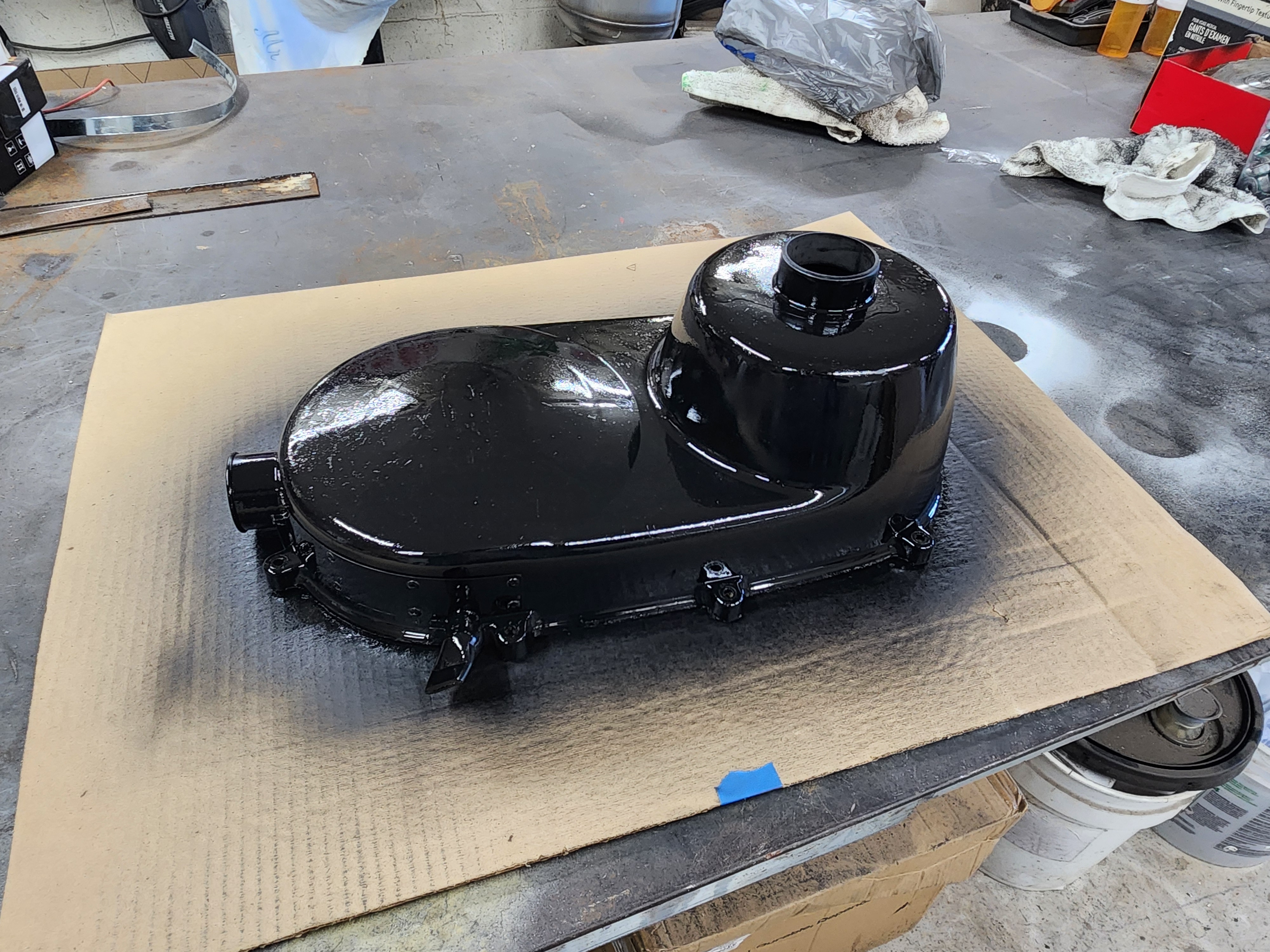

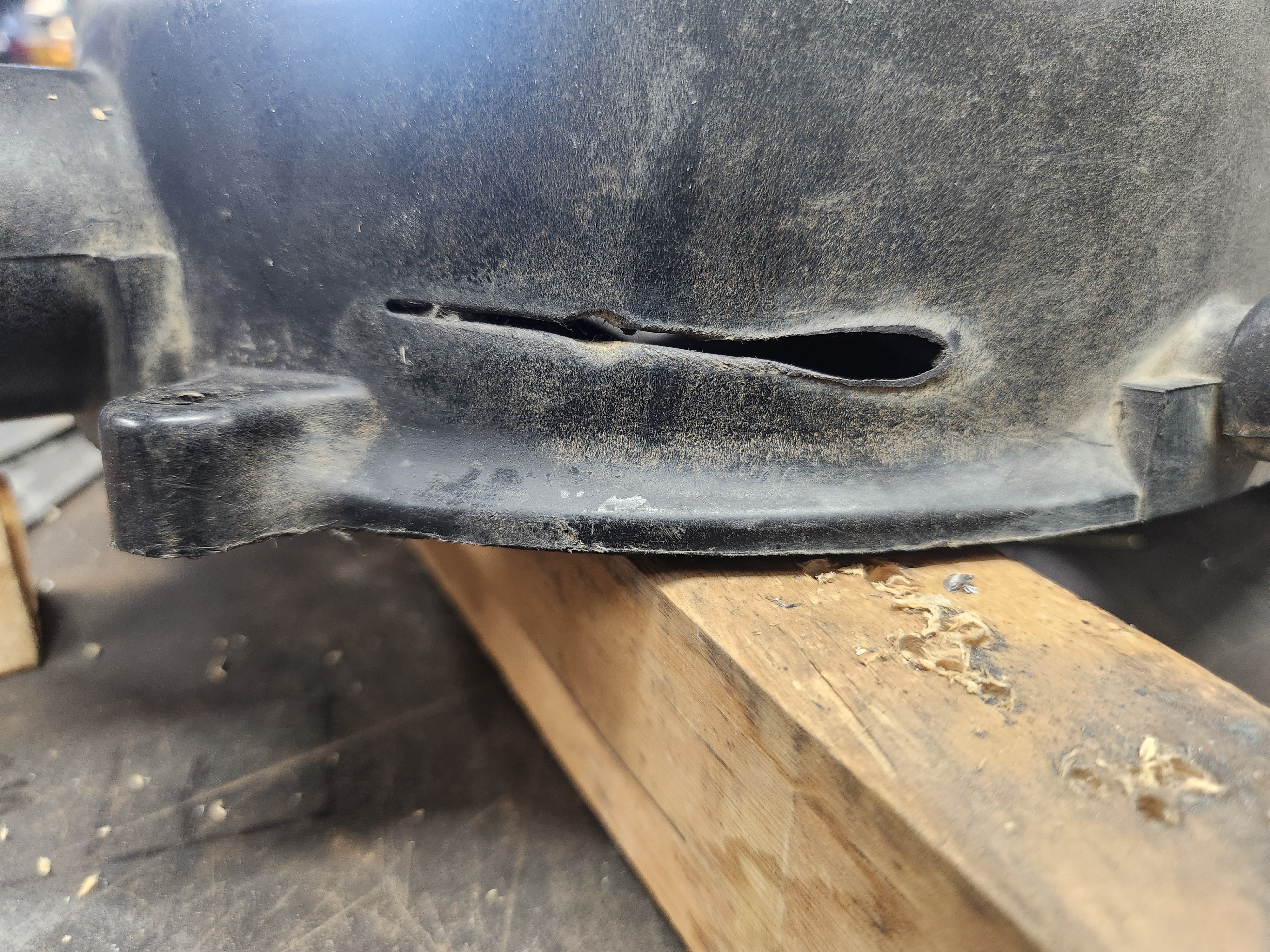

Someone shredded a drive belt sometime and cut the clutch cover.
I had to clean the old belt pieces out of the cover.

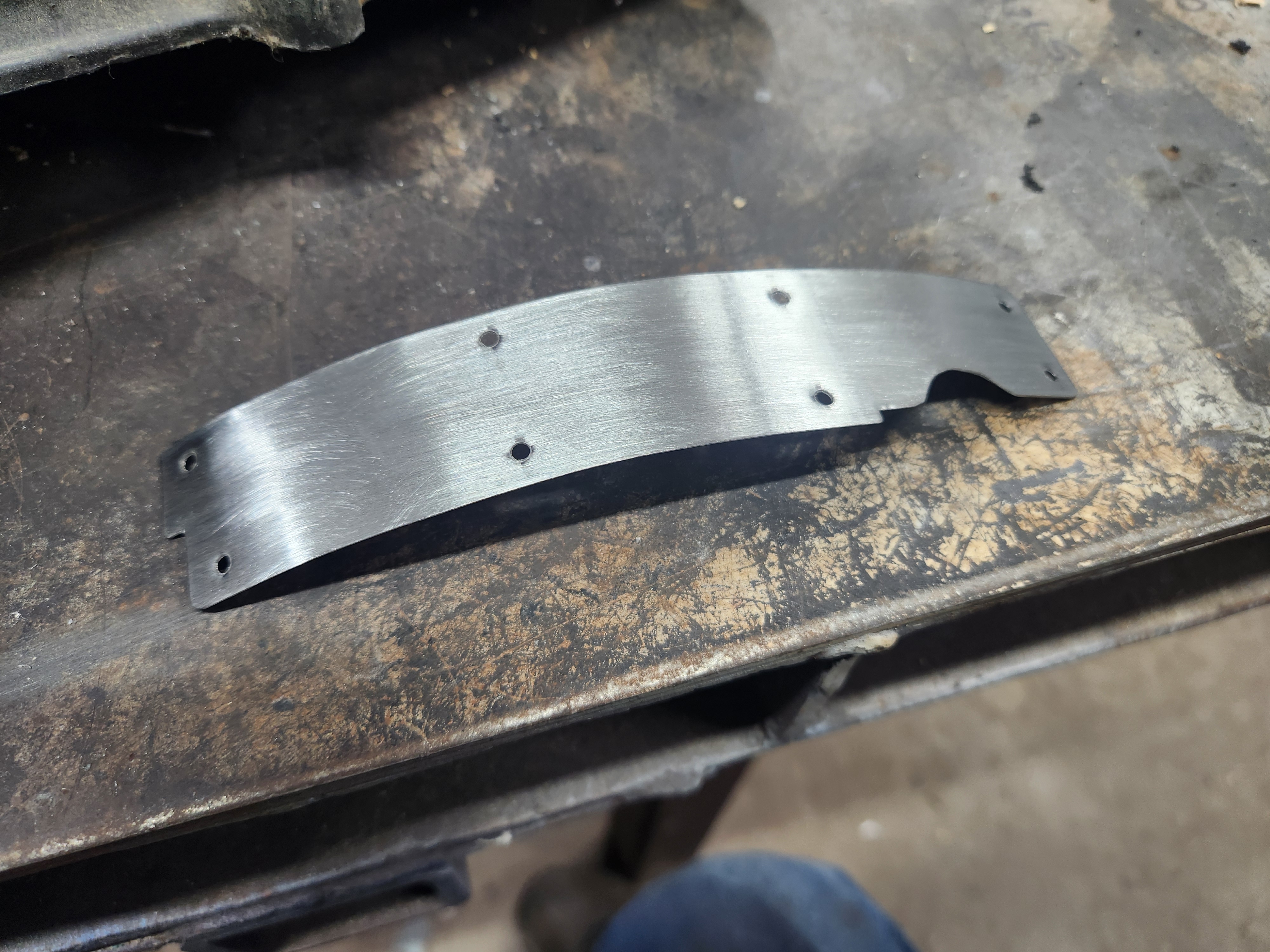

I made a couple of patches.

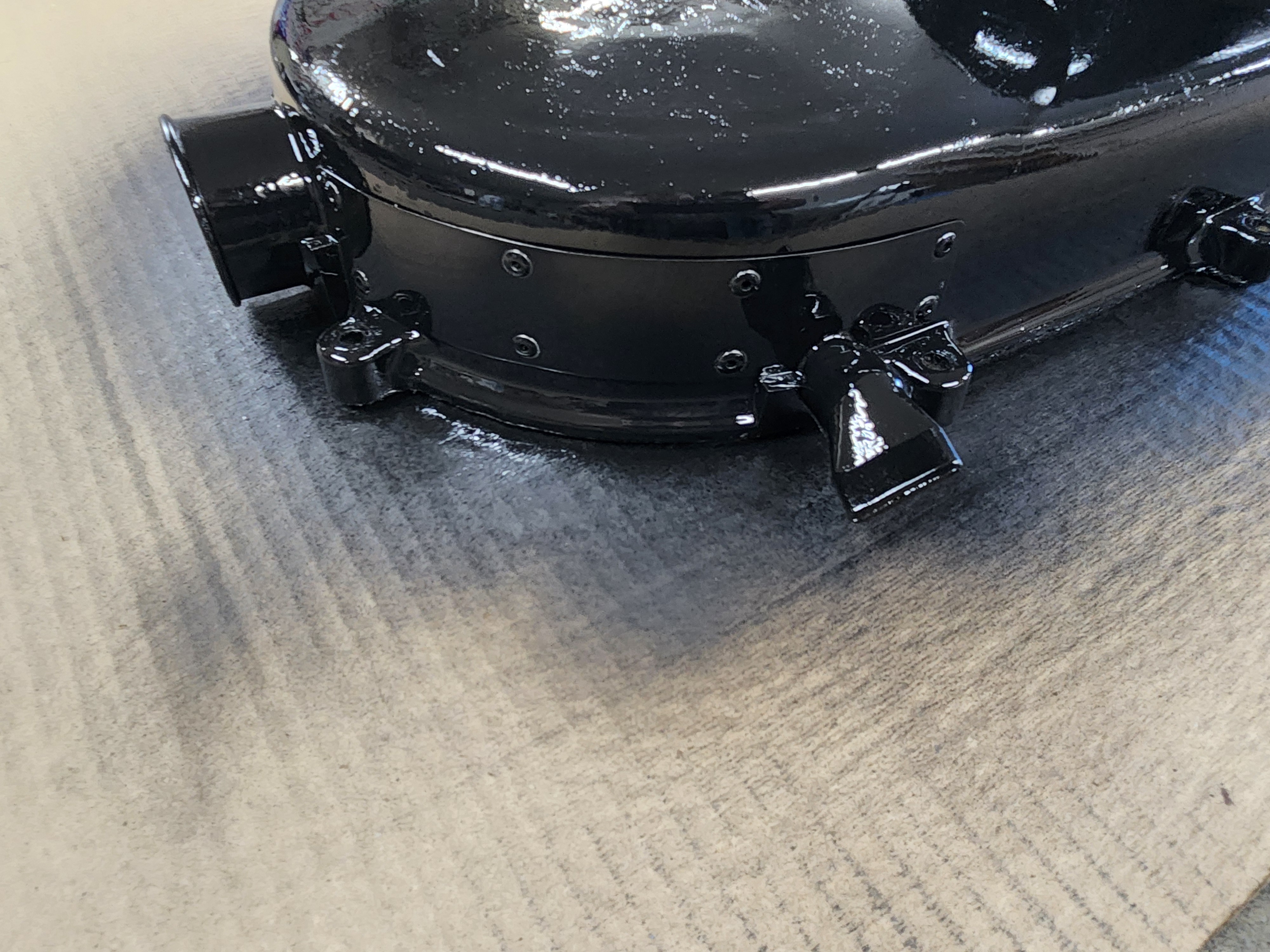

Gave it a coat of paint.
Another piece finished.
Back in place.

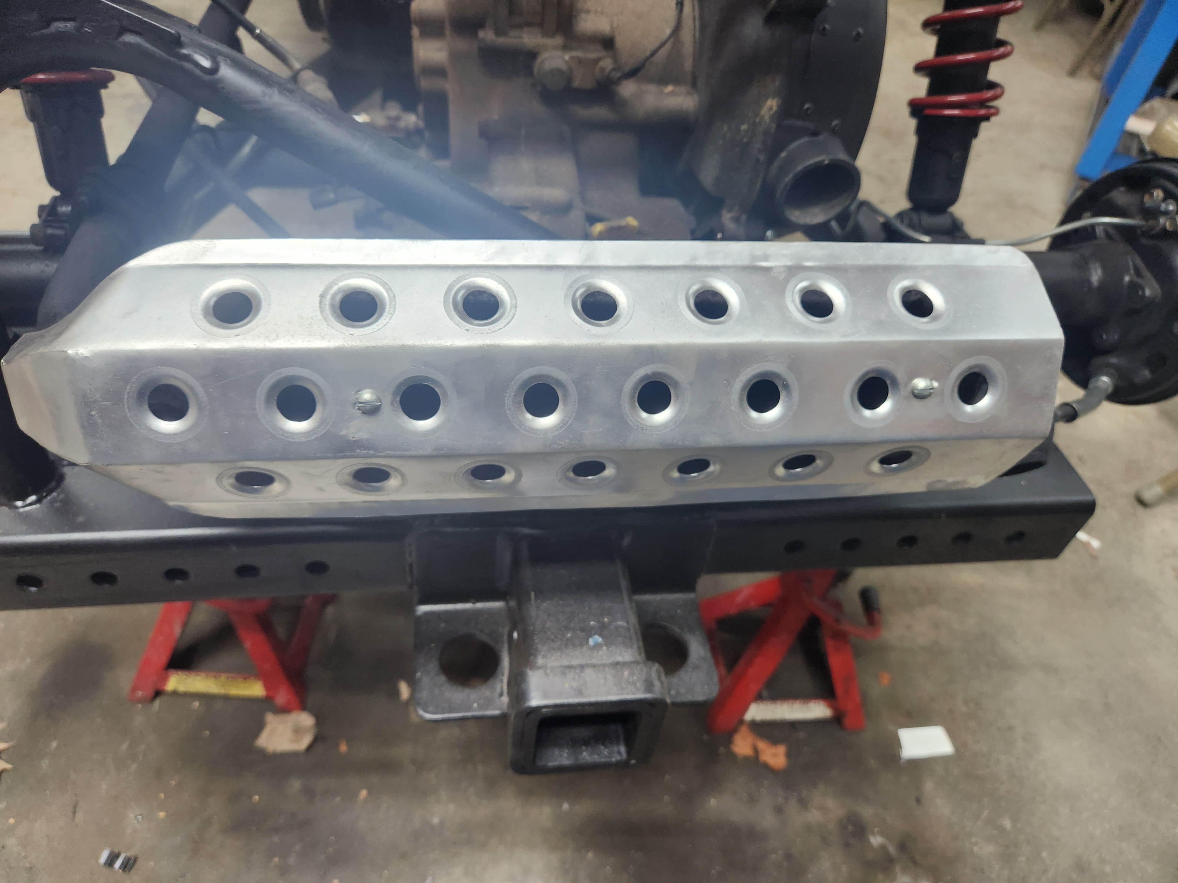

I got my new set of dimple dies and finished the heat shield.

My 4010 doesnt have a heat shield by muffler….was there supposed to be one?
/ Kawasaki Mule rebuild!
#59
It shows a heat shield on top of the pipes but not one on the muffler.
I put this one on mine because I can see me grabbing the muffler when trying to hook up a trailer!
