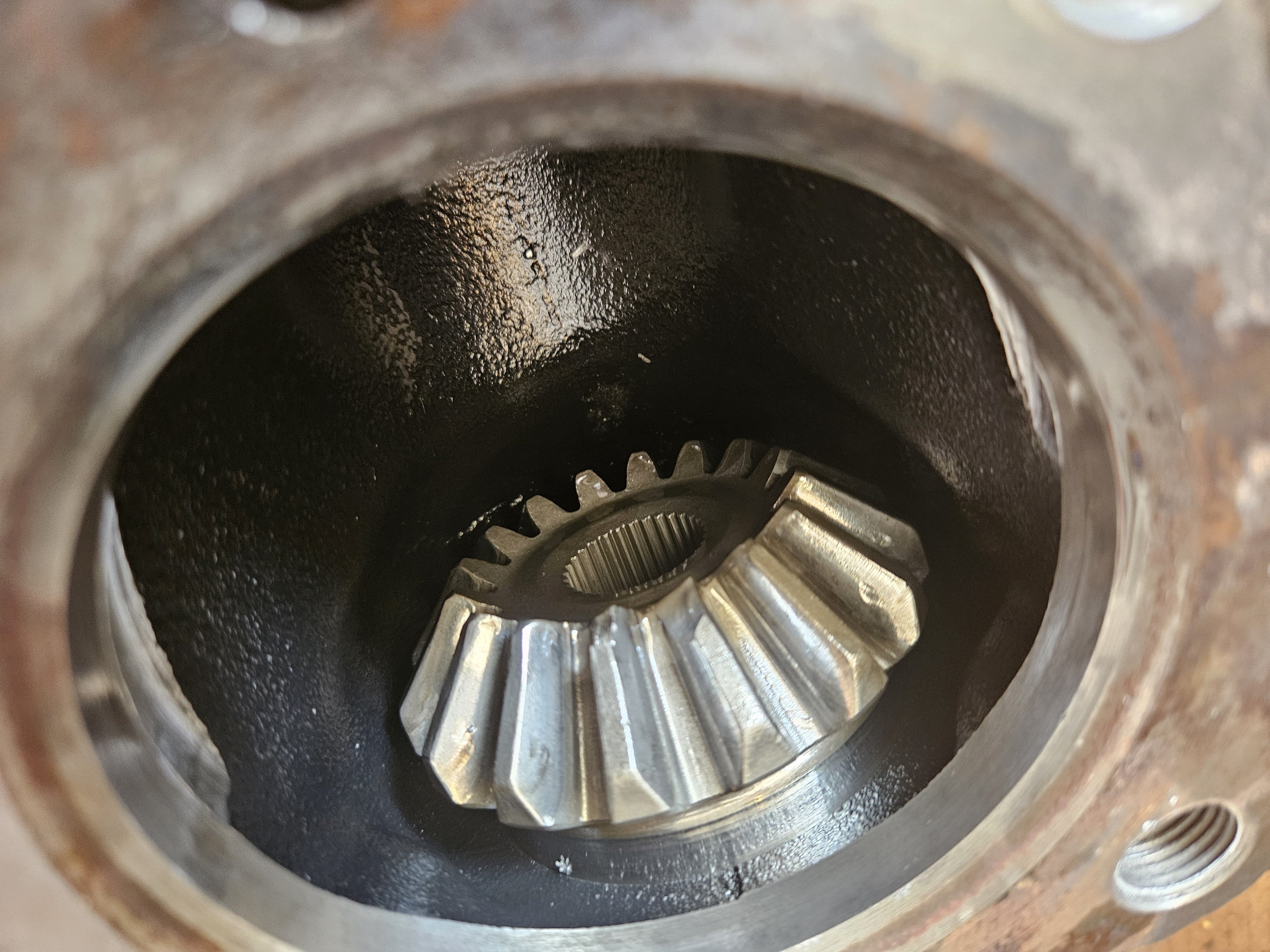

New holland t2310
I have a new holland t2310(same as tc40). I was pulling the box blade and started to hear clunking and could see the front tire vibrate when it did. It stopped when I took it out of 4 wheel. Fluid level was good in front axle and final drives so I drained the oil to look for metal chunks or large shavings. The right final drive had some small metal shavings not many. I took the driveshaft off and checked the couplers they looked fine. Spun the tires every which way I could in 2 and 4 wheel nothing noticeable. The right side does make a little more noise than the left when spinning so definetly suspect the right side. Is there anything else I can or should do before I tear into the front axle. I did notice my tie rod has a lot of play in the ball joint could that cause the binding?

I took the Dropbox cover off and found a lot of little metal shavings so i think it's in the drop axle assembly hopefully just a bearing

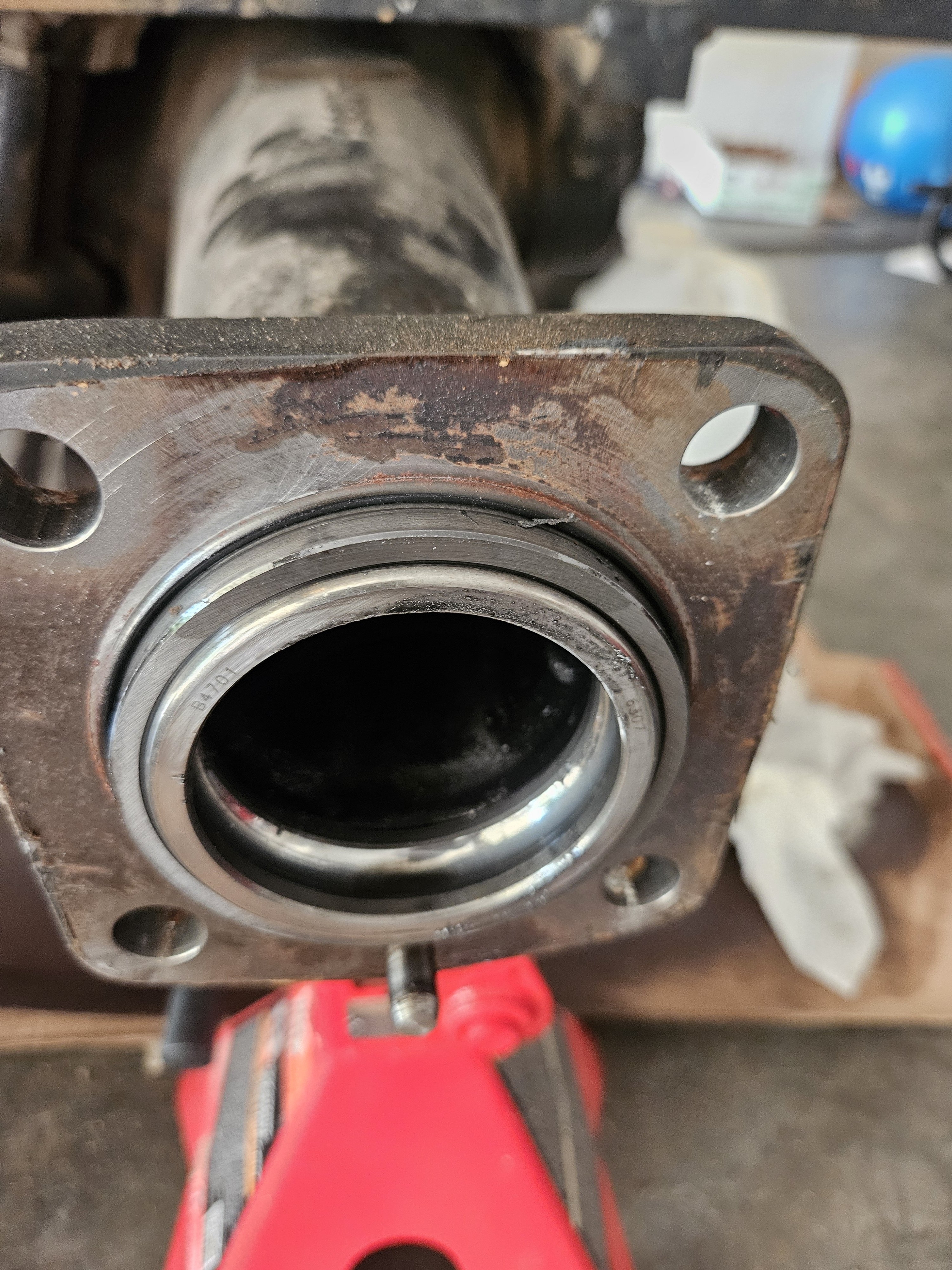

#9
#4 is the cover I took off. I've got most of the case off now finding more and more metal
/ Popping front axle
I found the problem. The case bearing that the axle rides on shredded. The ball bearings rolled into the case and were sitting against the ring gear. Luckily it didn't cause any damage to the ring gear, but it did chip the gear that's attached to the axle.
