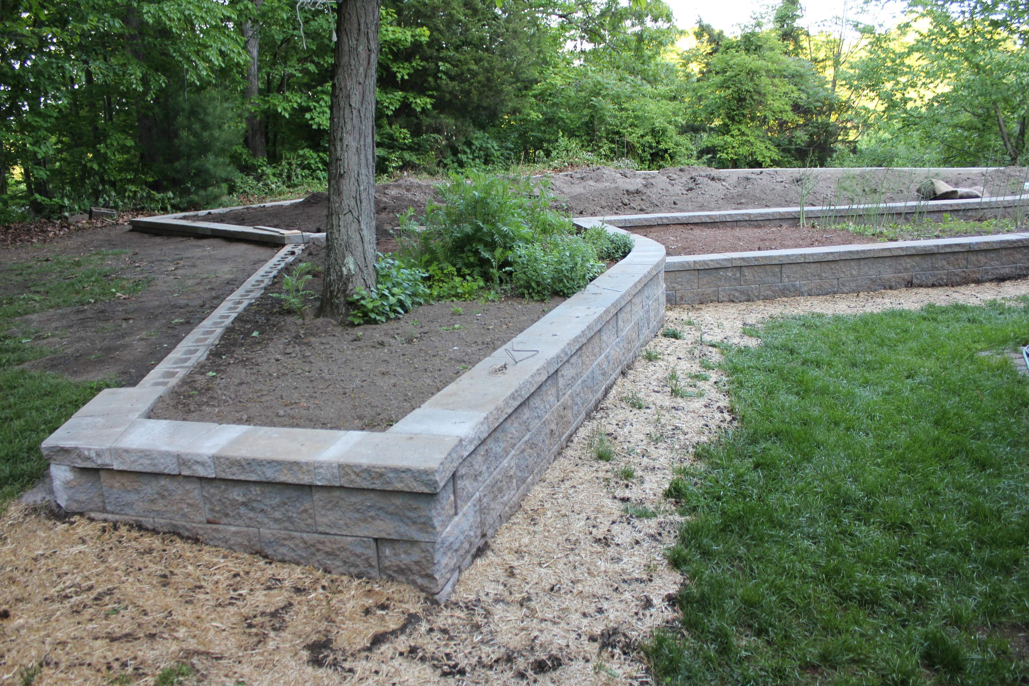

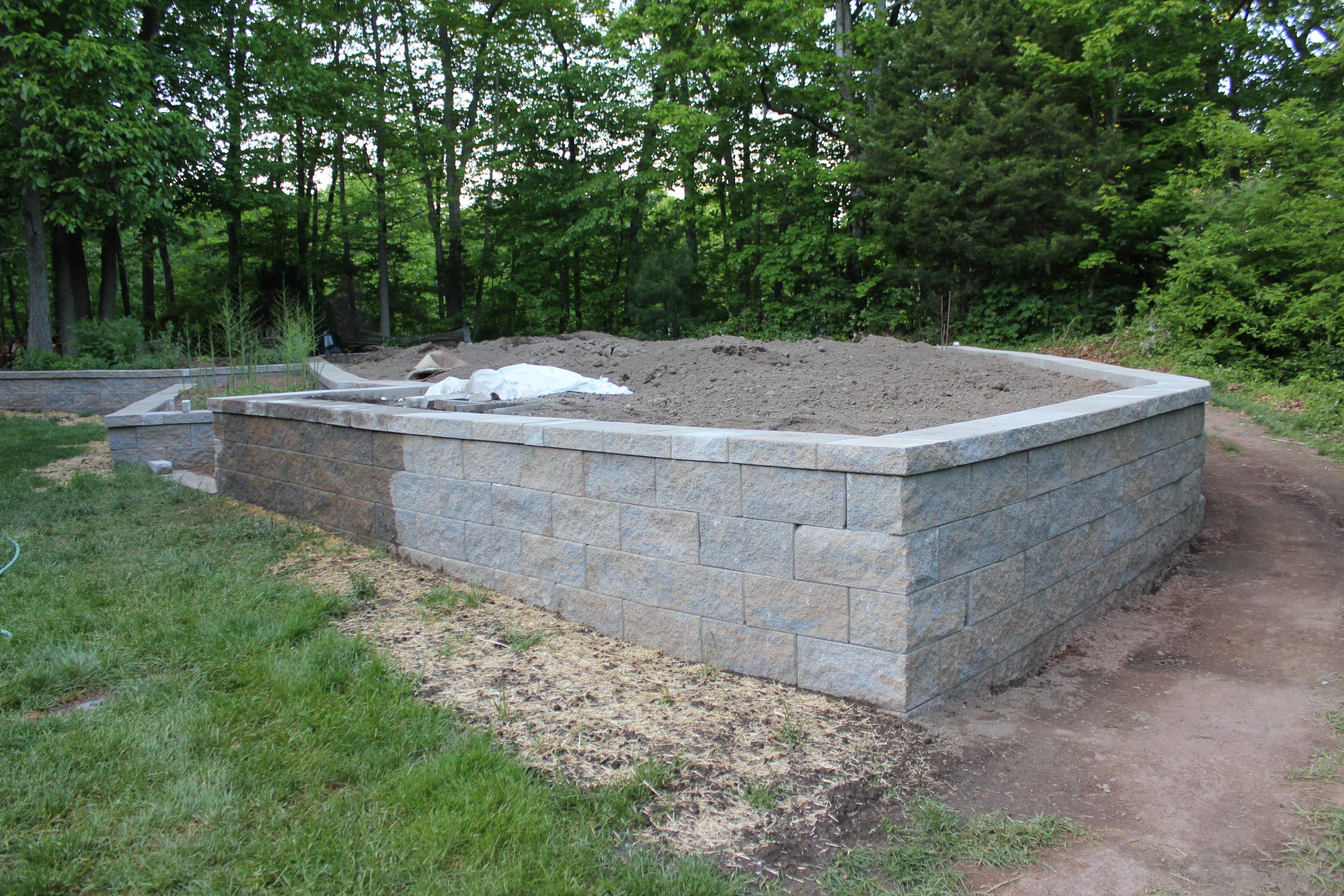

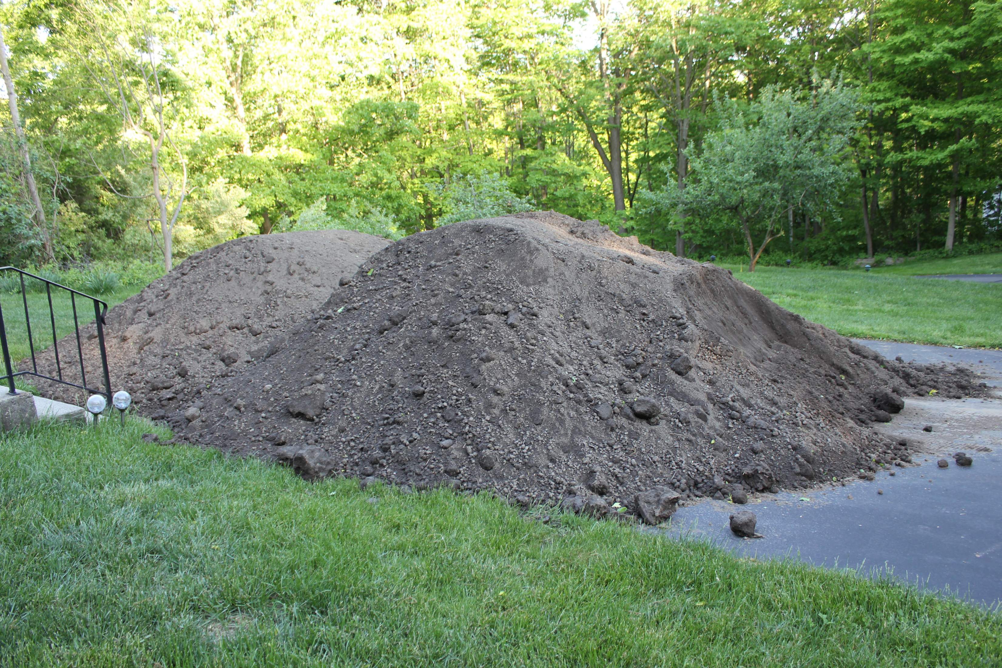

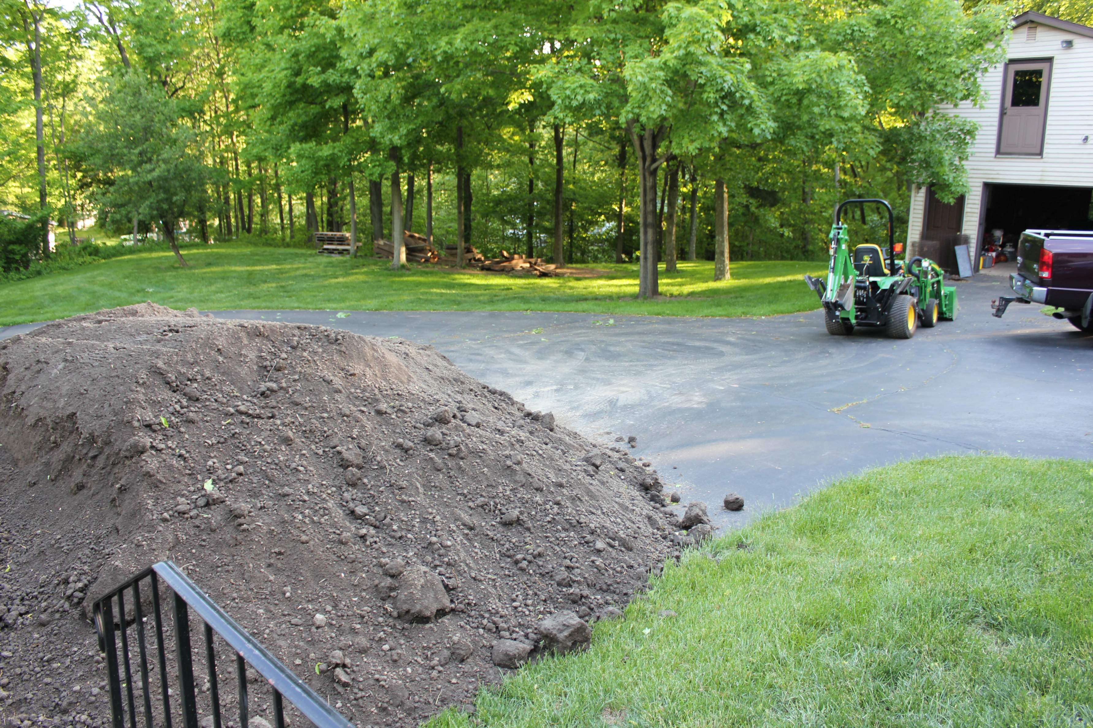

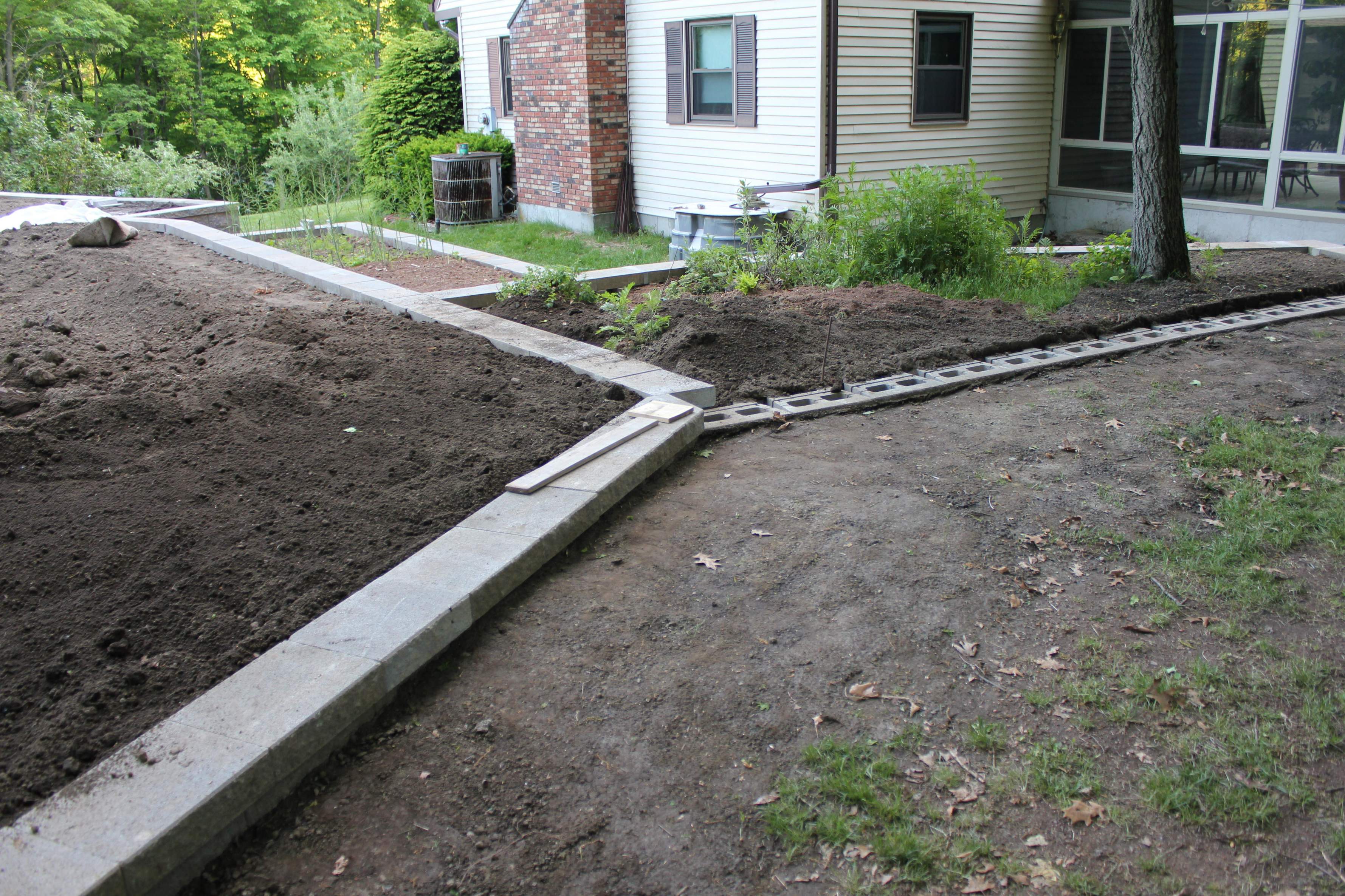

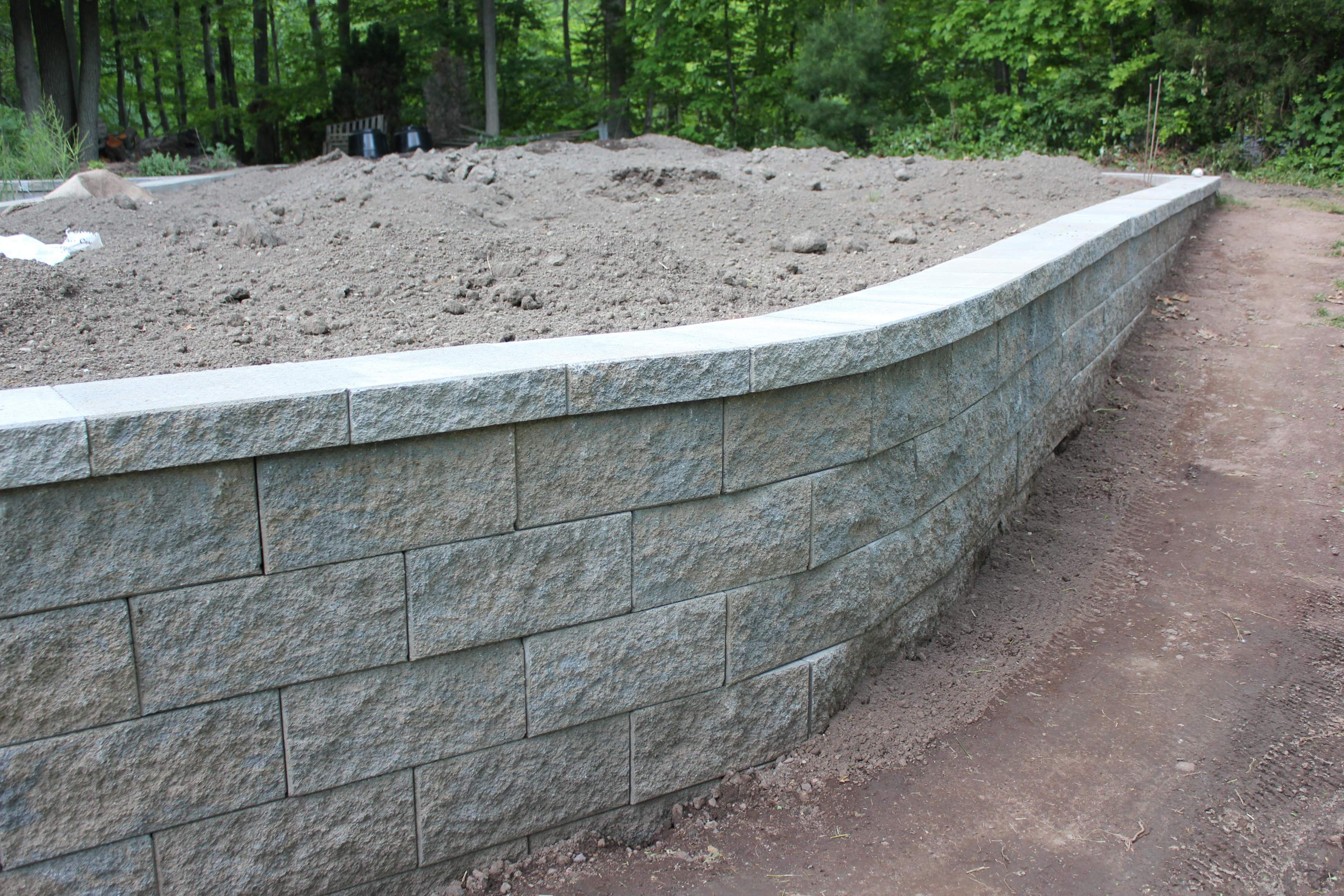

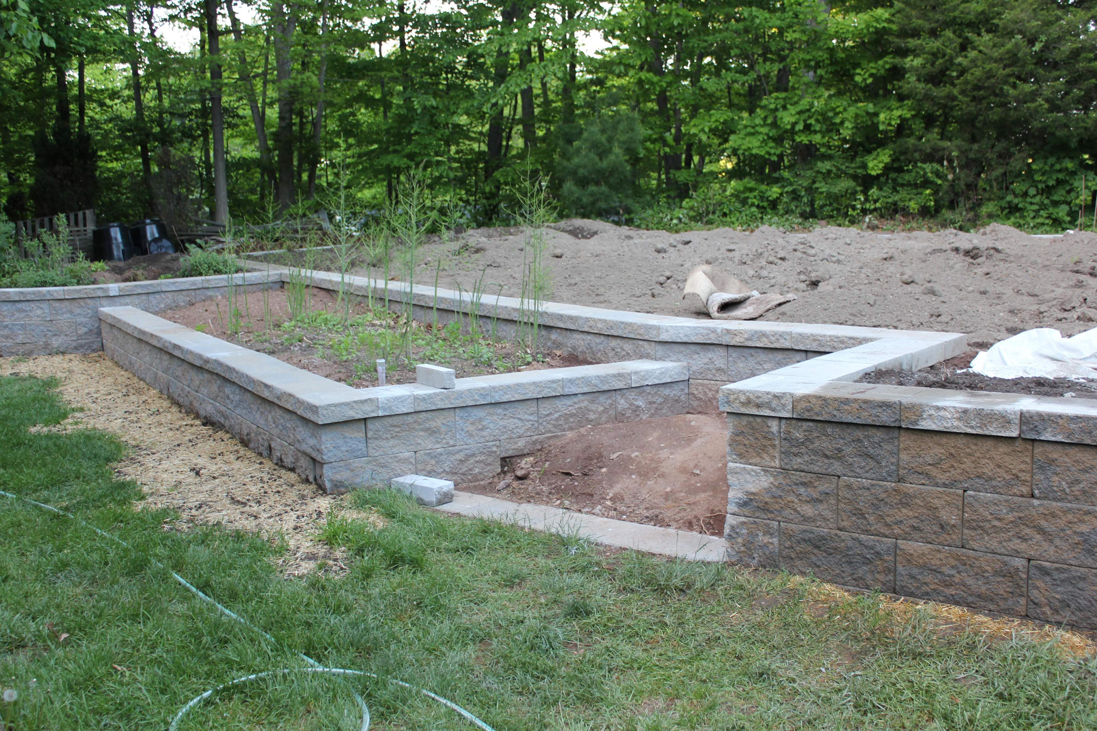

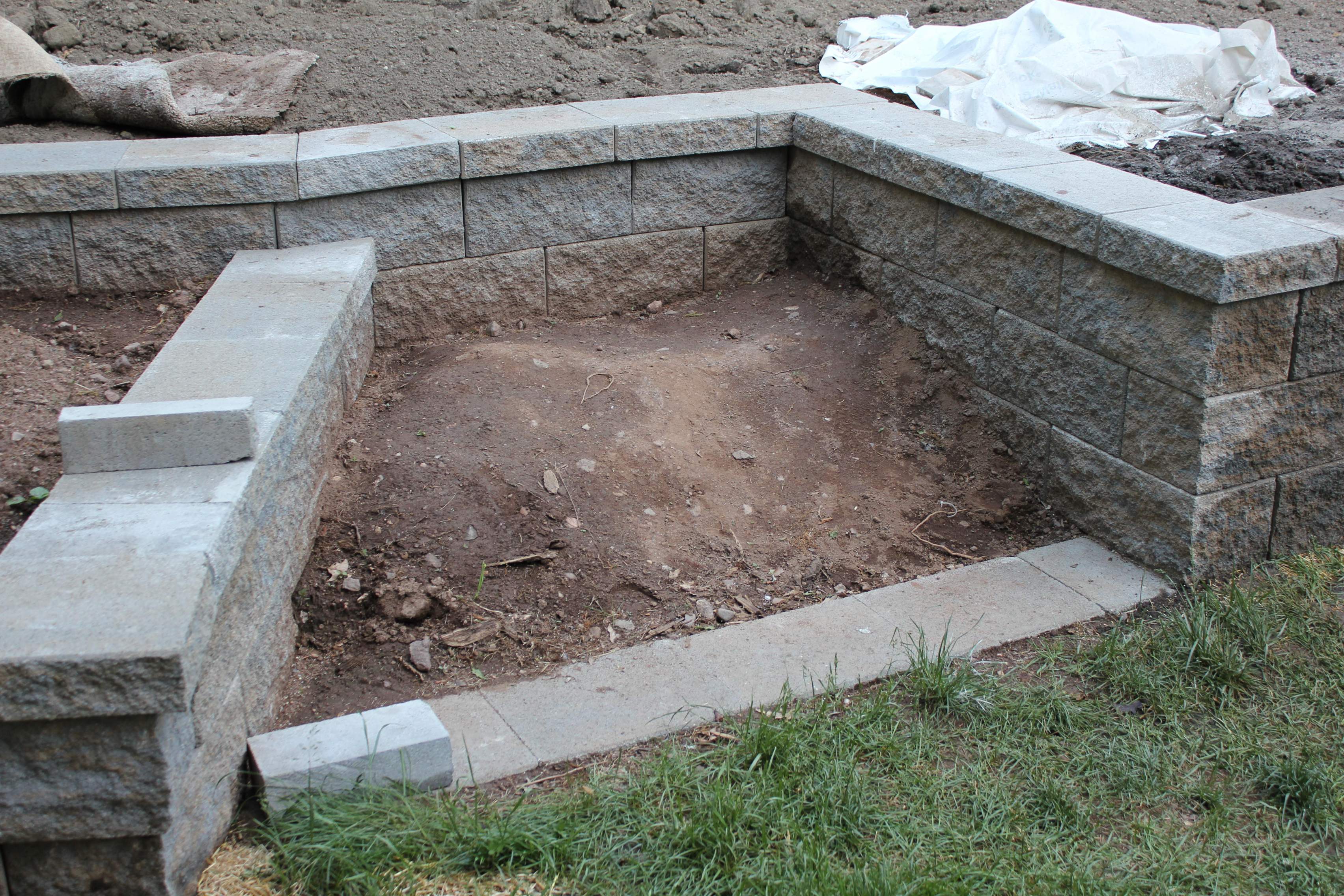

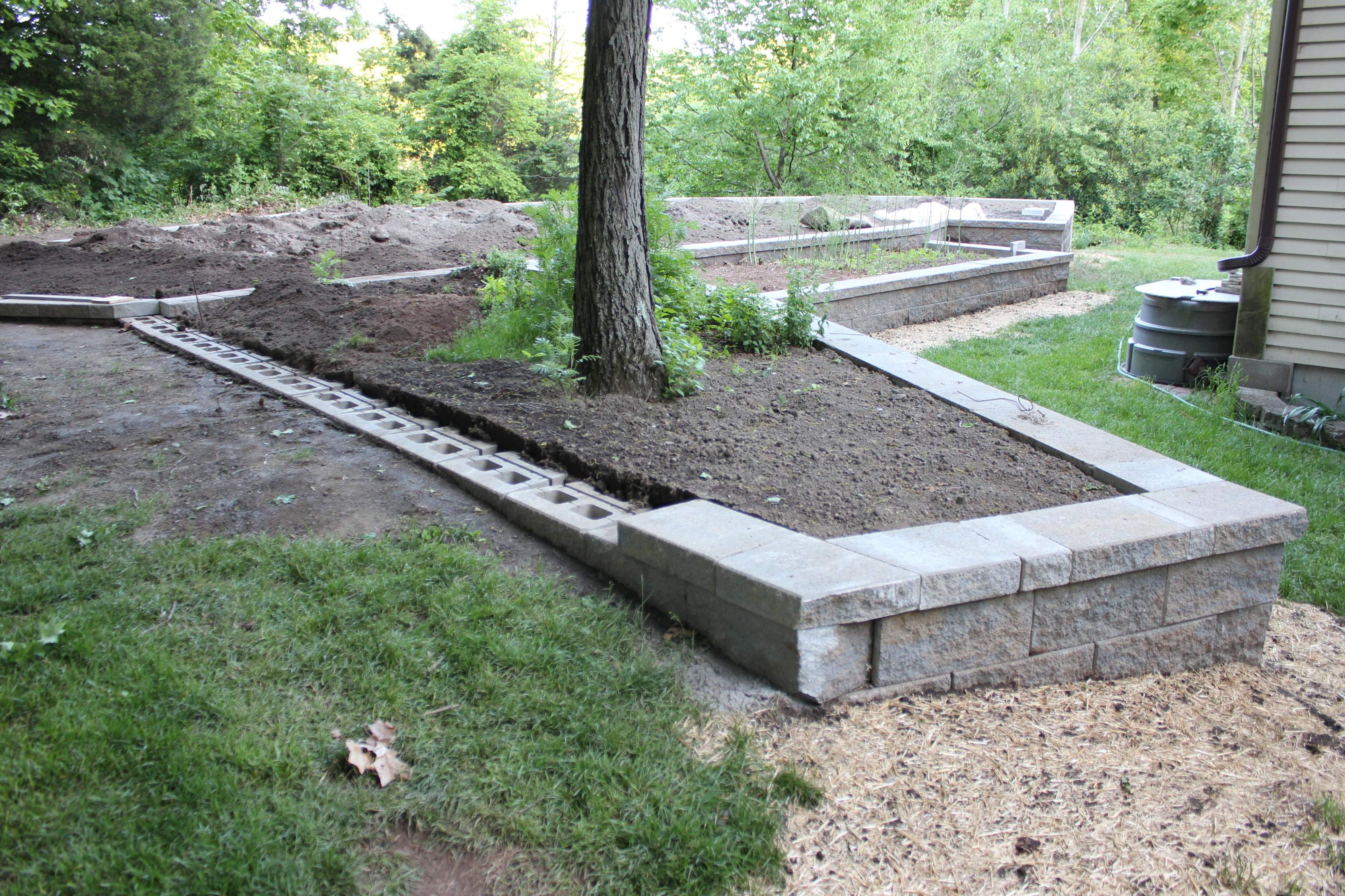

Sorry to take so long to post on the progress. Pictures will make it worth the wait!
The wall is nearly complete. Only short 16 cap. Infilled with approx 27 the 36 yards of topsoil that was delivered on the 7th. Rented a wet saw over last weekend and got all the cuts made to make the cap look like one solid unit. We went with the overhang. Thanks to everone that voiced their opinion on the matter.
Left to do: Get 16 more cap where we are short. Figure out what we are doing for the stairs. Glue the cap and install fencing on main part of the garden to keep the critters out.
Sidenote: Renting dumpster this weekend to get rid of 3 tons of rotting pressure treated lumber.
Any comments or suggestions regarding the fencing would be appreciated!!!
