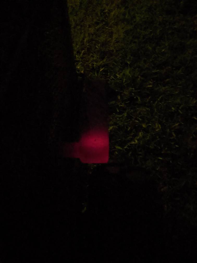

So... I ordered a stump grinder on Tuesday. It came today. Power-trac has been hanging around Amazon too much... 2 day shipping on a stump grinder and rake, haha. However, I know we talked about it and a few people said it didn't seem that great. I am here to tell you. That was wrong. I took out a stump in about 20-25 mins. As long as you don't try to dig into the stump too fast it works better than great!!! I took out two stumps this evening and will get more in the next couple days... I'll also get a video. I will say that I will be adding a bigger shield to it in the near future!!! View attachment 669951MVIMG_20200917_192442.jpg

How big was the stump? A six inch stump is easy, a 2 foot stump can take a while.
It was roughly 15" across. I didn't think to get a before picture cuz I was excited and wanted to play with my new toy.
My wife did tell me that it looks like a death blade on the front and that I need to be ready when the zombie apocalypse comes.
/ New PT-180 owner #155
My PT stump grinder works very well and quickly. But I have a PT1850. And I quickly reversed the direction of rotation to throw the chips away from me.
