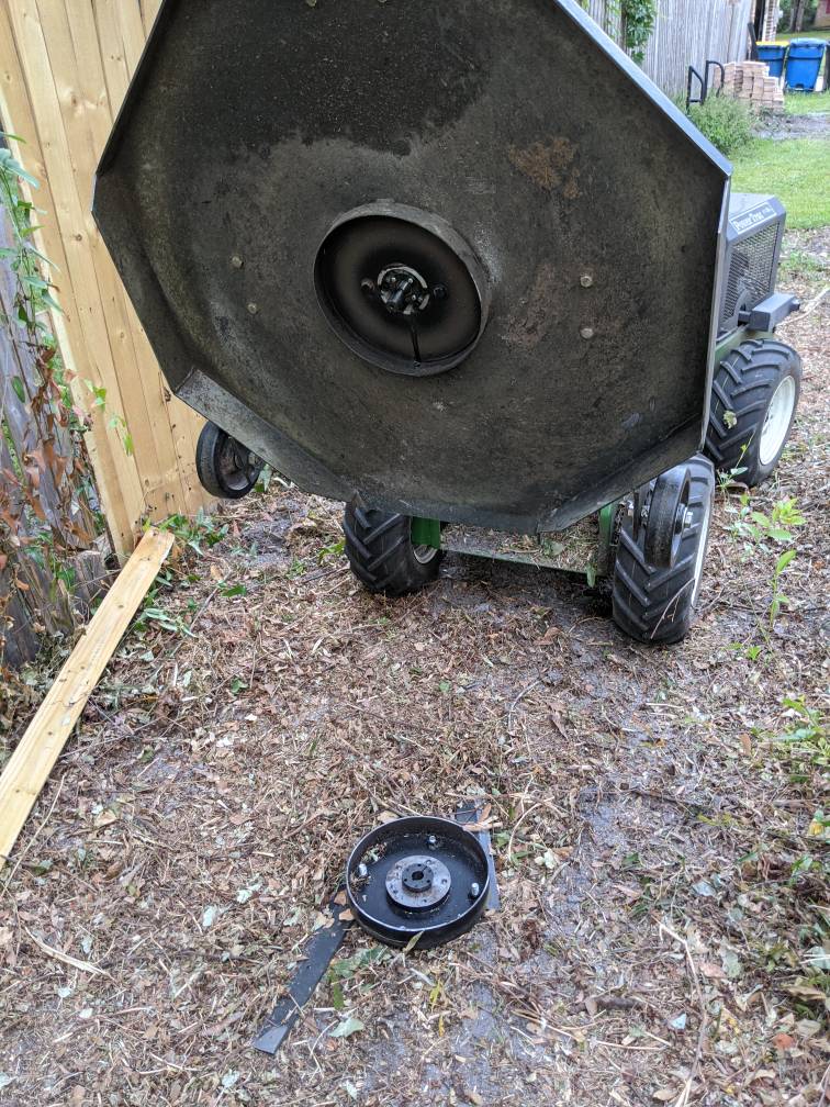

Now the bad. By brush cutter came apart. By came apart I mean the whole rotating assembly flew out from under the deck and hit my fence. Not sure what happened. There is nothing on the ground that I hit. Anyways, tomorrow I will dig into it and figure out what broke.
/ New PT-180 owner
#2

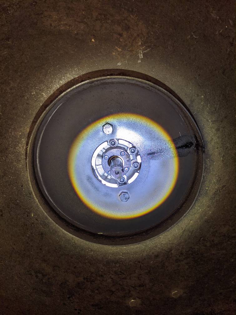

It's dark, but my flashlight is bright.IMG_20200508_221256.jpgIMG_20200508_221218.jpg

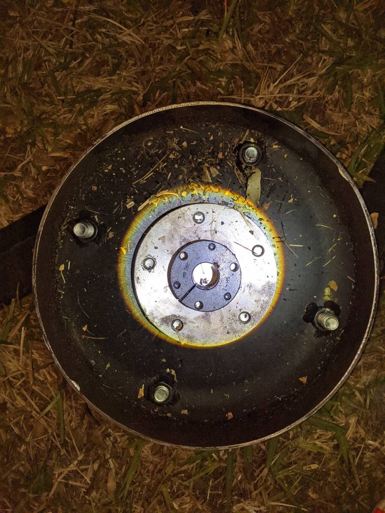

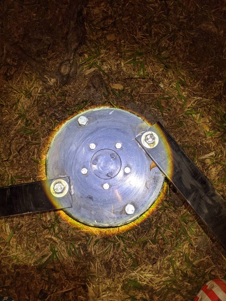

This is the underside of the hub assembly. The blades found a piece of metal probably 3 or 4 minutes before it decided to launch itself from the underside of the deck into my fence...IMG_20200508_221944.jpgIMG_20200508_221949.jpgIMG_20200508_221955.jpg

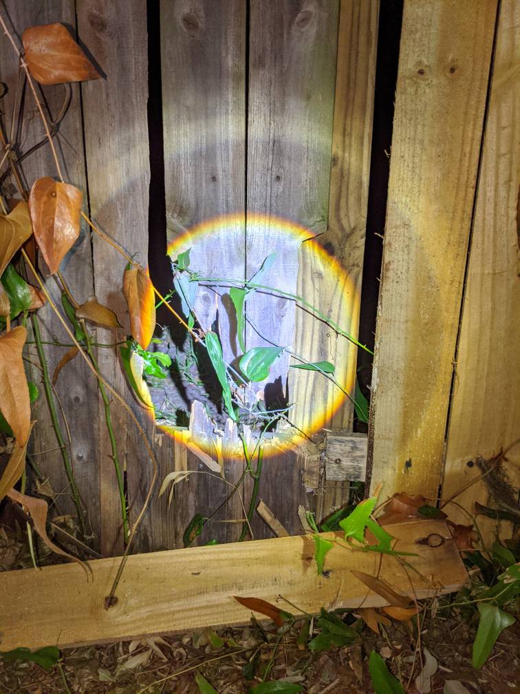

Luckily I have extra pieces of fence to fix these.. hazards of living in a hurricane prone area where I have had to replace fencing numerous times over the 5 years we have lived in the house.IMG_20200508_222212.jpg

OK. Yours is definitely different than mine for the 425.
from the underside, mine only had two bolts for the blades, and two spare bolts for spare blade location. Mine has the 5 lug bolts on the top, not the bottom like yours.
Looks like maybe your set screw came off of the shaft.
I'd take those 5 bolts off the underside to get that hub off of the drum and then see how that hub attaches to your shaft. Hopefully, all it will be is a set screw had backed out and you may have lost a key way stick.
Get those 5 bolts off and see if the hub will slide back onto the shaft and lock in place. If so, you may be good to just put the drum back on with the 5 bolts.

/ New PT-180 owner #10
Looks like a taper lock, probably not tightened at the factory. Call them and they will send you a new key and bolts.
Edit:: just looked at the second set of pictures. Definitely a taper lock. Those three small bolts on the bottom pull the keyed inner piece into a cone. Much stronger than any other way to attach. You can remove the three bolts and see if the tapered part can be removed by hand. If it can, they never tightened it. There should be holes between the three that are threaded on the outer part. You use the bolts to push the taper out.
Glad no one got hurt..
Take three bolts out, put into threaded holes on opposite side, tighten increments until the center becomes loose. Put key on shaft and slide taper on shaft with flange toward deck. Mount center hub on taper lining up the three bolts holes. Put three bolts back in from bottom and tighten in incremented until they are good and snug.
Good luck.
