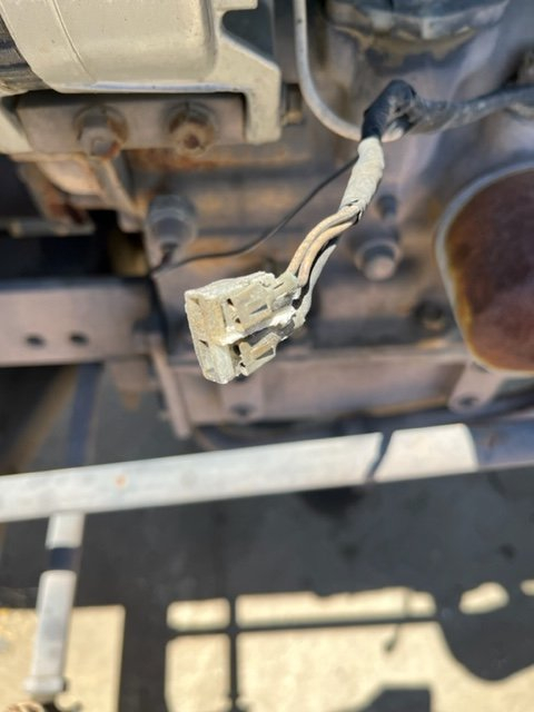

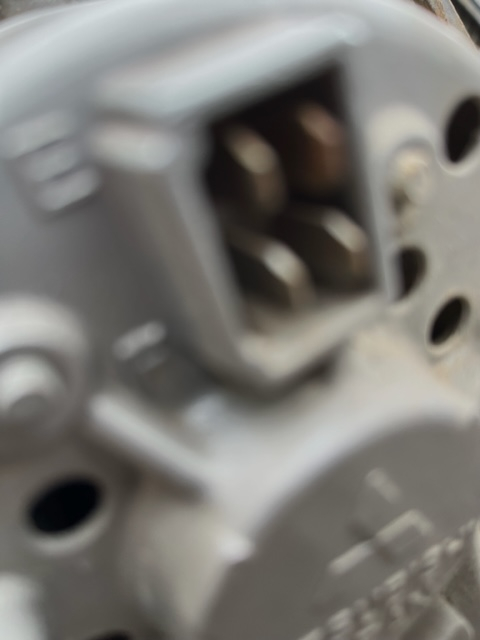

More on my project , still waiting on water pump to come back. The connector to the altenator is sun damage as far as falling off , so I'm looking for a replacement connector. The connector is 4 wire and that back of altenator looks like this

#23
I need to know the wiring for this connector , not sure if I can make out the colors so may have to trace

#24
still looking for help finding the correct connector
/ new project #26
The number that I have found is 34145-70010. I have not found any listed for that number. I can't get mine fixed I will go to making an electric pump to work
Wrong number. That's just a part serial number, no hits on the web at all.
The model is AH2015S Alternator. You can find it all day long on the web.
This alternator is used on Shibarura, Hinomoto, Yanmar and a few Kubotas too. It's automotive origins are on Mazdas from the 1970s into the 80s. Like the popular Mazda 323, later becoming the Mazda Series 3. It's also used on some Mitsubishi forklifts.

#32
How do you change from 4 wire to 2 wire ? which 2 do you use and what do you do with the other 2 ? What about using a 1 wire ?
/ new project #33
My machine uses the 4 wire setup. 2 wires on the female Delphi connector spade terminals and then 2 eyelet wires that are tightened down.

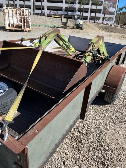

#36
I now have the FEL it is a JD. think it maybe a model 70 the bucket is 53 inches. Now I need to make the mounts and get some parts. I need a 2 spool control valve , I have found a 11gpm on e bay is that a good one to use ? I need the parts to tap into the hydraulic system , is there an adapter that mounts to the pump ?

#38

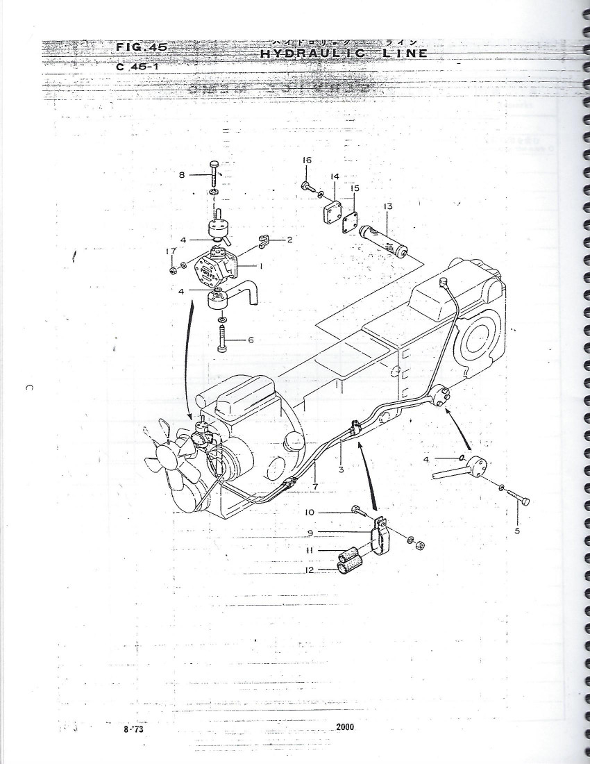

I have found the control for the loader , I need to know how and where to splice the hyd line to connect to the loader valve.

here is a page from the manual I have , is at the top wher I spice into the hyd pressure line

/ new project #40
I usually cut the pressure line & braze pipe fittings on the cut ends, Bell adapters work good. You can drill the line side to the size you need. Run the pump side to the IN on the valve & the OUT to the other cut line.
