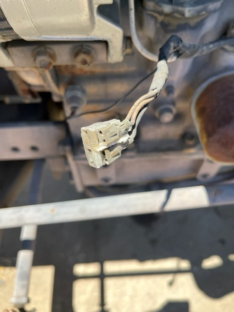

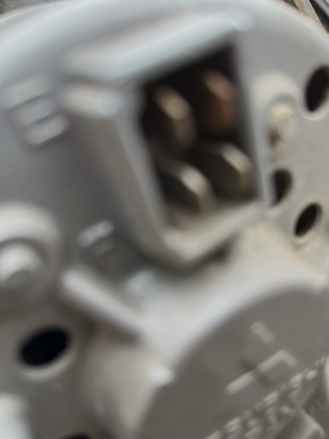

More on my project , still waiting on water pump to come back. The connector to the altenator is sun damage as far as falling off , so I'm looking for a replacement connector. The connector is 4 wire and that back of altenator looks like this

I need to know the wiring for this connector , not sure if I can make out the colors so may have to trace

still looking for help finding the correct connector

The number that I have found is 34145-70010. I have not found any listed for that number. I can't get mine fixed I will go to making an electric pump to work
Wrong number. That's just a part serial number, no hits on the web at all.
The model is AH2015S Alternator. You can find it all day long on the web.
This alternator is used on Shibarura, Hinomoto, Yanmar and a few Kubotas too. It's automotive origins are on Mazdas from the 1970s into the 80s. Like the popular Mazda 323, later becoming the Mazda Series 3. It's also used on some Mitsubishi forklifts.
