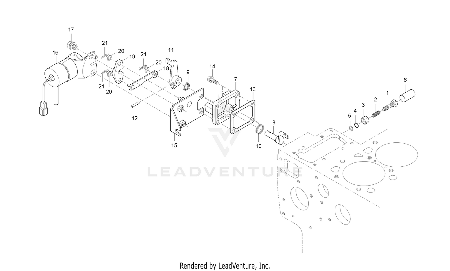

Have you checked your fuel cutout valve? Sounds like the open relay is allowing fuel while cranking then the hold relay may not be holding the valve open and fuel not flowing.

Where is this located ? I ordered a lift pump. Theyre cheap. Wil do some more diagnostics when its not 33 degrees and raining.
/ 2013 DK55 starts and stops immediately #5
I think #16, but I believe it is controlled by relays. This is from Michigan Iron's on line parts. The relays are probably on the firewall.
I'm sure there's others here that have this tractor and can be more help.
Good luck.
Patrick
