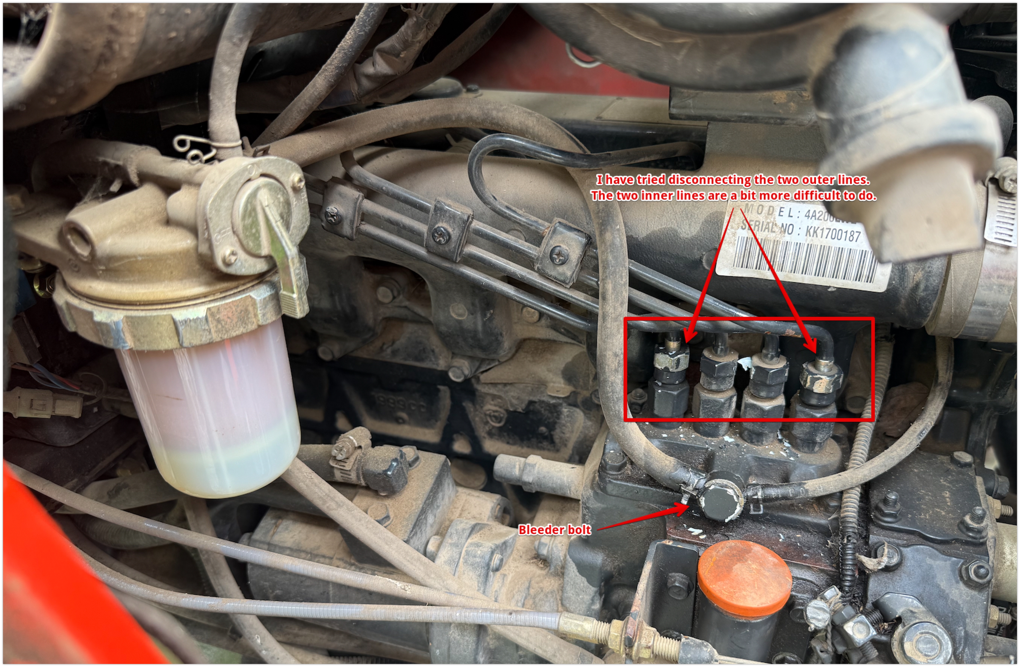

My DS4110 has an inoperable fuel gauge, so I rely on visual inspection of the tank to determine fuel level. The other day, she wouldn't start, but cranked fine. The fuel looked low, but certainly not empty. I grabbed a can of diesel (filled last summer and stored in the unheated shop all winter), and filled the tank up. This definitely stirred the tank up and aerated the fuel. Turned the key, started right up, I completed the 5 minute task at hand, and parked her. The next morning, just cranked, no start.
My assumption was that air, sediment, or both were introduced into the system. I purged any air from the filter housing using the "air" position on the petcock, nothing. When I loosen the bleeder bolt, fuel just runs out, so I don't think it's a problem between the tank and the injection pump. I disconnected the first fuel line coming out of the injector pump, turned the key, and it started, but I shut it right back off. I then reconnected the fuel line and turned the key, just cranked, no start. I've not gotten it to start again since.
I do notice that when I disconnect a fuel line or two from the injector pump and crank the engine, I don't really see any fuel coming out of the ports - although when I disconnected the first line for the first time, fuel ran out of the line itself.
Maybe worth noting is that the fuel looks and smells fine to me, but what do I know? Do I need to drain and flush the whole system and start with fresh fuel?
I'm kind of at a loss at this point.
Here's a picture for reference:

That bleeder bolt looks like a banjo fitting to me, and while it will allow a bleed function, I don't think it was made to be "bleed here". It sounds like you have introduced air into your system, which is a pain in the rear for diesels. You are probably going to need to follow the proper bleeding procedures to get it to run. (which is rough on a battery and starter, so be easy on them!!) I suggest a charger hooked to battery, and a lot of patience to make it easy on the starter. You will need a helper to run the starter and another person at the injectors to loosen the nut while cranking. Once you get diesel coming out of the injectors, tighten the nut while still cranking. Then give the starter a rest, go get a drink of water and go on to the next one. (read your manual for proper way to do this)

Thanks for the quick reply. Actually, using that bleeder bolt is a step in the manual. When you say to loosen the injector nut, do you mean on the top of the injector pump where I have it noted in my photo or at the injector itself?

Thanks for all of the additional suggestions. I finally got to get back out to it today. Turns out that @Snezzy had the right idea.
I checked the connector at the solenoid and it appeared to be good: one lead had constant 12v when the key is on and the other had a 12v burst for one second when the key is turned on, but the solenoid still didn't pull. A replacement solenoid also didn't pull. I then found a post from a guy saying he had a bad pull relay but could get around it by removing the solenoid, turning the key, pushing in the plunger, making sure it held, and then reinstalling it before starting. I tested those steps up to seeing if the plunger remained pulled. Bingo.
I located the relay (thank you workshop manual) and noticed that I could push the connector onto the relay an additional 1/8"-1/4". It then successfully pulled several key turns in a row and started right up when tried. I'm really thinking I've gotten this nailed down at this point and I will be getting a new relay to keep on hand in case this one gives out completely.
Turns out if I had slowed down and fully read this post, I would’ve/could’ve gotten here sooner.
