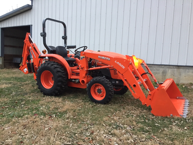

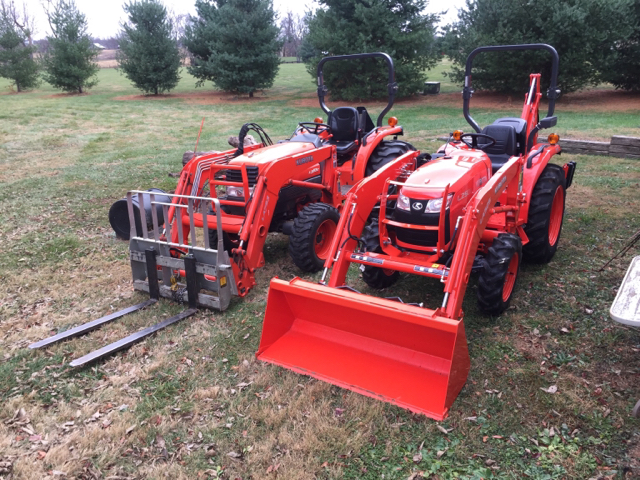

Well I just got a new L2501 with front loader and backhoe. The engine seems really loud! The exhaust has a metallic rattle sound to it. My L3830 is much quieter sounding.
Using a dosimeter app on my phone I measured around 92 db at 1700 RPM. My L3830 is running around 90 db. The L2501 has a harsh exhaust note like a hammer hitting an anvil.
I'm curious if anyone else thinks their L2501, L3301, or L3901 is loud. I'm planning to drive another L2501 at dealer when I head down
there.
One thing to note. The tractor has off-road diesel in it. Not sure if that would make it run louder or not.
I've attached a pic of my two Kubota since we all like pics!

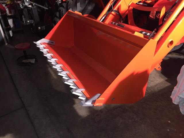

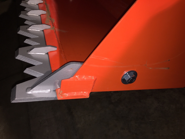

The tooth bar is a Piranha from BXPanded. I have one on my L3830 72" bucket as well. I installed both of them. Eventually I will make a video about it. They improve digging ability of loader by 100%!

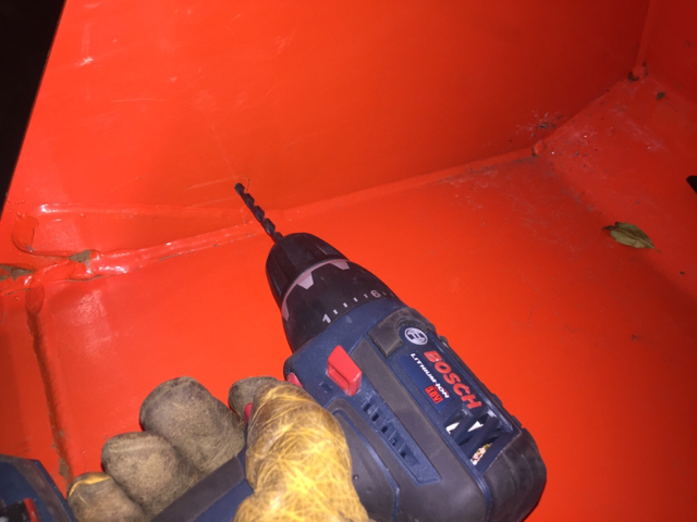

I wonder if the mounting holes on the side need drilled or come standard. I'm not too familiar with Kubota buckets, my bucket has the holes along the cutting edge.

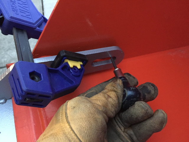

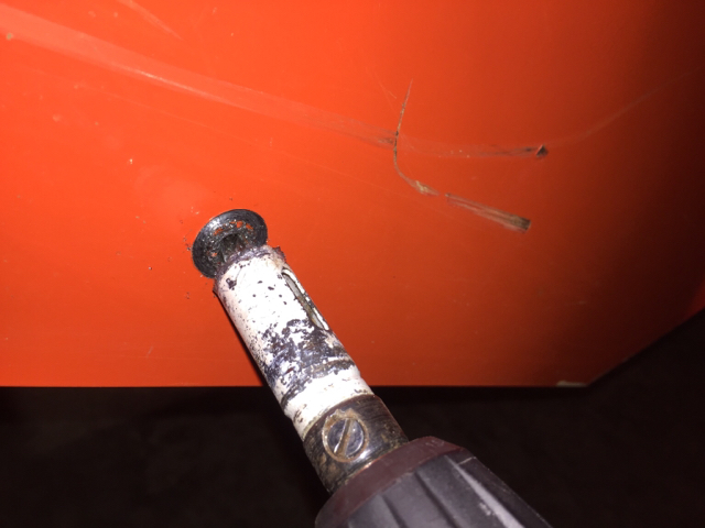

The bucket has to be drilled. It's not bad at all. I use a hole saw. I'll attach a few pics.
The toothbar works great. It's similar to a serrated knife. Cuts into dirt like butter and makes the loader much easier to control. Also it works great when ripping out saplings and brush. The teeth bites and rips saplings out by roots. It also works well when back dragging. Many toothbars don't work well when back dragging.
