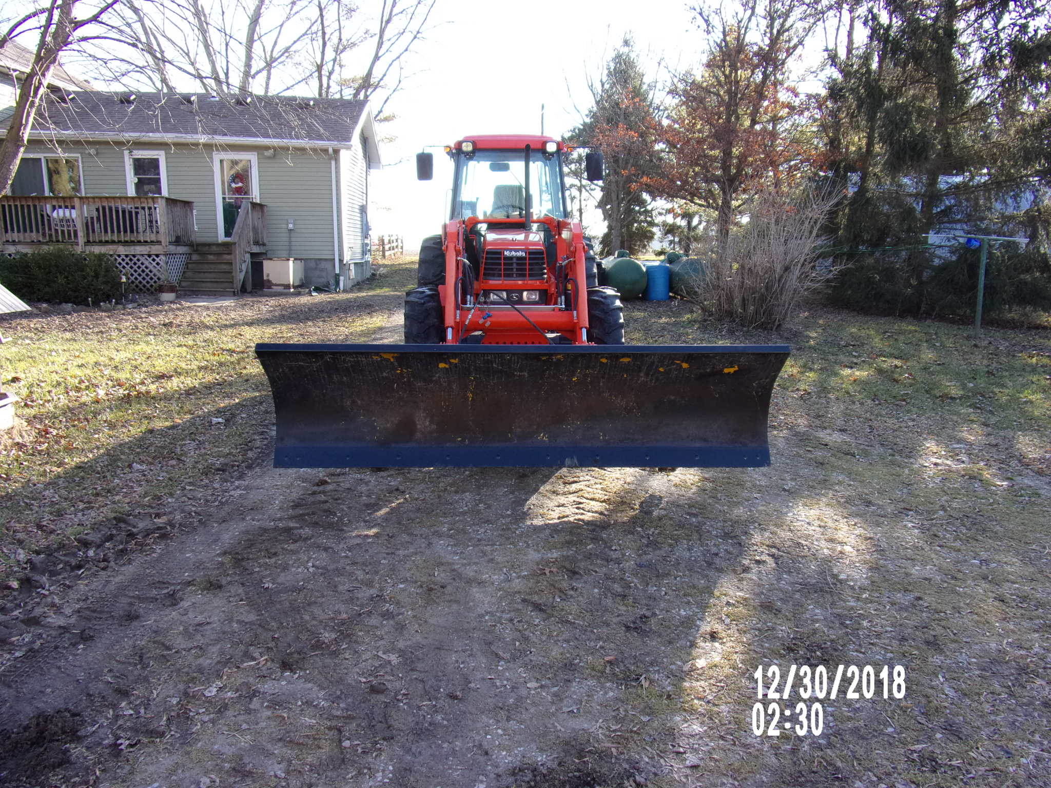

Not good. Haven't had an issue with mine yet and I do a lot of loader work as in moving and loading round bales but I've always ran 85-140 on the front axle and outboards. In fact that is the first thing I did was drop the UDT and change to gear oil. Do a lot of snowplowing too in the winter, almost 2 miles from there to the pavement...
I change the oil in the front axle every time I change the hydraulic oil too.
Don't know about tires, all I run are R1's.
