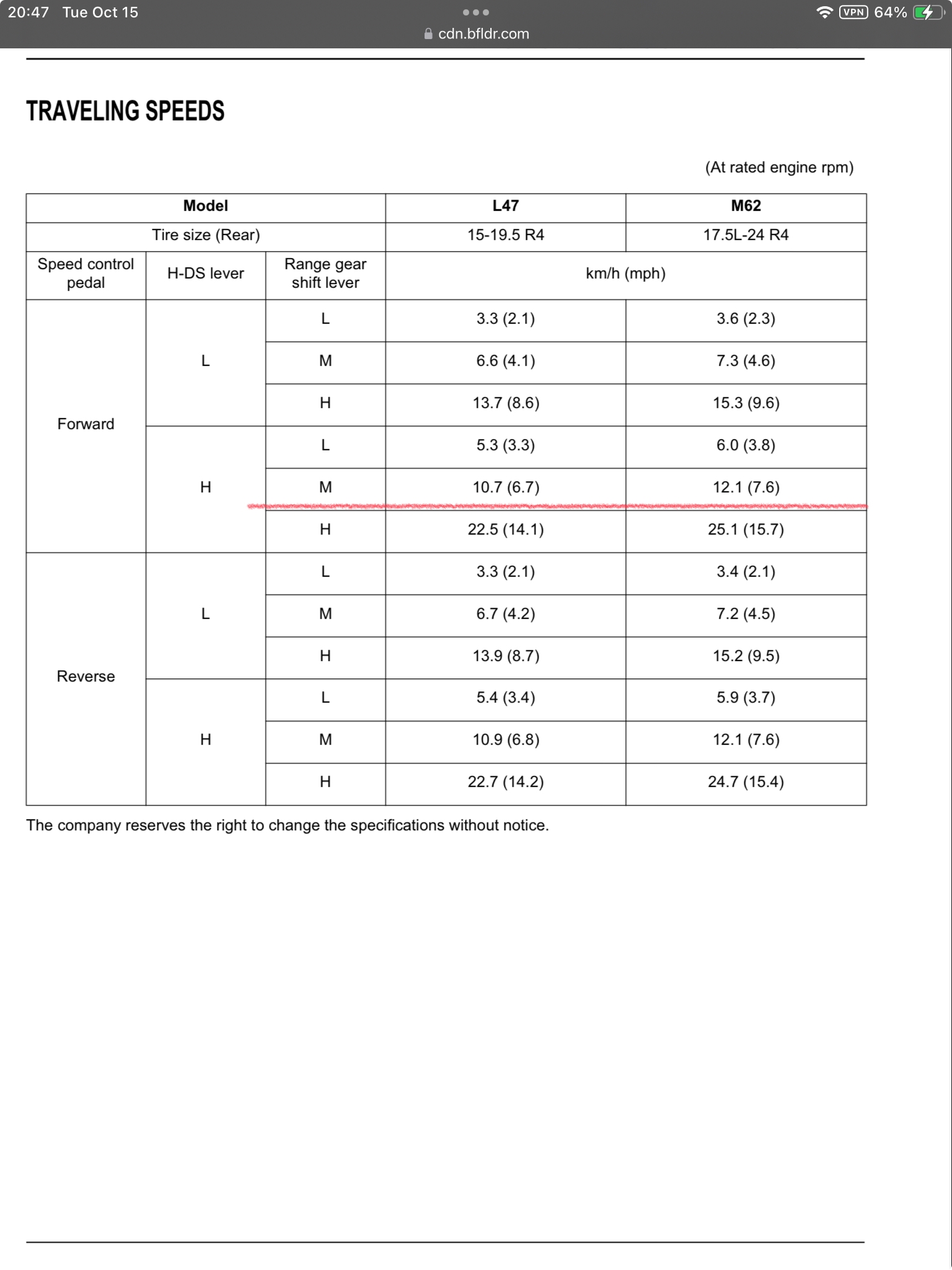

All of a sudden a few weeks ago it felt like our M62 was a bit slower at the usual Medium HST settings.
If anyone has an M62, could they check what its speed is at the Medium gear range with the Rabbit setting? On level ground, ours is going about 6km/hour.
This would be a big help before we truck it over to the dealership. Everything else on the tractor seems fine and it goes pretty fast in the High gear range.
Thanks in advance for any help.
   / A little help from anyone with a Kubota M62. #2
Yours seems slow

Thanks.
That's a very useful table - where did it come from? Do you know how many RPM's?
   / A little help from anyone with a Kubota M62. #4
That's in the owner's manual. The rated rpm is 2700, which is what those speeds are based on. I found it on Kubota Canada's www site.
