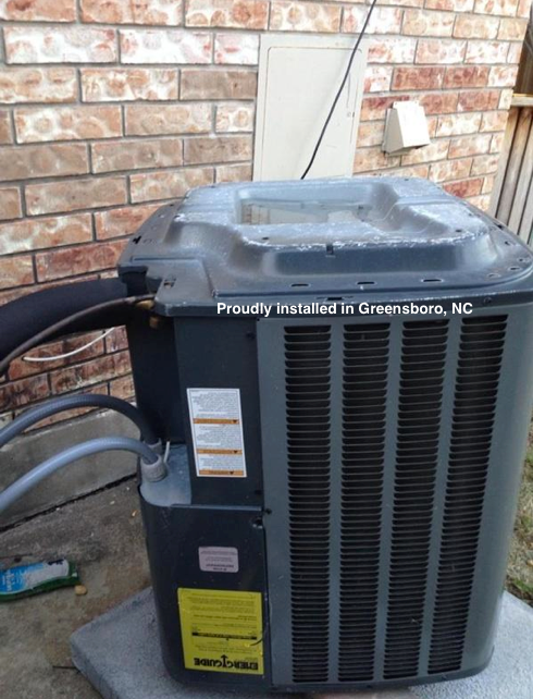

Just for you. My director of technical services asked me how I edited the photo LOL Do a websearch. It's an original picture I assure you.
well, You win the award ! I thought I had seen just about everything. But, I have never seen this:laughing:
