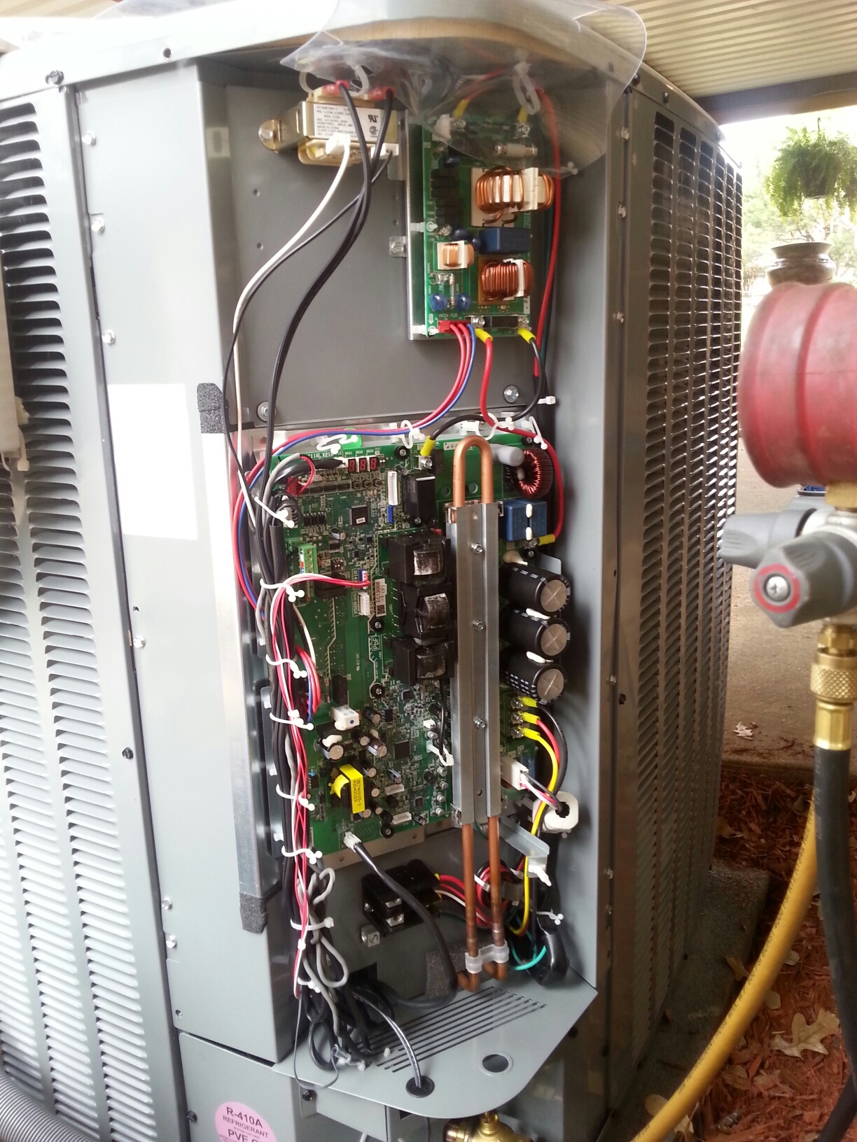

if you are considering a VRF system, get ready to come off some bucks. They ain't cheap. about 20 k to install a 2.5 -3 ton VRF system. You talk about electronics . the VRF units are loaded
I helped design what we believed was the original VRF drive (mid 1980's GE),,,
the cost should be down to $100 per unit by now,,, :confused2:
Oh, well,, somebody has to get rich,,I guess. :thumbsup:
Not me,,, :laughing:
