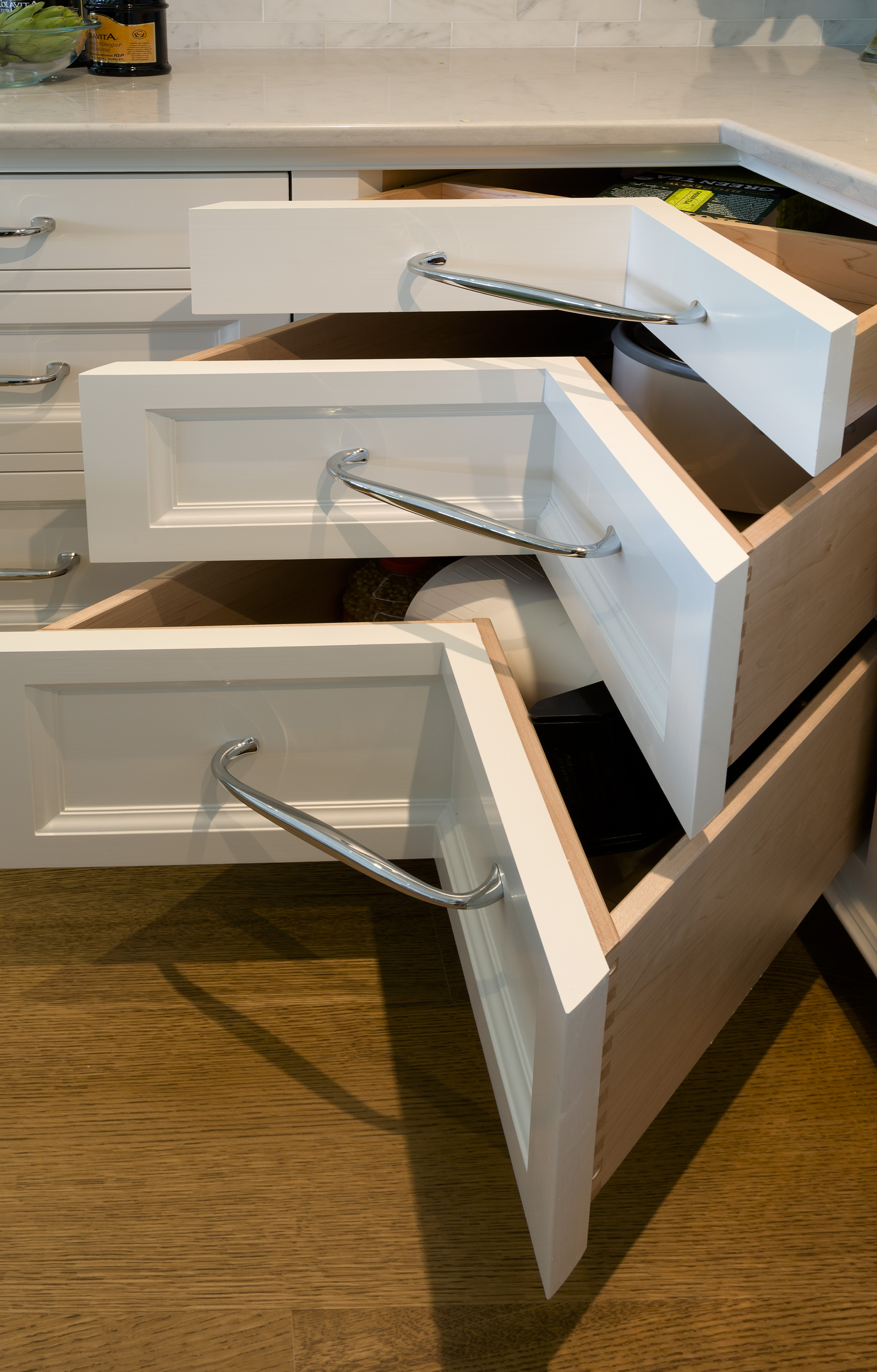

In my previous house we had a corner of cabinets in the kitchen like you do in yours. A lot of space hard to get to on top and bottom The house we are in now has an angled pantry in that corner and it is a so much better use of space. The refrigerator is on one side and double oven on the other.

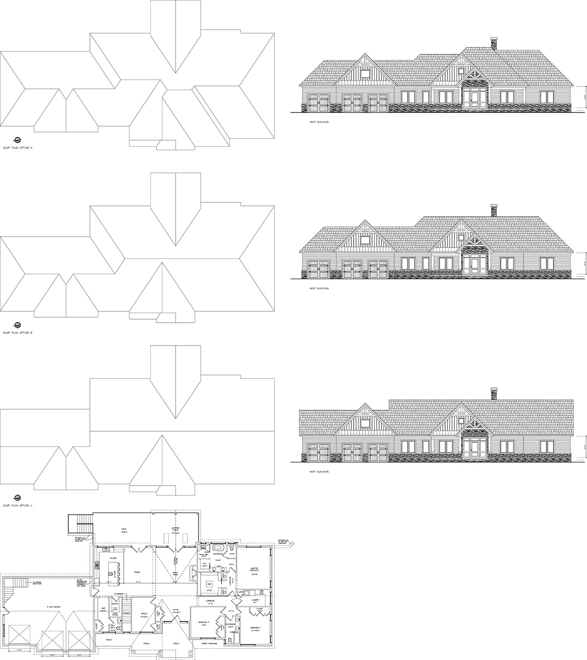

Going to try going with something like this:
Figured I would also show other possible rooflines and elevations:
never seen base cab drawers like that before...interesting......what kind of hardware are they using as I don't see any side mounted slides.....I would think there would be a lot of stress on it so must be something heavy duty.......Jack

How to make maximum use of dreaded kitchen corner- the initial design.IMG_2187.JPG
Your corner cabinet will go straight back so you will not be using the space in each back corner and the space in the front corners, in the small triangles, is really not usable. The cabinet above in the corner will have an access problem on the upper shelves because of the reach.
Open to suggestions. At this point we're pretty happy with what we have. Can't change a lot without drastically changing the rest I don't believe.
