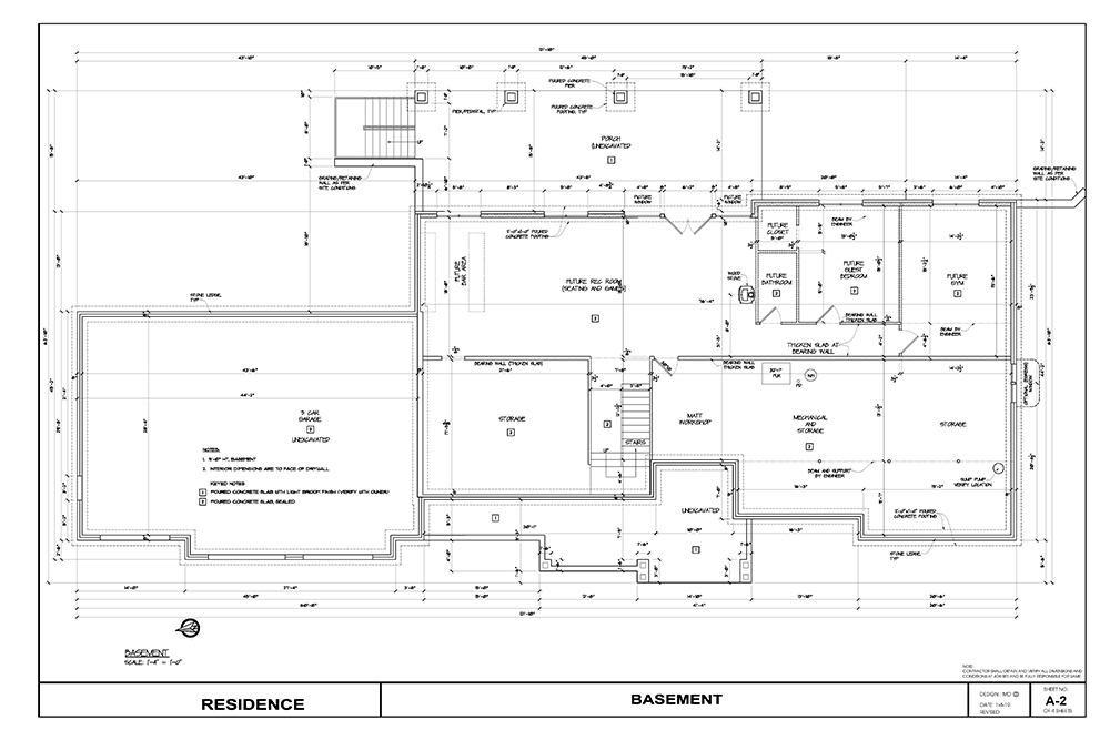

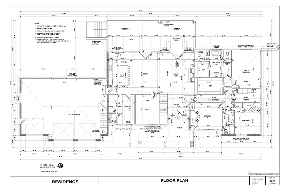

House plan is done (changed a few things), and filing for permits soon. Plan to break ground in June. We just had the driveway built (excavator finished yesterday), septic system is designed and permit issued, PPL plans are done, staked, and just waiting for good weather to put in. Well will be drilled asap weather permitting.
I MAY start a build thread, but not sure if I'm ambitious enough to keep up with it. :)

The plans look good. Call me strange, but I always like a separate closed door "poop room" in the master bath. Some things you don't want to share!

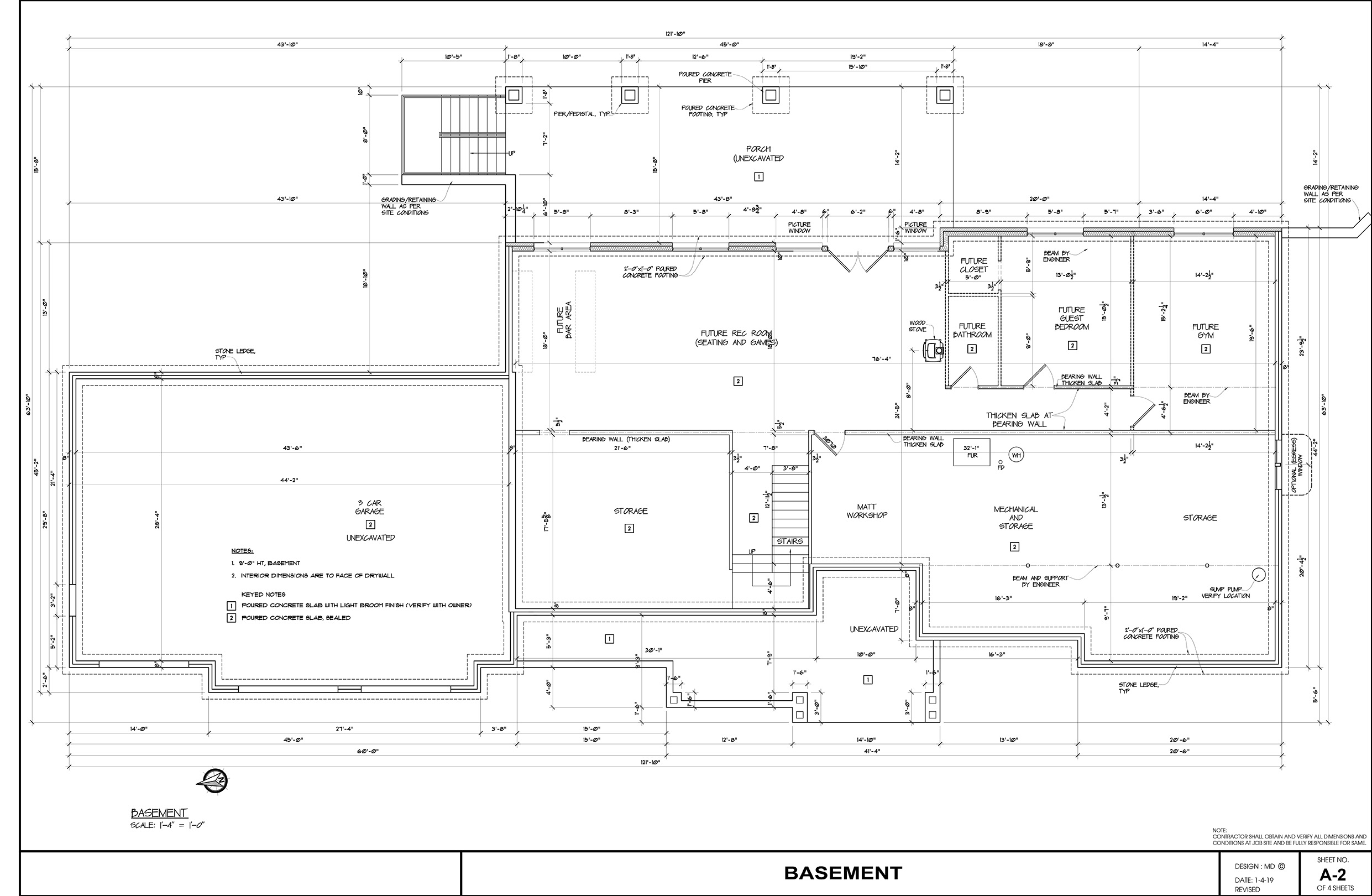

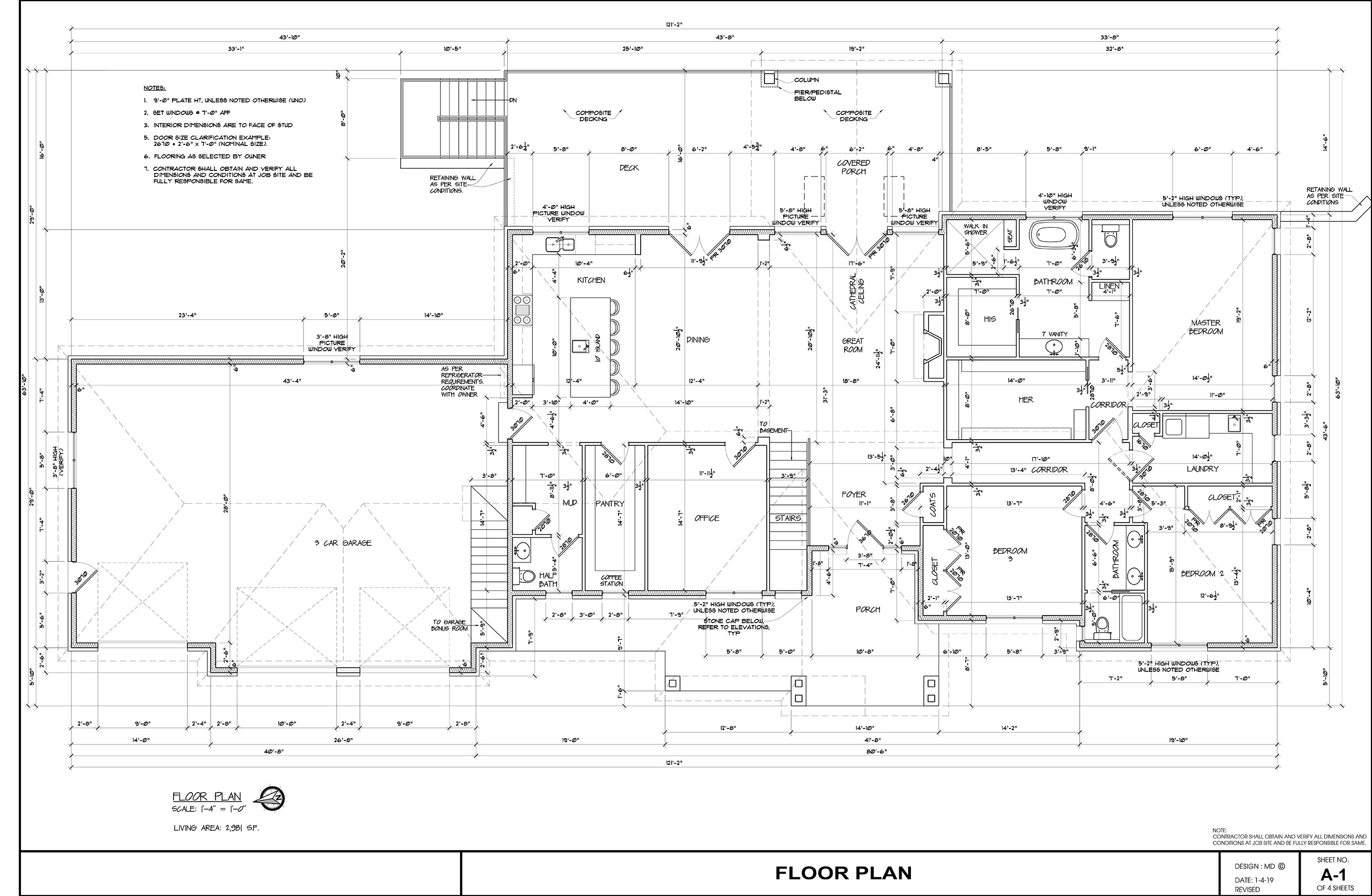

Updated with better sized files...I think :)

On the garage, I can't read the dimensions very well, so I might be off here a little bit, but I'm wondering where you will put your workbench and tools in there? I've also found that having a sink in the garage is a must have thing. My parents have 9 foot garage doors on their house and it's a bit tight. I have a ten foot door on mine and I think it's a huge difference. Is there a reason to have the walk through door where it is on the side of the garage? Seems kind of awkward getting in and out of there with something parked inside the garage. How committed are you to having storage above your garage? To do this, you are going to pay a fortune to have it strong enough to put anything up there. With all that space in your basement, it's a very big expense to span the garage without using posts to be able to support the load that ends up just sitting up there. If it was me, I would get rid of those stairs and put the walk in door where they are, then truss the roof over the garage and blow in two feet of insulation over that area.
Kitchen looks nice, but I would bump the wall out into the garage behind the refrigerator so you have enough depth for the front to line up with the cabinets.
Master Shower looks plenty big enough. I would make sure that the faucet is on the left wall as you walk into it because you wont have to deal with cold water coming out of it when you first turn it on. Any other location will make it hard to turn it on and not get wet.

As for the garage, we really want the storage up there as I'm giving up a 30x40 two story barn I currently have when we build. We're bursting now as is, and since the basement will eventually be partially finished, it won't be all storage, so the space above the garage is important to us. We're doing a 10' door in the middle, flanked by two 9'. The garage is 30'6" deep (28' deep at the one bay that is set in), so I should have a good amount of room toward the back for shelves/cabinets and a small workbench. The majority of my non-auto workspace will be in the basement since it's a fully exposed walkout (and I plan to have large doors in there as well).
The shower is the one space I'm hoping doesn't end up being too small. We also removed the window that was originally in place for the shower. I think we're going to miss the light it would provide, but windows in showers make me nervous.
