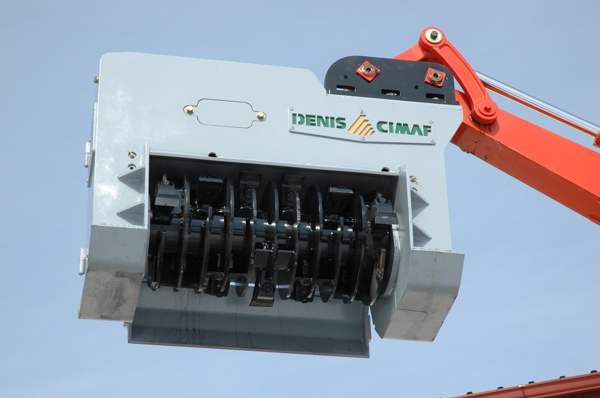

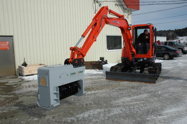

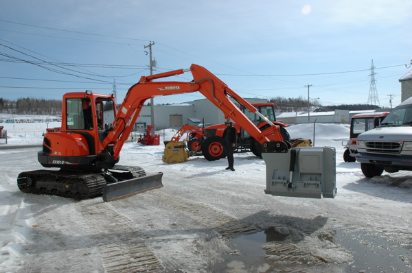

Here is our newest arrival. It is the DAH-080C. It is for 8 ton and up excavators. Testing soon to follow. As you can tell by the snow in the pictures they were taken in the far north. Also you can see in the pictures this unit has the optional door to control debri being thrown.

I'll answer the obvious. Yes it is pictured on a 161. This was a photo shoot/ test to see just what the 161 would think about the head. 1200 lbs. was a bit too much.

Looks mean! How about some more info. How wide is it? Did the 161 run the head good or was it mounted just for the pictures? Price? Whens the Connecticut demo?
/ New Cimaf Excavator head
The cutting width is 32". The weight is just to much for the 161. The head weights about 1200 lbs. A tad more with the door and cylinder. My brushhound weighted 600 lbs and gave my 161 what for. Coupled with the hyd flow required I think a customer would be dispointed with it's performance on a 161. But we plan to test the head on the 080 with the 18 gpm setting and see just what it will do. If it will cut good and just the weight is a factor then we can always counterweight. That all will be determined with our tests. Price as you see it with the debri door is approx. 34k. I think it will be great cutting, mid sized excavator that is easily trailered. Head with an Kubota 080 should be right at 100K. Very close to a large skid with a head.

  • Hydraulic motor is a variable displacement axial piston motor. That's more expensive than a fixed displacement motor, and of course much more than a gear motor. But it gives better efficiency, allows rotor to recover faster, generate less heat and allows installation different kind of carriers without changing the motor.
  • Drive system uses a cogged belt (timing-type belt). That's more expensive than a V-belt, but it doesn't slip as easily. And its required tension is pretty slack compared to V-belt, saving on the life of the bearings.
  • And as said Robbie, whole frame is just industrial, heavy-duty type. We understand that on smaller excavators, there might be a bigger market for less-sturdy and more-affordable machines. But going that way would mean to reach for lowest possible cost in order to be able to compete with other big international manufacturers. And you know where that leads manufacturing operations (hints: Olympics will be held there this year).
