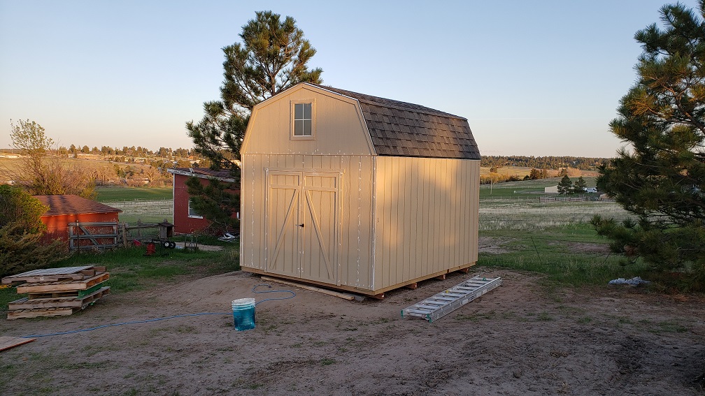

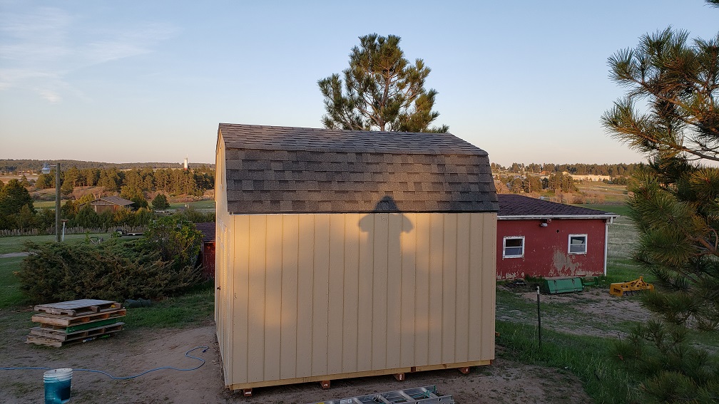

Got it done to the point where I can start using it. I still need to finish sealing, paint add skirting, a bit of dirt work, and add some rock around it. I'll probably slow down a bit now that it has a roof and I can use it.
This was the first time I put on a roof on my own. I'm not a fan of heights, but it went pretty well.
   / New Building! #12
Good job. Looks like a perfect fit for your mower!!!
   / New Building! #13
Good job! Nothing like having a place to put stuff.

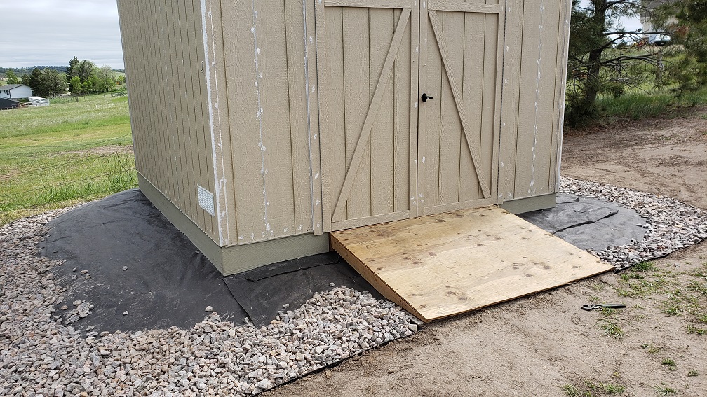

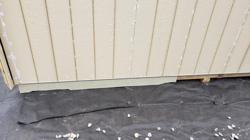

I finished this up a couple of weeks ago, but I've been slacking on posting the pictures. I put down weed barrier for the rock and added scribed pieces of cement-board siding to keep critters out. I went with cement board to make sure it wouldn't pull up moisture. It worked out pretty well. A grinder with a masonry cutter (and a good dust mask) was the easiest way to cut it to the profile.

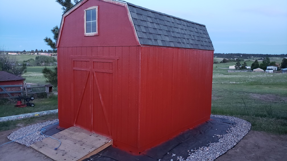

Like the red paint also. The building looks good.
What kind of paint did you use. Every time I buy a barn red paint it doesnt look red to me.
But some darker shade.

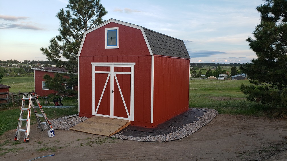

I just got exterior paint from Lowes. I forget the exact color name. I just grabbed a bunch of red samples and let my wife pick. I was worried it was too dark until I got the white trim done.
   / New Building! #18
Thanks I will check Lowes out. Will show them your pics and tell them thats the color I wantšŸ˜›
The white trim really sets it off.
