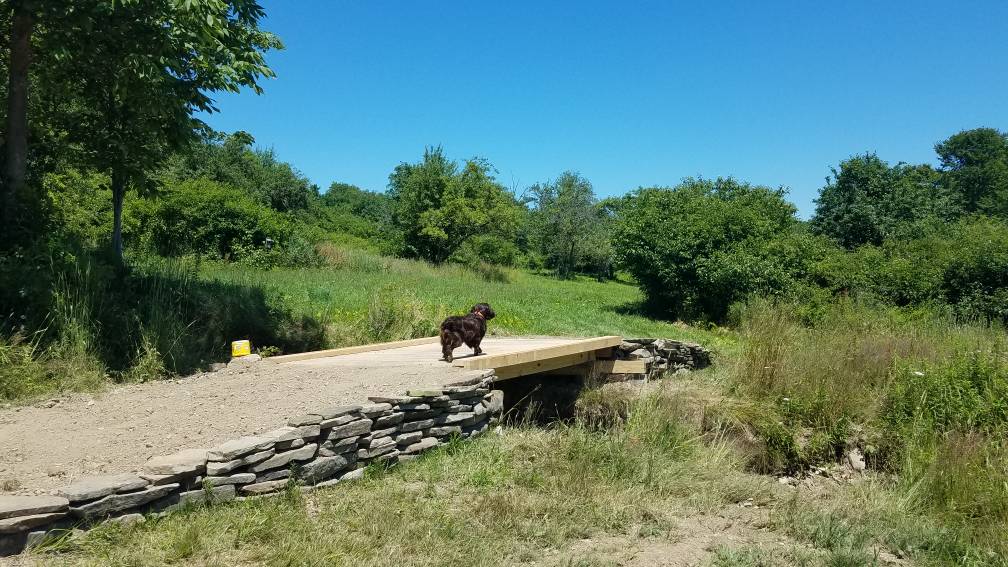

Last springs heavy rains washed out my old bridge.
This run off is 4-5 feet deep and only 8 feet across. Dry except for rains , then it's a raging torrent.
Used beams made of 4 sandwiched 2×10.
They sit on top of 36 inch utility pole sections buried. Three beams total.
Rough cut hemlock deck
Field stone accent on earth ramps.

Very nice looking bridge. Did you cover the sides before the bridge to prevent washouts?

Looks nice. I need more details and pictures so I can duplicate it :)

I have no idea what you take across your bridge,
when we put in culverts or bridges we also have a creek crossing that we use for heavy and or wide loads,
gentle slopes down in and out with large rock lining the bottom 8-12 inch rocks driven in smooth.
also, very nice looking bridge

Mind sharing how much total cost you have into it? I need to make something similar for my creek.
/ New bridge 4 new tractor
#14
I got 10 foot pieces on new utility poles from a lineman buddy.
The pressure treated lumber and the hemlock came from a mill nearby. It and the hardware, bolts, screws etc was a bit under $300.
Not near as much as I had expected.
I need to seal the decking, when it ever dries out....
/ New bridge 4 new tractor #15
Thanks! very reasonable indeed.
Can you describe a bit (or show more & bigger pics?) of how the utility poles are oriented? like driven in to the ground as posts?
#16
Posts in the ground 3 feet. I used a post hole digger and ground bar, lots of cussing too. The beams rest on top of the utility poles. I cut them level once in with a chainsaw. 10 inch poles, it was like cutting iron!

Very nice! Did you screw the beams to the utility poles so this one won't wash away? What size screws?
/ New bridge 4 new tractor #20
Nice looking bridge. Did you treat the hemlock or is it rot resistant? Don't have hemlock around here.
