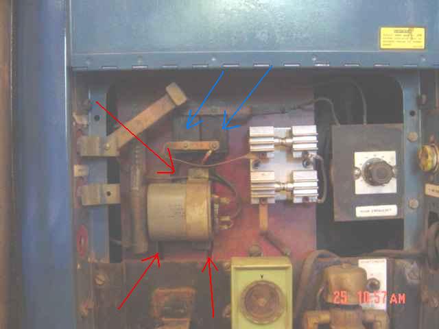

I wonder what would have cause the HF to go out?
Could be as simple as age. Or capacitors, (blue arrows). I know I got tired of changing them on my old Gold Star, thats one reason I bought the Dynasty 300.

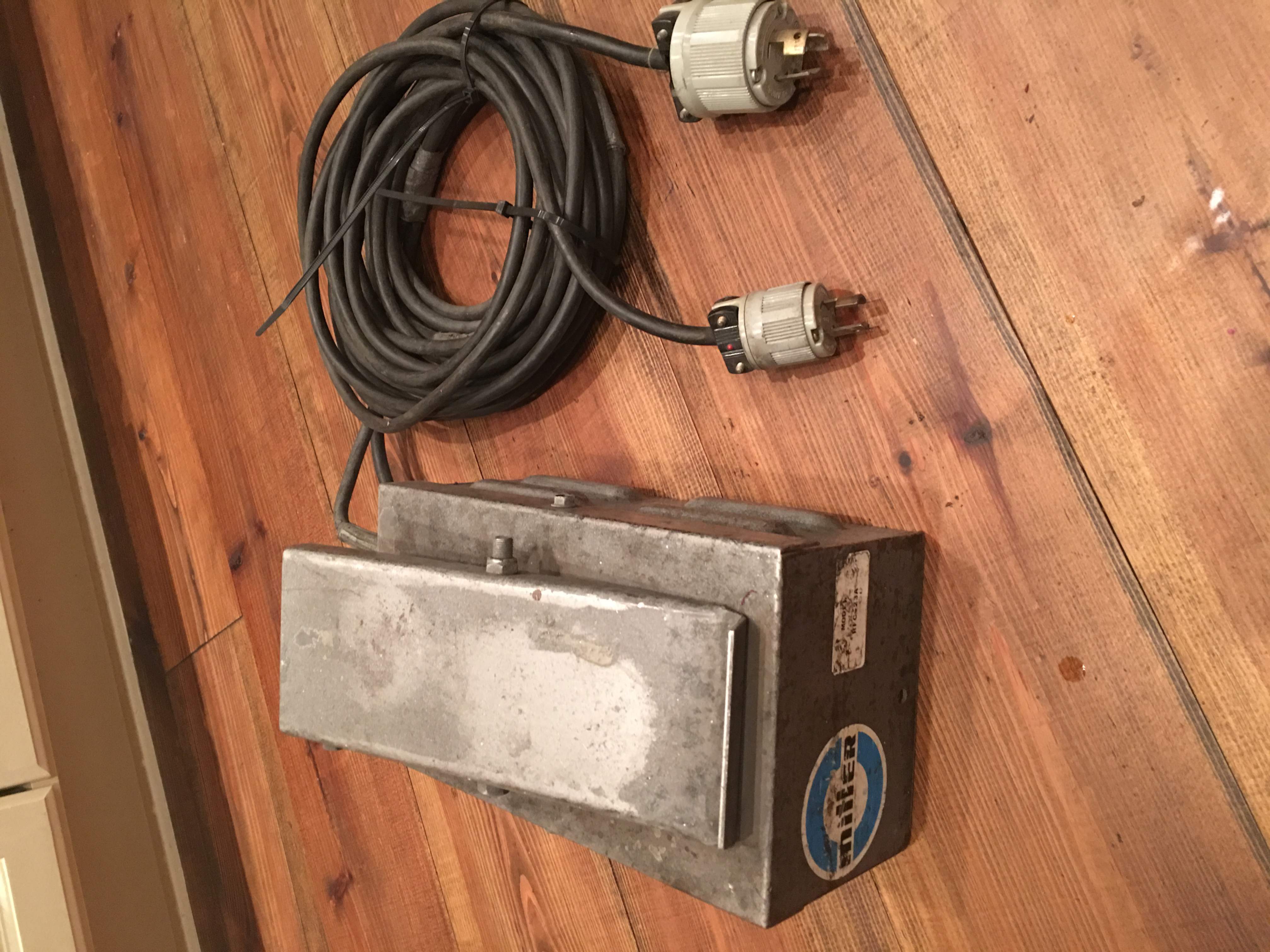

Well I almost started a new thread but since it's on the same subject as before I found my old one and figured I'd resurrect this one lol! Only 5 years later! Well since my welder purchase- the old Dialarc HF, I've gotten a few projects done including building our house and my shop and finally have a little more time to do things. I've used my Dialarc for numerous jobs and it's a great stick welder for what I do. I also was given a nice old rod oven (barrel shaped) and a lifetime supply of 7018, and 6010 rods. Probably need to add a few 6011s to the collection but not a big need at the moment. Long story short I am finally ready to try my hand at TIG welding. I've been on the lookout for a used pedal for it, RF-23a seems that it's different tech than newer type pedals and haven't found any aftermarket ones. There is one on eBay at the moment that looks like it's a Lincoln k870 that's modified to work perhaps? It's described as a rf23a and has a plug that's been taped on, so for 130$ I think maybe it would be worth it if it works.

Actually the eBay listing had the wrong pics on the listing, so it's actually 2 rf23a pedal setups for 135$, not too bad a deal I guess.

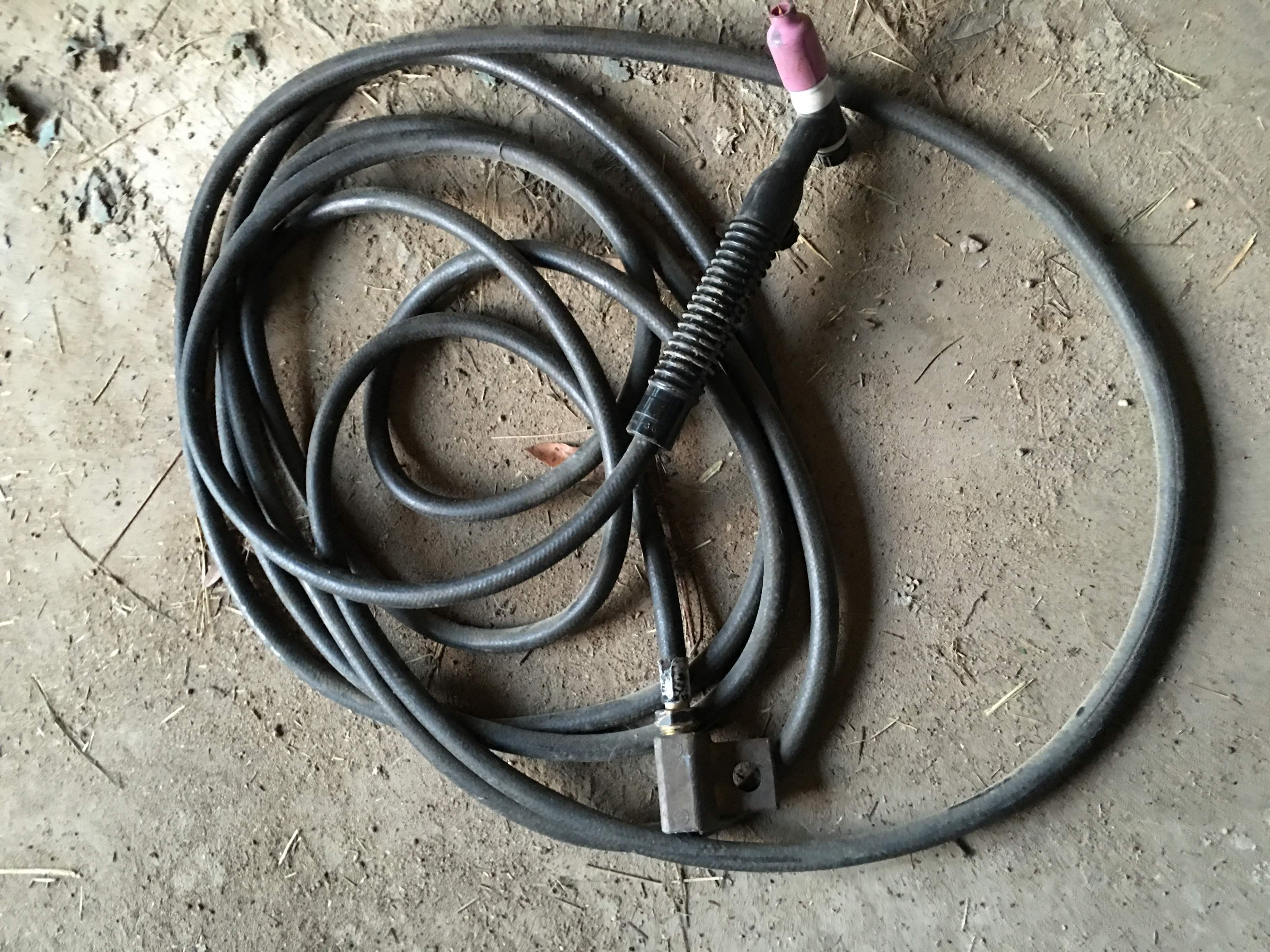

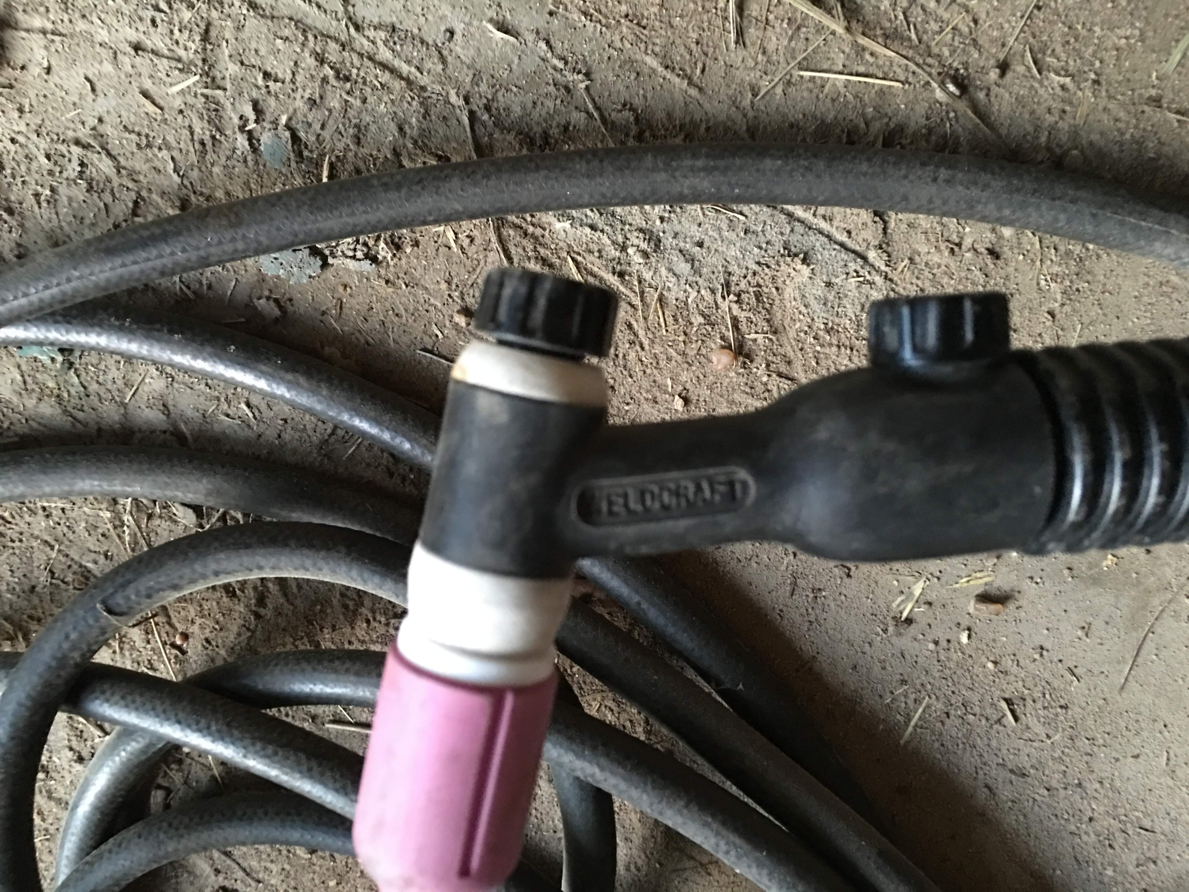

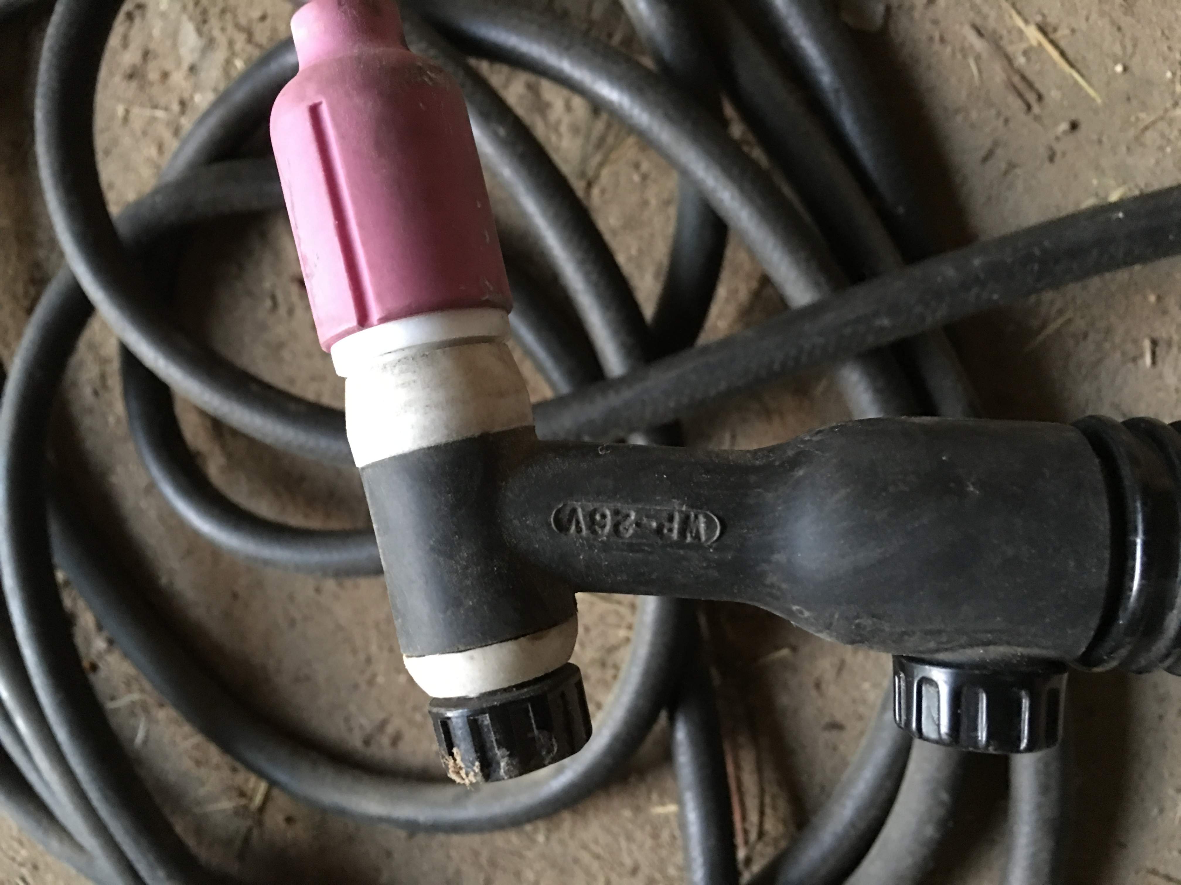

Ok so I got the pedal on the way, has been tested and looks to be in great shape. Also a friend gave me this torch awhile back, wp-26 I think it says. Is this ok to start with or even compatible with the Dialarc?image.jpgimage.jpgimage.jpg
/ Need welder advice... #75
Ok so I got the pedal on the way, has been tested and looks to be in great shape. Also a friend gave me this torch awhile back, wp-26 I think it says. Is this ok to start with or even compatible with the Dialarc?View attachment 445512View attachment 445513View attachment 445514
I am looking for a RFC23A foot pedal also. I passed on the one you bought when it was $120.00. The ad read untested and the wires were beat up leaving the pedal. He had been trying to sell that pedal for some time. If it needs parts you can get them from Miller, Good luck though
#76

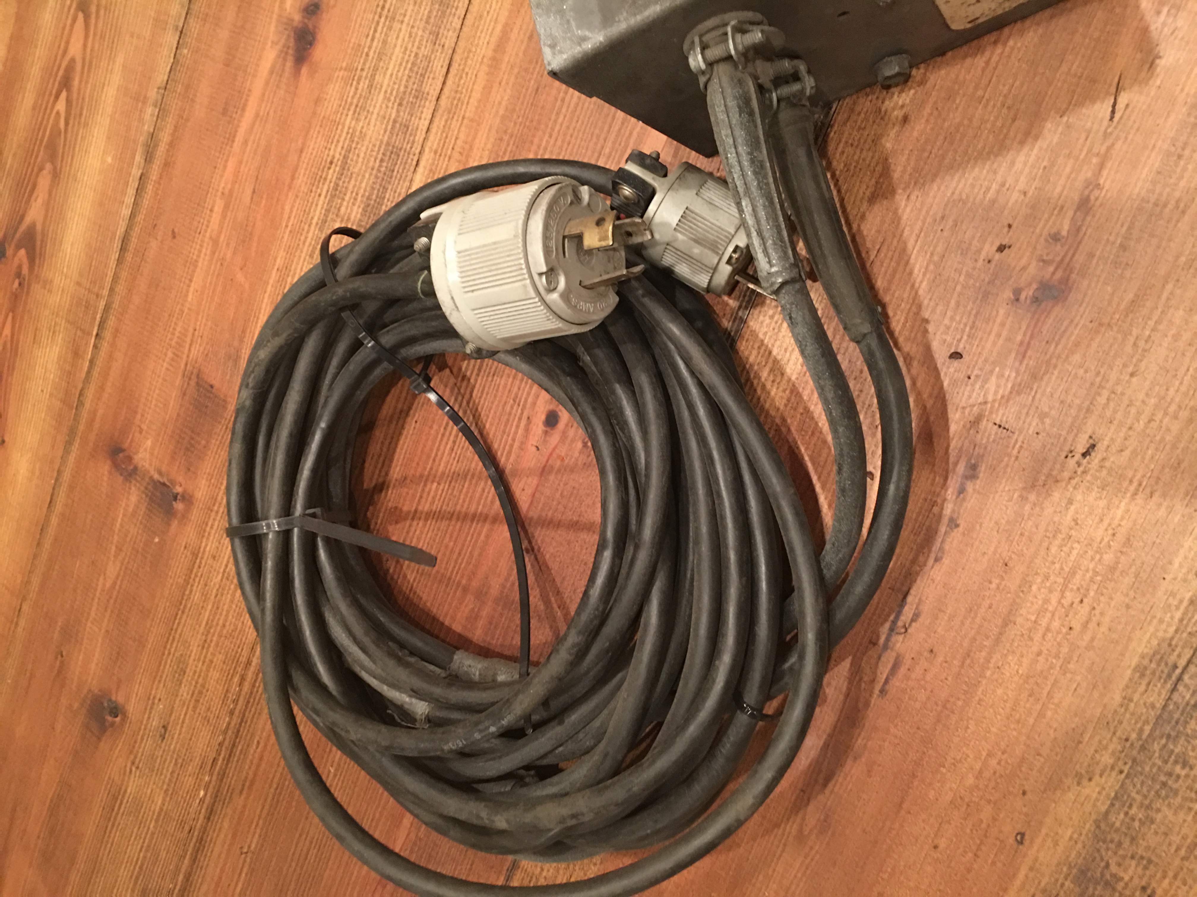

The one I got looks to be in decent shape wires included, it was from a Miller service center and has been tested. Not sure, but hopefully it's not a dud...

Well whadya know my pedal came in today! I checked the tracking number and yup it was sitting out in the yard. That was really quick shipping. It looks to be all there, a little paint worn off but the plugs look right and the pedal moves really smoothly. A bit too late for me to go try it out though I'm tempted lol. Got an early morning hunt anyway.
Here's a couple pics,

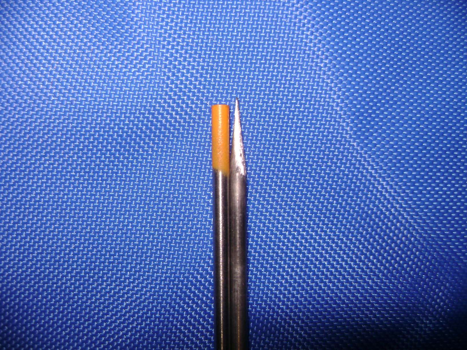

Can anyone recommend which tungsten electrode type I should try? I've read somewhere they liked the 100% tungsten but before I order a kit I figured you all may have some suggestions. Are there any online suppliers you all recommend, or should I bite the bullet and pay my local store a little extra. Thanks for any help or advice.

When using an inverter welder I use 2% Ceriated tungsten, (orange) for all my Tig welding. Even aluminum.
Arc Zone generally has anything you'll need far as Tig welding. But I use Google Shopping, and Bing to find the best price on anything I buy.
