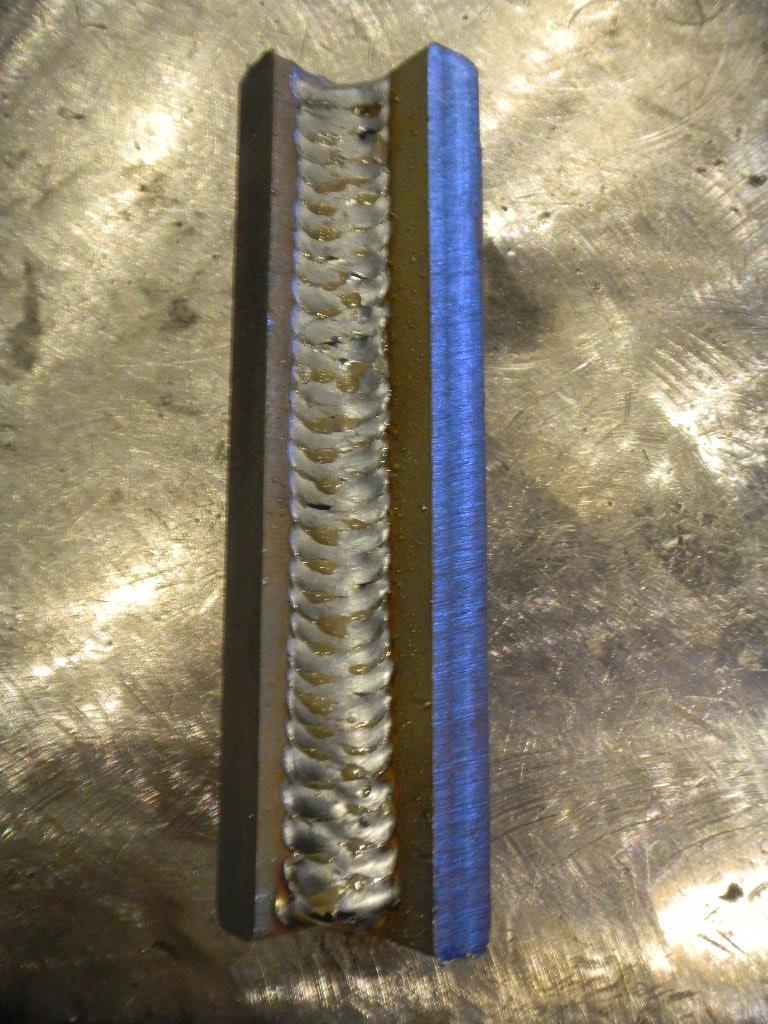

Yes it's single phase, 200-amps at 100% duty cycle. That's one sweet Mig machine. The variable inductance really gives you control over the puddle.
Here's a vertical up, with .045 Lincoln L-56 wire.
wow I have never seen a single phase one. I would love something like that.

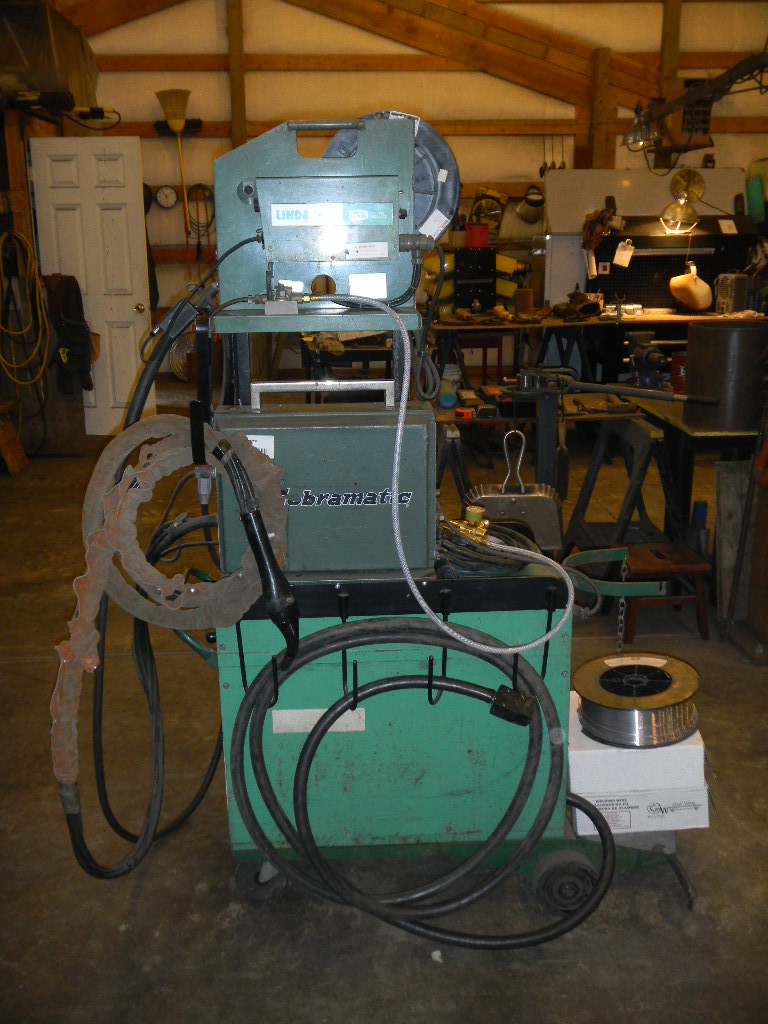

I have it up for sale, along with a Cobramatic. But shipping to you would be about 4 xs what I'm asking! :rolleyes:
That and I dont have anywhere near the cash for one now. Why are you selling it?
