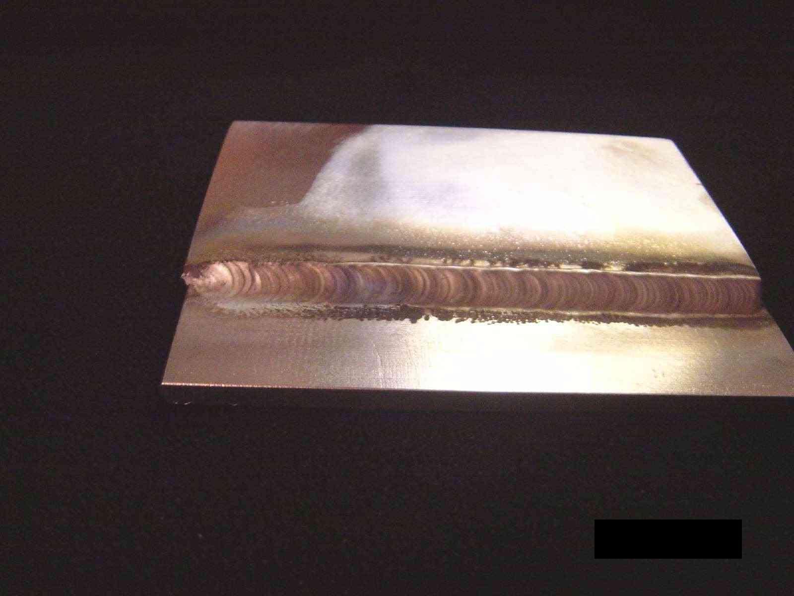

Well it's not necessarily required, you can weld aluminum with DCEN and helium, now that's old school at it's best!:laughing:
Here's a picture of a weld I did on DCEN with 100% helium.

That's a good looking weld to my eye. Does helium with DCEN use the same basic equipment as regular argon tig? I guess for the limited times I'd need to weld aluminum I could always just use stick instead...
/ Need welder advice... #12
Same basic equipment. Just with helium generally you crank up the cfh. The plus side with DCEN w/ helium you can do the same thing as AC w/ argon with about half the amps. But you don't get the cleaning action with DCEN w/ helium as you do with AC w/ argon. Another down side to DCEN w/ helium is there is a very, very small zone that the arc will start!
