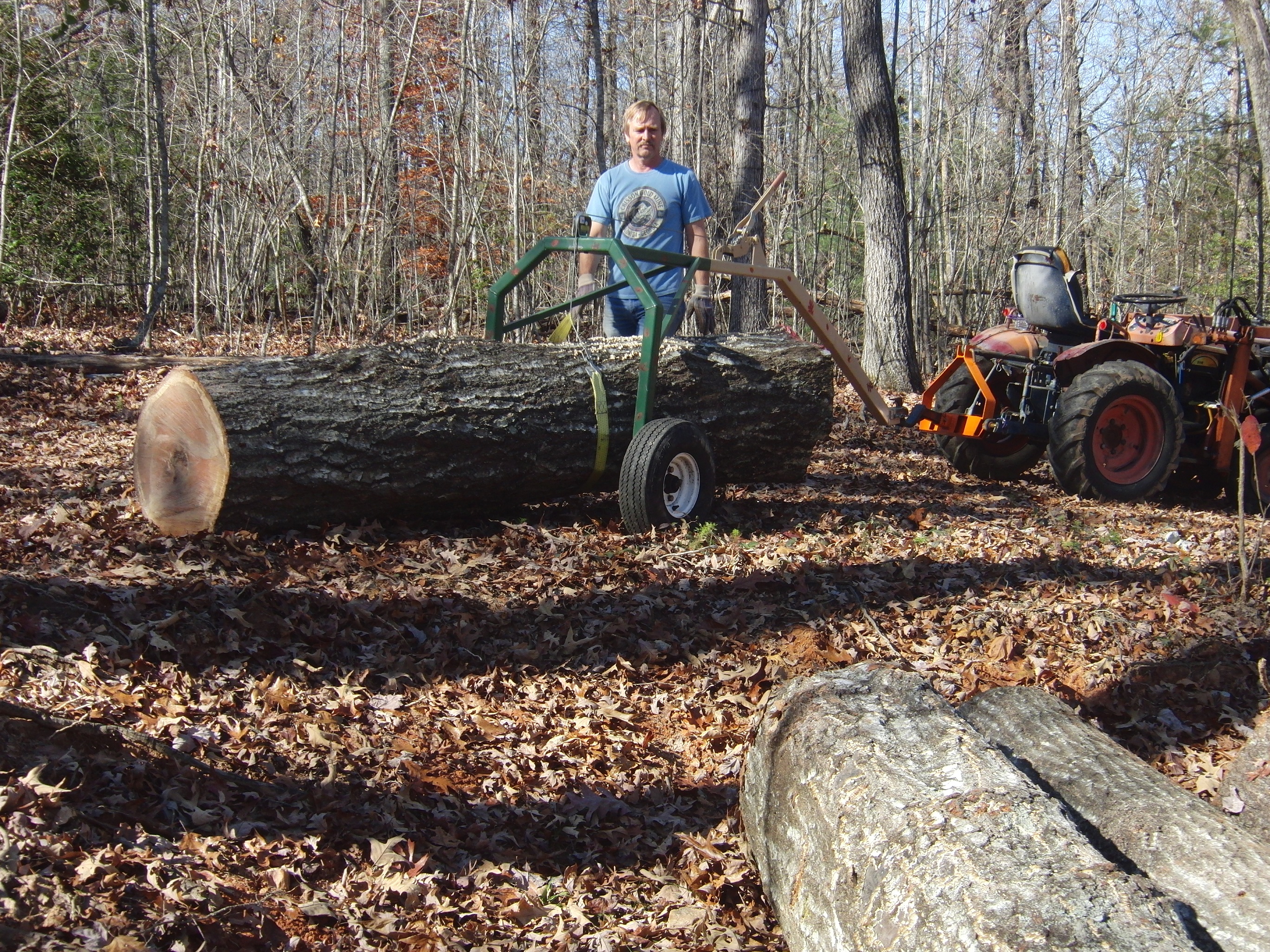

I built this one out of 2 x 2 x 1/4 inch. cost was less than $100. Pawn shop come along (4ton), flee-bay pulley, Old trailer axle and wheels found on side of road. 3 large log on arch-1.jpg

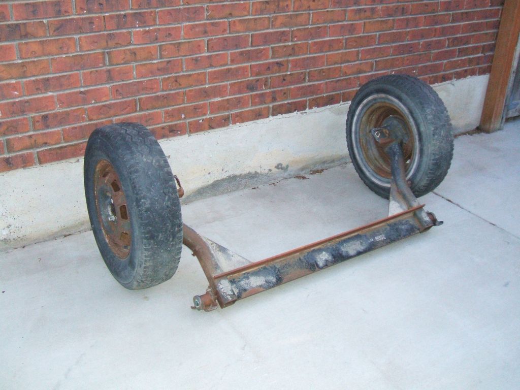

I thought it would be an easy log arch to add a tongue to a VW rear axle. There are several versions of this style.
