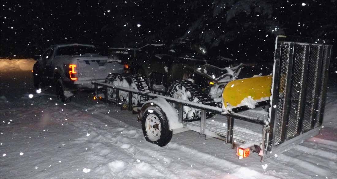

Hummm, maybe some folks here tow in more demanding conditions :LOL: :ROFLMAO: View attachment 817948
Well we can see your tail lights and what color the truck is so yes there are more demanding conditions.
I would get trucks coming in so covered in salt you couldn't see a lit taillight or what color the tailgate was.
