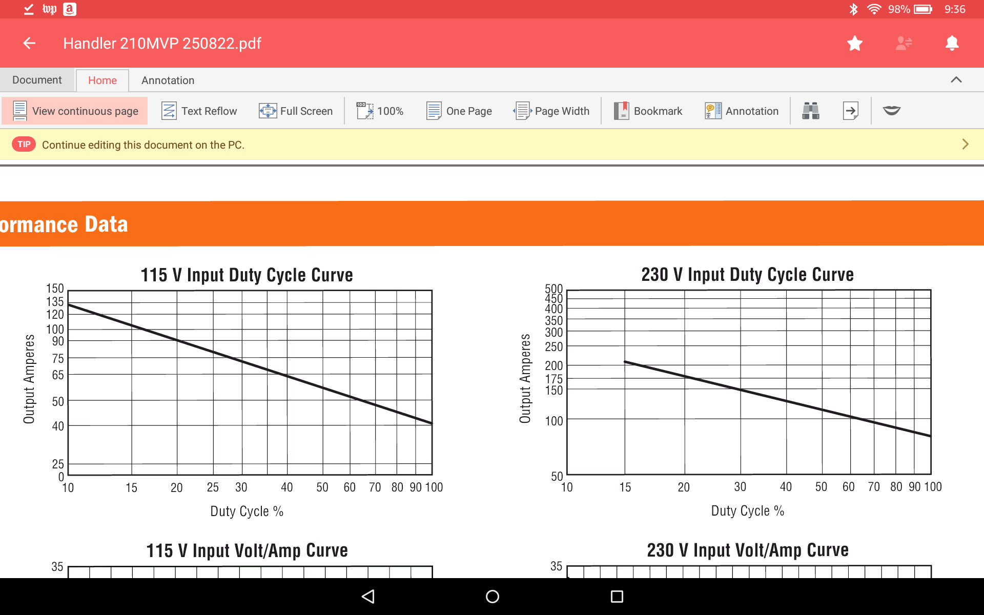

A friend bought a MVP about a month ago with spool gun and cart. We hooked it up and ran .030, 035 and 035 Aluminum on 230v & 50 amp breaker. We put DC tongs on the ground cable and we could only get 151 amps output. that's what I based my post on. I don't think there is an issue with the machine.. Not exactly sure why we couldn't get to the 200 amp output.
Stickout and movement and a few other thing will regulate voltage and amperage draw, Why you could only get the 151 amps on clamp on meter may be purely technique at the gun....

Na, Ive been at this awhile. We did vary the stick out a little but we were using real world welding techniques. Im not sure why we got what we got. I'm guessing it's all the machine had. Spec sheet also says Rated @ 150 amp output.

BUT that is 30% duty cycle... look at the spec 250 amp at 15% get away from charts on page 10 and look at graphs of page 11 and 12...

In the beginning we decided to put the tongs on because the new MVP machine didn't seem to have the snort of his regular 230v welder when set at 200 amps. ( bought MVP for 115V/230v portabillity ) That's how we discovered the discrepency. He's taking it to his LWS to have it re-tested.

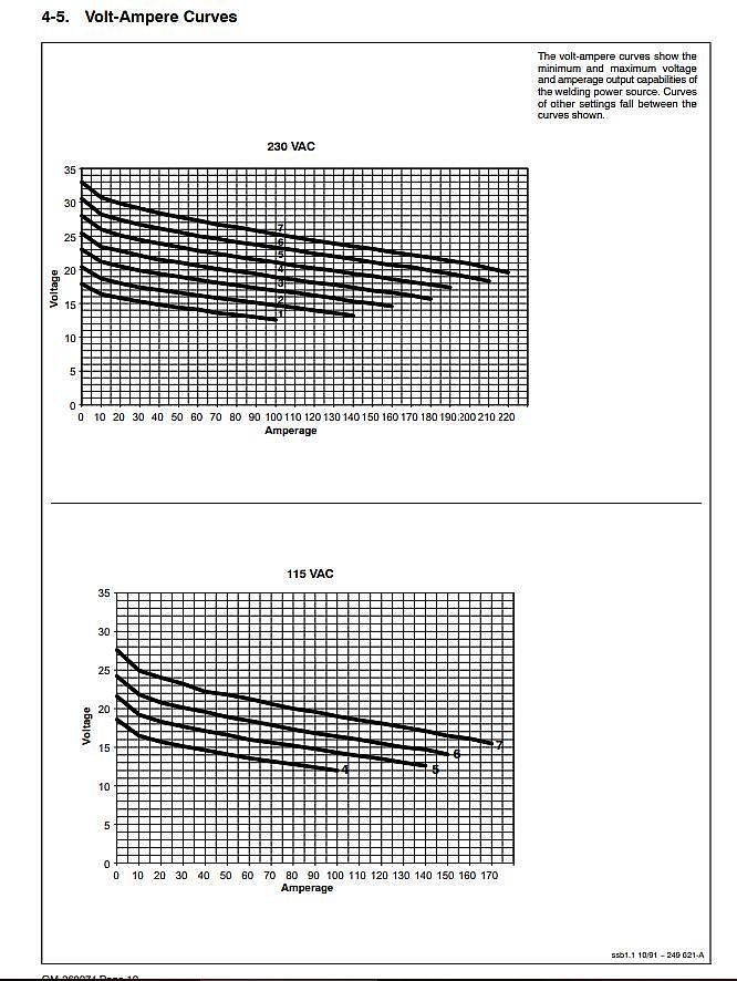

/ Need Mig Upgrade #17
Ummmm....
Don't think Hobart would put this out for whole world to see if there was not a bit of truth to it....
Dale
