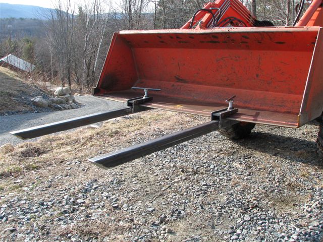

I have a set of clamp-on bucket forks I bought last year, and no matter how hard I cinch those suckers down they don't stay put worth a ****. Were I to do it again, I'd spend the extra money and get a set that attached in a more positive manner. (whatever that might be)

I have clamp-on bucket forks & a quick connect FEL forks. Clamp-ons don't stay put real well unless you custom fit them. Originally bought clamp-on to use on either my 580 Case or Kioti DK45S because the tractors live 150 miles apart. Forks could use some welded shims to get a perfect fit, which would be more stable, but then wouldn't fit both tractors. QC set was built by me with a bought adapter plate, scrap steel, & used forklift forks. Used on Kioti only because Case doesn't have quick connect & they're too big to lug back & forth. QC forks have more lifting capacity because they're closer to the pivot points on the FEL & weigh less than bucket with clamp-on. Clamp-on can be set to full bucket width, in my case 6', which is nice for moving longer materials, logs, etc. I now keep the clamp-on near the Case tractor but would keep them if I sold the Case because I can throw them in the Kioti bucket for occasional use on my property easier than going back to the barn for a swap. If I had only one it would be the QC. As Casco1 pointed out, visibility is much better with QC forks.
Agreed. I have a set of Payne's Forks that I got almost 6 years ago. I even welded some angle iron "ears" (for lack of a better word) to keep them from pivoting side to side on the bucket. It didn't help a whole lot.
Although it may take some time, the next move is to an ATI or Washburn skid steer quick attach and a set of real forks. As casco points out, it's much easier to see the forks. Big blind spot on clamp ons.

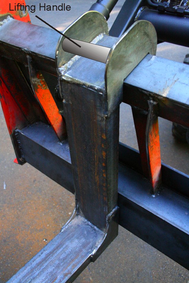

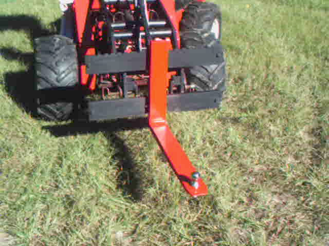

If you have the skills, I believe I would try and find a used forklift 16 in frame, and weld up some brackets that fit your tractor, and then you can put any fork you desire, similar to these.
The second picture is a forklift frame with one fork on with a 2 in ball for moving trailers, but you can dig up plants with it also with the ball removed.

Both my tractors have pretty substantial buckets. The Kioti won't lift enough with the clamp-on forks to worry the bucket. The Casebucket will lift enough to bend the forks so I pay attention to what I'm lifting. My forks are rated for 1K lbs. MikeD74T
