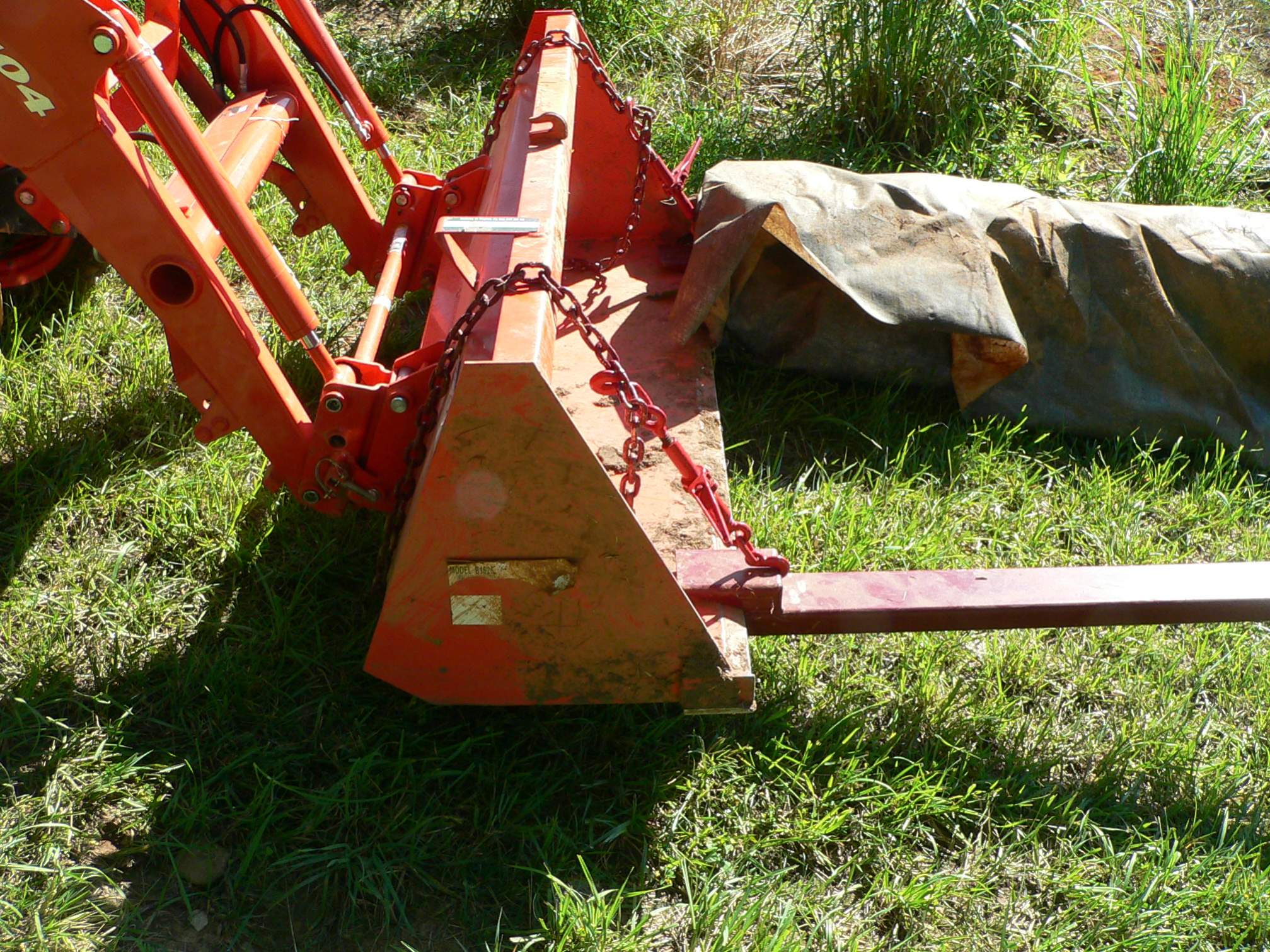

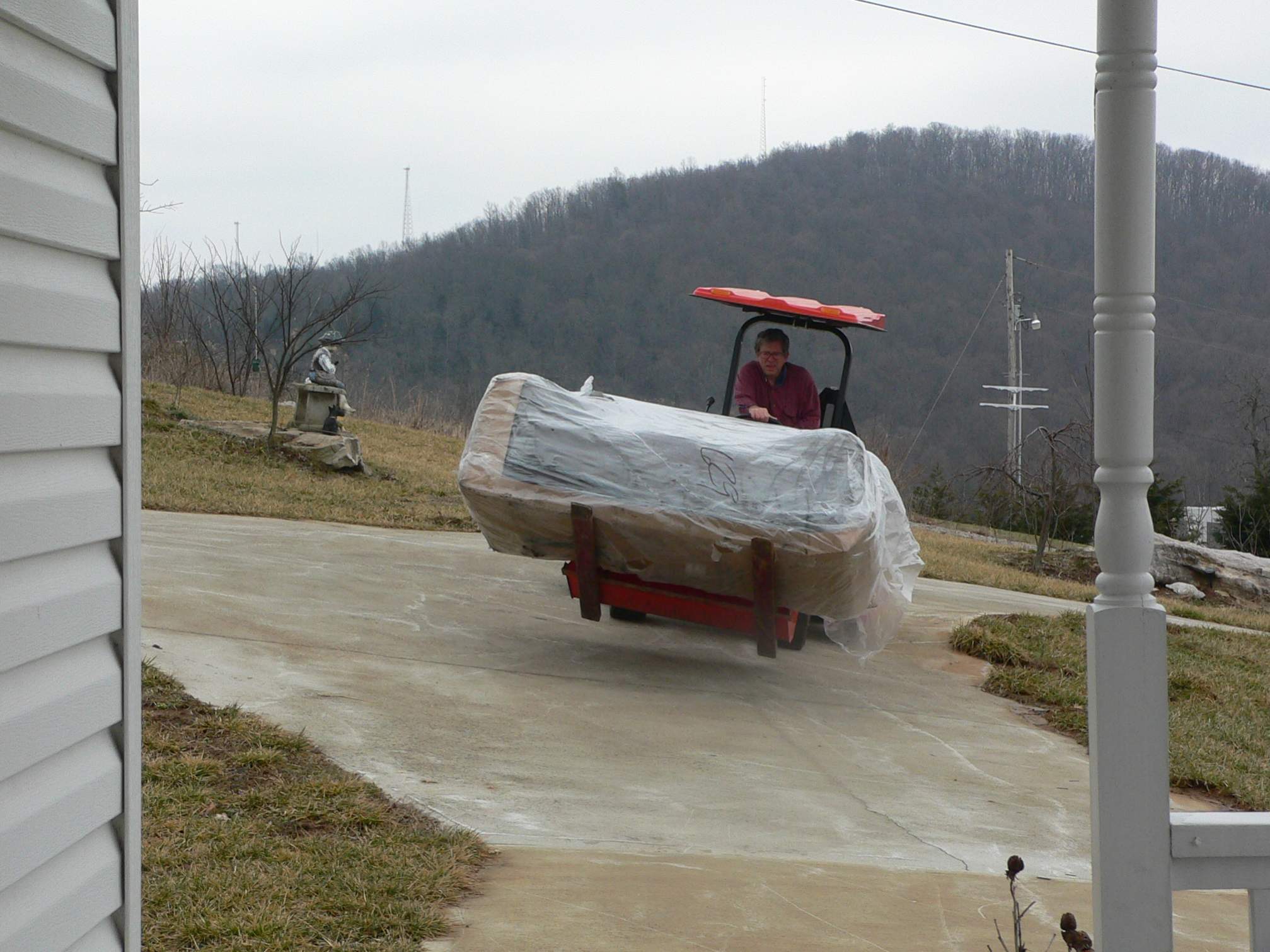

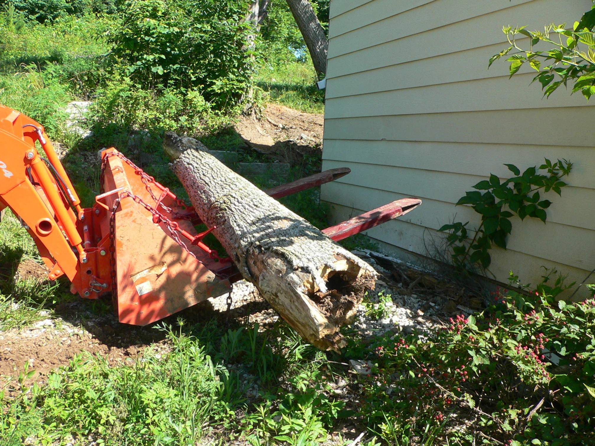

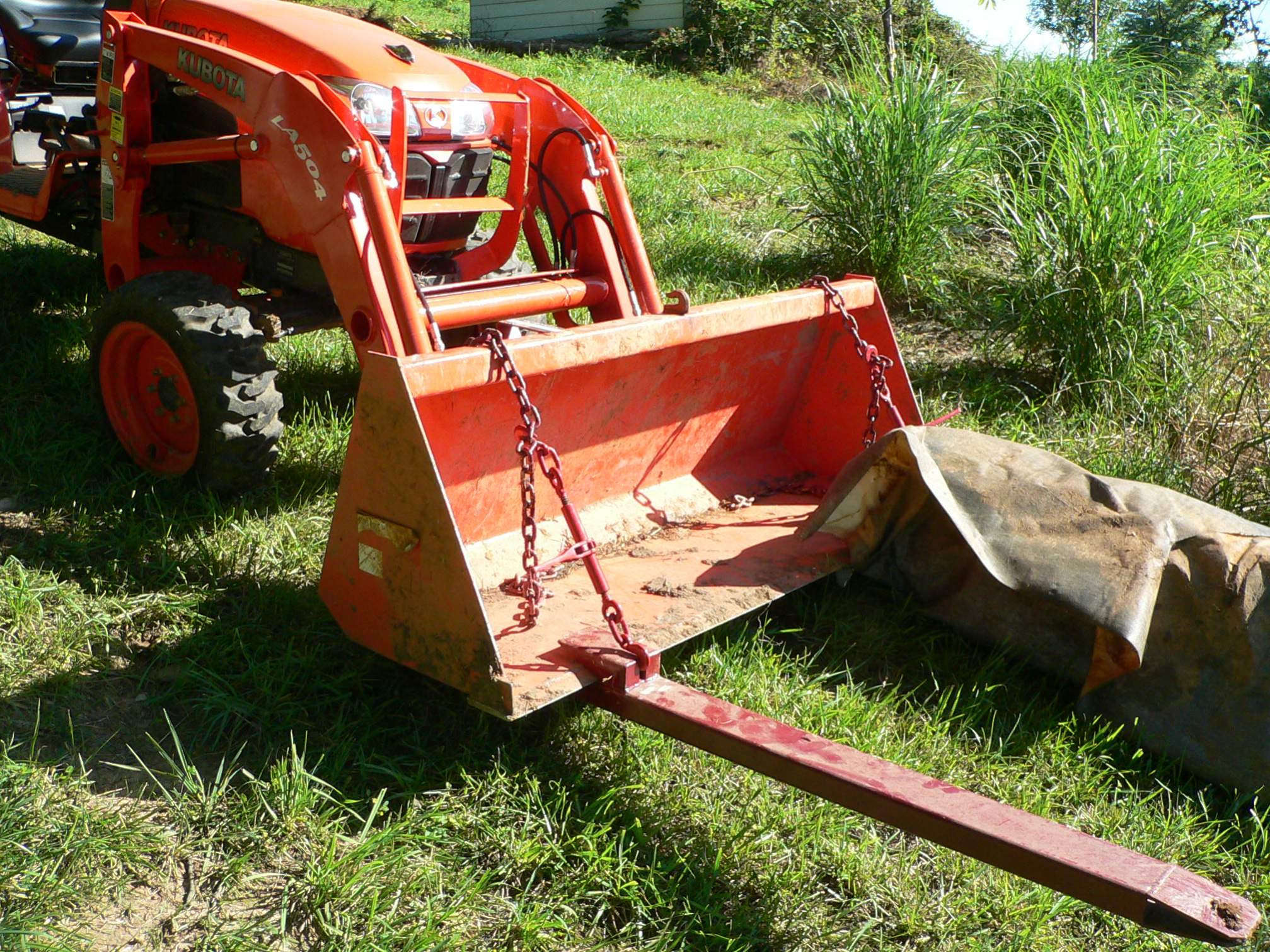

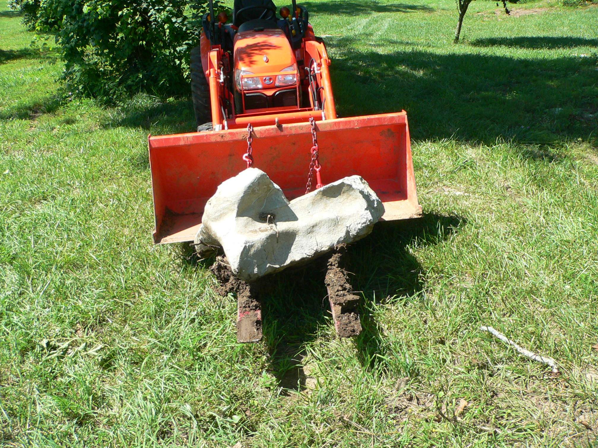

I have the ratchet type but can't compare to clamp ons since I've never owned them. Had the ones that had the SSQA for my L3240 but traded them when I traded tractors. The ratchet type tips have turned and slid on me but I may not have really tightened them down.I guess some type of clamp, drilled bolt or some such devise could keep them from sliding but keeping the tips from turning in or out would require some other type of preventative measure. Here's pictures, I like them, won't sell or trade them and use them but that wasn't your question.
After reviewing pictures, more hooks across the top of the bucket would keep them from sliding and could use the hooks for other things.

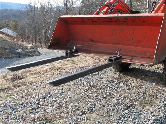

2 important factors are what type/size of bucket you have and what type of forks you get. I bought a middle of the road set of clamp on forks, bent the forks and bent the bucket. I was picking up a 1000 lb backhoe on a pallet....I think the problem lies with lifting the load too far out on the forks. Just too much stress on the bucket at that point. (compact 32 HP) I still have them, and would use them again for light duty use, but purchased a set of nice adjustable implement forks that replaces the bucket that do a much better job.
   / Need Advice on Bucket Forks #16

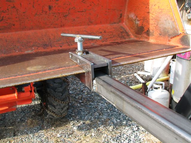

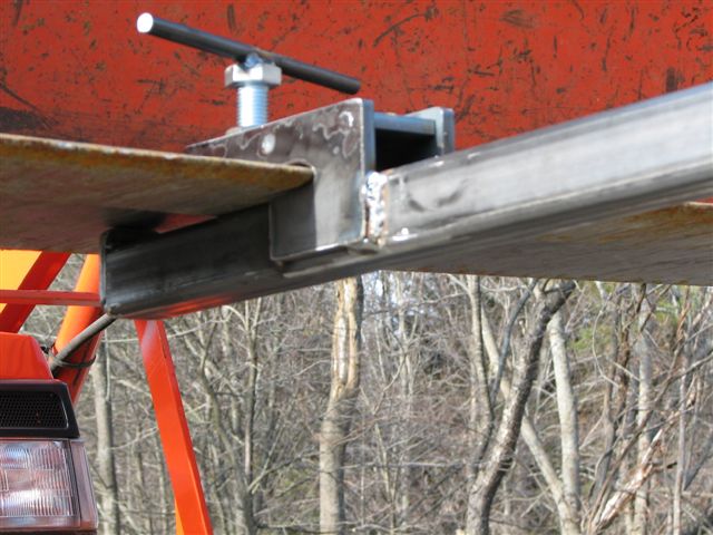

Clamp on forks are great for homeowner type use, assuming you get ones that are designed properly. I shopped around and tested a few....some put a big load on the clamp screw (no good), and some fit the cutting edge and bucket tightly....only using the clamp screw to keep them on the bucket. A well designed (or well fit) pair of clamp on forks will lift the same weight with or without the clamp screw tightened! Here are some "mini forks" that are extremely light weight.....work well on 30 HP and less tractors, and can be bought for less than $250 with free shipping. I have not been able to break this set!
