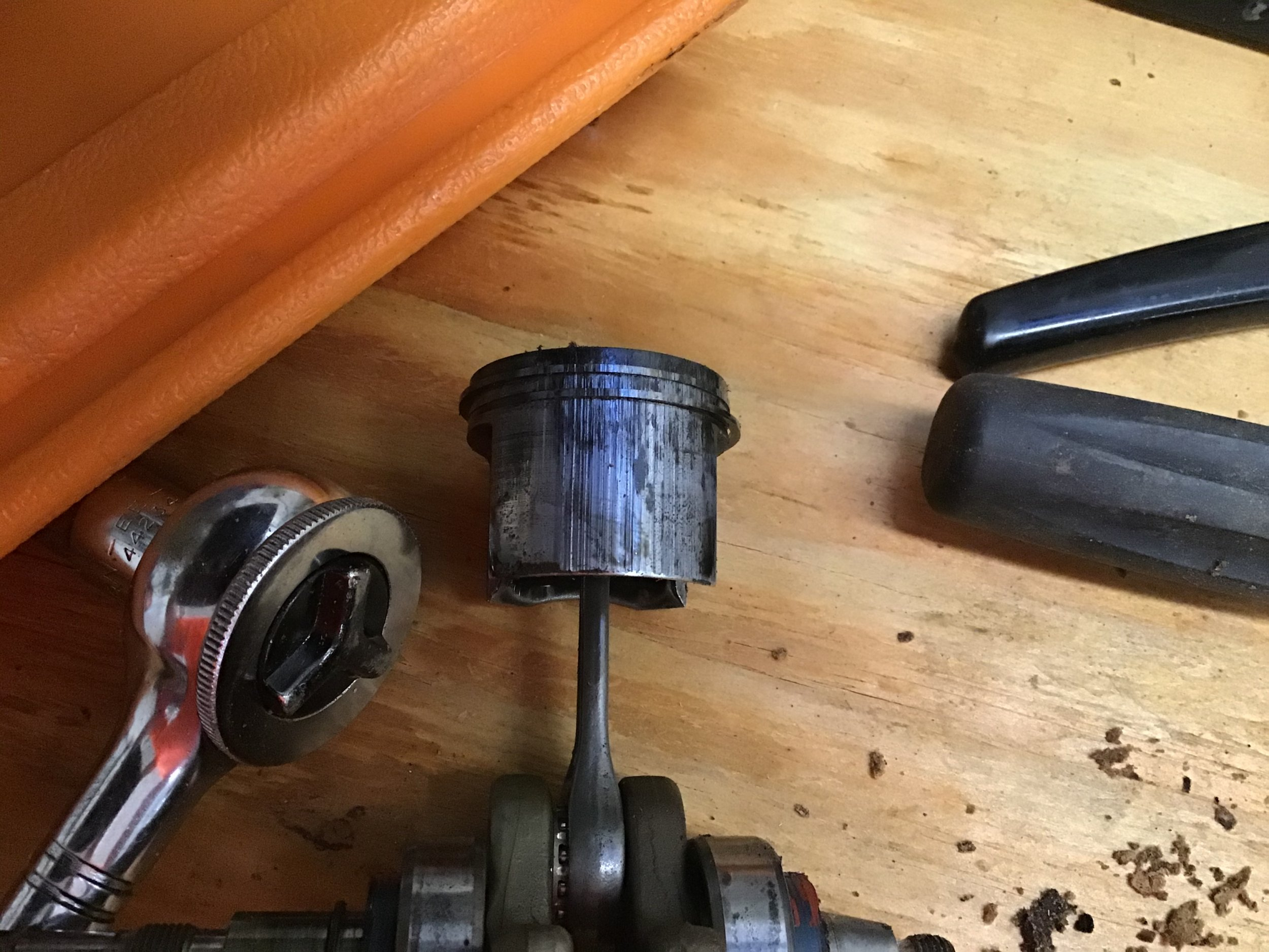

I bought a Husqvarna 572XP that had a muffler mod. It came from out west and had a long bar. I put on a shorter bar and had the (skip) chain shortened. The performance was unimpressive. I then put on a full chisel chain, and it made a huge difference. I never used the skip chain again.
