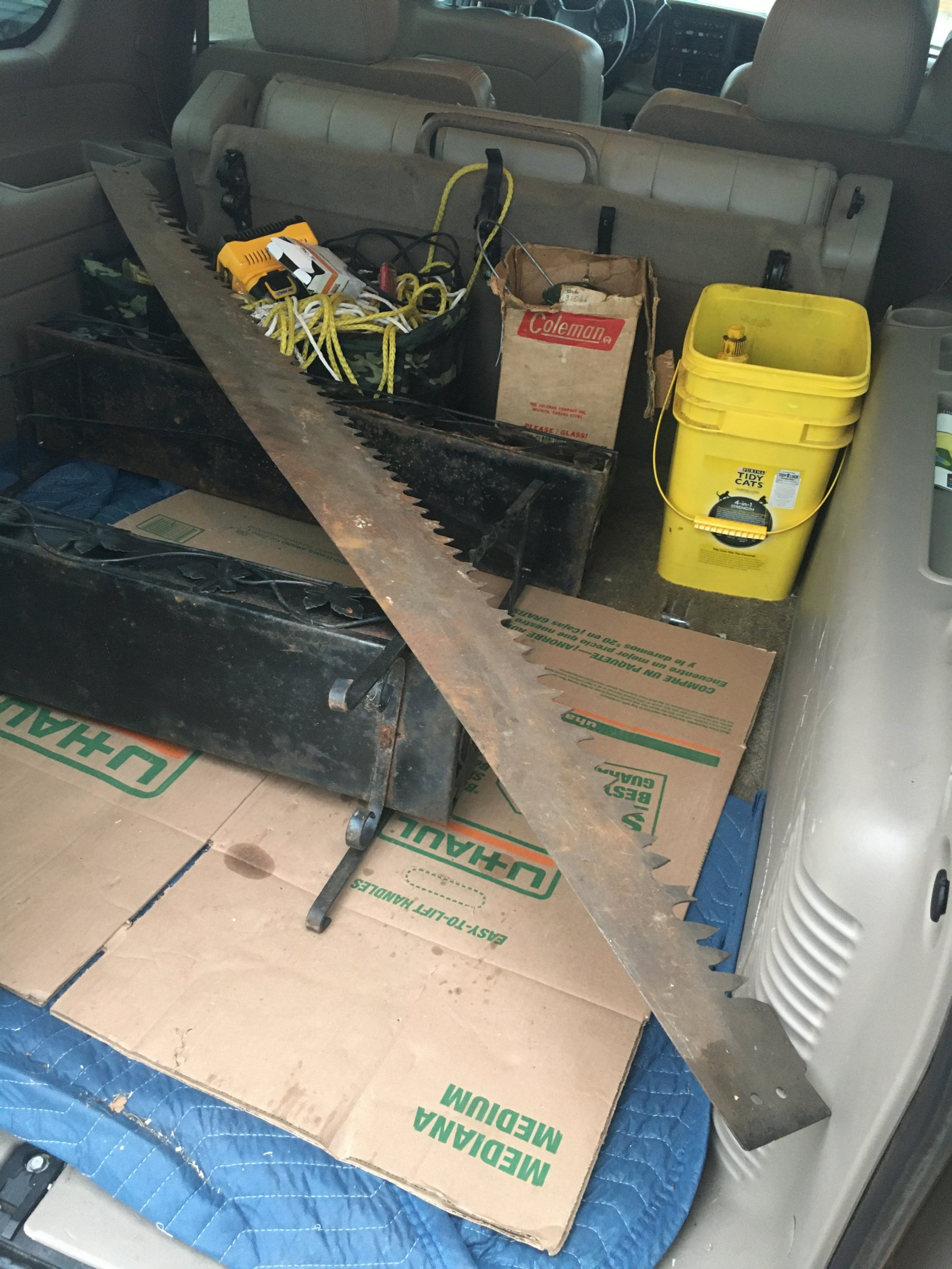

I picked up a very lightweight 72" saw this weekend. Needs some work, though.
   / Need advice on a larger chainsaw for an older guy. #148
Oh that's going to be some work all right.
We had one of those when I was a kid. We thought it would be fun and we begged dad to take it with us to get firewood. We were mistaken. I don't think it has been used since then.
