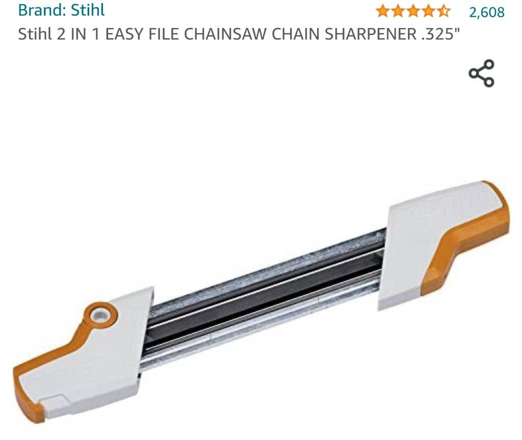

Since we're off the rails already let me ask - are these Stihl sharpeners crap too?
I have a collection of chains that I usually use until they're blowing smoking sawdust (too late, I know) and every once in a while I take a few to town where the local stihl saw shop sharpens them for $5 each, but I wouldn't mind getting more mileage out of my chains and I've been thinking about getting a couple.
Yep, that's the crappy, plastic new-fangled sharpener that I love. Find a video and give yourself 5 minutes with it in your hands. It will sharpen the teeth and also set the cutter depth so you get a good shaving coming off of it. I keep a small vise on a bench and a marker to know where I started. When I see it getting a little dull, I will run this through about 4 passes/tooth on the next fill-up. It takes very little time. That keeps me from changing out the chain and making more adjustments to the bar. I guess others prefer doing them all as a project but I keep the same chain on until it's toast. just make sure you get the right one for your chain.
By doing that you’re missing a few huge things that will help the chain last longer one is removing the chain to clean bar rails and flip the bars so you’re rails wear evenly. I look at it differently then most of the guys here I’m falling for production so swapping a chain is faster then filing a chain.

Sharpening a chain is just one of those things you have to jump in and do.
