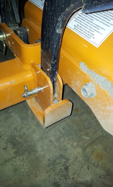

Here are two more photos of the shank. The rusty bit is likely from my drooping it while trying to remove the upper broken bit from the box blade.
10679822_10203281276812216_506243202894386239_o.jp  g
1456610_10203281277572235_2371938826508987575_n.jp  g
I'm far more concerned about the peening of the scarifier shank pockets. At the fold on the rearward bottom of the shank pocket, the metal becomes thinner, and is likely work-hardened from the bending process, making it weaker than in other areas of the shank pocket.
This photo shows how the paint is chipping off as the metal bends outward.

That looks like some very brittle metal on the ripper if it cracked and popped a little chunk out. Probably a low quality casting, or a casting not intended for this kind of stress.
The design of the shank pockets definitely has a weak spot where it's deforming. All the load will focus on that one spot, and has only the plate thickness to support it. I am guessing EA designed it this way to avoid cutting slots into the square tube. But the pocket needs more reinforcement behind the rear plate.
I have a pretty basic Howse box blade. The rippers slip through slots cut into that front square tube. While that probably reduces the stiffness of the square tube a little bit, it provides a bunch more support to the rippers -- there's probably about an inch of plate on edge behind each ripper.
I have only owned two tractors, and both relatively light Kubotas. Both will run out of steam or traction long before they could damage a box blade, especially in snowy/muddy conditions like you show. So I really doubt you're doing anything that could damage the box. I think the ripper was cast poorly, and I think those pockets need more than a plate thickness to support the rippers. Hopefully EA will comment.

Eric, wow, your close-up of the shank pocket showing the peening is a real shocker. Agree that it's more concerning than the broken shank, which is easily replaced and may just be a one-off metallurgical flaw.
I've attached a close-up of my Woods BSM84 box blade. The bottom and back of the shank pocket is formed as one piece, but from 1/2" steel. What is the thickness on the EA pocket? Looks like it may be 5/16", or maybe 3/8", as it's thinner than your side plates, which I think are 1/2".

I have the Woods 2013 catalog and in 2014 Woods changed all of the model numbers, but I was looking at an 80" 4x4 Gannon without a tailgate or hydraulic shanks (Woods/Gannon makes a distinction in their 2x4 and 4x4 versions).
From your photo, the difference in the Woods stake pocket, from appearances anyway, is that Woods isn't pinching down and stretching the metal in order to form the 90 degree bend and maintains a consistent thickness of metal throughout the bend. In other words, Woods has a larger radius in the corner that doesn't stress the metal as much. To me, when EA made the stake pocket, the inside bend is a straight up 90 degree bend with no radius so as to avoid having a radiused "tab" poking into the stake pocket. If my conjecture is right, this is something EA can fix pretty easy by increasing the corner radius so as to not stress the metal.
That all said, Everything Attachments wants the blade back and I image they will do their own looksey. Speaking of: Travis, I called YRC in Burnsville, MN and they have a banding machine to secure the blade to a pallet, and so I'll get the blade down to them when I get back from northern MN in the first week of December.
/ My NX6010
#398
Woods/Gannon on right, Everything Attachments on the left.
Looking at the difference in the Woods design, it looks like Woods doesn't bear the load on the heel whatsoever, whereas the EA design must use more metal in order to hold the load on the heel.
