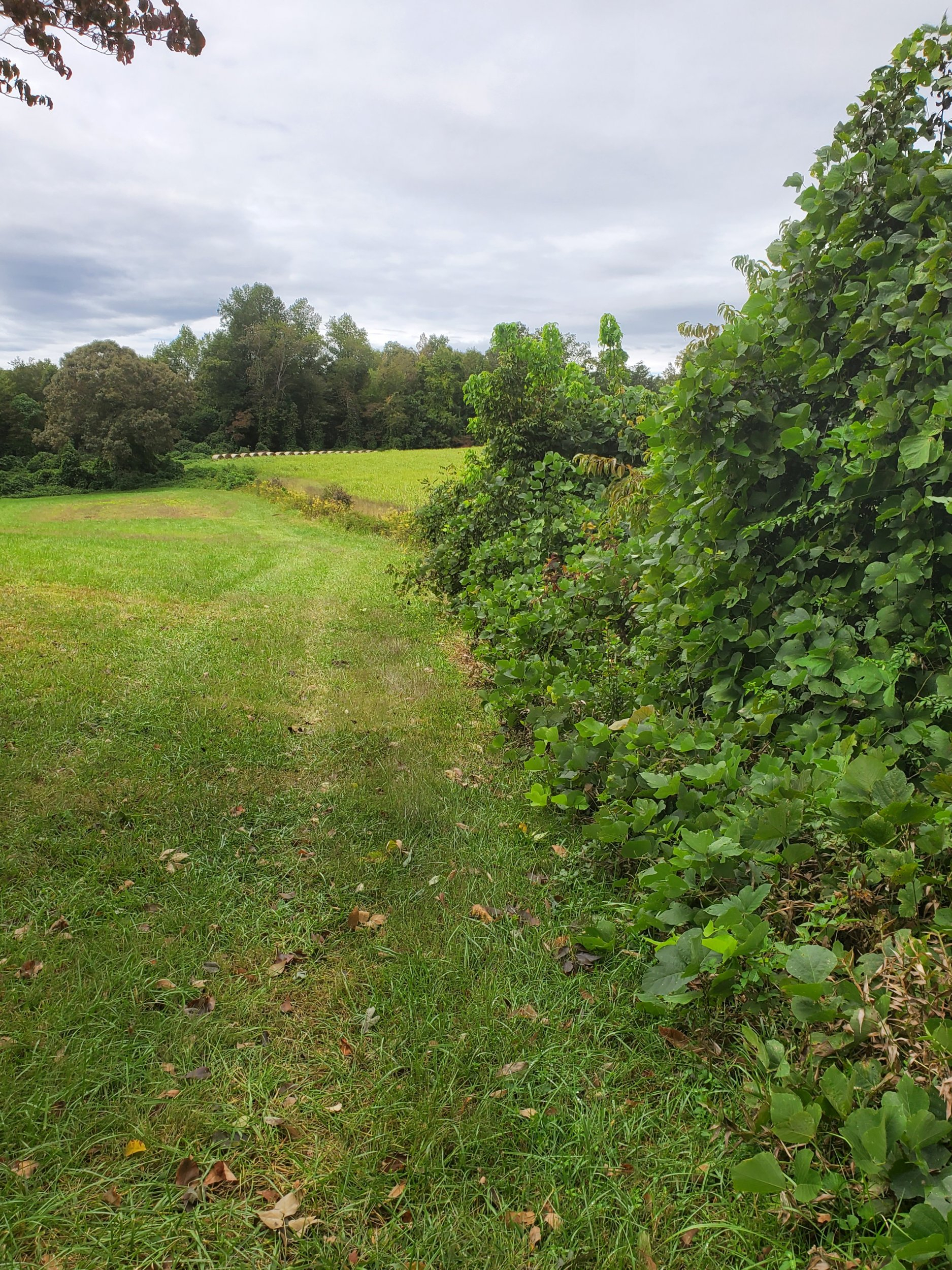

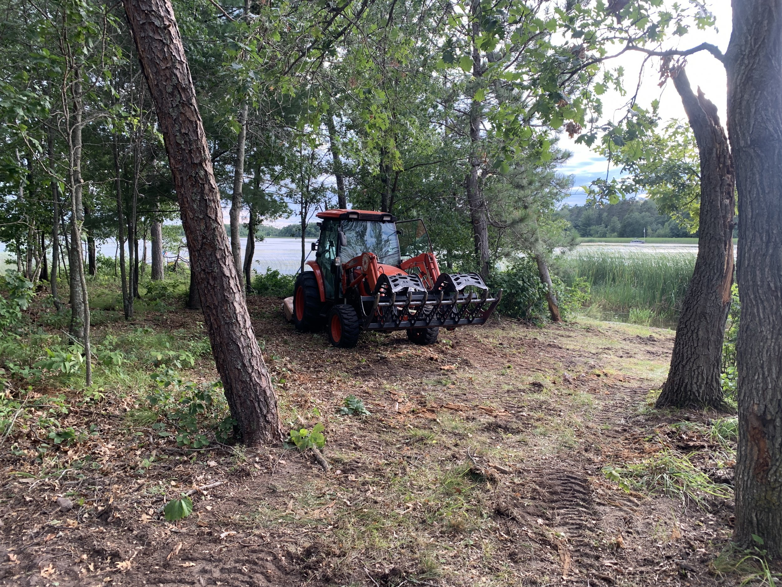

I Liked and Saved the video. What grapple is that you have. I'm looking for one. Also, I have a drainage ditch that is about 300 get long and 3-4 feet wide that is overgrown. I want to cut down the vegetation and maintain it that way. I'm afraid to try and straddle it with the tractor and brush hog. What implement would you recommend?
Thanks again for your help!
/ My NX6010
#1,329

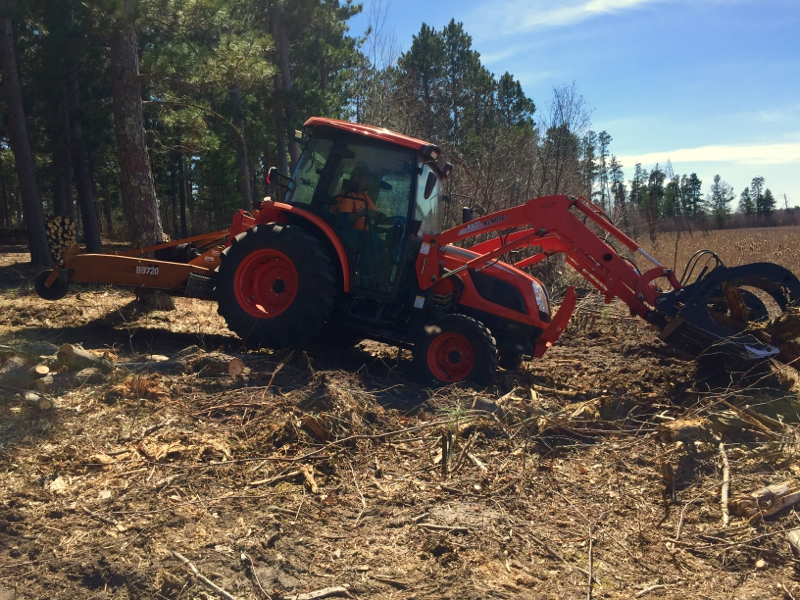

The drainage ditch doesn't look deep or steep. Drive in there with your rotary cutter or use a regular law mower. The Grapply I have is an Everything Attachments 72" wide version 1.0 double lid wicked roots grapple. On my properties it is a my go-to attachment and is primarily used to pick up windfalls and once in a while to clean up improved areas. I'd purchase it again.

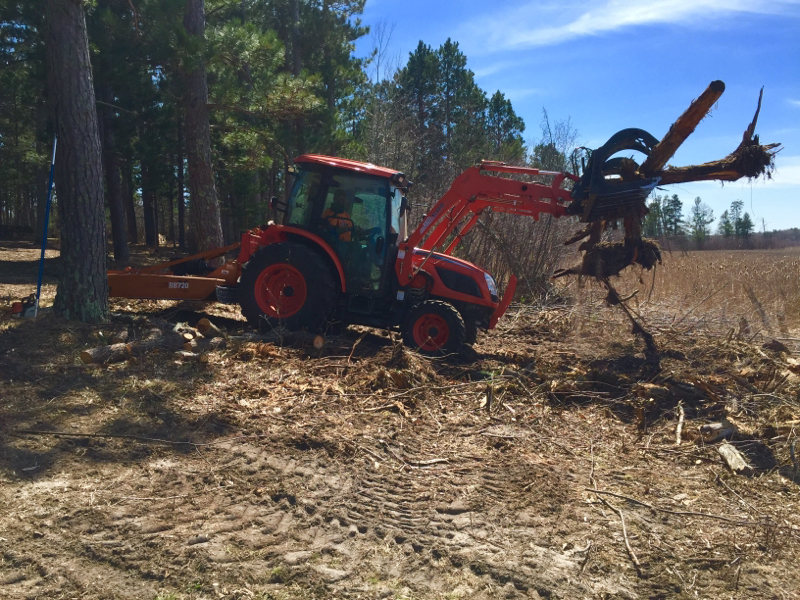

Arnold, congratulations on solving the problem with the shifter! Eric's the man! He's helped many folks on this board in the past. Including me.
I think you are really going to enjoy the NX4510HST/cab, especially with that pesky issue gone. I have the same tractor, 2014 model.
I also have an Everything Attachments Wicked Root Grapple like Eric's, but in the 60" width. I initially thought I wanted a 72", since that is the width of the bucket it replaces, but decided to go with 60" after discussing it with Travis at EA. I'd buy it again with no hesitation.

I also considered the 66" width before going with the 60." All three widths would be fine for the size tractor you have, but for me the 60" aids maneuverability without really giving anything up. I believe the dimensions of the double lids are the same for all three widths. So you lose nothing in terms of downward clamping ability. Sizing a grapple is different than sizing a bucket, where an extra 12" of width can mean a big difference in carrying capacity of loose material. In my woods, and in other areas where I work, I can poke the grapple into narrow spots between trees, stumps, bushes and other plantings I don't want to disturb, etc.
The narrower width also concentrates both the penetration force and the lifting force a bit more when digging out stuff. This is just my experience. It's worth a chat with Travis at EA about the best width for you based on your particular situation.
One final thought. A few years after getting the 60" grapple, I added another tractor, a 2018 CK3510SE HST. As it turns out, the 60" grapple is a perfect size for that tractor, where a 72" would be too large. And now that's where mine pretty much stays! So if you think a second tractor may be in your future, consider sizing with that in mine as well. :)
