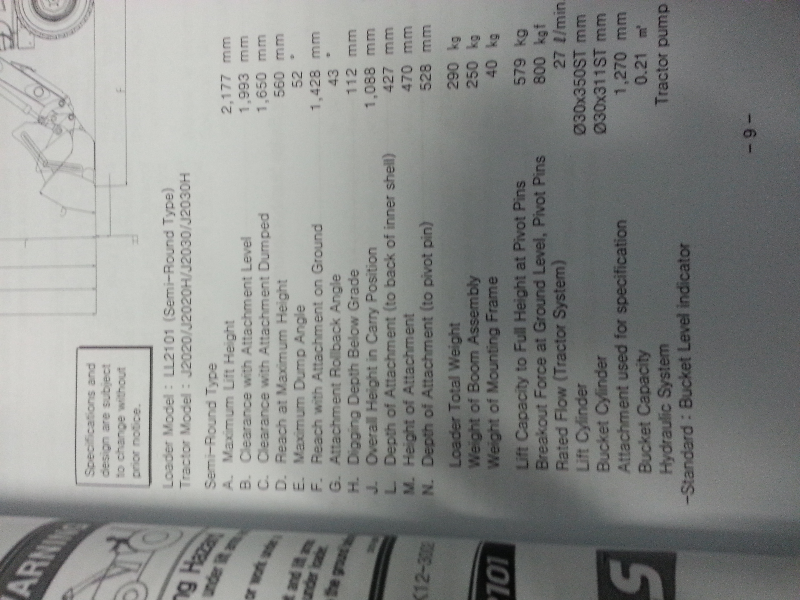

It will be in the loader manual ... it will specify how much ballast is needed
Says "Add wheel ballast and/or rear weight to counterbalance tractor/loader for stability at maximum loader capacity."
   / My New J2023 Initial Review #12
Check the main specifications page in the loader manual... the page that gives dimensions, lift specs, etc
#13
Nothing there about how much fluid to use. That's only specs for the loader parts.
   / My New J2023 Initial Review #14
Hmmmm ... in the specs page for my loader manual is where the recommended ballast amount was listed (when I had the R4047). Not fluid amount ... ballast amount. They likely won't list a tire fill amount.
#15
Here is the specs page.
   / My New J2023 Initial Review #16
Looks like they don't list it ... sorry, that was my best shot. Have you called & asked the dealer? They may have it
   / My New J2023 Initial Review #17
Go to the Rim Guard site, they have a chart that could help you.
   / My New J2023 Initial Review #19
