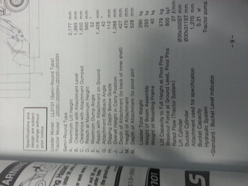

Says "Add wheel ballast and/or rear weight to counterbalance tractor/loader for stability at maximum loader capacity."

Check the main specifications page in the loader manual... the page that gives dimensions, lift specs, etc

Nothing there about how much fluid to use. That's only specs for the loader parts.

Hmmmm ... in the specs page for my loader manual is where the recommended ballast amount was listed (when I had the R4047). Not fluid amount ... ballast amount. They likely won't list a tire fill amount.

Here is the specs page.

Looks like they don't list it ... sorry, that was my best shot. Have you called & asked the dealer? They may have it

Go to the Rim Guard site, they have a chart that could help you.
