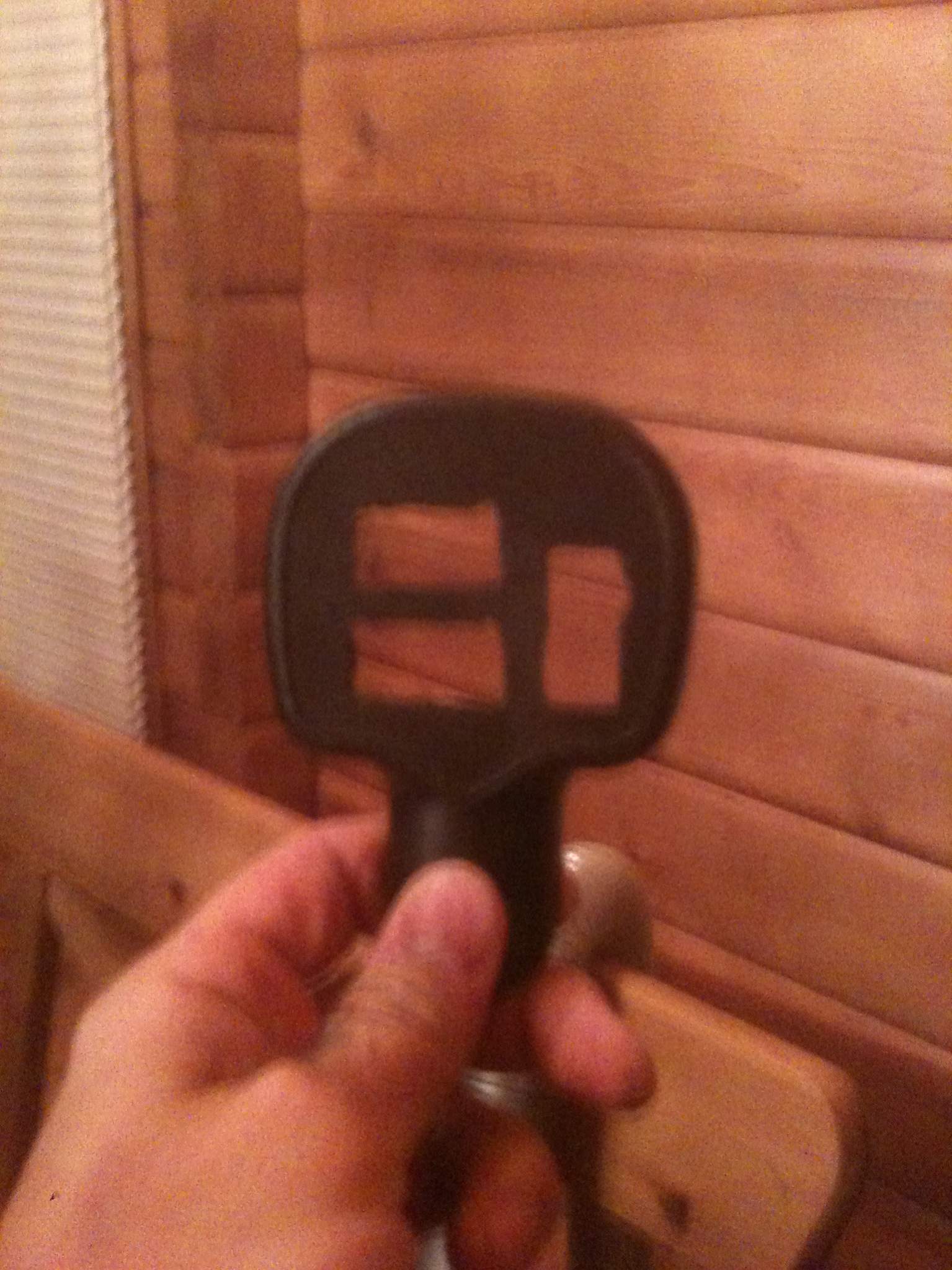

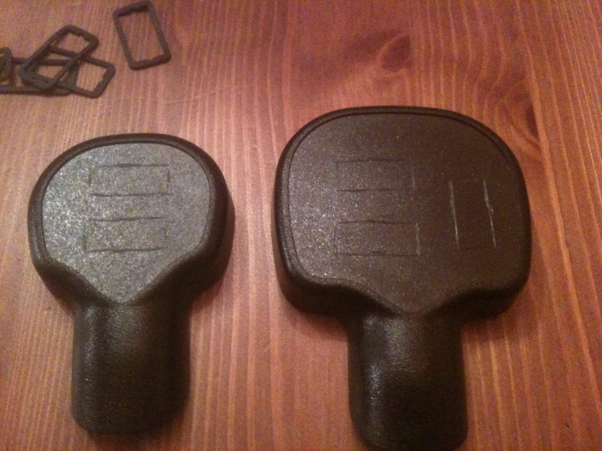

Here is what i've been left with at the end of the evening with my Dremel, some black silicone, and about 300$ worth of parts from Otto......

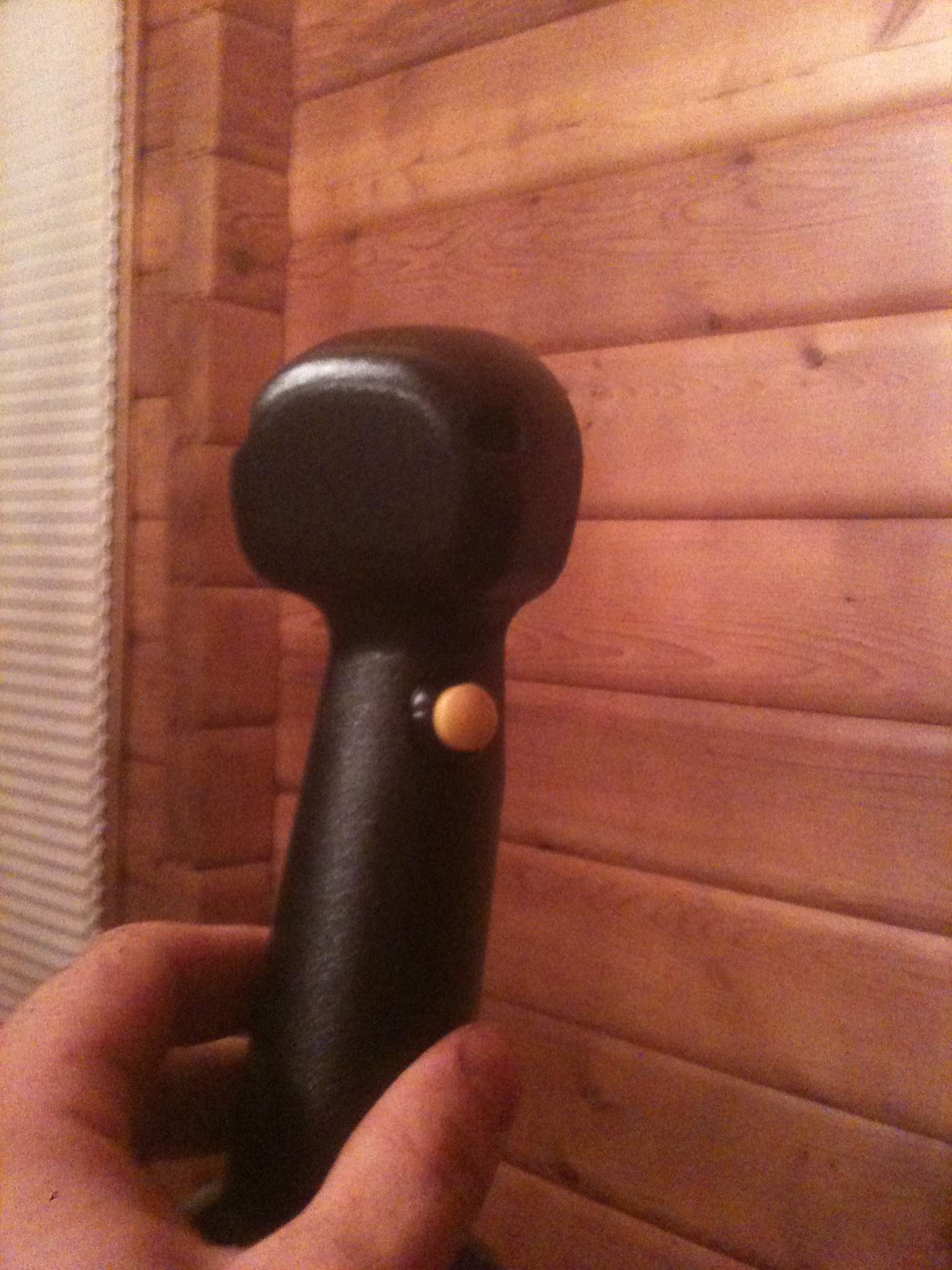

The smaller grip is for the loader joystick and the bottom rocker will control the grapple or snowblade. The top rocker is actually a dud for the time being, it's just there for possible future (ie if I get around to building my PTO driven high-flow hydraulic driven snowblower to hang from my loader). The yellow push button is what I use when I'm too close for missiles..... or if I need to blow the yet-to-be-installed horn.
The larger grip is going to go on the 3pt control lever. The bottom horizontal rocker will be for angling a blade, or rotating the chute on my blower. The top one will be for the tilt of top 'n tilt, and the vertical one is for the top of the top 'n tilt.
Yes, before someone notices, the top horizontal switch is a little cock-eyed.....
The last remaining switch is the one for the dash for the ON/OFF/ON wiring.
There's a ways to go yet, but most everything else will be done at the hydro shop. Hopefully be done by early next week.....

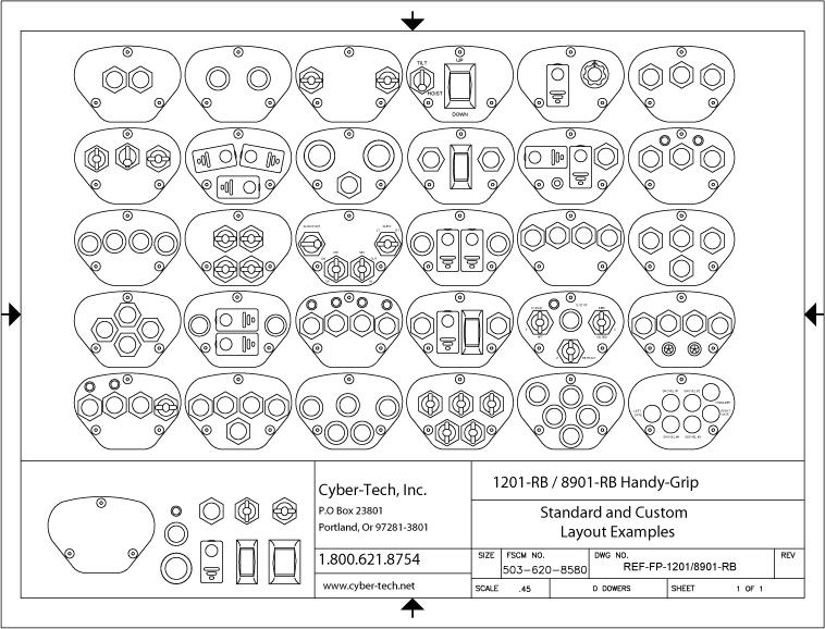

There are plenty of the electronic joysticks on the Internet, but if you just want to make your own, no reason why not.
8901-RB Handy-Grip
8901-RB Handy-Grip
I couldn't find anything that suited my likes (and a few needs).... and at the end of the day, it was very, very fun!!!

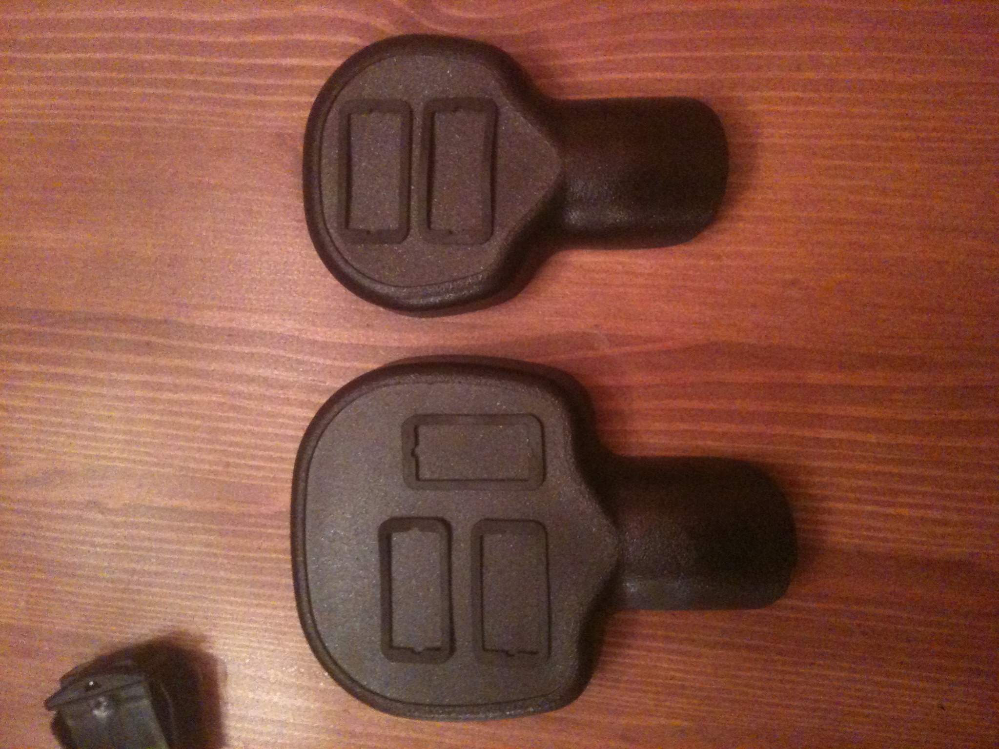

The large faced Otto grip that I intended to put on the 3pt hitch control lever is too big to fit between the seat's armrest and fender.....sooooo..... the 3 buttons that were placed on that grip are now going on some blank space on the right side fender, where the cruise control buttons are. They'll be cut in this weekend (correction, I'LL be cutting them in - I don't want to be deemed lazy) and hopefully I'll be blowing snow by tuesday.

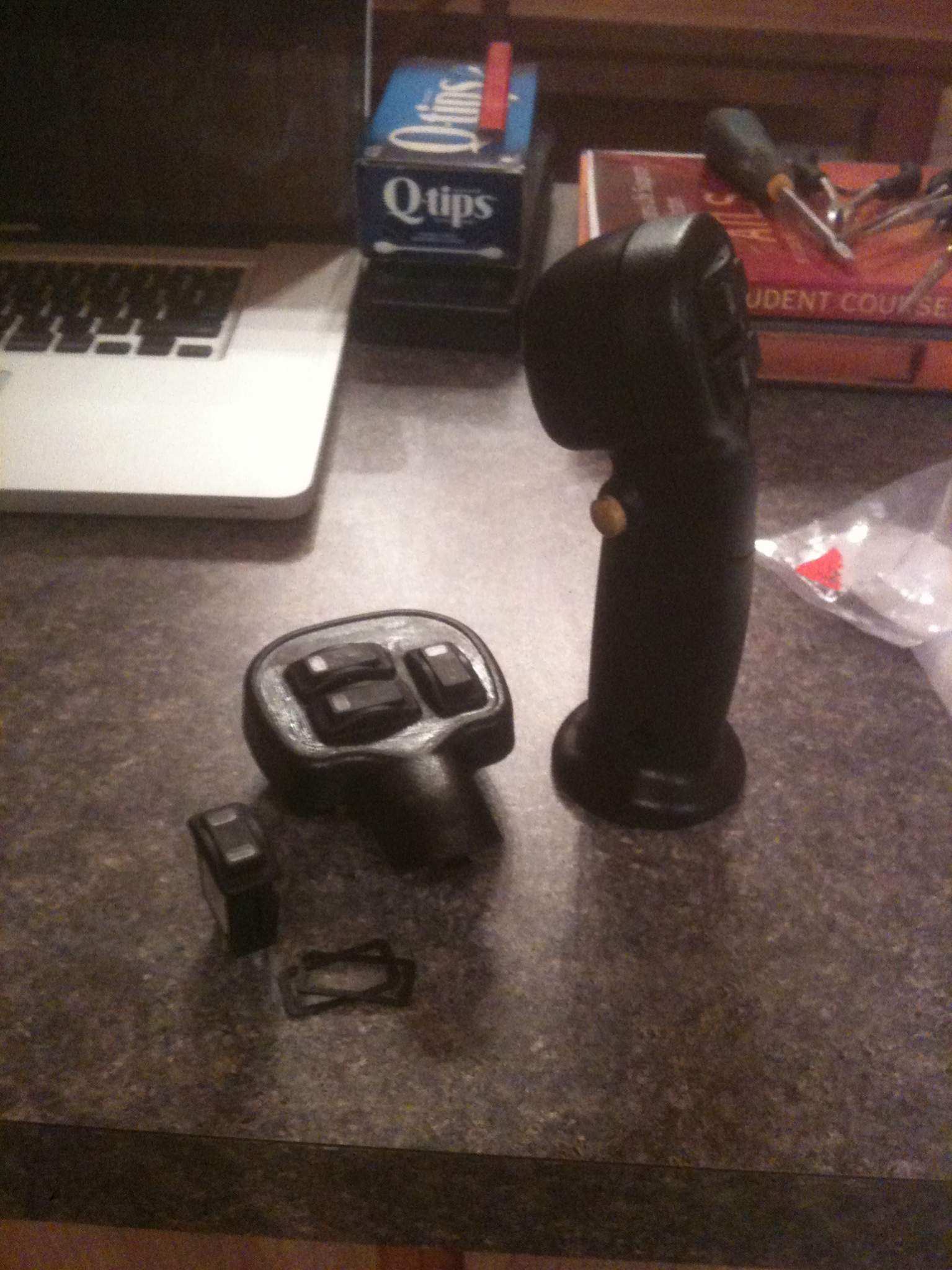

Sat down today to fix my previous oops....
The switches popped out from the grip no problem, I didn't glue them, only silicone, and it wasn't really set up yet. The gaskets survived nicely, so I reused them.
I went with the same pattern as I was going to use on the grip, only tightened it up a bit in case I find an excuse to add something else.
I put a pic of the underside of the fender panel just for you all to see the pre-marked holes that JD places on there.
FOR SALE: One pre-cut Otto large grip. Price: Free, you pay for shipping.. Need to purchase own switches. PM me.
I hope I was able to take my pics from such an angle that you can see the 5 degree deviation in my cuts!!! Kenny..... this means you......!! :cool:
