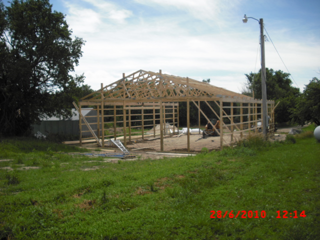

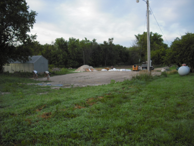

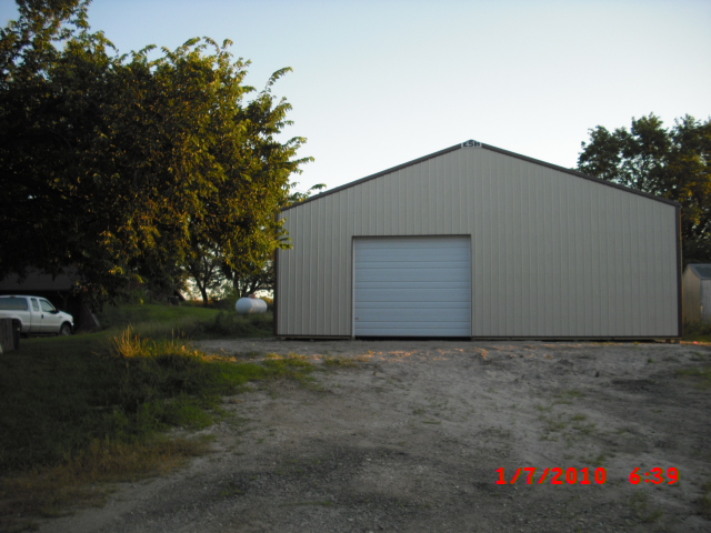

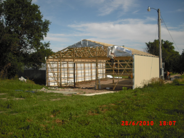

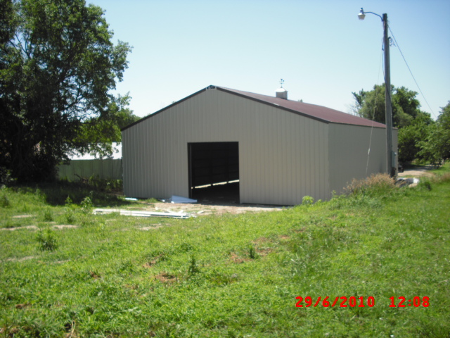

I just had a 40' x 60' x 12' building put up. Man were those guys quick!
I bought the building from Esh Quality Structures and their crew showed up on a Monday morning and were done by 2:30 p.m. on Tuesday.
Now I'm waiting on their concrete crew to show up and put in the floor.

I'm thinking of using ESH also, curious why you didn't pour the floor first and build on top of the concrete.
/ My new building #11
Pole buildings are put up first then they use a pressure treated 2x8 along the bottom as a form to pour the concrete floor once the prep has been completed. You can see in the last photo daylight under the edge of the building. They do this so you can bring in the 4 or so inches of crushed gravel, compact it then lay down the vapor barrier, re-bar or fiber mesh then pour the pad.
