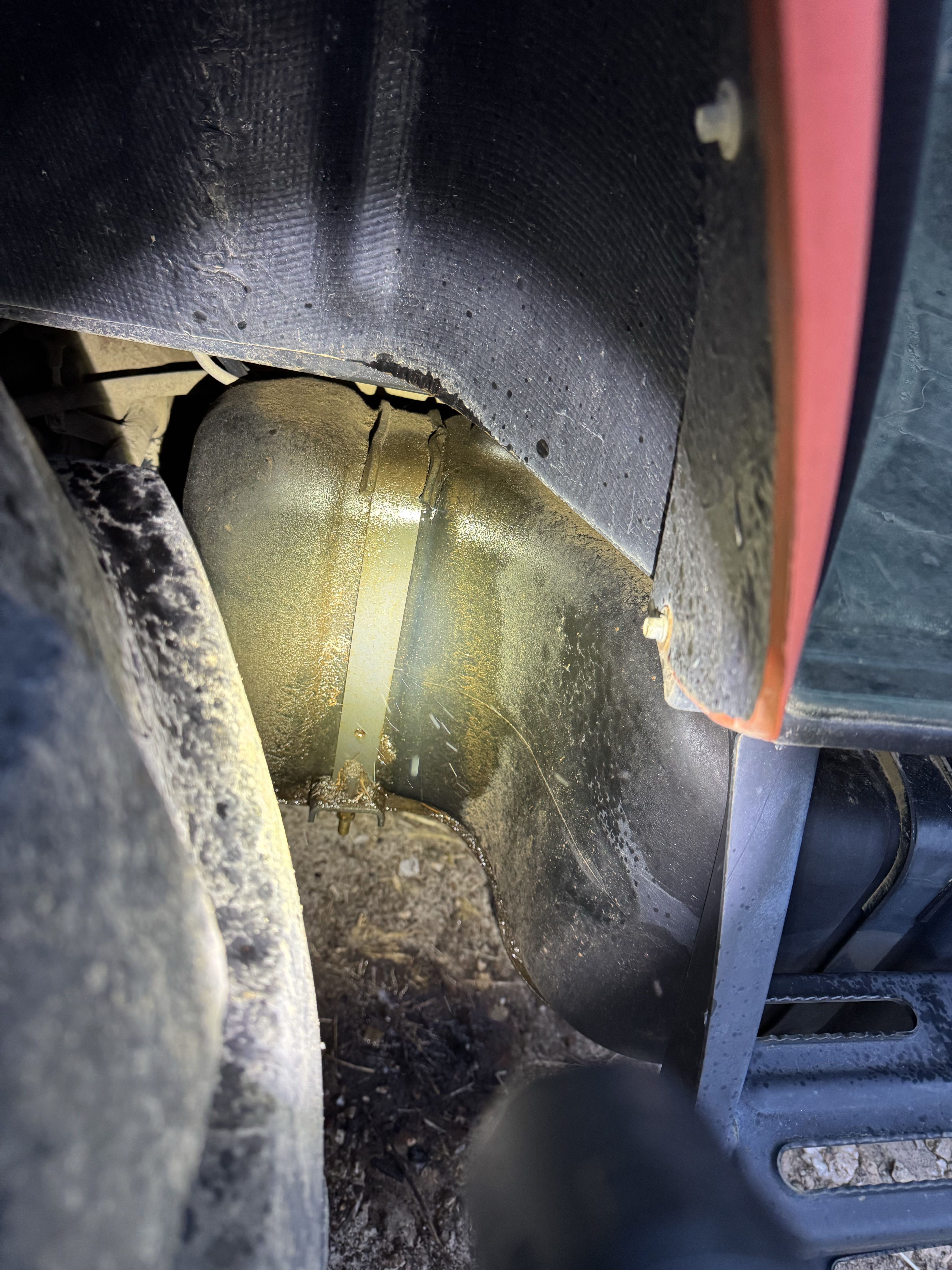

I have a crack in my kioti Fuel tank. Was getting prepped for the storm last night and saw a trail of diesel after I filled up. It is on. the top and May have been there a while. I don’t always top off the tank.
Leaking Fuel Tank

Back in the 80's when I was in High School, I bought some sort of two part putty from the Auto Parts Store that seals cracks in gas tanks. In my case, it was rust on a 1973 CJ5. It worked great.

Wipe it dry if you can and use Flex Seal. Was given a 200 gallon tank that leaked and sprayed it with Flex Seal, hasn't leaked since.

I’m willing to give those a try. Even if they just buy me some time

I got one of these plastic welders to repair the hoods and fairing on a 1864 cub cadet and have used it to do a bunch of other plastic welds. With the wire mesh and different welding rod materials it can patch up about anything. https://www.amazon.com/Plastic-Weld...8-1-spons&sp_csd=d2lkZ2V0TmFtZT1zcF9hdGY&th=1
Clean and sand the tank first. then melt the mesh into the tank, then melt more rod over the surface.
I used to use a soldering iron to do this but it doesn't do as nice a job.

JB cold weld??
   / My Industrial Cabin Build #4,977
Not sure about Kioti but Kubotas tank are HDPE and no epoxy is going to stick to that, especially in the presence of fuel. Sorry to hear about the barn:(

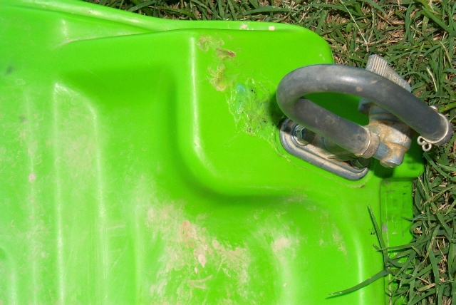

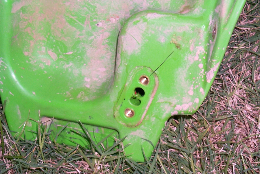

Over 20 years ago faced similar problem. New gas tank discontinued, aftermarket dried up. This is the crack:
Tried to glue it with special "plastic" glue, this failed.
Then purchased an "ATV Fender Repair Welder", a modified soldering iron with formed tip to accept welding rods. Forgot if this was HDPE or PE, think it was PE plastic. Has held ever since.
I didn't use any mesh. Used the finest tip tool in my Dremel to open the crack and clean it out of glue and gasoline. Then I plunged the "welder" all the way through the tank wall and "puddled" plastic from one end of the crack to the other until finally using makeup plastic to fill the hole at the end. Is important for the weld to penetrate full depth, not just smear over the surface.

These plastic welders. How do you not blow uourself up, when welding a fuel tank?
