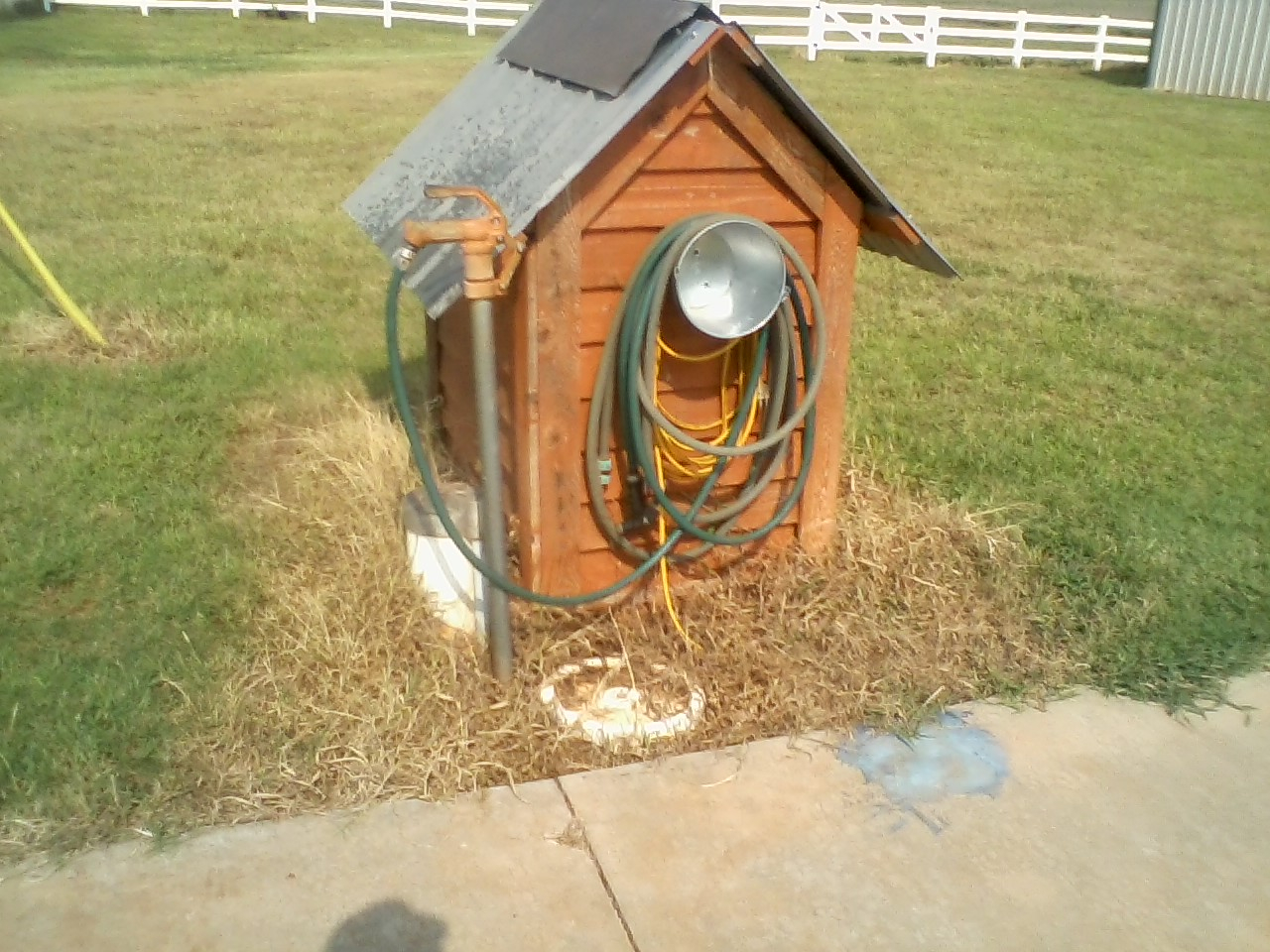

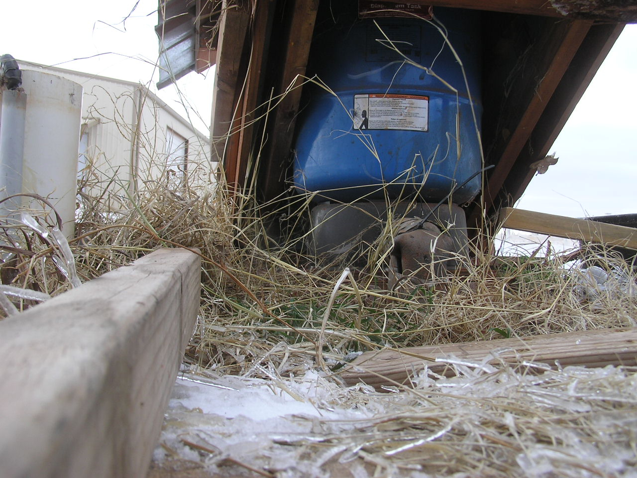

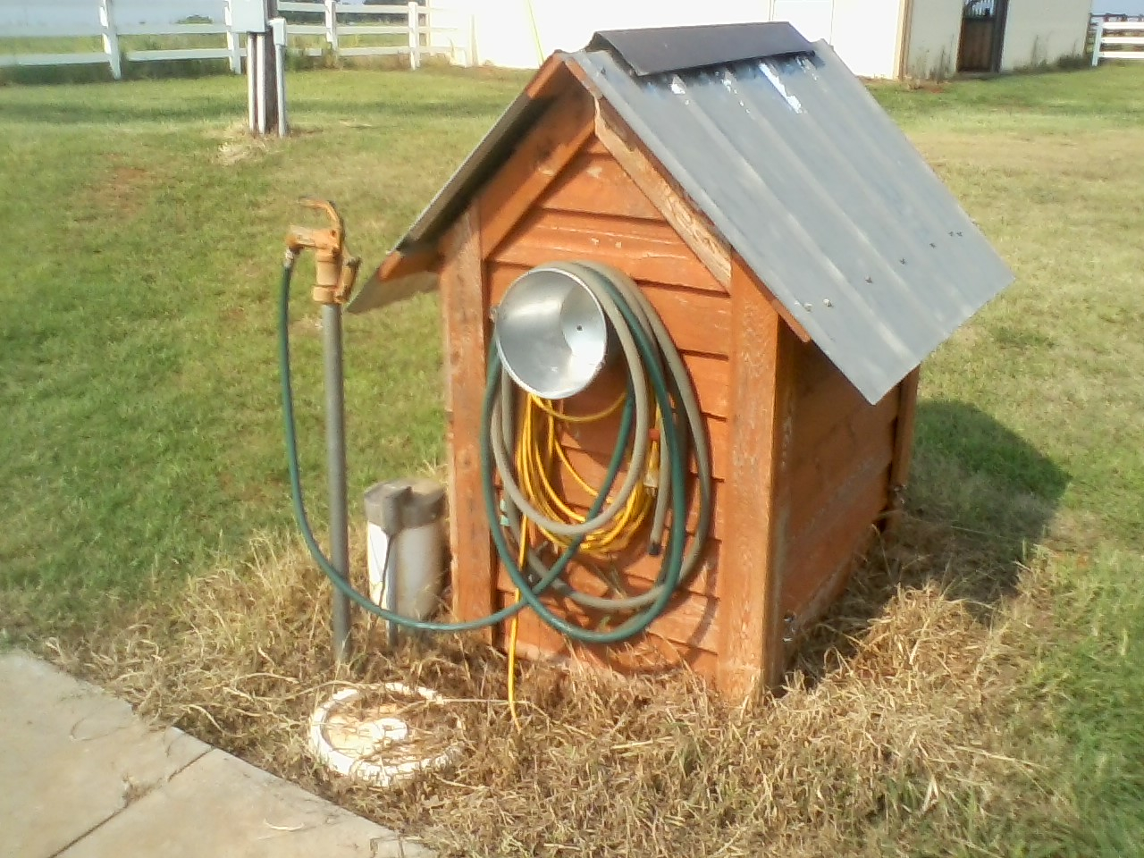

This is the pressure tank house at the well where we live now:
   / My Industrial Cabin Build #2,493
The house is insulated, was built in 2006 and as far as I know the tank has never froze:

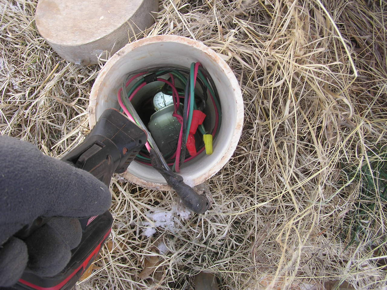

The pressure switch is in the well:
I pulled it up for the picture, then pushed it back down where it was.
